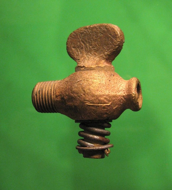

Post by Steve Jelf » Fri Nov 20, 2020 11:35 am
The stock #3079 petcock is used on both the oil pan and the radiator. So far I have never had a problem with one leaking.

Thanks guys, the petcocks I have on both cars are same as the one Steve posted the pic of.
Maybe I'll give it that "quick tap" first, and see what happens. If not, I'll take it apart and try what Richard G suggested.
