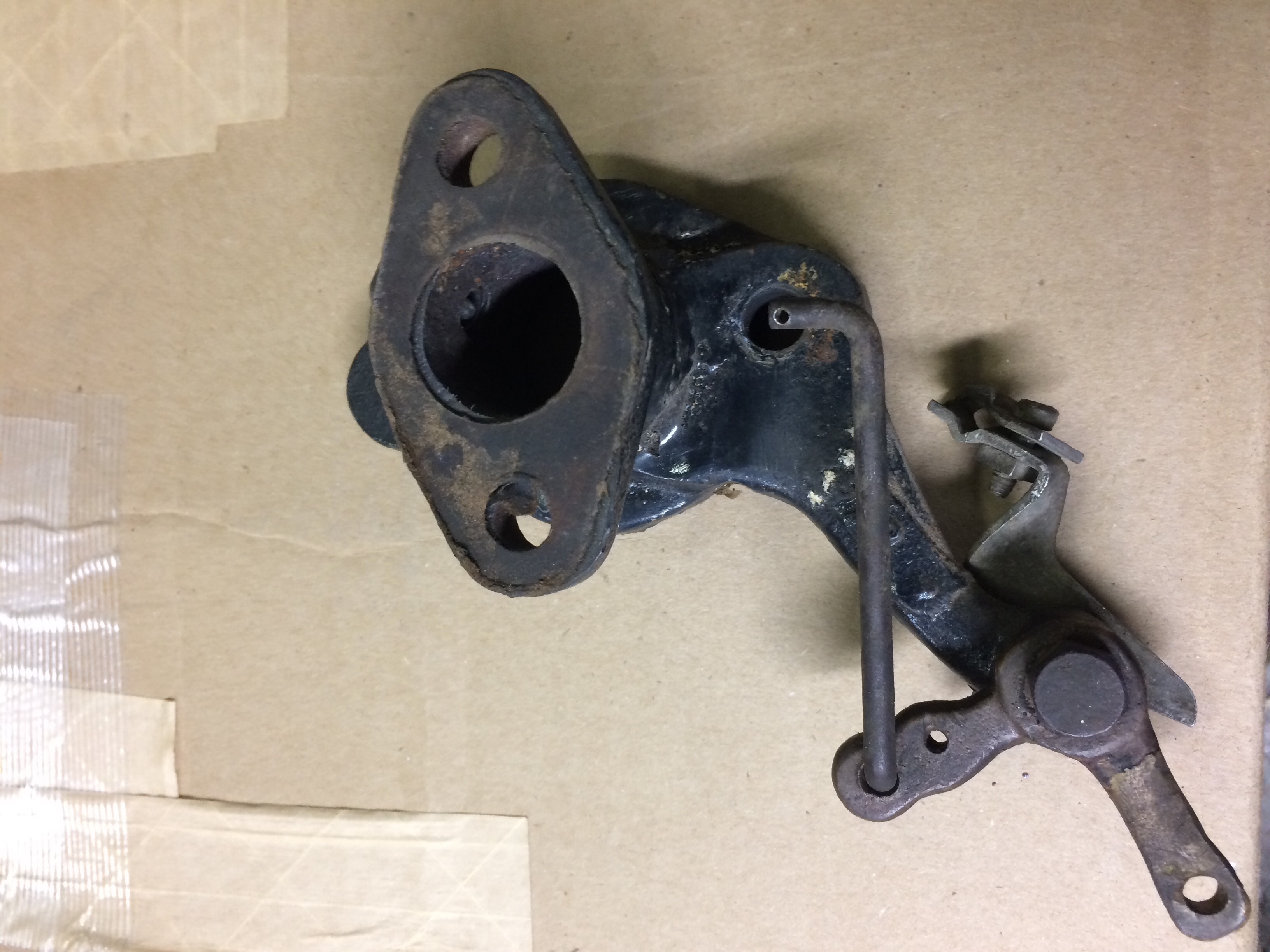

I was moving some boxes that was received from my late brother-in-law.
Found this Stromberg.
Would this work with the Frontenac?
What model?
Is a rebuild kit available?
Do you see any obvious parts missing?
What model?

Re: HELP It runs for about a mile and dies(Frontenac Touring head worth)
That is an updraft and has the wrong mounting for your Fronty. You should be looking for a side draft carburetor similsr to this:
https://www.ebay.com/itm/STROMBERG-OS-2 ... Rk&vxp=mtr
If you could locate a copy of the original sales literature for the Fronty, you would see that a similar side draft was offered as the correct carb for that set-up. It would be a lot less work fabricating an intake manifold with a side draft.
Frank
Frank
That would explain why it was buried in a box.
Thank you for the link.
We have a '26 touring with a stock head.
The thought might be getting this setup to run on the touring car.
