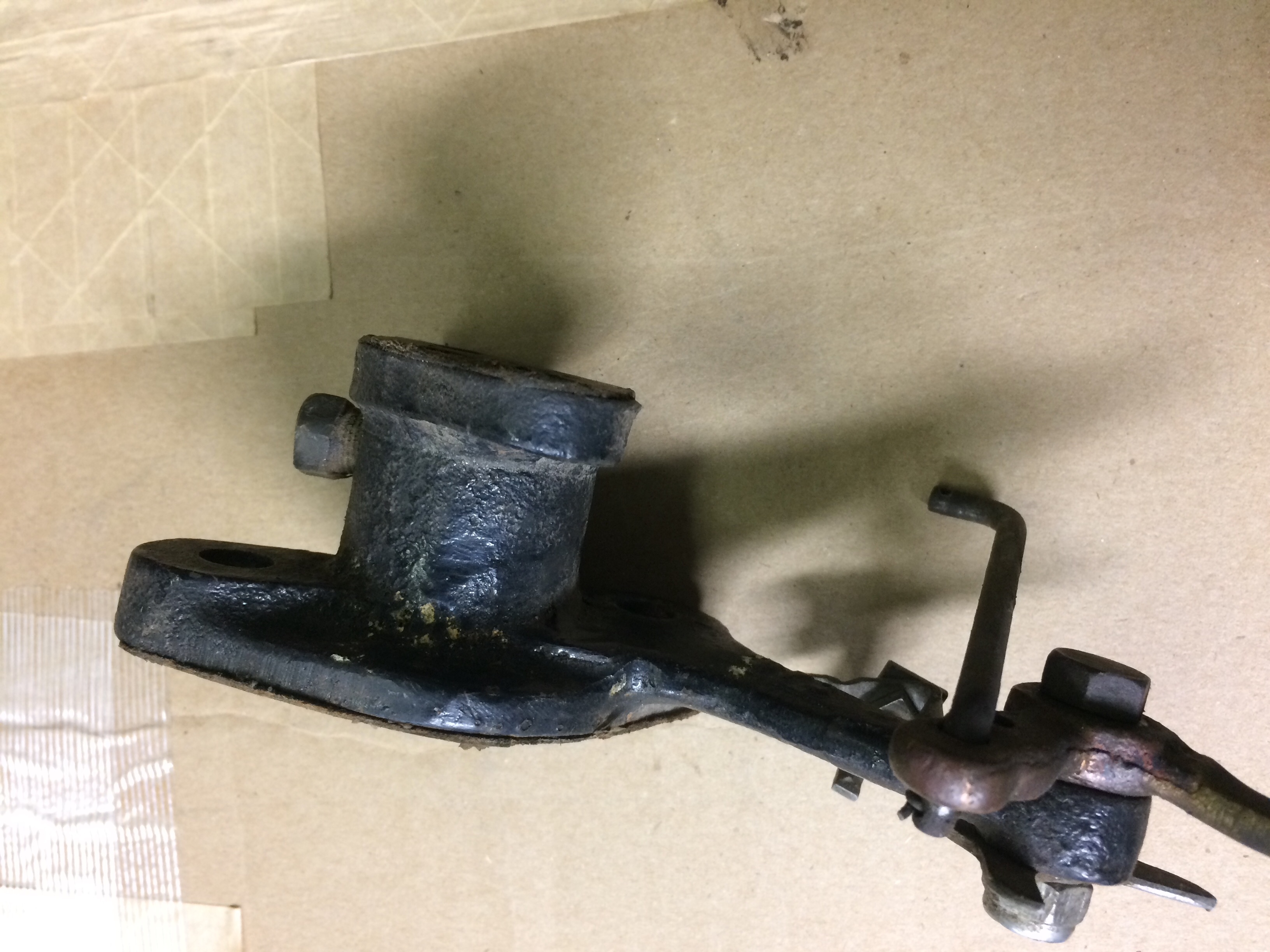

- Location: Waco, TX
Re: HELP It runs for about a mile and dies(Frontenac Touring head worth)
I was moving some boxes that was received from my late brother-in-law.
Found this Stromberg.
Would this work with the Frontenac?
What model?
Is a rebuild kit available?
Do you see any obvious parts missing?
What model?
That is an updraft and has the wrong mounting for your Fronty. You should be looking for a side draft carburetor similsr to this:
https://www.ebay.com/itm/STROMBERG-OS-2 ... Rk&vxp=mtr
If you could locate a copy of the original sales literature for the Fronty, you would see that a similar side draft was offered as the correct carb for that set-up. It would be a lot less work fabricating an intake manifold with a side draft.
Frank
Frank
Topic author - Posts: 268
- Joined: Sun Jan 06, 2019 10:48 pm
- Last Name: Bourgeois
- * REQUIRED* Type and Year of Model Ts owned: 1914, 1926
That would explain why it was buried in a box.
Thank you for the link.
