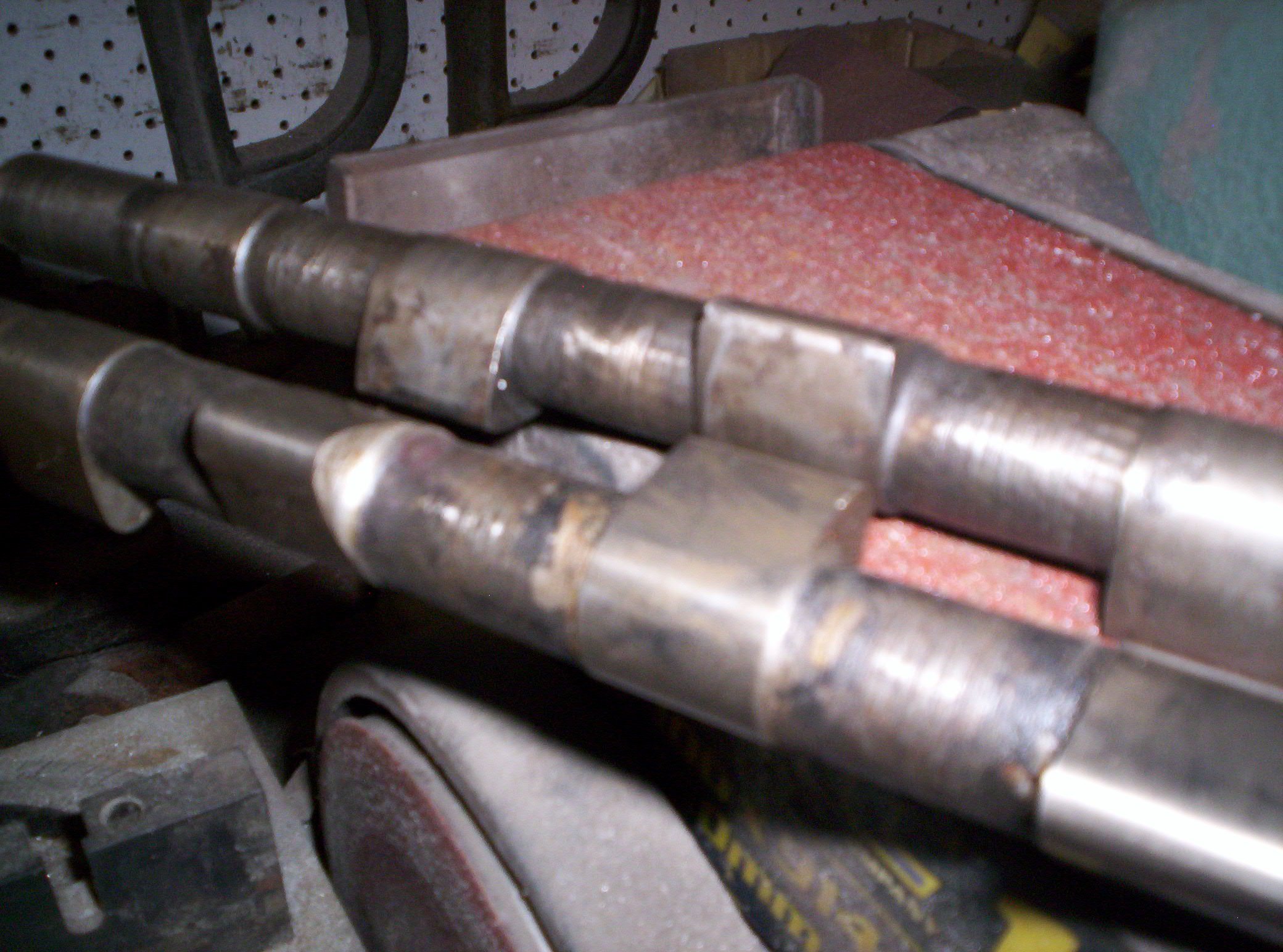

Finally got enough snow cleared to get to the shop (we had 15” here Monday Tuesday)

The bigger camshaft allows for a MUCH more aggressive cam profile. The cam pictured is about.320 lift. The engine requires 4 separate intake runners to get a decent lower end torque but pulls strong to 5,000 rpm!!

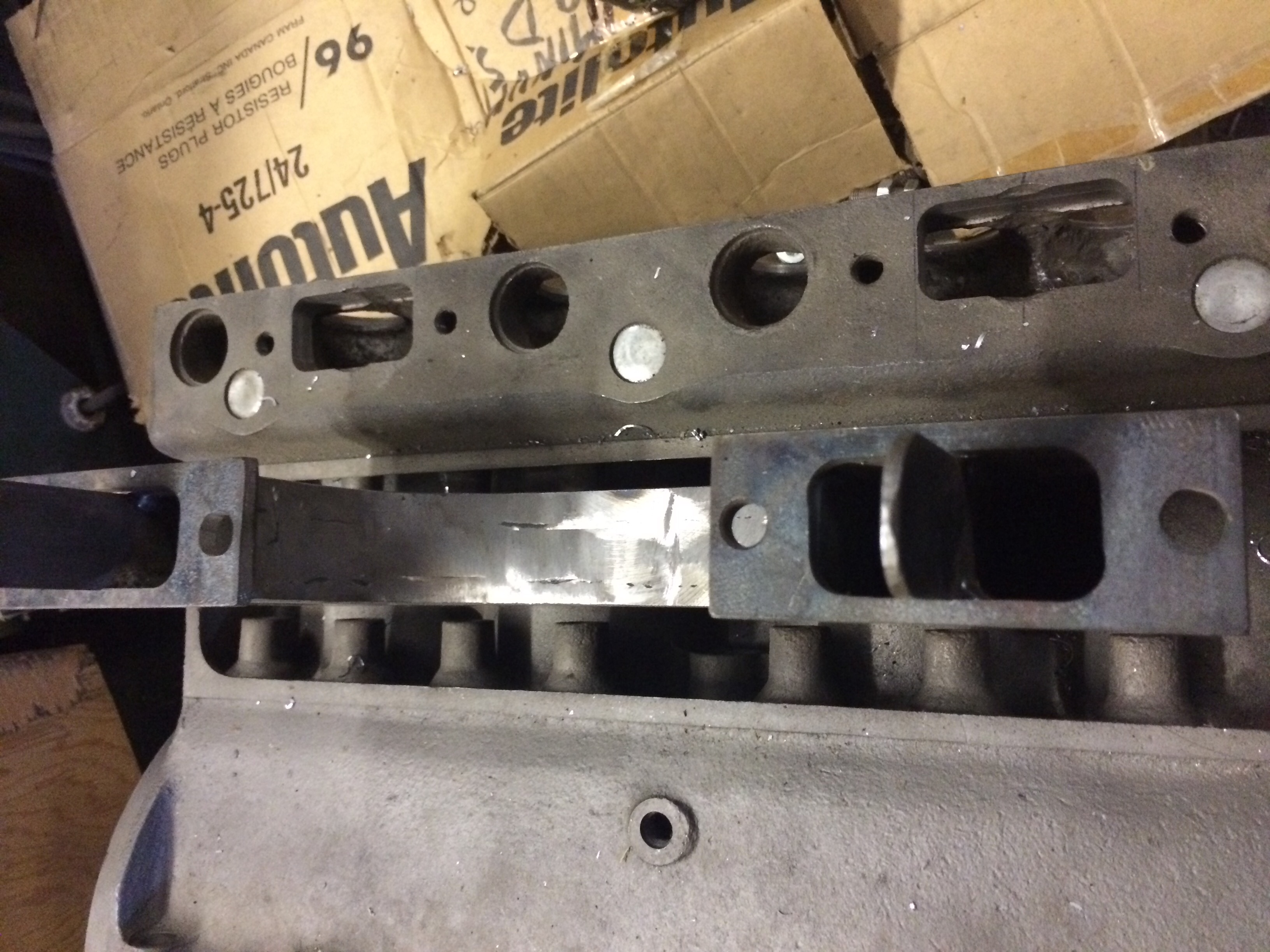

Les Schubert wrote:
" The engine requires 4 separate intake runners to get a decent lower end torque but pulls strong to 5,000 rpm!!"
I am embarrassed to show my ignorance with this question, but how does one use four separate intake runners when the block has only two intake ports? Are you implying the use of an overhead valve setup? This inquiring mind would like to know. Thank you, Bill
Bill Harper
Keene, New Hampshire

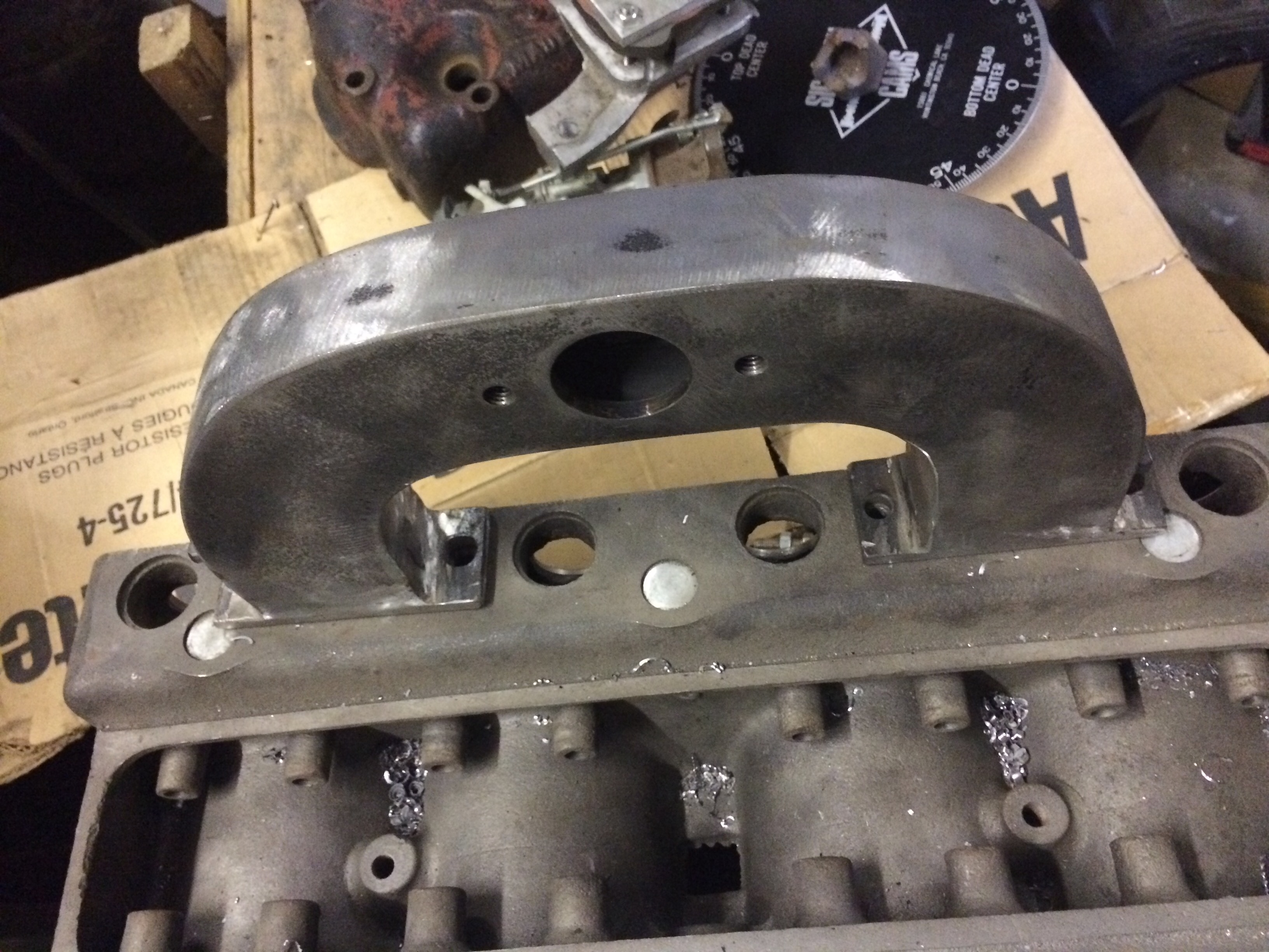

Another way to get 4 intake runners is reverse engine rotation. A whole new can of worms, but can be done.
Les Schubert
- Posts: 1364
- First Name: Les
- Last Name: Schubert
- Location: Calgary
Re: Installing A-B CAMSHAFT in T

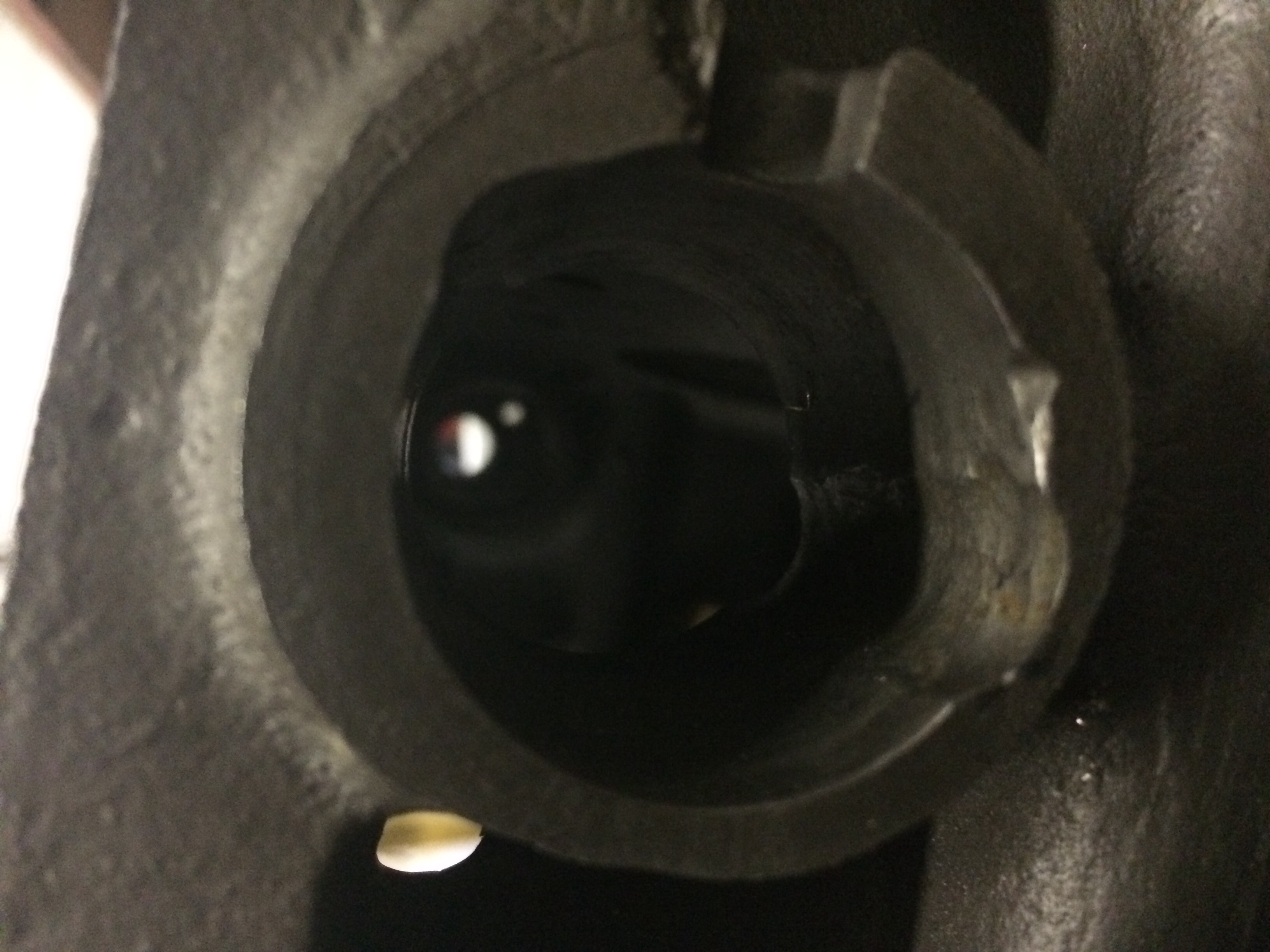

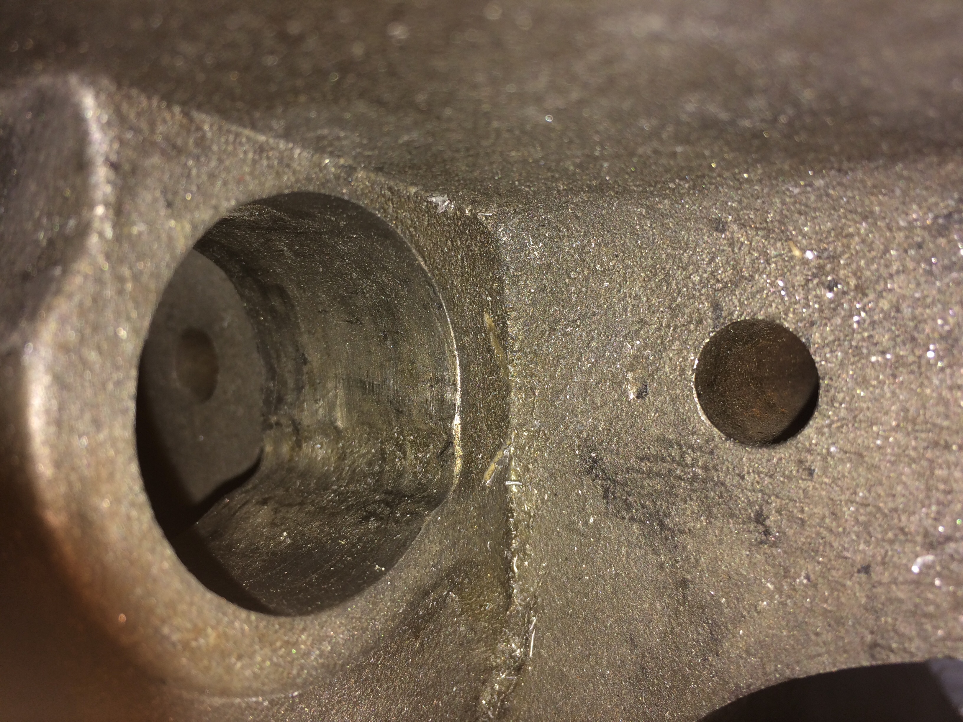

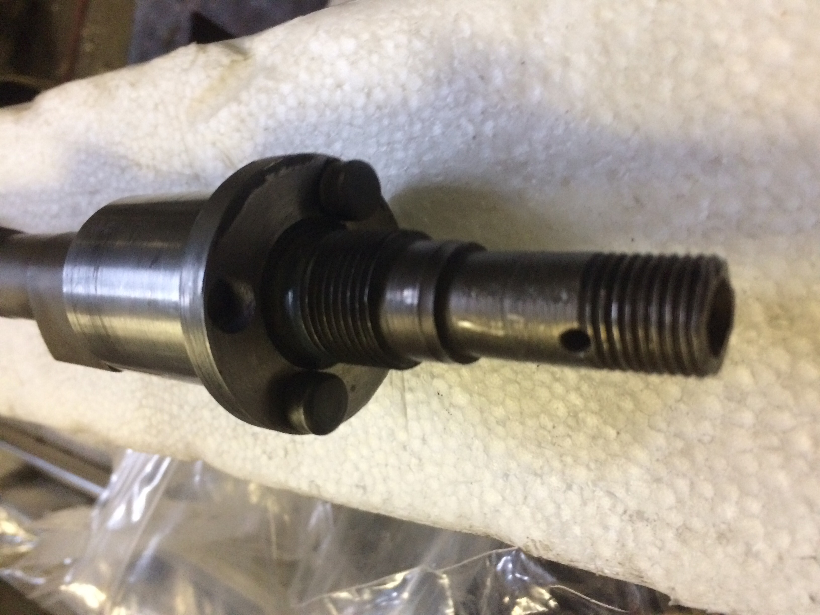

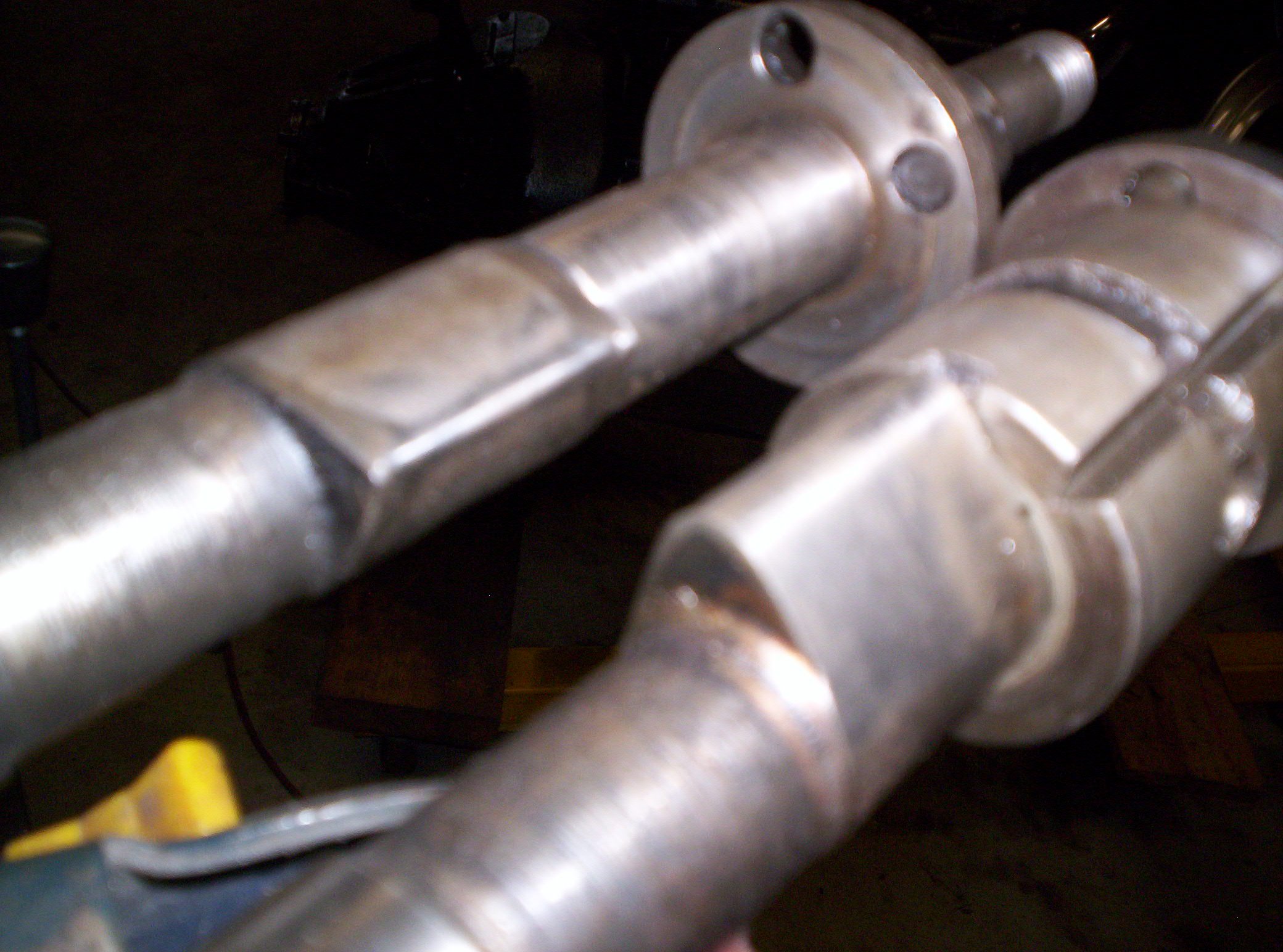

I hope these pictures help
Cam gear;
Several options. As pictured the front of a T cam has been added to the A cam. The first time I did this I refitted the T gear to the front of the A cam
Cam gear;
