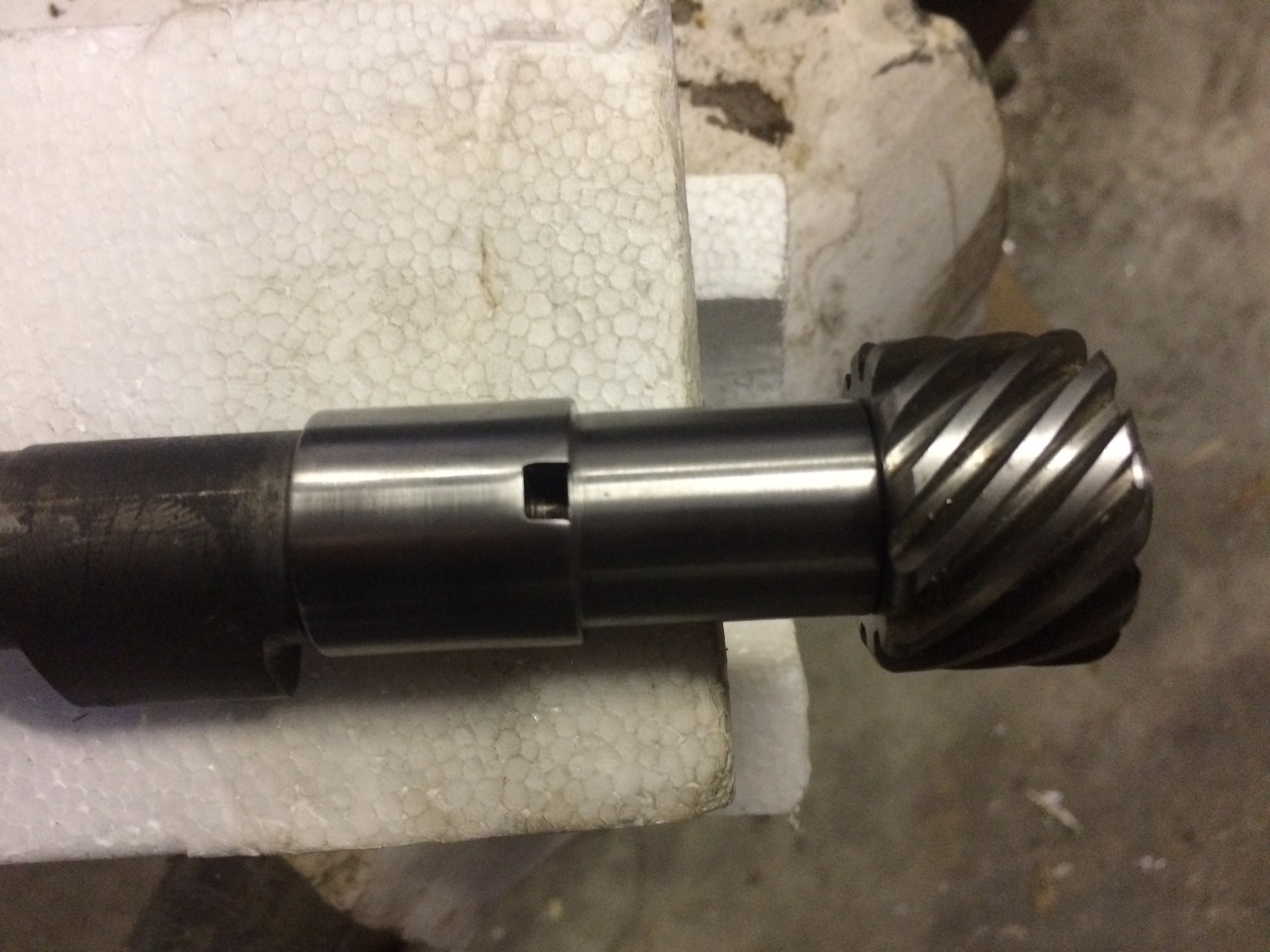

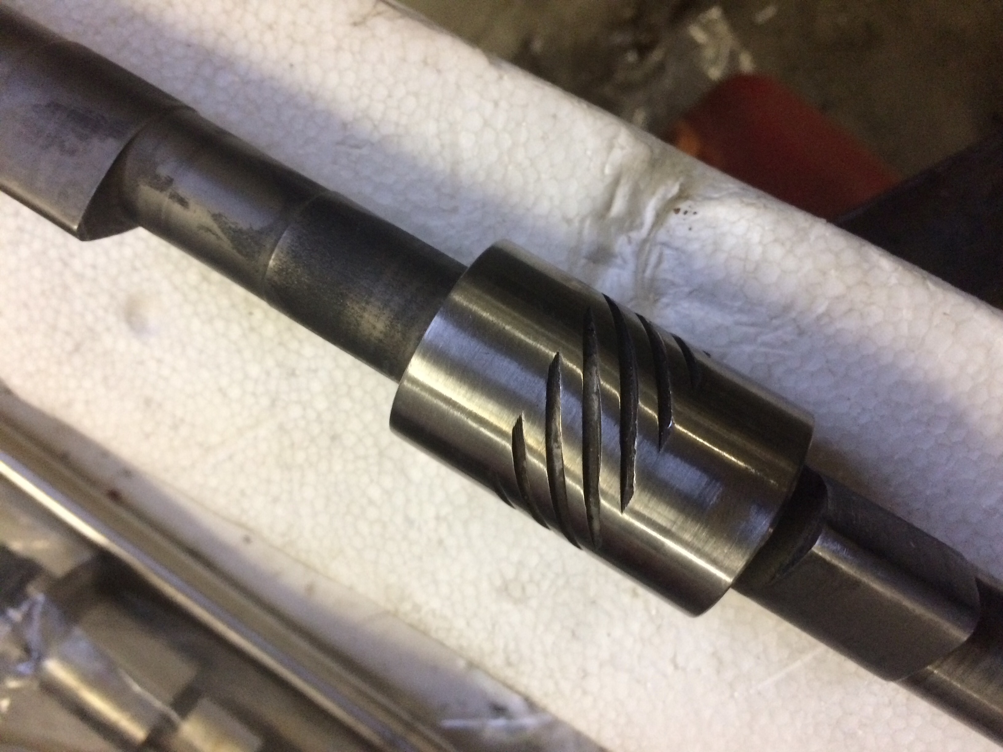

Re: Installing A-B CAMSHAFT in T
I hope these pictures help
Cam gear;
Several options. As pictured the front of a T cam has been added to the A cam. The first time I did this I refitted the T gear to the front of the A cam
						Cam gear;
