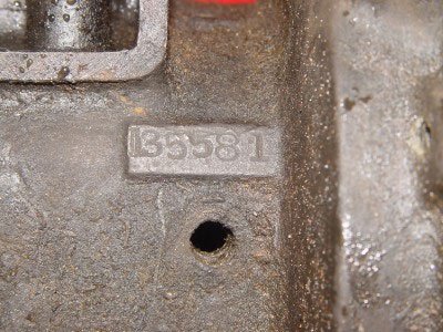

I have an early engine that does not have mounts for either a starter or a generator. Its number is 116844 but I cant find a date to go along with it. Does anyone know of a way i can find the date? I have been searching through the Ford Model T Encyclopedia with no luck.

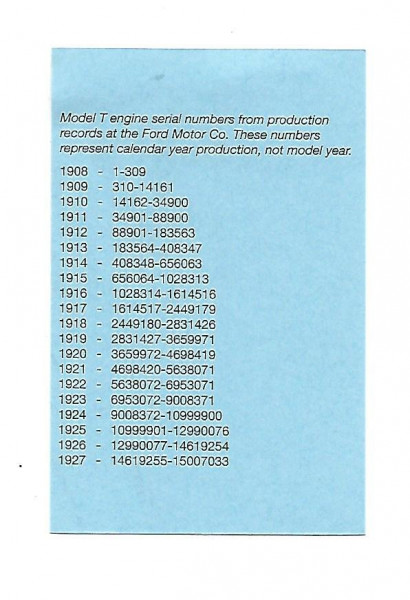

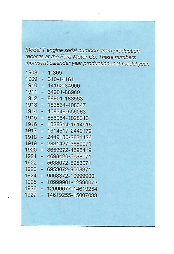

Join the Model T Ford Club International. The back of the membership card has this handy dandy reference!

Beside it it says 3 25 16 i think

Are you sure of the numbers? Can you try to include photos of the serial number and the casting date?

You're missing one digit on your serial number. March 1916 is should put it in the 1.1 million range.
