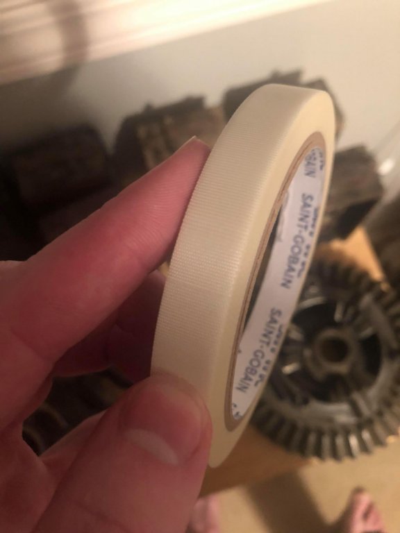

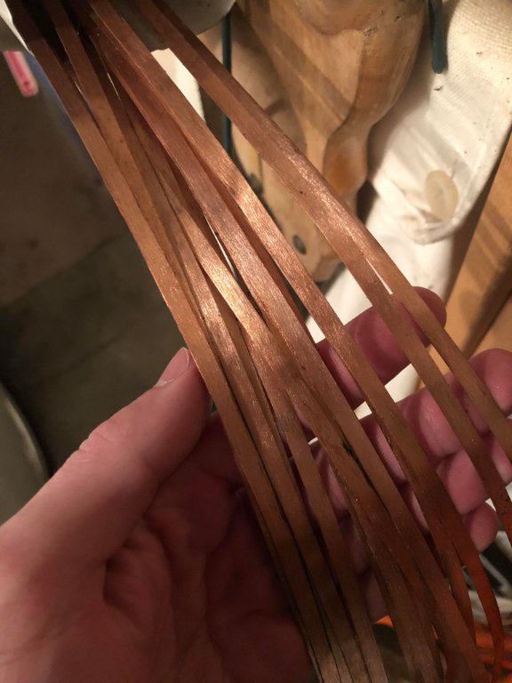

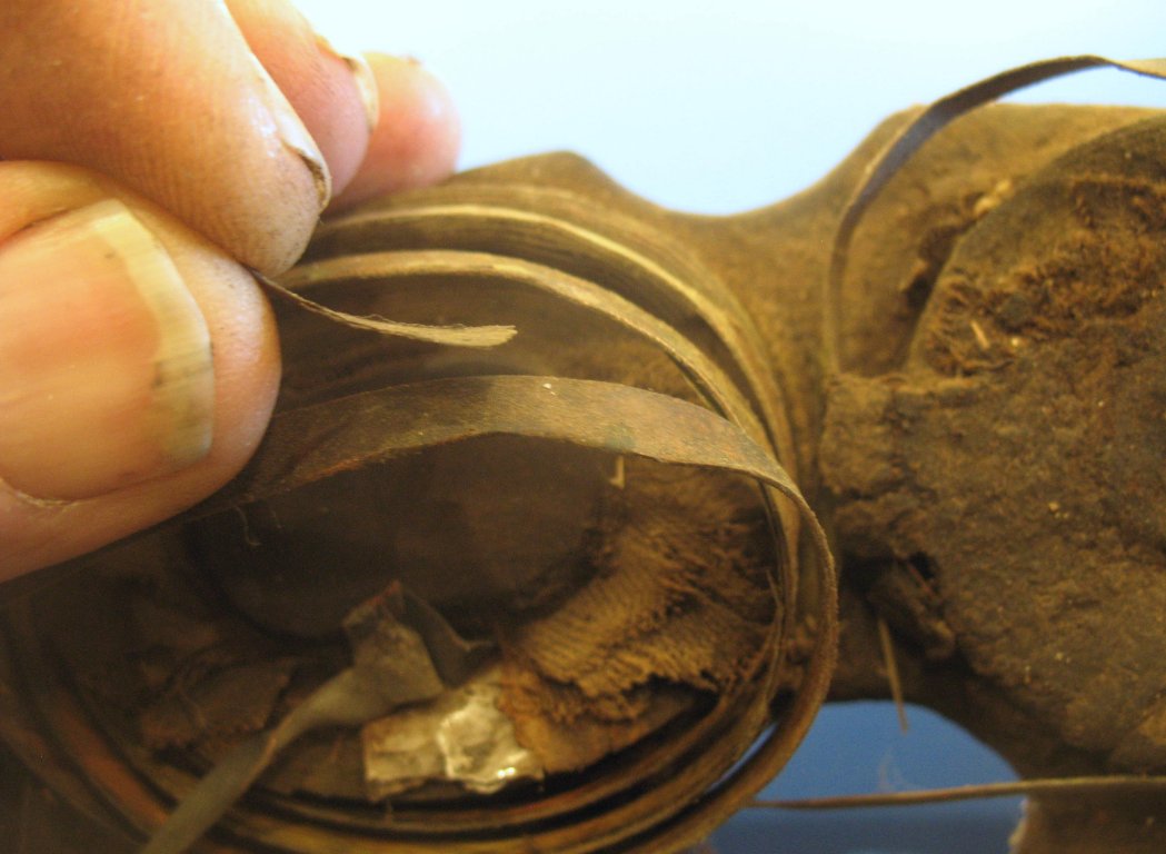

I've straightened and cleaned all of my ribbons for my field coil, and they've been sitting idle for a month now without tape.
I can't seem to find the 3M 361 tape by the roll, only the case. Does anyone know of retailers who will sell by the roll? And because the 1/4" width is not available, I've seen posts where people will put the roll on a lathe, and then slice off the desired thickness. Is there any reason why one couldn't get a width of say, 2" and cut that into three 1/2" and two 1/4" rolls?
On the contrary, is there a more cost effective alternative? I'm hoping to rebuild this once over the life of the T, and not have to worry about something failing years down the road, despite a significantly lower up front cost.

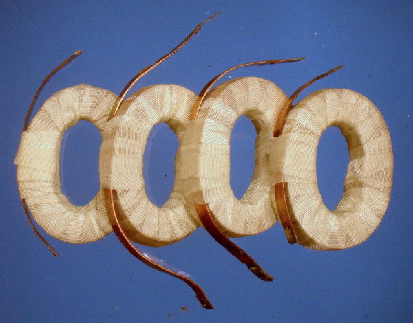

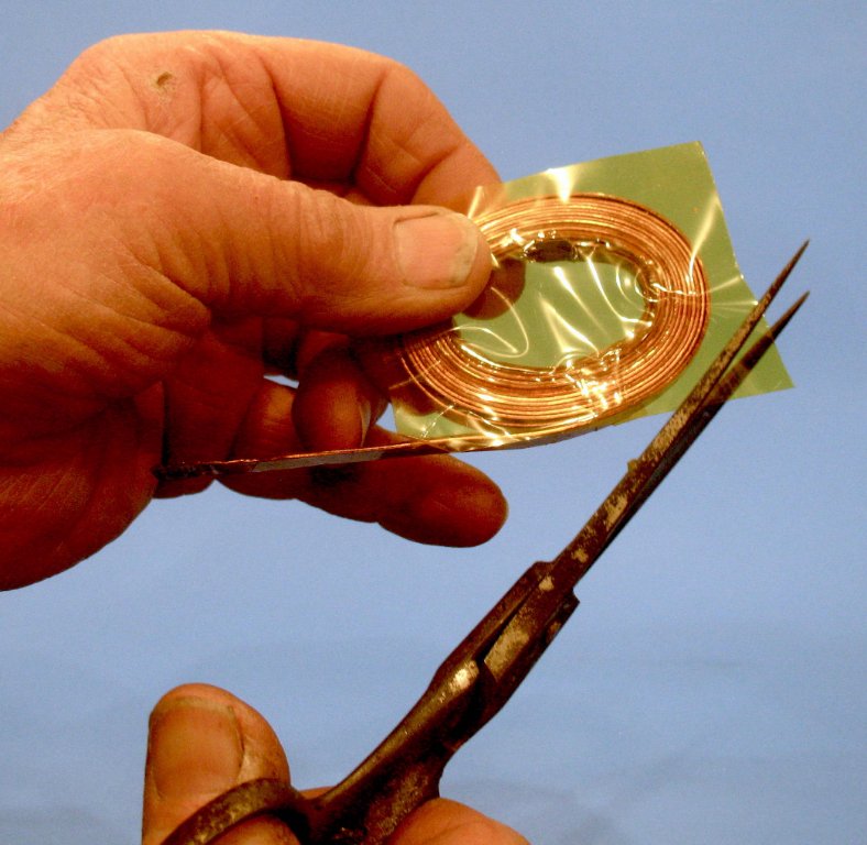

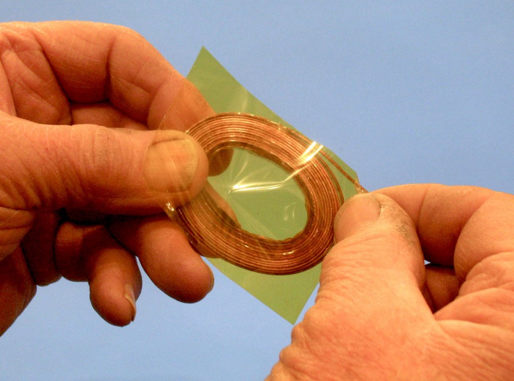

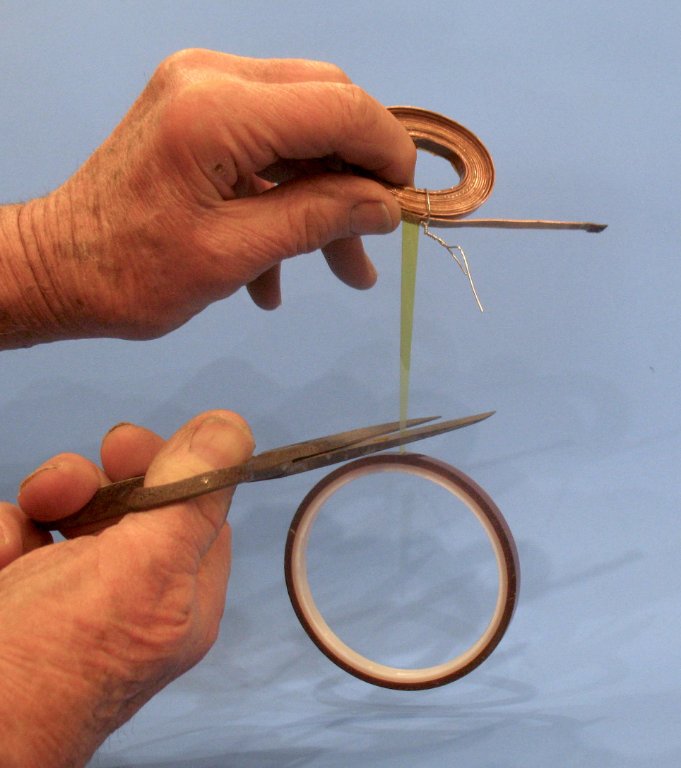

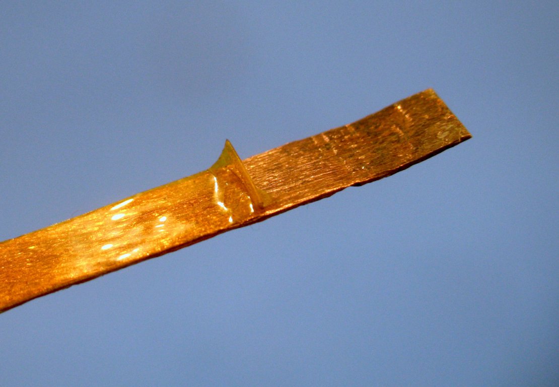

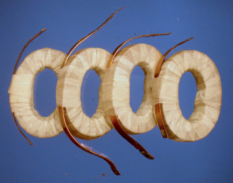

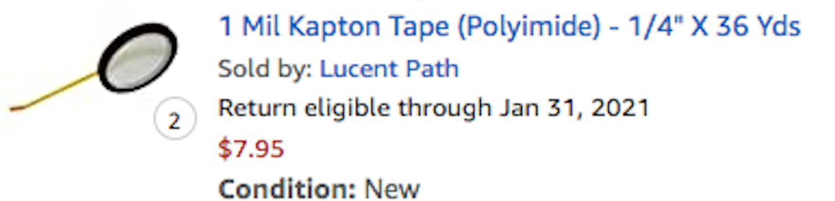

I am using Kapton™ tape on the ribbons. 1 mil ¼" x 36 yd is $21.89 (shipping included) for two rolls on Amazon. It turned out that I needed a third roll to do all 32 individual coils (1915 double stack). It turns out that I have enough extra to wrap one side of each coil to keep it wound tight.

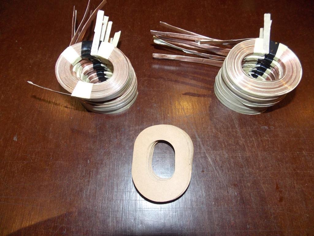

For insulation between the two coils in each stack I got a 10-pack of 8" x 8" polyimide tape from the internet. I'm not finding the receipt, so I don't have the cost. It's from gizmodorks.com, but I probably ordered it through Amazon.
The big expense was three rolls of 7574A11 ½" x 18 yd fiberglass tape from McMasterCarr for $49.52 for the final wrapping. I haven't done that yet, so I don't know if three rolls will be enough.
The outside coating will be Sprayon EL-600 clear insulating varnish. Grainger had the best price.

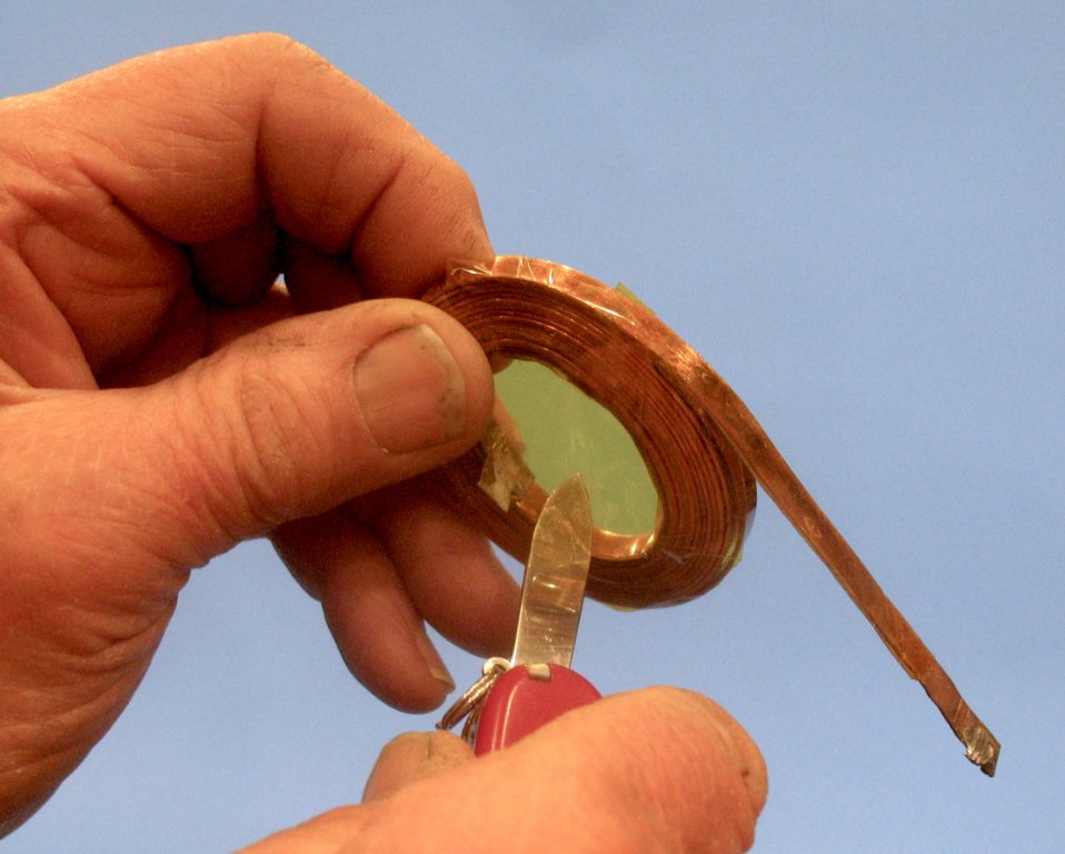

¼" Kapton™ is a perfect fit on the ribbons. I put it on both sides, so there will be 2 mils of insulation between layers.

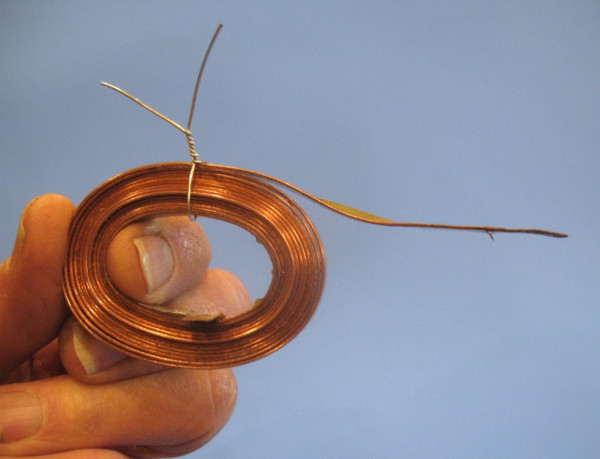

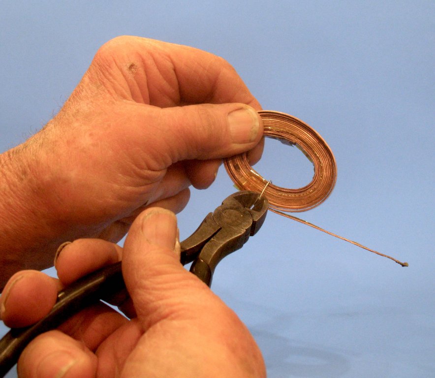

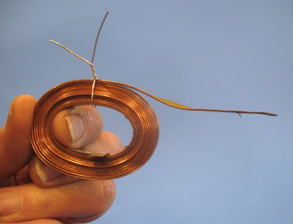

I tied the coils with wire to keep them from unwinding.
Next was wrapping Kapton™ around the coil to keep it wound...
- Posts: 7392
Re: Field Coil Tape
...then I could cut off the wire.

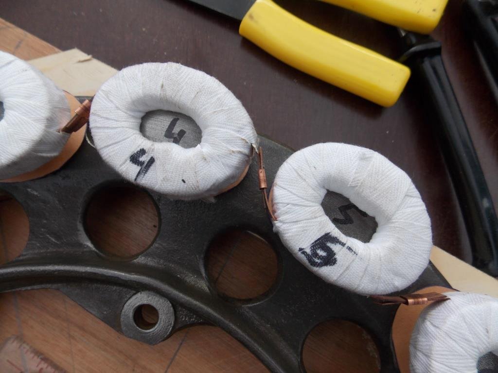

I'm applying a polyimide sheet to both coils in each pair, so there will be 2 mils of insulation between them.
I trim off the excess leaving a little sticking out around the edges, and fold it down over the sides.
The final step in this part is cutting out the center oval. Next will be soldering the coils together in pairs. Then final wrapping, coating with the clear insulating varnish, and installing on the coil ring. I've never done this before, and I have other things to do, so it's taking forever. That's OK. I'm not going anywhere until I get my shots.

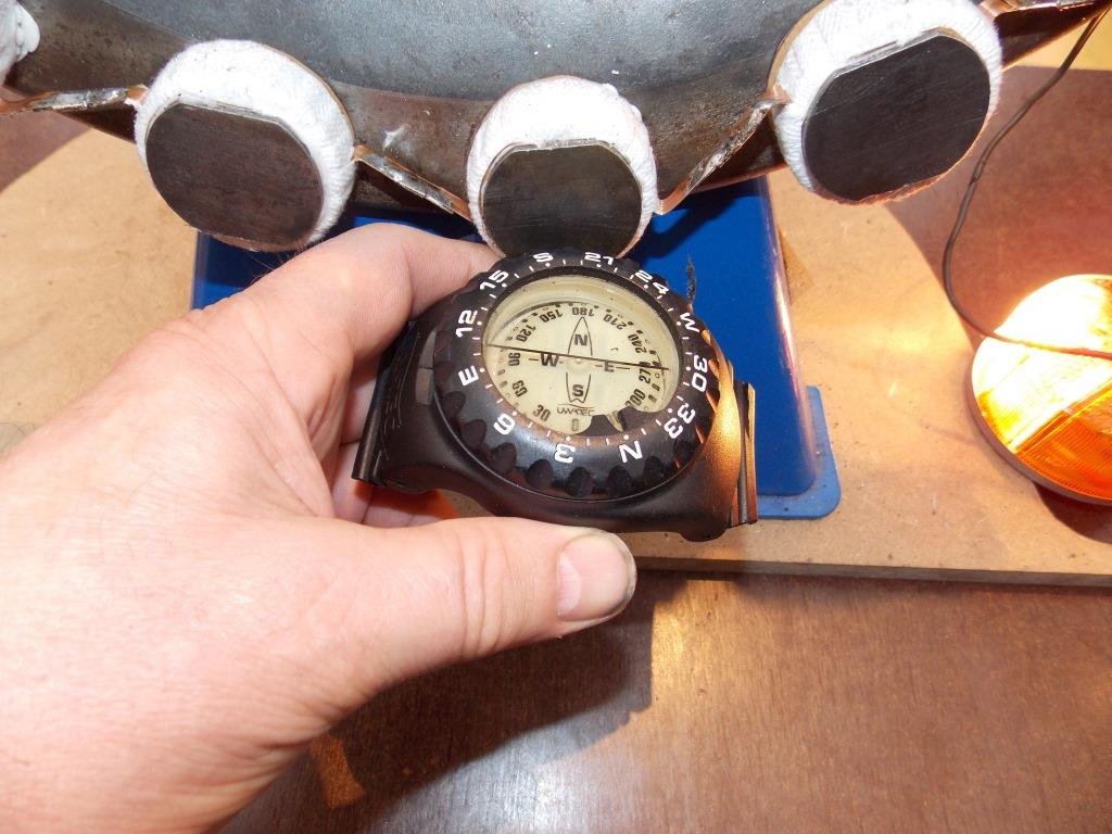

After reading that I wondered what Ford used. I went out to the barn and got a damaged mag ring with some unwinding coils to take a look. The layers are separated by thin (.010") paper. The Kapton™ tape I'm using measures about .002". It's applied to both sides of the copper ribbon, so there's about .004" "cushion" between layers. Given the toughness of the tape, is that enough cushion? We shall see.

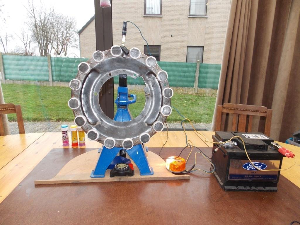

As Norman said you can check for continiuty or short with an Ohm-meter. To be sure and check the working of the coil ring I only found one way to do it before you build it in an engine.

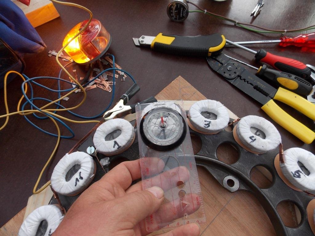

Preassemble your coil ring on the support and make a loop with a 12V battery, a 21W 12V light bulb and your coil ring. As the light lights up you have continiuty. With a compass, pass near to each coil and you should find North and South alternating. When, in front of a coil, the needle do not show N or S, this coil has a problem. With the double coils the problem could be an internal short or a mistake in the assemby of the coil.
This test can be done before you warp the coils with cotton or other tape, just be sure to insulate each coil well from the support. (I will try to find a photo)
As you install the coilring in your engine, before you install the transmission, just turn your engine by hand the speed you use to start the engine. With a ACVolt meter you should read about 2acV, the magneto tester can be used for it too. Final test should be done on a running engine.
Hope this help.
Andre
Belgium

I measured single stack copper ribbon at 3/16" x 0.013" about equivalent to 15 gauge round copper wire which has a published resistance of 3.184 Ohms per 1,000'. 192' would have 0.6113 Ohms resistance. If the double stack is different cross section, the resistance differs inversely with cross section area. Personally, I like Andre's approach to the entire process. jb

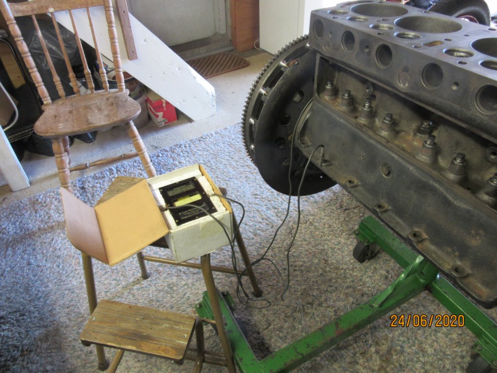

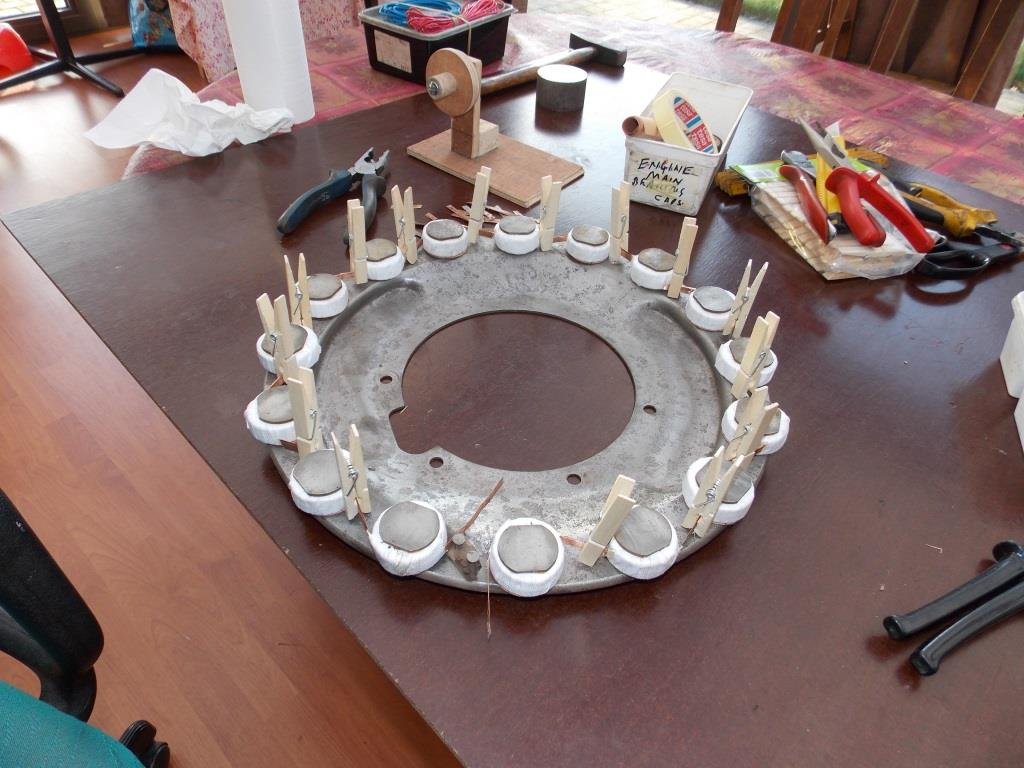

Testing the working of the coil ring I do it this way.
- First I make the crankshaft fit right in the block.
- Before installing any other parts (rods, pistons,...) I install the ciol ring and the flywheel (with the right gap between the ring and the flywheel).
- Install an acVolt meter.
- Turn the crankshaft by hand with the speed you turn an engine for starting.
- At the same time, watch your V-meter. You should find about 2acV.
Now you are about sure the coil ring is working and the magnets are charged.
Turning the engine with an electric motor should be a better test but I am not at this state jet will be done in the future.
Good luck
Andre
Belgium

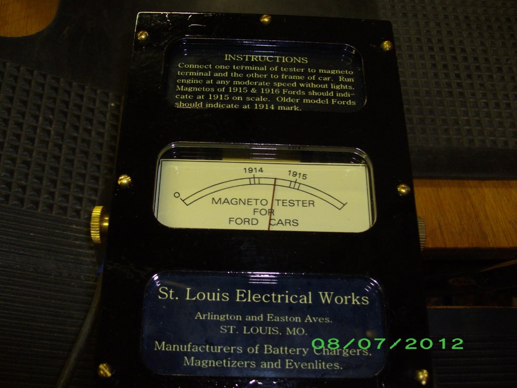

I do it nearly the same as Andre' , but with an St.Louis magneto Tester .

To rebuild the double round in the photos it took me a total of 28 hours. About half of the time was needed to clean and make the strips and all the other parts grease free. Making the insulating shields (5 for each coil) took about 2 hours. The time left was for making the 32 single coils and assembling the coil loop.
As I understand the model T history, the flywheel and the magneto coil ring were the first to be assembled on a small assembly line starting late 1910 early 1911.
They started with all clean parts. Insulating the strips was done on a tool aswell as making all the coils.
Making the new coil loops should take a lot of less time as I needed to rebuild mine.
After rebuilding my first coil ring I understand the price dealers are asking for the rebuild loops. It are not the parts but the labor that makes the price.
The reason why I tried to rebuild my own coil rings are the shipping price and the locak and income taxes here in Belgium.
The final price is about the double of the prices the dealers are asking.
The second reason was the challenge to repair my own coil ring.
Andre
Belgium
Andre
Belgium

Today I wrapped sixteen double coils with that ½" tape. I used a little under 19 yards, so you have plenty.

Ryan,
What is important by the double coils is that you make all 16 double coils the same. You will get the left and right winding by alternating the windings as you asemble your loop by facing the ends of each coil ones up and the next down.
By the single coil coilring you have to make 8 left and 8 right coils. Easy to do this by making the inner connection strip facing to you and for the other direction the strip should face the other way.
The mandrel in the photos is working for me for more than 10 years and is easy to use and a copy of the picture I found in the MTFCA electric book.
Good luck
Andre
Belgium

I've watched the Model T Tips video several times now, very helpful. I'm wondering if the ribbons need to be surgically clean. The fellow in the video looks to do a fairly quick pass and then puts the tape on. I was quite deliberate going up and down the ribbon with my wheel, and they've been sitting exposed in the garage for almost a month now. I figure as long as the conductivity is good, then barring any glaring debris I should be good.
I'm also following the other thread re: soldering and flux, which is where my concern lies. If the copper is not super clean prior to insulation, can it rust from within over time?
This is a sample of my ribbons. Anything dark there I could rub off with my fingernail, which I can easily do as I tape the ribbon

Ryan,
The copper strips should be clean and grease free so the glue on your insulating tape get a good connection with the strips.
Clean copper strips make the soldering easier. You don't need anything else than a good iron and good electric solder lead.
To get my copper strips grease free I use ACETON.
Don't worry about the copper rusting. A few hours after you clean the strips, the oxidation of the copper has already started.
Best is to clean and insulate at the same time.
After assembling the coil ring get a good coating on the assembly and make it dry well. It will seal the copper from the air.
In the engine, the coil ring is sitting and is soaked in oil. No oxidation here.
Good luck
Andre
Belgium
Good luck
Andre
Belgium

I bought the High-Strength Fiberglass Electrical Tape with silicone adhesive. Product #'s 7574A35 and 7574A11
