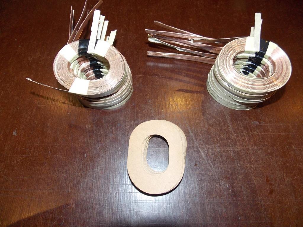

I've straightened and cleaned all of my ribbons for my field coil, and they've been sitting idle for a month now without tape.
I can't seem to find the 3M 361 tape by the roll, only the case. Does anyone know of retailers who will sell by the roll? And because the 1/4" width is not available, I've seen posts where people will put the roll on a lathe, and then slice off the desired thickness. Is there any reason why one couldn't get a width of say, 2" and cut that into three 1/2" and two 1/4" rolls?
On the contrary, is there a more cost effective alternative? I'm hoping to rebuild this once over the life of the T, and not have to worry about something failing years down the road, despite a significantly lower up front cost.

I am using Kapton™ tape on the ribbons. 1 mil ¼" x 36 yd is $21.89 (shipping included) for two rolls on Amazon. It turned out that I needed a third roll to do all 32 individual coils (1915 double stack). It turns out that I have enough extra to wrap one side of each coil to keep it wound tight.
For insulation between the two coils in each stack I got a 10-pack of 8" x 8" polyimide tape from the internet. I'm not finding the receipt, so I don't have the cost. It's from gizmodorks.com, but I probably ordered it through Amazon.
The big expense was three rolls of 7574A11 ½" x 18 yd fiberglass tape from McMasterCarr for $49.52 for the final wrapping. I haven't done that yet, so I don't know if three rolls will be enough.
The outside coating will be Sprayon EL-600 clear insulating varnish. Grainger had the best price.
¼" Kapton™ is a perfect fit on the ribbons. I put it on both sides, so there will be 2 mils of insulation between layers.
I tied the coils with wire to keep them from unwinding.
Next was wrapping Kapton™ around the coil to keep it wound...

- Posts: 7334
Re: Field Coil Tape
...then I could cut off the wire.
I'm applying a polyimide sheet to both coils in each pair, so there will be 2 mils of insulation between them.
I trim off the excess leaving a little sticking out around the edges, and fold it down over the sides.
The final step in this part is cutting out the center oval. Next will be soldering the coils together in pairs. Then final wrapping, coating with the clear insulating varnish, and installing on the coil ring. I've never done this before, and I have other things to do, so it's taking forever. That's OK. I'm not going anywhere until I get my shots.

Ryan: I used McMaster-Carr p/n 7574a11 High temp fiberglass cloth with silicone adhesive. With all the work involved, I would not skimp on this part of the project. That tape is good for -100F to +500F and oil resistant. I split 1/2" width tape with a boxcutter blade attached to a guide laying the roll flat on a sawtable, if you have a lathe, that's good too. You will see other width fiberglass tapes on Mcmaster along with the one recommended. Do not use mylar tape, you need the cushion of the cloth between turns of the coil copper.
And I recommend Glyptal 1202 clear insulating varnish for sealing the finished assembly, that's brushed on liberally to saturate everything. I feel this product is best b/c you can cure at very low oven temp, 200 F for an hour, per manufacturer. After air drying for a couple days I used our kitchen electric oven, the oven curing varnish did not smell.
When you cut the insulating washers that go between the stator ring and coils, make them teardrop shape rather than the original oval. Use that extra 'tail' to give additional insulation where you solder the ends of coils together. It prevents any of those junctions from ever touching the cast iron ring. Mcmaster has fishpaper for this if you need it, I recommend the 0.020" thick fishpaper, it's tough to cut, I used a punch for the center hole.
When I assembled, I glued the fishpaper rings and coils to the stator individually with Glyptal, verified electrical function of each coil, soldered the coils in series, checked electrical function of the assembly and then painted liberally everything with Glyptal.
Have fun, jb
Have fun, jb

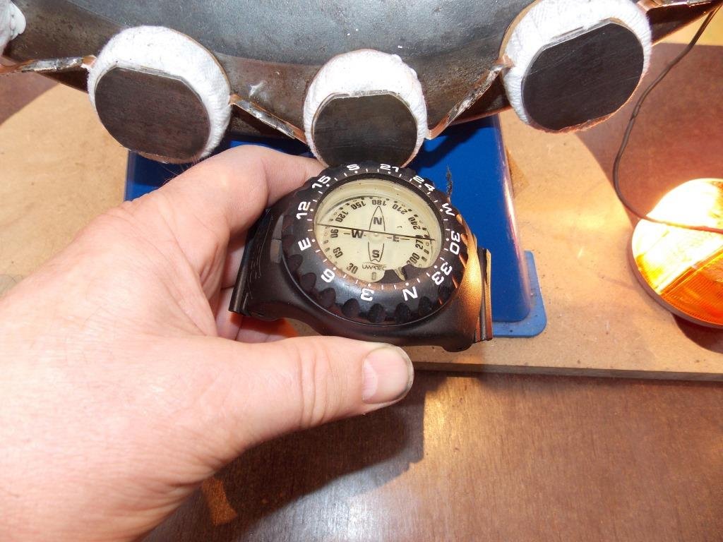

Preassemble your coil ring on the support and make a loop with a 12V battery, a 21W 12V light bulb and your coil ring. As the light lights up you have continiuty. With a compass, pass near to each coil and you should find North and South alternating. When, in front of a coil, the needle do not show N or S, this coil has a problem. With the double coils the problem could be an internal short or a mistake in the assemby of the coil.
This test can be done before you warp the coils with cotton or other tape, just be sure to insulate each coil well from the support. (I will try to find a photo)
As you install the coilring in your engine, before you install the transmission, just turn your engine by hand the speed you use to start the engine. With a ACVolt meter you should read about 2acV, the magneto tester can be used for it too. Final test should be done on a running engine.

Testing the working of the coil ring I do it this way.
- First I make the crankshaft fit right in the block.
- Before installing any other parts (rods, pistons,...) I install the ciol ring and the flywheel (with the right gap between the ring and the flywheel).
- Install an acVolt meter.
- Turn the crankshaft by hand with the speed you turn an engine for starting.
- At the same time, watch your V-meter. You should find about 2acV.
Now you are about sure the coil ring is working and the magnets are charged.
Turning the engine with an electric motor should be a better test but I am not at this state jet will be done in the future.

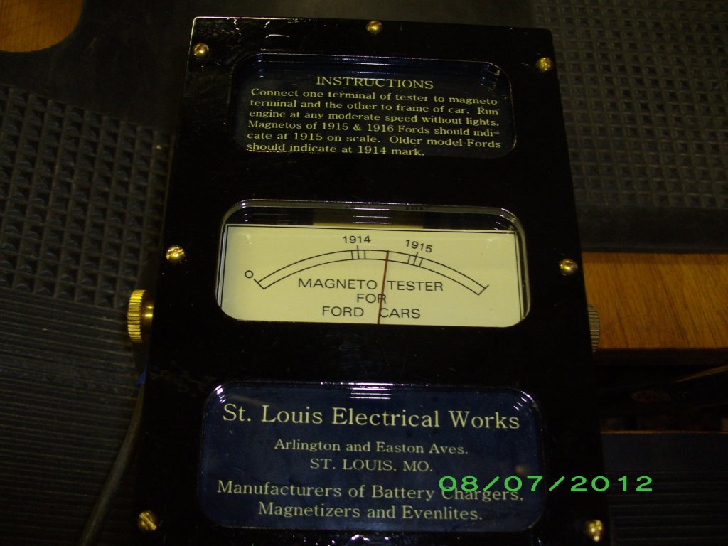

I do it nearly the same as Andre' , but with an St.Louis magneto Tester .

They started with all clean parts. Insulating the strips was done on a tool aswell as making all the coils.
Making the new coil loops should take a lot of less time as I needed to rebuild mine.
After rebuilding my first coil ring I understand the price dealers are asking for the rebuild loops. It are not the parts but the labor that makes the price.
The reason why I tried to rebuild my own coil rings are the shipping price and the locak and income taxes here in Belgium.
The final price is about the double of the prices the dealers are asking.
The second reason was the challenge to repair my own coil ring.
Andre
Belgium
To rebuild the double round in the photos it took me a total of 28 hours. About half of the time was needed to clean and make the strips and all the other parts grease free. Making the insulating shields (5 for each coil) took about 2 hours. The time left was for making the 32 single coils and assembling the coil loop.
As I understand the model T history, the flywheel and the magneto coil ring were the first to be assembled on a small assembly line starting late 1910 early 1911.
Andre
Belgium

What is important by the double coils is that you make all 16 double coils the same. You will get the left and right winding by alternating the windings as you asemble your loop by facing the ends of each coil ones up and the next down.
By the single coil coilring you have to make 8 left and 8 right coils. Easy to do this by making the inner connection strip facing to you and for the other direction the strip should face the other way.
The mandrel in the photos is working for me for more than 10 years and is easy to use and a copy of the picture I found in the MTFCA electric book.
Good luck
Andre
Belgium
Good luck
Andre
Belgium
