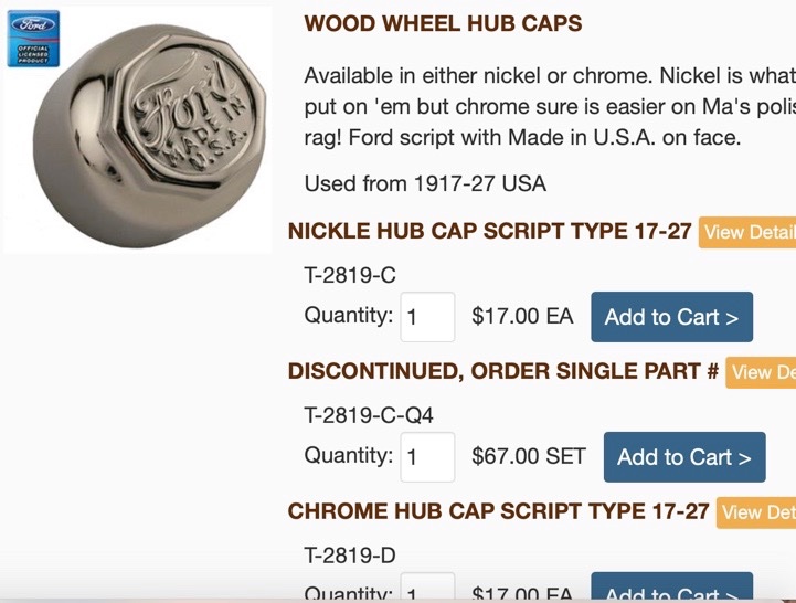

My 1921 came to me without any hubcaps. During shopping on eBay I see differences in hub caps. Which design is correct for a 1921 with Non Demountable wheels?

Nickel finish is what Ford provided on the wood hubs. Repo can be chrome or nickel, your choice.

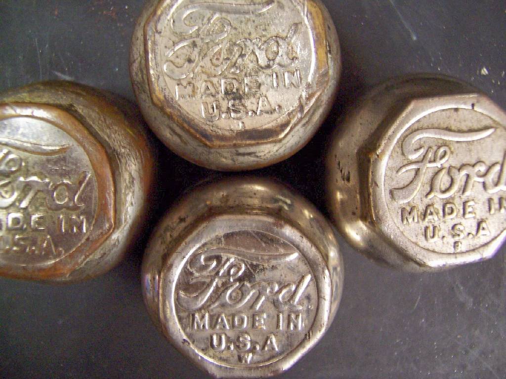

I have originals on all of my cars, but studying the changes from 1913 on is an interesting topic. I don't know when they started putting the manufactures symbol on the bottom, but I guess it would be in the early 1920's. I've been extremely lucky in being able to find NOS hubcaps at Hershey over the years, but if your are satisfied with current reproductions, they seem to be very good quality, but don't have the symbol.

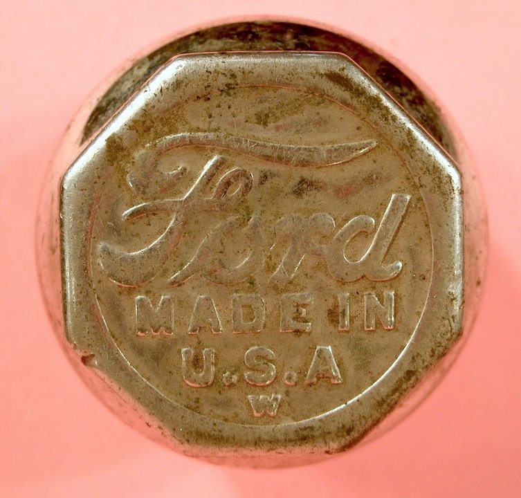

Here's one of those caps with the manufacturer's mark, in this case a W.

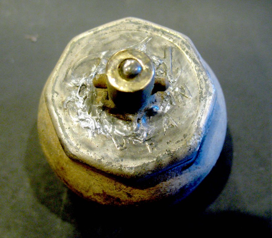

This cap with an Alemite fitting soldered in is marked R.

And along with letter marks of mfg. some are missing the "period " after U.S.A

Is there documentation/evidence that the letter on the hubcaps is a manufcturer's mark? Our Canadian hubcaps also have various letters on them, the significance of which I have never discovered.

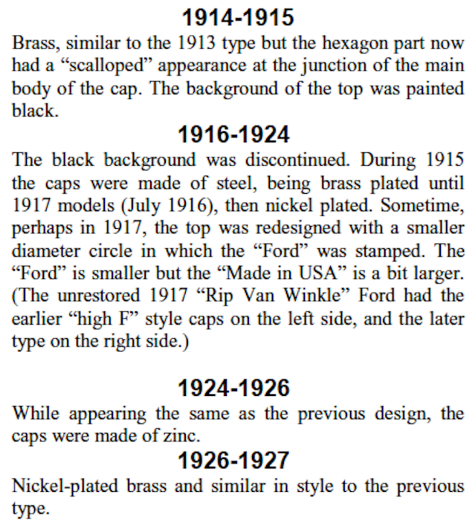

Don’t know of listing for suppliers of hub caps to Ford, but maybe not all put marks on them. Some details from club encyclopedia:
Click on image to enlarge and read

Here's some of what Bruce says about hubcaps. The encyclopedia has photos and drawings.
