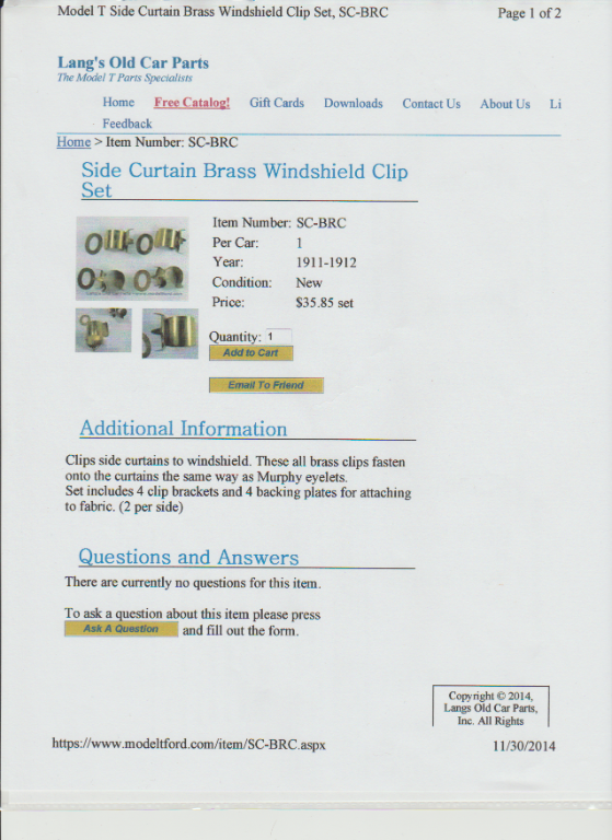

The windshield clips I got from langs repro

these are the windshield clips cheers Colin

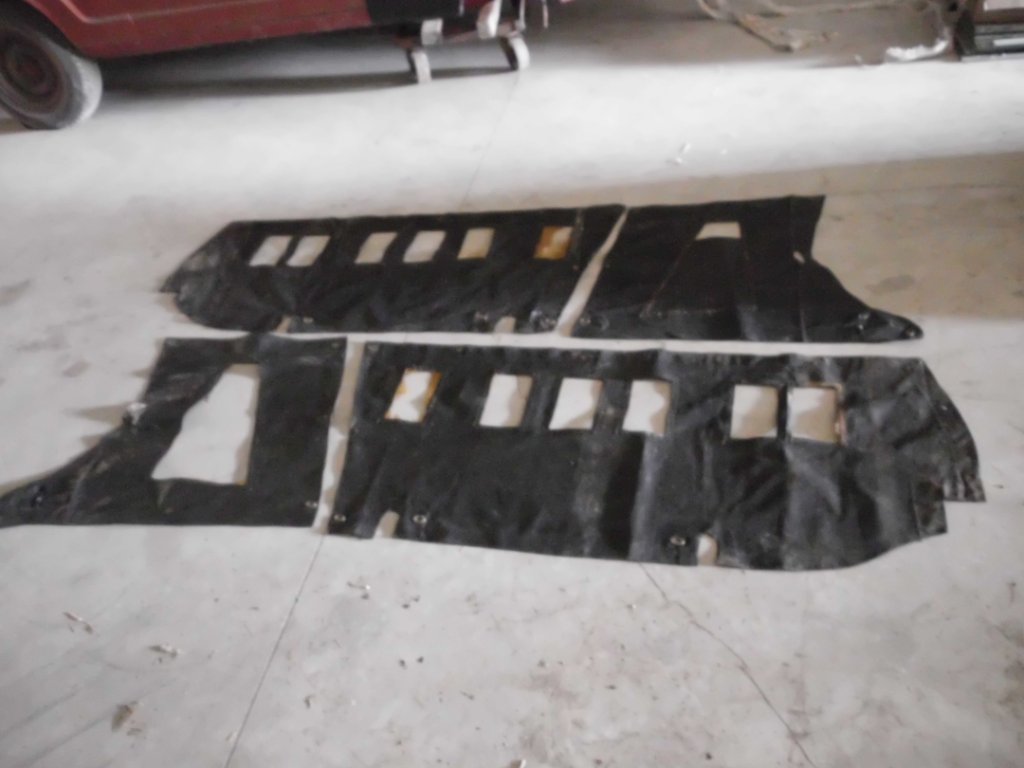

My 13 has no fasteners on the windshield but one on the firewall on each side and on the top. These are the only pictures I took after I put one side on that was under the rear seat of the car that had been parked since 1928. Someone has put black material in place of the clear on the front side window over the years back when these were in use.

The windshield clips Colin shows are no longer available from the vendors. I finally found some last year after a fair amount of searching. I was able to get the 8 I needed from the manufacturer, but that was the last of his inventory and he was unsure at that time about making more due to the difficulty of sourcing materials because of Covid.
