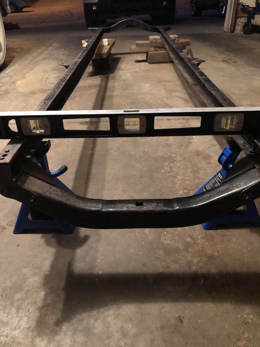

Last night, I was examining the frame for its condition. I will share my thoughts and questions, and welcome all inputs. I'm still fairly green to T's.
The first thing I did was gauge how square it was. From the naked eye, all seems fine. I put it on blocks and stands, and ran a level across it like so:
It was virtually perfectly level the whole way down. Although using a tape measure on my own was a little challenging (and lost some accuracy), the corner to corner measurements also seemed to be very even.
Is this a good way to check the frame?

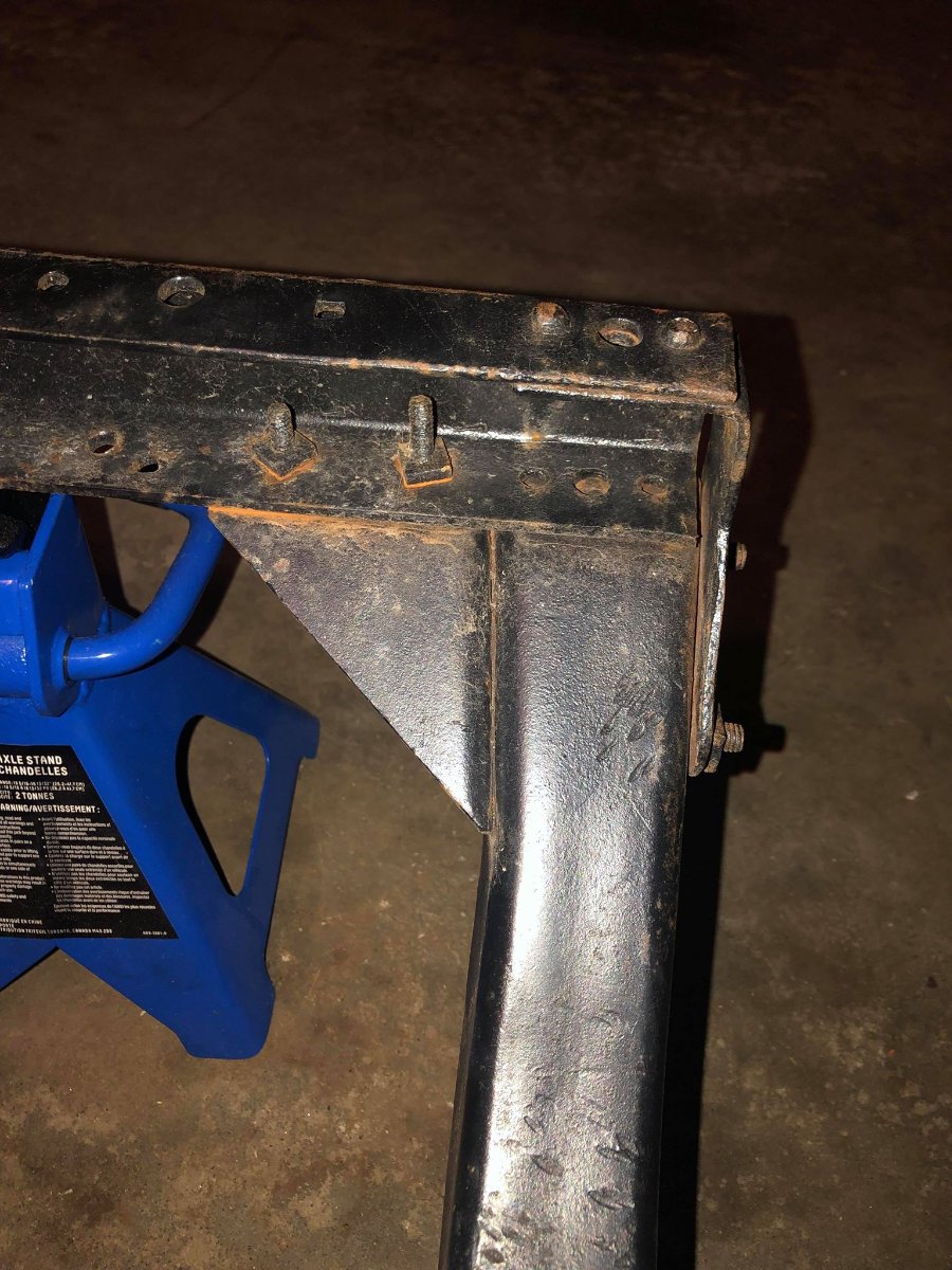

Second, the front had several screws in it, rather than rivets. Atleast one screw is missing on the driver's side that is there on the passenger side.
Passenger side: square bolt
Driver side: empty
I'm also not sure of the extra holes, and what goes in them.

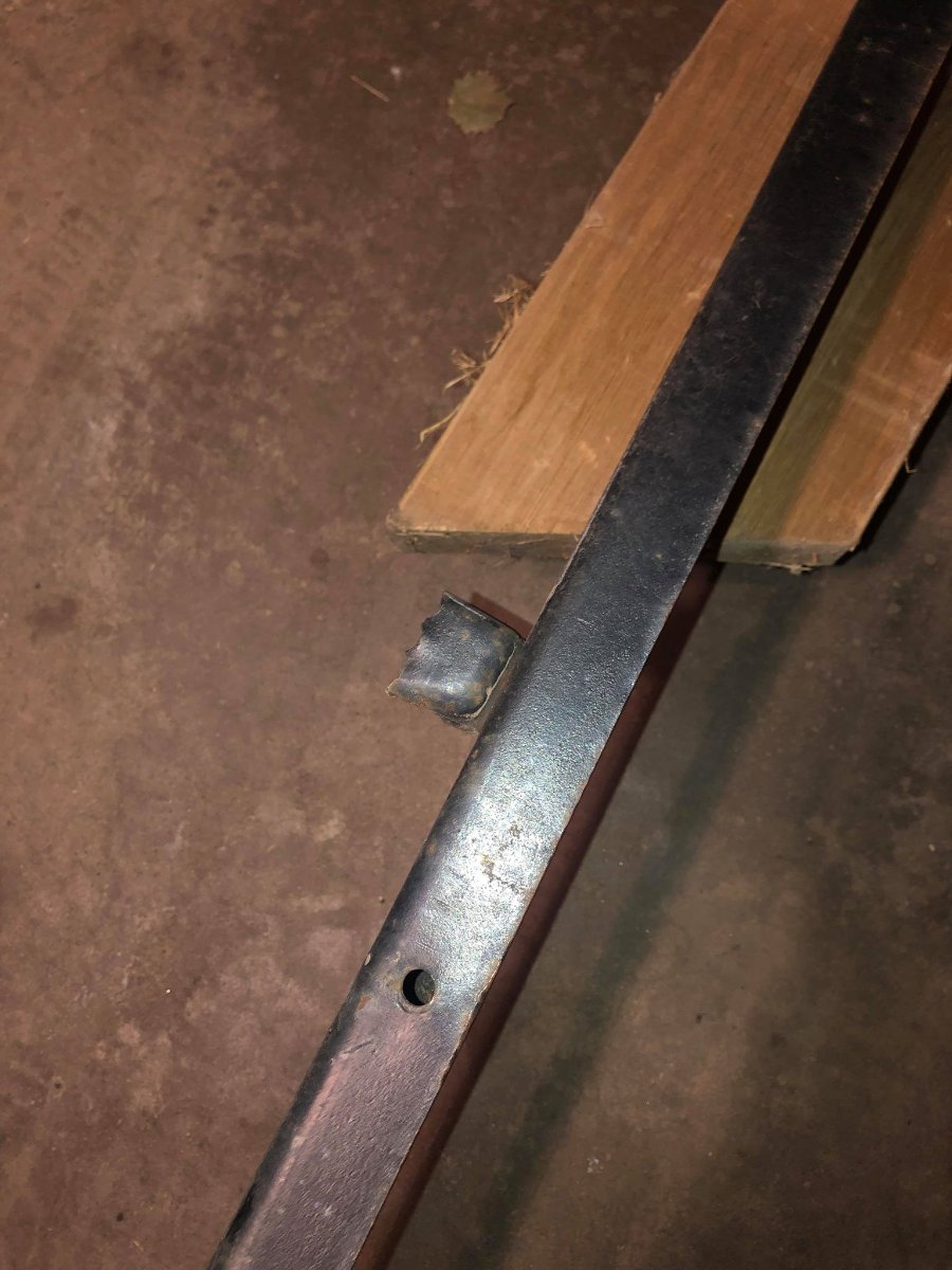

Finally, one of these four brackets is broken. What are these for? Running board brackets?

Bracket is for body mount- may or may not need it for your speedster. Beware of dips in the concrete- may look nice and level but can have dips in it.

Hi, I am doing similar with my hay wagon to speedster project. The frames are riveted, the bolts are not original. I am told that rivets are preferred for frame flexibility. The teethed item for the brake lever is referred to as a quadrant. Others have said stretch a string to check if the frame is straight on the long axis. Good luck with the project, please keep us posted.

Ryan, when you build your next speedster, there is an easier way to check whether it is out of square than using a tape measure. You just need a length of light timber and a nail. Drive the nail in the side at one end. That end of the is stick put in one corner of the frame, and a pencil mark made at the other end on the opposite corner. Then just switch corners and check against your pencil mark.If the diagonals are the same, the frame is square. This is an old joiners trick used to check any frame before gluing and clamping.
Hope this helps,

It looks like the running board irons are necessary for frame support. I'll see about locating some of those. The frame is away now (don't have the garage space), but I'll see to the other tests mentioned when I get the space again.

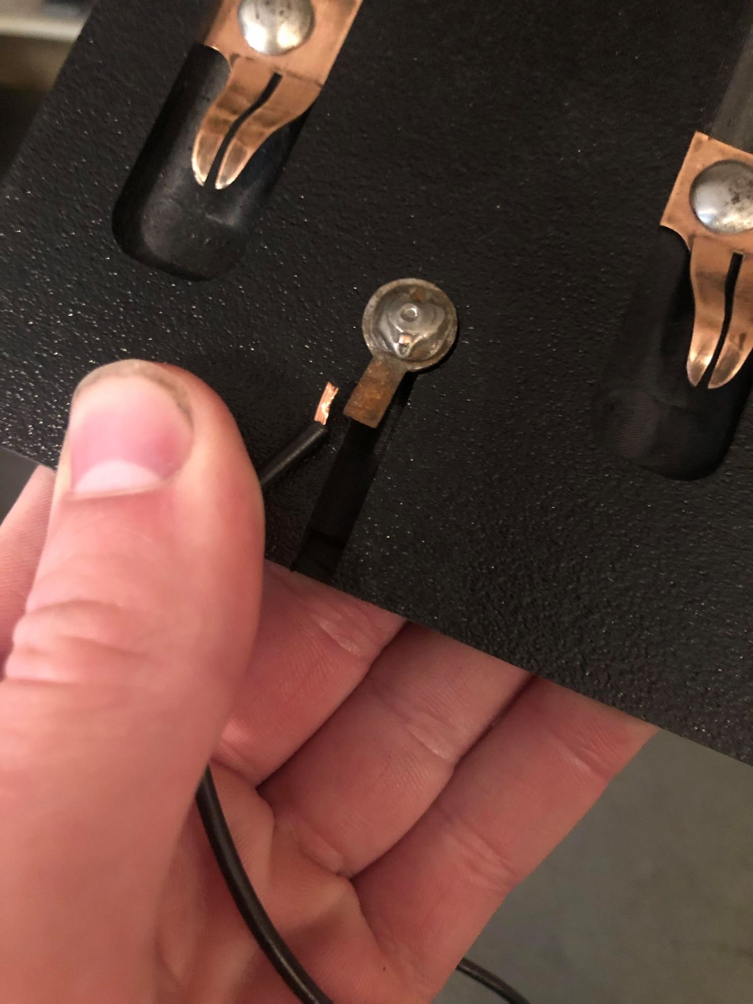

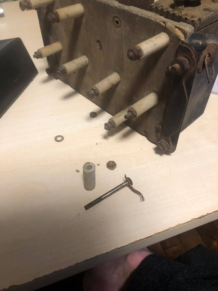

In the meantime, I have my coil box and 8 coils on hand that I want to go through and get a better understanding of. I've studied the circuitry over and over, and I'm finally starting to understand the function of the internals. Part of me wants to open up one of my coils just to see and feel all the internals to fully grasp what's going on.
I'd like to keep the coil box as weary and battered looking as possible, which involved keeping the original wood. Is there any risk of losing the functionality in the coils with old wood and the old box? I just see there are modern plastic reproductions. I'm guessing the risk is the wood getting wood, and then making contact with the brass terminals? I don't plan to get stuck in the rain, but that's happened to me in my Model A several times now, and I'd hate to do damage to a fairly exposed coil box if that were to be the case. Early Ford's that had no top could have been susceptible to the same conditions. Does anyone have experience with a rained on coil box, and the damage that it can do?
I took one of these guys off the back as well for curiosity.
Any need for replacing of the coil box tubes? Or do they provide a more important role that I'm unaware of?
In my head, a proper rebuild (in addition to the coils themselves) would be replacing the bottom contact strip, the back 8 contacts, and the coil box bolts and nuts, just to ensure proper conductivity?
Thanks in advance!

Ryan
You want a T that runs. I would recommend replacing the wood in that cool box with the plastic kit. Using that old wood will just give you problems down the road. However, keep all the other parts. They are just fine and the flexible strips inside the box are most likely the correct metal to make your coils work correctly. Just clean them up a little.

What wasn't mentioned is that the wood, even without getting wet, can develop carbon traces that short out the coils. Once assembled on a car, you can't hardly see the coil box wood, so use the modern kits. The contact strips are phosphor bronze, while some of the replacements aren't, so this is a situation where the original parts are often best.
Yes, replace those cross-member bolts with properly set rivets!

Couple of ideas for the running board supports. I cut the outer part that supported the running board off (wish I kept the first few inches to support some body. I took the flat piece and flipped it over to strengthen the top of frame - see photo. I'm planning to replace the nuts&bolts with rivets. As far as the coil box - refurbish using everything you have. As far as the wood goes - after removing all the contacts and dusting off the dirt (just the big chunks at least), I would brush on a couple of coats of Minwax Wood Hardener or equivalent. The Hardener is a plastic like liquid that would soak into the wood making it moisture proof (water proof?) and firm up the wood. If you have troubles with the wood you can always replace it later. The contacts you have are the "preferred" metal so just clean them off carefully and as a last step check for conductivity in case you left some wax residue on them .

Allen has a point. The original wood was a form of plywood (pieces of wood held together with dovetail tongue& grove joint(s) with a veneer glued to the front and back). The backs and bottoms may be warped and the veneer separates - if you decide to keep it coat with Minwax wood harder to water proof it. Your tubes, bolts and contacts look good. You need to get the fiber washers and new nuts (not worth the trouble cleaning the old nuts unless they are brass). If you replace the wood the waterproof kit is the way to go. Your coils are likely in need of $ome attention.

Thanks everyone for the input. I actually was unaware that there was a modern wood replacement. I've since bought the modern plastic, and finally went about disassembling it tonight. Boy, that would is actually quite brittle and rotten. I would've had to replace it anyways, so I'm glad I splurged and bought my plastic repair kit. With buying that, I almost doubled my entire investment in my T!
Regarding the conductivity of the bolts, contacts and contact strip. Is there any harm in letting it sit in a rust remover solution? Everything just has minor rust around some of the threads. There is really no serious damage anywhere. I can't imagine soaking in a solution would cause any detriment. I'm just wondering if people swear by the hand polishing/emery cloth method and why.
I also can convert my desk from school work to small workbench very quickly! I love having this in the next room, rather than going to the garage as the days start to cool off drastically over here :)
Posts: 6373
Re: Basket Case Speedster Build Thread
Post by TRDxB2 » Wed Sep 02, 2020 11:40 pm
ryanf1023 wrote:
Wed Sep 02, 2020 11:27 pm
Not sure what your bolts are made of. May be brass or copper coated and had steel nuts. In any case if i ts minor rust I just use a wire brush on a drill or dremmil tool. If yousoak them < 1/2 hour is all that's needed and then you still may need to brush off the residue
RustyFords
Posts: 1559
First Name: Don
Last Name: Allen
Location: Houston, TX
Post by RustyFords » Thu Sep 03, 2020 3:18 pm
I bought the resin kit and it made a big difference. My original box was pretty rotten as well.
I just wire brushed the contact areas with a little Dremel tool wire wheel and left the rest alone.

when I rebuilt my coil box, i used new bolts and nuts and put silicone greece in between all electrical connections. also, I used a wire wheel and a buffer wheel to clean up those brass contacts.

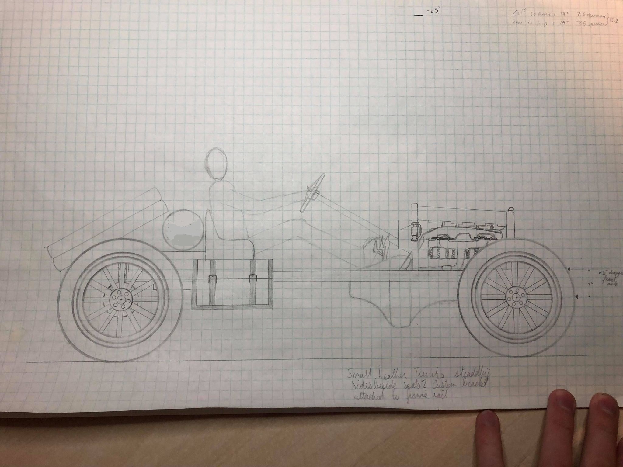

I've done a few mockups for my eventual speedster, and this one has been my most recent scale draft.
I'd like to lower as much as I can, but I know that comes with problems.
1) Potential tie rod, radius rod, etc. interference
2) drain plug (lowest point of clearance..?) can get low to the ground
The number I have in my head is 3", simply because that's the lowest that Nostalgia Sid drops T axles. I've only heard good things about Nostalgia Sid on this forum which is why I have that in mind.
I'm asking for recommendations on axle dropping, but mainly if 3" is an overkill, and if so, are they for the reasons listed above or for something else?

Sid's dropped axels are great. I have a 2 inch and 3 inch drop, both stretched. Make sure you get a dropped and stretched axle so the kingpin to kingpin is stock T measure, that way you can use a stock tie rod. If you want more drop thain the 3 inch you can use 1926-27 T spindles to get another 1/2 inch drop. More front drop can be added over this by using a 1926-27 front spring because of its lower crown thain pre 26 spring, about 3/4 of a inch lower. Next a reversed eye front spring will add another 1 inch drop. All this drop is over 5 inches so make sure you plan out your rear drop, lower crown spring, reversed eye, Zd frame, etc. You may decide that the 3 to 4 inch drop is fine for you., it all depends on your overall build, more drop would be OK also.

After looking at your drawing I should have added to make sure that your tie rod and steering drag link clear your engine pan. You should be OK with a 3 inch to 4 inch drop. I am assuming that you are going to use a 1919 or later front wishbone that mounts under the axle.

Kevin, you are correct in assuming I'm using the under-axle wishbone. If nothing else, the safety issue with the over-axle is the main reason why. I would like to lower as much as I can, barring any drivability/safety issues. I'd hate to hit a huge bump in the road and have my drain plug scrape and get ruined, or have any piece bearing an abnormally large amount of stress.
For the rear, I was going to start with removing some leafs from the spring, especially as there will be very little weight near the rear of the car. Reversing the eye is something I didn't consider much, mainly as I don't have the skill set...yet. Trying new things and learning new skills is kind of the point of speedsters, though, isn't it?

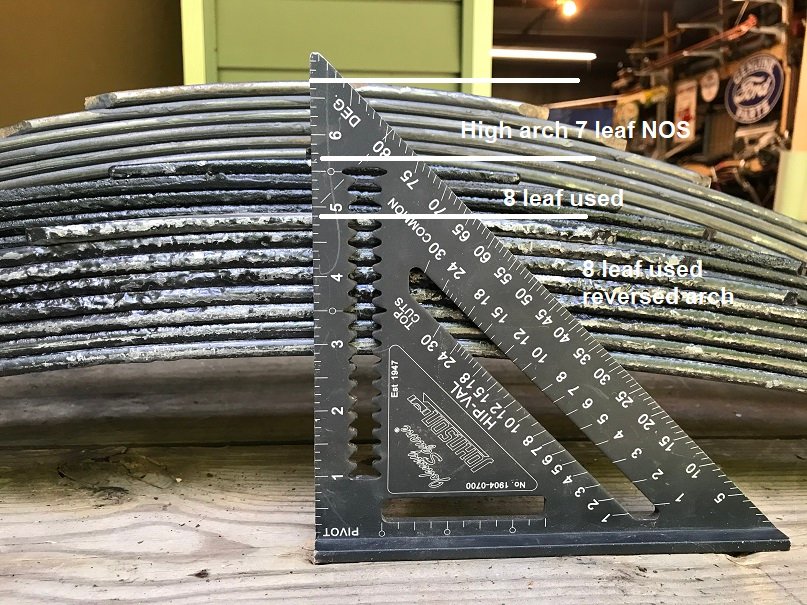

This is a most important point, so don't get ahead of yourself. As stated you need to watch out for the tie rod and/or drag link interfering with the radius rods and pan. So do the math first before you spend. Having said that, you need to determine what your use and/or replace. For example are your starting with a high arch 7 leaf spring or low arch.
Here are some height differences for different spring configurations
So what components do you have now for an axle, front spring and spindles. If your axle isn't in good shape and needs work (needs new bushings, isn't straight etc) may as well get the dropped axle. Its likely your spring is in good shape but which is it?
I successfully reversed eye my front spring (should be called re-arched ) following this video. https://www.youtube.com/watch?v=ldwUHFBwN7o If you planning a speedster that would be lighter than a Model T could be an option http://www.mtfca.com/discus/messages/118802/166494.html

Frank, I actually had no idea of the different springs and arches. Mine is currently stored away behind the shed, so I'll have to come back to this and check when the time comes.
In the meantime, I've almost finished the coil box. I'm amazed at how effortlessly the points clean up with a bit of emery cloth. Though, the carriage bolts have no square notches to fit in on the plastic rebuild kit. Perhaps this is a case of having to do more work to remanufactured parts before they're ready. Hopefully I can started on the coil ring before the end of the week.

Ryan, the square under a carriage bolt head is there to hold the bolt steady while the nut is tensioned. The square pulls into the medium into which it is fitted. This may be easier in wood rather than the plastic used in the kits. When I fit the kits, I fit the contacts before fitting the panels to the box. That way the bolts can be tapped home in the round holes, prior to fitting the porcelain insulators, thus not relying on the the nuts drawing the bolt in, and he load applied possibly crushing the porcelains.

The old insulators virtually disintegrated when I took the nuts off the porcelain. I almost forgot about them until I was using emery cloth to clean the nuts, until I unintentionally disintegrated one on the cloth. Are these things I need to replace?
I have this small piece left over. It's got a square hole, so my first thought was for the bolt that provides power from the magneto/battery.
However, the head of the bolt gets soldered onto the wire for the bottom strip, correct? The plastic kit is also grossly undersized for it to fit, whereas it had plenty of room in the old wood box.
I don't know how the magneto/battery connects to this bolt from the back. It surely can't be that different from the connectors to the spark plugs/ground? It doesn't go here, does it? It wasn't on the back when I took the box apart.

Ryan, both the battery and magneto connections are soldered to the strip in the bottom of the coilbox. From there the wires follow a groove in the underside of the base timber/plastic. These grooves meet with corresponding groves on the inside of the back panel, and the wire follows that groove to the terminal bolt. The little terminal you have is likely used on one of those. The same effect can be had by soldering the wire directly to the bolt head.
The porcelains can be quite fragile, and may well have been cracked before you started working on them. The earlier glazed ones were more robust. I have 14 later ones put aside to select 10 good ones for a box on which I am presently working.

Another question. For carrying spares for wooden fellow non-demountable 30x3.5 clinchers, did period practice involve carrying an extra tube (inflated?) and rim as well? I figure for non-demountables, the extra rim doesn't provide much use, correct? That's why some early cars carried a spare wheel as well. I'd like to carry a spare obviously, I just don't want to forget anything needed for non-demountables.

Your speedster drawing shows two spare tires
mounted on the back deck. The car looks nice and period correct like that. Yes you can keep each spare tube in the spare tire partially inflated, I have used about 10 psi for rubber stems, metal stem psi might be different, I don't know on that. Make sure you have room to carry tire irons and supplies to change tire on the rim. You can make leather straps and footman loops to mount the spairs to the deck. Note that the USA cars used 30 x 3 inch tires in the front and many speedsters build in teens kept these wheels on the front because they used what they had. Your car project is going great, enjoy your build .

Just some food for thought. This is a 4” dropped axle using 26-27 spindles. They use early straight spindle arms. This places the tie rod above the upper wishbone and right below the engine pan. When you drop an axle 4”, you narrow the track slightly. And with the tie rod to long, you are now able to drop the tie rod in the area under the pan making it shorter to work with the axle. This car used a stock tapered leaf front spring so it will have full suspension travel.

Fellows, some food for thought. With a 5" drop at the front, the spindle height will be that far above its usual position. Any shock to the front end will have a far greater rotating force on the front axle than was ever the case on the standard configuration. While an under axle wishbone is usually the better choice, I wonder if an over the axle type may be better in this situation. Its mounting will be much closer to that of the standard under axle job in this application. This is one area where perhaps both should be fitted.
Ryan, when trying to organise the steering geometry under the motor, keep in mind that the bent spindle arms on the later cars can be swapped from side to side to allow the bend to go down rther than up. This may help getting things to clear.

I don't know if I'd venture to drop the car much lower than 3"-4". I'd like to keep the geometry as simple as I can relative to the increase in drop height. I have been mindful of wishbones as well. I've considered using both, Allan. Am I correct in thinking that two wishbones equates to more rigidity/safety? I imagine that either wishbone would pickup the same amount of stress if it were to be fitted solo. Surely it's that simple?
