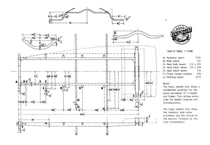

This is a diagram of a 1926 frame has some slight differences from '22 - '25. Like wider rear cross member and extra bracket 'E'. Your broken bracket, is B, used to hold the 'body' to the frame via another  bracket. But for a speedster you'll likely use it to hold the floor platform to the frame. Your missing the two cross members used for the running boards (top of picture) and to stiffen the frame and keep the frame rails parallel.

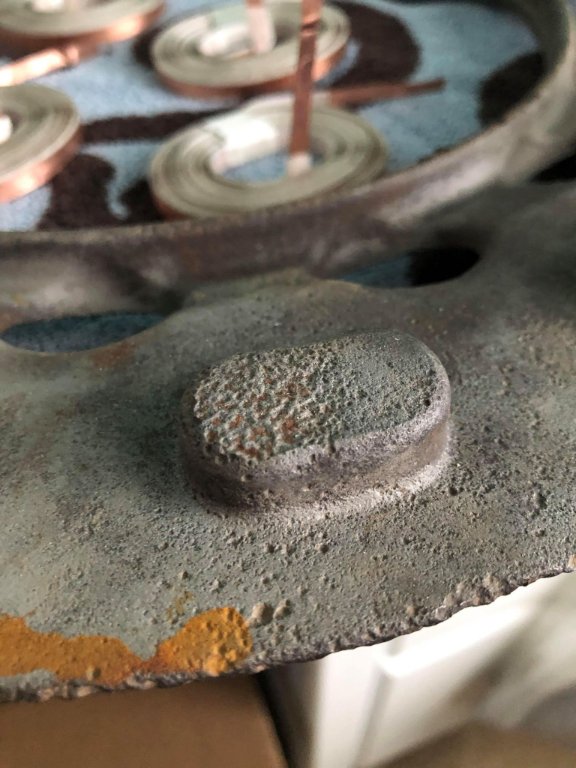

In the meantime, I have my coil box and 8 coils on hand that I want to go through and get a better understanding of. I've studied the circuitry over and over, and I'm finally starting to understand the function of the internals. Part of me wants to open up one of my coils just to see and feel all the internals to fully grasp what's going on.
I'd like to keep the coil box as weary and battered looking as possible, which involved keeping the original wood. Is there any risk of losing the functionality in the coils with old wood and the old box? I just see there are modern plastic reproductions. I'm guessing the risk is the wood getting wood, and then making contact with the brass terminals? I don't plan to get stuck in the rain, but that's happened to me in my Model A several times now, and I'd hate to do damage to a fairly exposed coil box if that were to be the case. Early Ford's that had no top could have been susceptible to the same conditions. Does anyone have experience with a rained on coil box, and the damage that it can do?
I took one of these guys off the back as well for curiosity.
Any need for replacing of the coil box tubes? Or do they provide a more important role that I'm unaware of?
In my head, a proper rebuild (in addition to the coils themselves) would be replacing the bottom contact strip, the back 8 contacts, and the coil box bolts and nuts, just to ensure proper conductivity?

You want a T that runs. I would recommend replacing the wood in that cool box with the plastic kit. Using that old wood will just give you problems down the road. However, keep all the other parts. They are just fine and the flexible strips inside the box are most likely the correct metal to make your coils work correctly. Just clean them up a little.

What wasn't mentioned is that the wood, even without getting wet, can develop carbon traces that short out the coils. Once assembled on a car, you can't hardly see the coil box wood, so use the modern kits. The contact strips are phosphor bronze, while some of the replacements aren't, so this is a situation where the original parts are often best.

Allen has a point.  The original wood was a form of plywood (pieces of wood held together with dovetail tongue& grove joint(s) with a veneer glued to the front and back). The backs and bottoms may be warped and the veneer separates - if you decide to keep it  coat with Minwax wood harder to water proof it. Your tubes, bolts and  contacts look good.  You need to get the fiber washers and new nuts (not worth the trouble cleaning the old nuts unless they are brass). If you replace the wood the waterproof kit is the way to go.  Your coils are likely in need of $ome attention.

I bought the resin kit and it made a big difference. My original box was pretty rotten as well.
I just wire brushed the contact areas with a little Dremel tool wire wheel and left the rest alone.

when I rebuilt my coil box, i used new bolts and nuts and put silicone greece in between all electrical connections. also, I used a wire wheel and a buffer wheel to clean up those brass contacts.

Your speedster drawing shows two spare tires
mounted on the back deck. The car looks nice and period correct like that. Yes you can keep each spare tube in the spare tire partially inflated, I have used about 10 psi for rubber stems, metal stem psi might be different, I don't know on that. Make sure you have room to carry tire irons and supplies to change tire on the rim. You can make leather straps and footman loops to mount the spairs to the deck. Note that the USA cars used 30 x 3 inch tires in the front and many speedsters build in teens kept these wheels on the front because they used what they had. Your car project is going great, enjoy your build .

Attached are more photos of the ring. Do the tops have to be perfectly flat in order to function, or just ground level (if necessary) in relation to each other to ensure the magnets will rotate with a uniform gap?
- Posts: 6950
Re: Basket Case Speedster Build Thread
Ryan, if you can't find a less pitted plate, that one will do. I would leave the finishing of the poles till everything else is done. Tape the coils, fit the insulating washers to the plate, fit and connect the coils, have it all varnished, and then have it ground flat. A machine shop with a flywheel grinder can do this. This will also remove any varnish from the poles and ensure they are all the same height.
This will give you a head start when setting the magneto gap.
