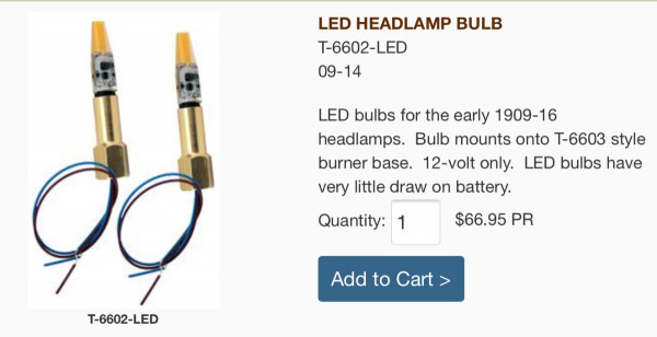

I would like to convert my acetylene headlights on my Model T to LED headlights. I found some nice halogen bulbs that mount directly onto your burner base at Langs. https://www.modeltford.com/item/BL-H.aspx Unfortunately, I don't have enough power to drive the halogen lights so I am looking for the equivalent option that uses LED bulbs. Several people have commented about LED replacement bulbs for gas headlights, but I can not find them. Does anyone know where I can buy some???

Re: LED Bulb replacement for acetylene headlights

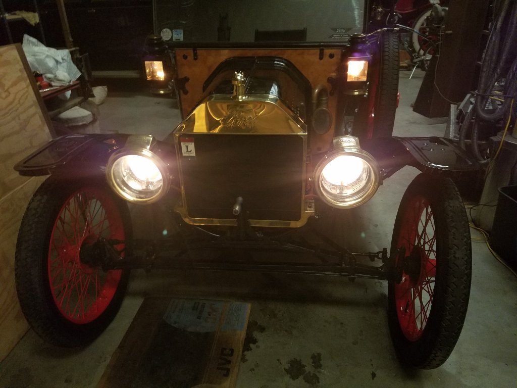

I’m using these from Snyder’s on my Mack.
PN: T-6602-LED
https://mtfca.com/phpBB3/viewtopic.php? ... 69#p136869
They are pretty decent, but 12v not 6.
PN: T-6602-LED

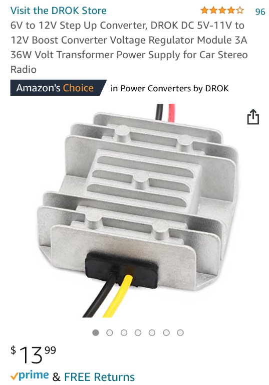

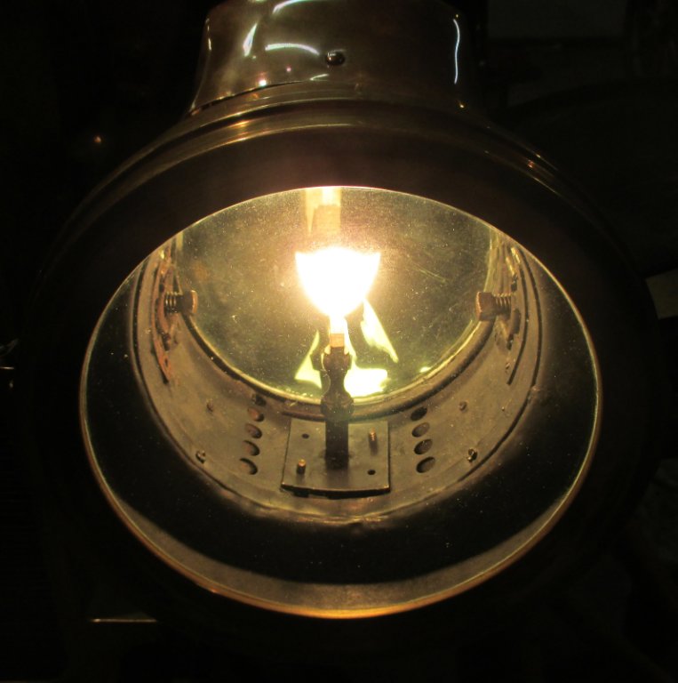

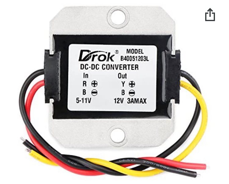

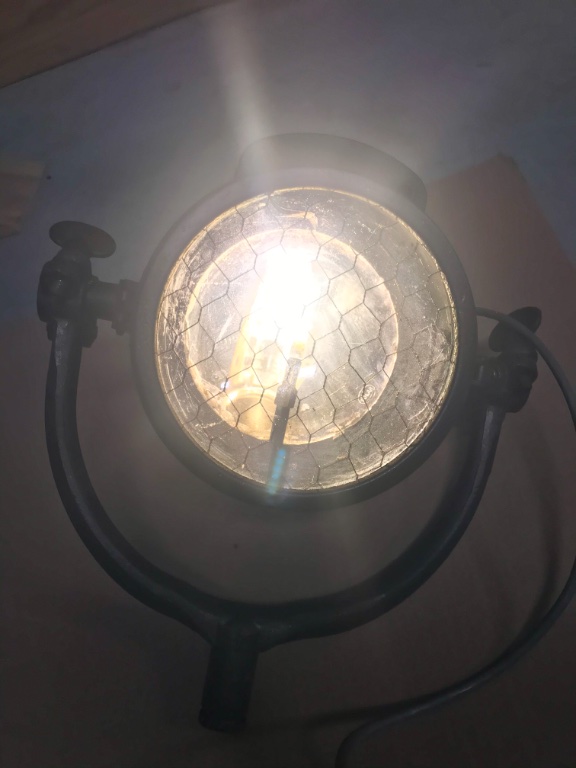

For what it’s worth -
Had one of these laying around and never used it on the T,
but thought I’d try to fire up one of these led conversion bulbs. 6v would not pass the start test, but these have no problem lighting them up.
Don’t know how much each lamp draws, but 3a might handle 2 if you must stay with a 6v system.

I contacted Snyders today and they have T-6602-LED in stock....so I ordered some. I will be running a 12 volt system so these should work well. When I get the new LED lights I will run some tests and report my results.
