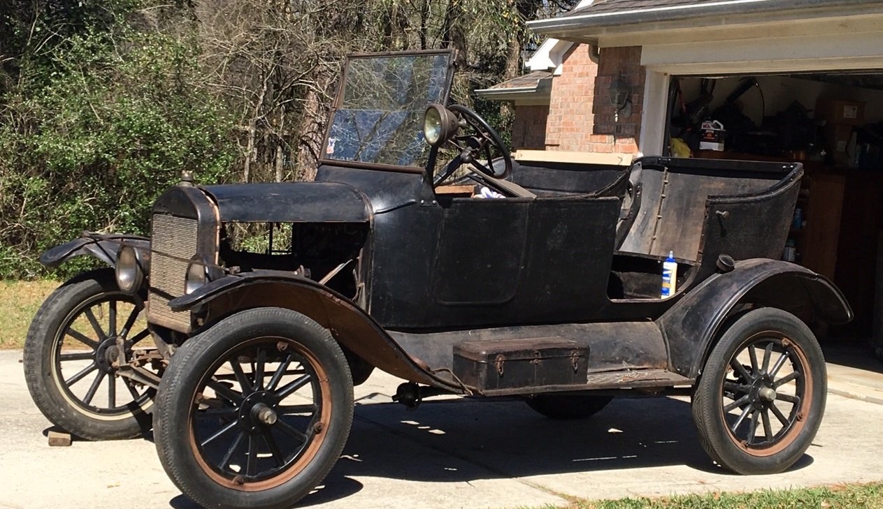

New year, new forum software, new Build Thread page for my 24 Touring.
I am confident that this is the year that I'll return the old girl to the road.

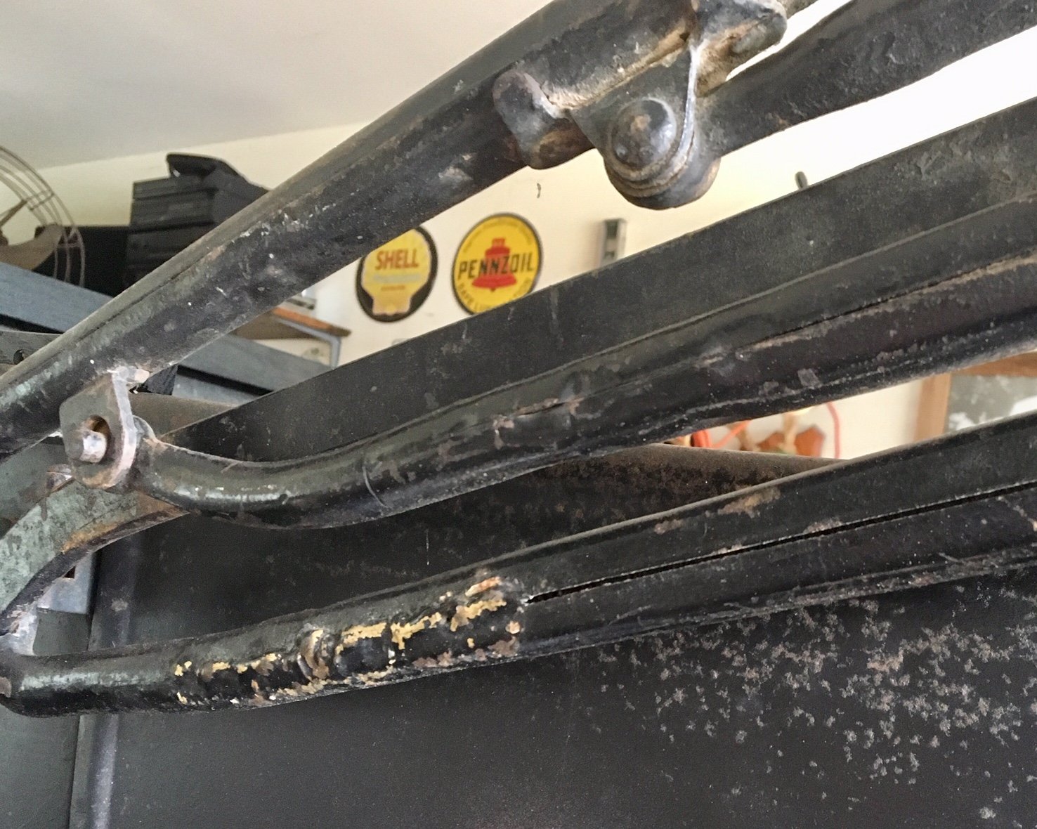

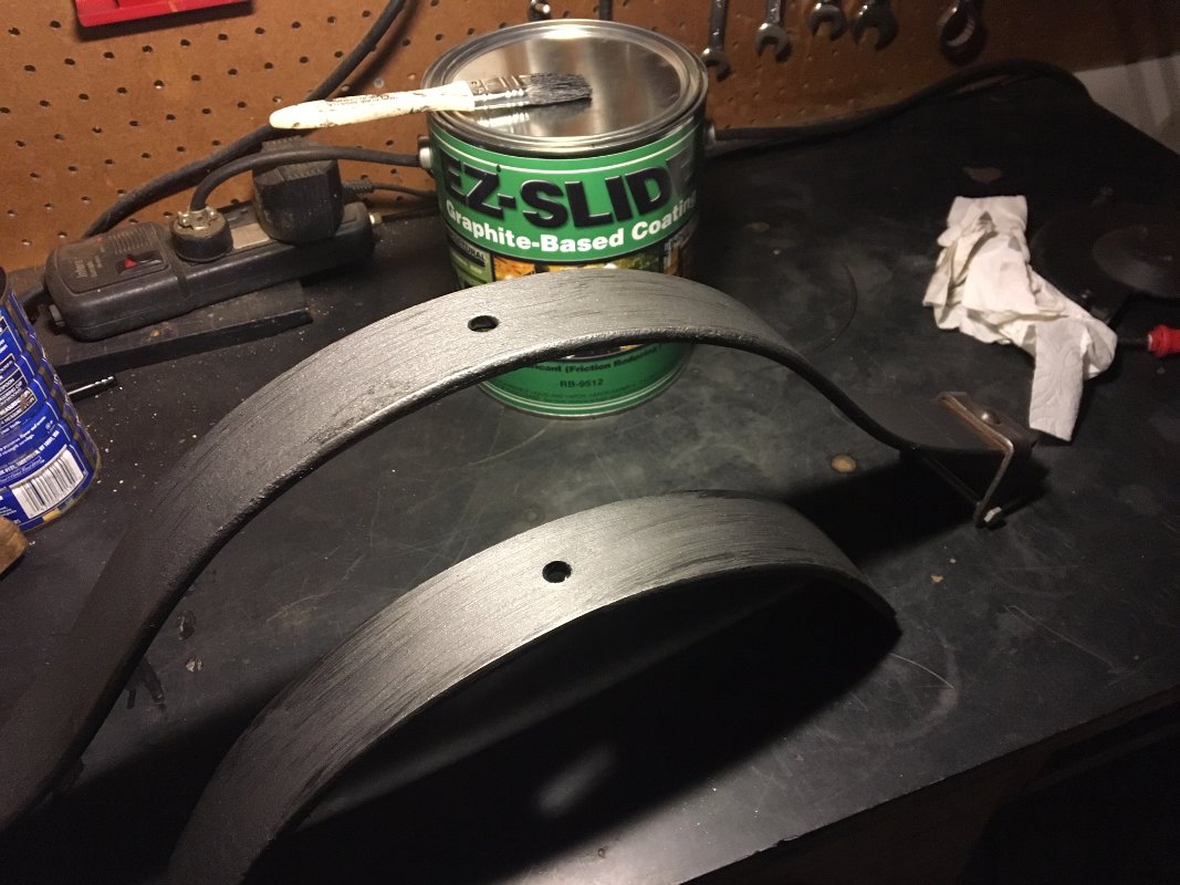

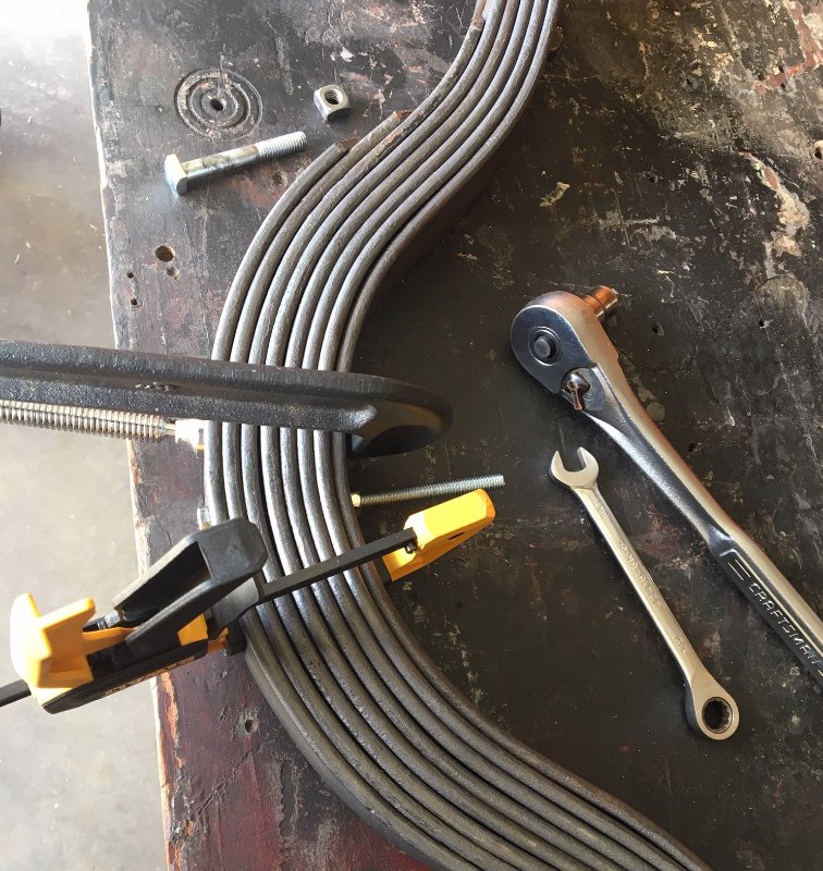

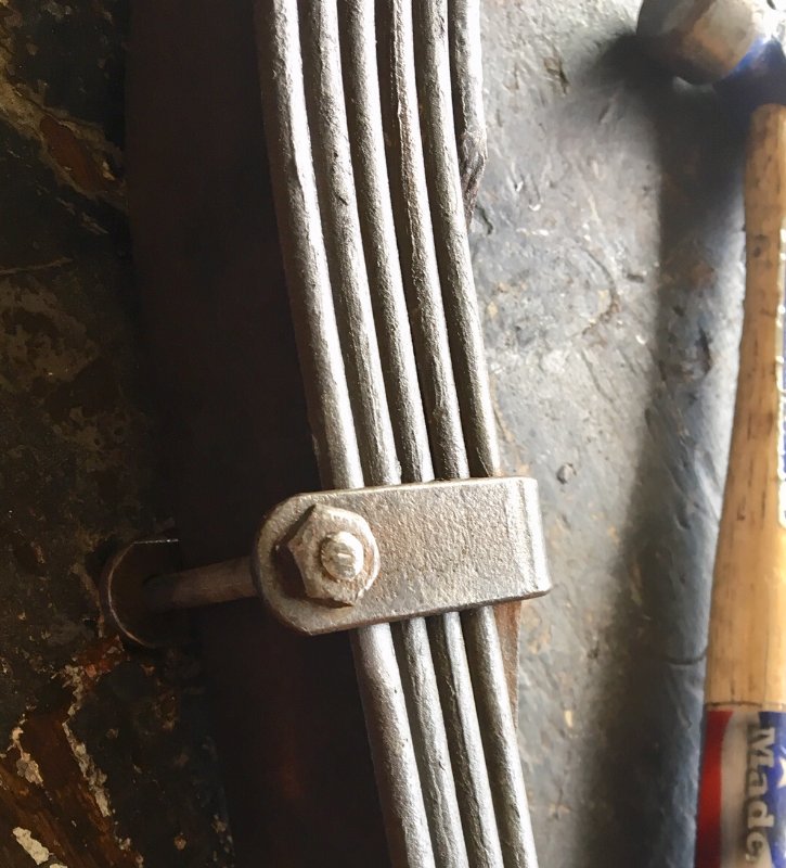

Yesterday I made a big push to get the rear springs done. Cleaning them up on the wire wheel was nasty work and left me covered in dust...looking like a coal miner. I don't mind getting that filthy occasionally, but I figured I'd limit it to just one day this weekend.
Here's how it went:
I finished cleaning all the leaves late last night then I painted them with graphite paint. I've never messed with that stuff before. It's pretty neat. I might paint the underside of my mower deck with it. If anyone in the Houston area needs some, let me know. I'll never use the gallon that I have.
They were dry this morning. I installed new bolts in the clamps. The old weathered nuts from the original set were in good shape and cleaned up nicely so they got re-used. My practice with this car is, if it's sound, safe and re-usable, it gets re-used...even something as small as a nut.
Then I installed the main bolt that holds the whole set together. I didn't have the strength to clamp down the whole set enough to get the main bolt started so I used another long bolt to press them together, then clamped them, then removed the long bolt and installed to correct bolt that I got from Langs.
I then cut off the excess bolt material and peened the clamp bolts and the main bolt. It'll now get a coat of flat black. I need to install new bushings and new grease cups and then it'll be ready for installation.
Here's how it went:

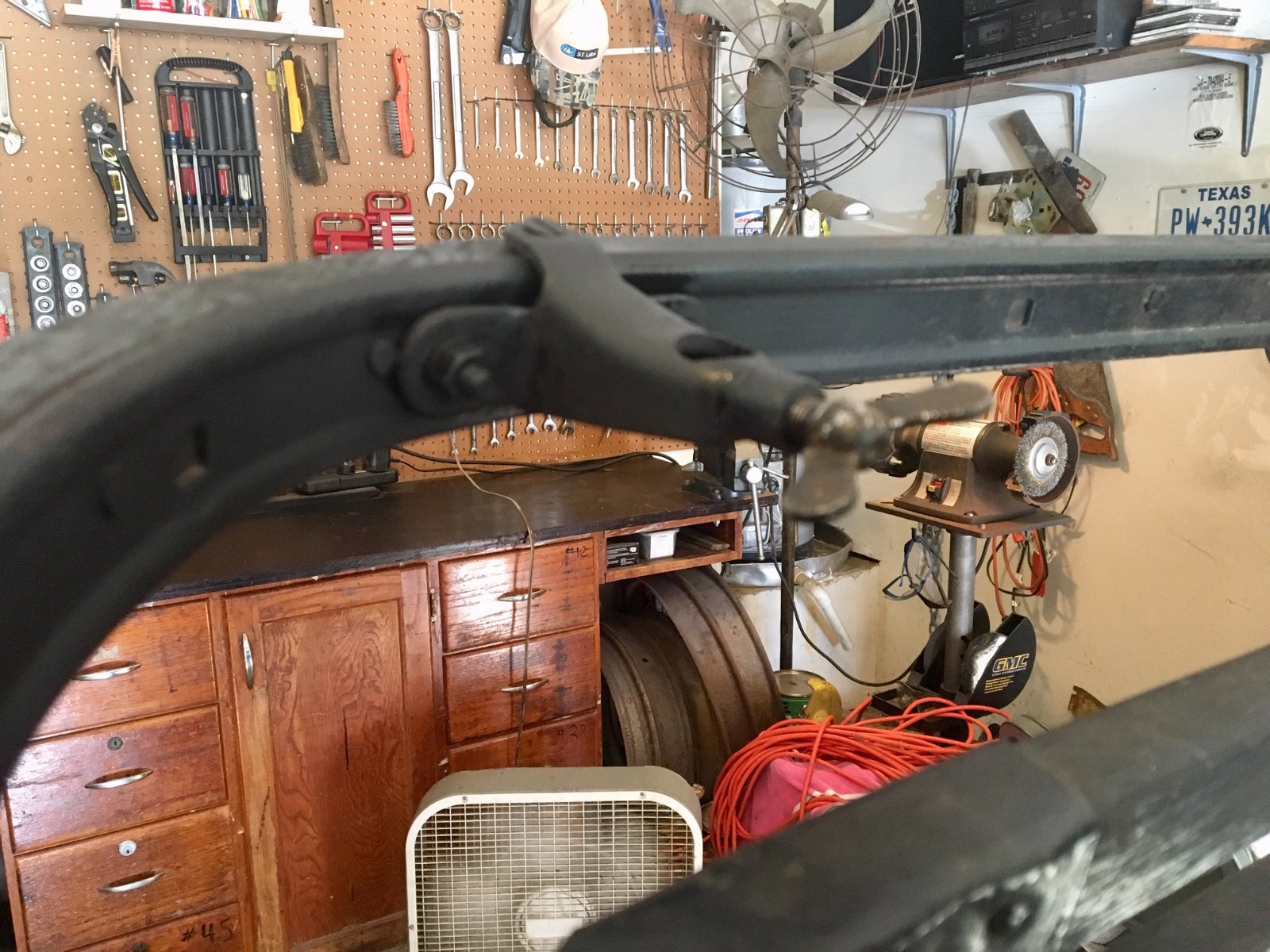

Re: 24 Touring Barn Car Revival - Part 3

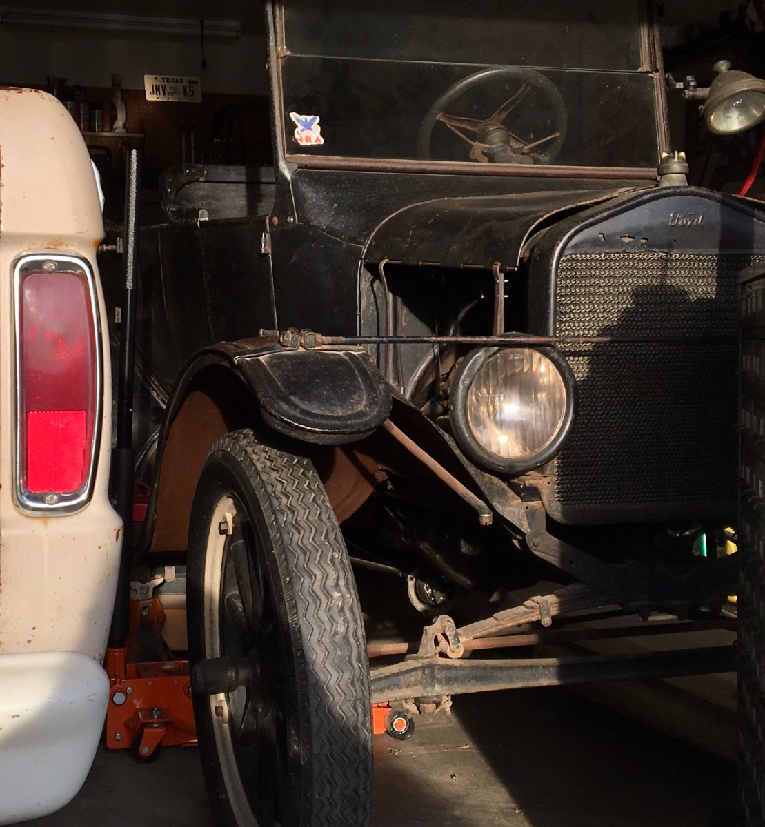

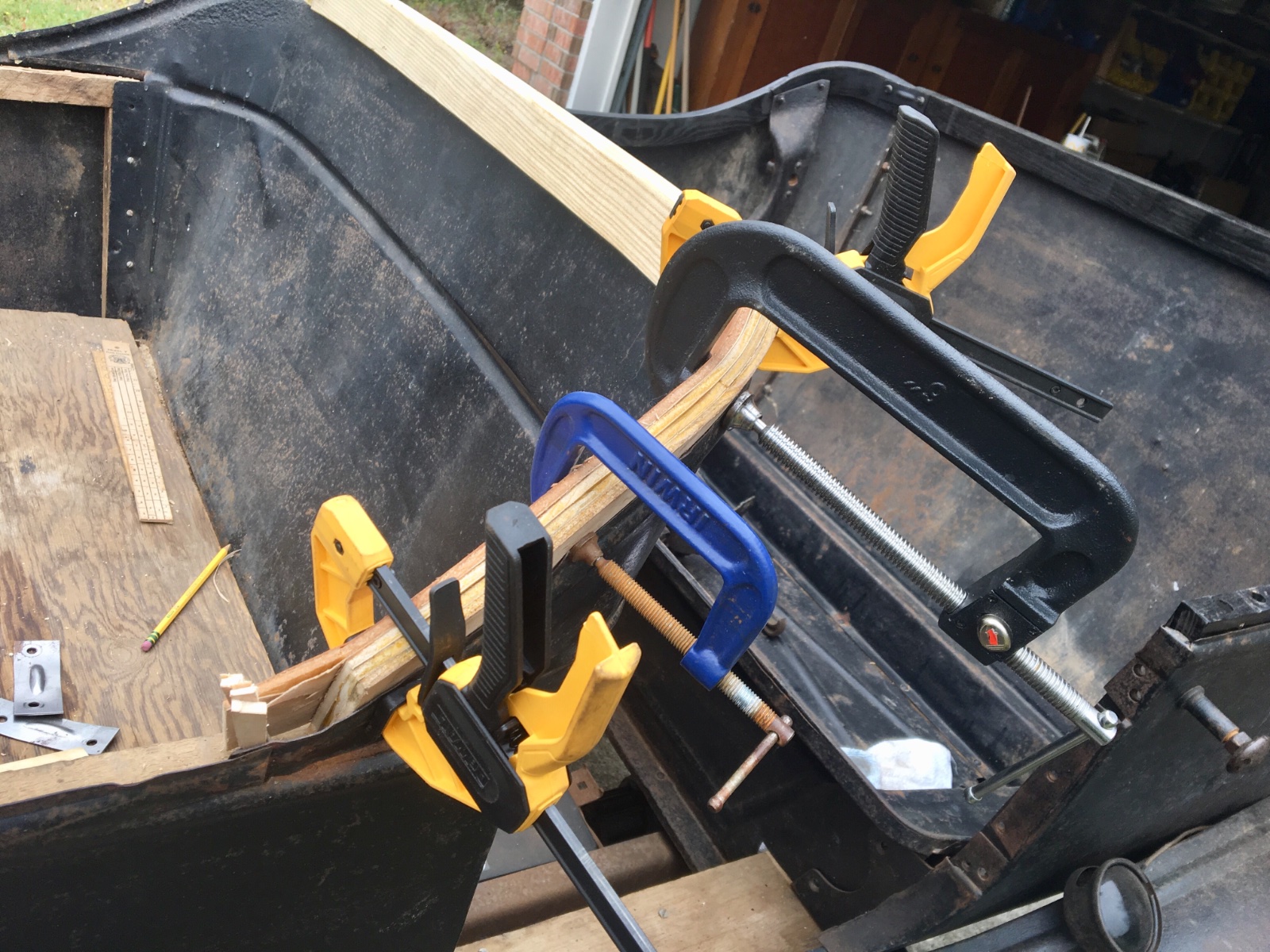

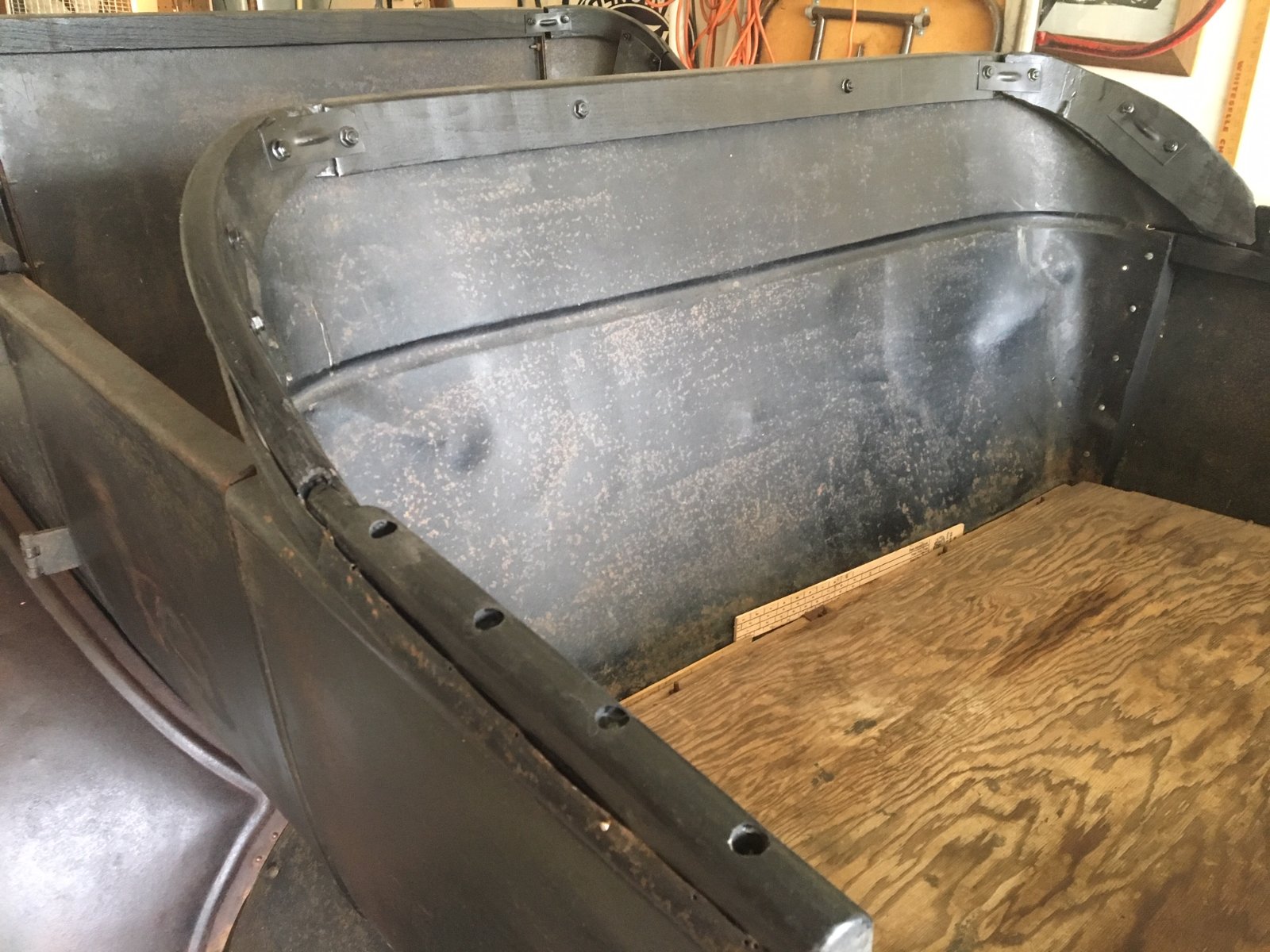

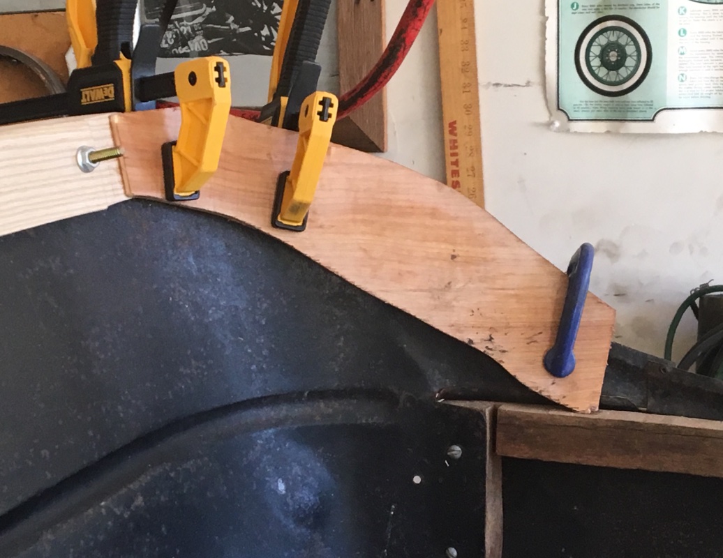

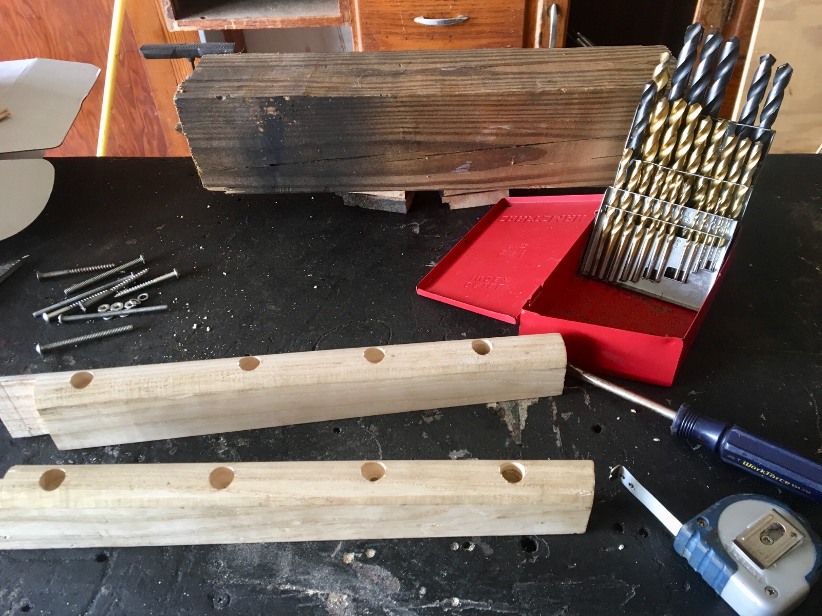

I wrapped up the day by continuing the tack rail project. I’m building the driver’s side curved piece out of plywood laminate like I did the other side.
I also installed the brake drums on my “new” wheels.

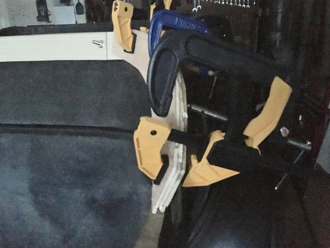

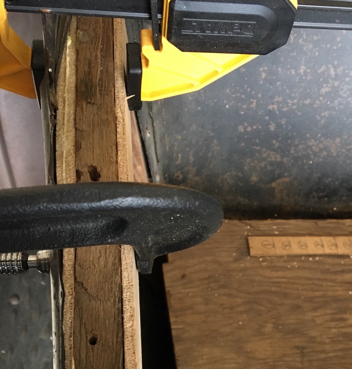

Had just a few moments after work, before I ran out of sunlight so I glued another layer down on my plywood laminate corner section of the tack rail.
Hopefully, this coming weekend, I'll be able to wrap up the tack rail project.

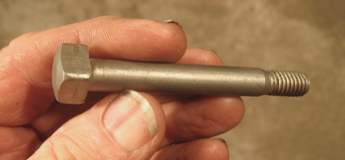

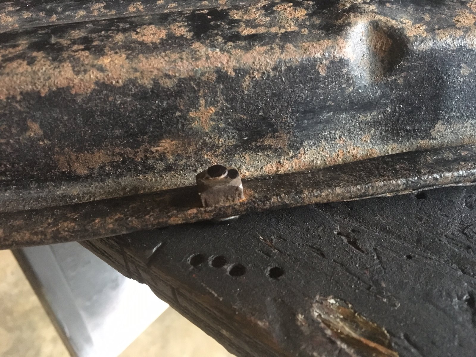

The spring bolt I got from Langs was rather disappointing.
Beside the remains of an original bolt it's obvious that the head is much too short. It's just a generic square head hardware store bolt. The head should be tall enough to fit into the hole in the frame and keep the spring from wandering.
This is the NOS bolt I got from Bob Bergstadt.

Wow Steve...that is a huge difference. Thanks for clueing me in on that.
I'll contact Bob to see if he has another one.

Good to see the original style bolt is available. I found a good original in my pile of parts for my 21 touring. I was about to cut the head off another bolt to weld on the head of the standard head bolt to make a thick one which would work but then I found the decent original.

The later center spring bolts didn't have as high a head as the early ones did. I have no idea when the change occurred. Also, the two spring clips used on each side have a special square head, and use a 1/2" across the threads jamb nut, which is used in various places on the late T's.

Bob B has a new center bolt in the mail and Lang's has a new u-joint and pin, and new bushings in the mail as well.
That'll be everything I need to re-install the rearend/torque tube/driveshaft. The items won't be here by the weekend
but I'll get it done as soon as possible.

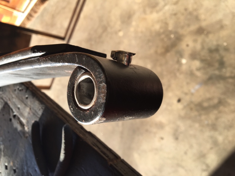

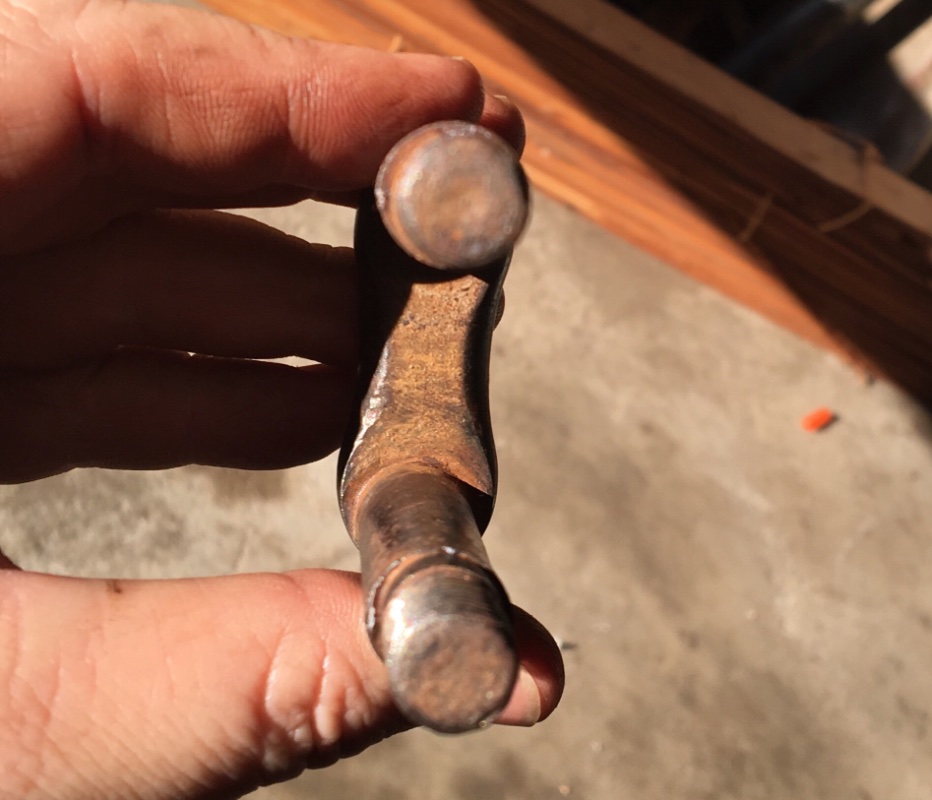

New bushings and grease cups in the rear leaf springs.
I was ready to install my old shackles but immediately noticed that they’re way too worn to use. Looks like I have another purchase to make before I can install my rebuilt rearend assembly.

Don, I don't know which is correct, but I find it easier to oil the shackles if the hing on the lid is to the outside of the car. The spout on my oilcan lifts the lid and holds it open while I squirt. I can't get it in with the orientation at which you have yours set. Much easier to fix before the spring is fitted.

Good point Allan....thanks. I think the process of twisting the little bugger around might destroy it, but I bought a whole bag of them. So...I'll give it a go during my next "Model T therapy" session.

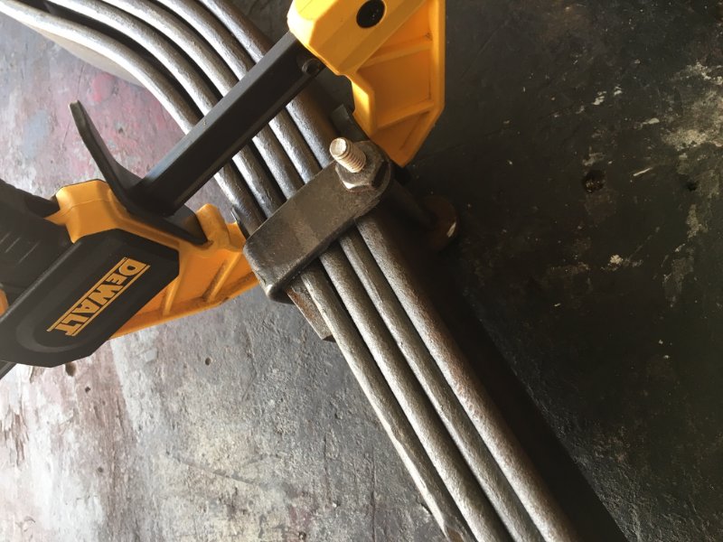

Using those plastic clamps on a spring terrify me! The energy in that spring released in a millisecond can do serious damage. Use a real forged steel clamp, please
RustyFords
Topic author - Posts: 1559
- First Name: Don
- Last Name: Allen
- Location: Houston, TX
Not sure if you noticed...there is a steel clamp in the photo.

Don, I'd take the oiler out to re-orientate it, rather than try to turn it. My tool of choice to remove them is a pair of side cutters.

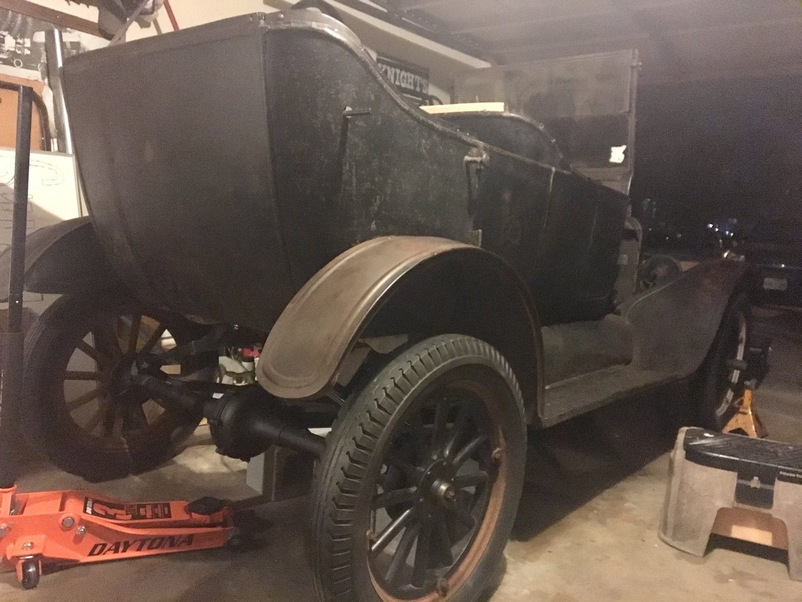

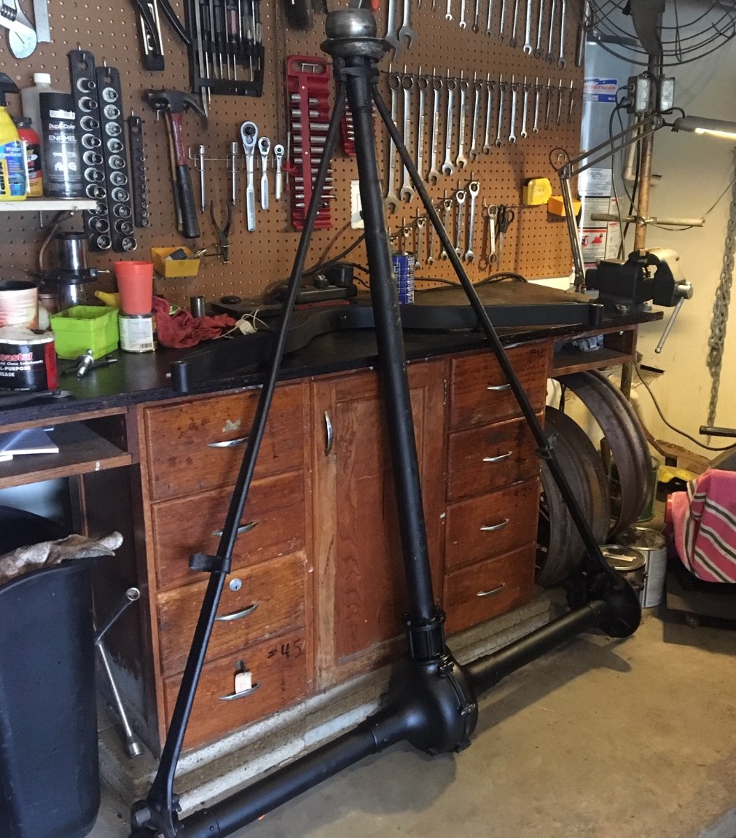

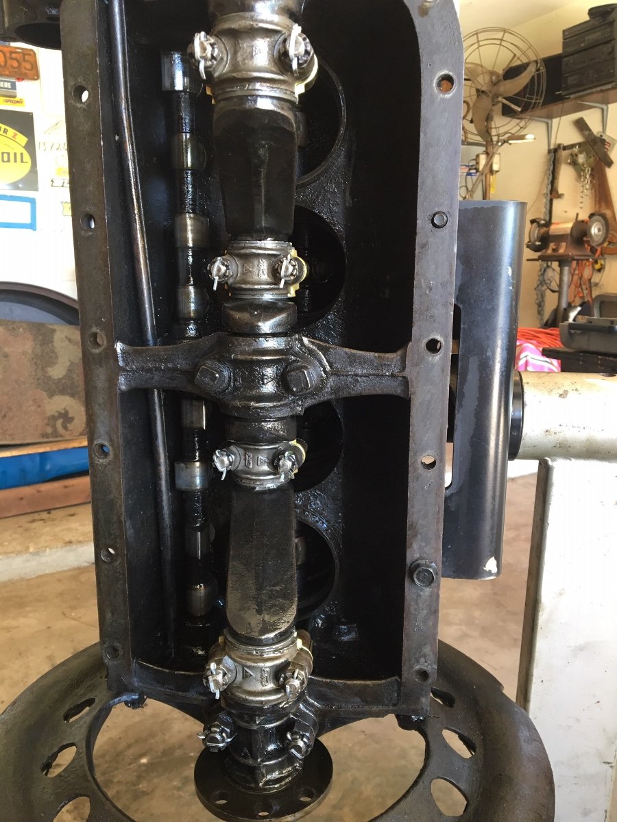

It was a good and productive day of T'ing.

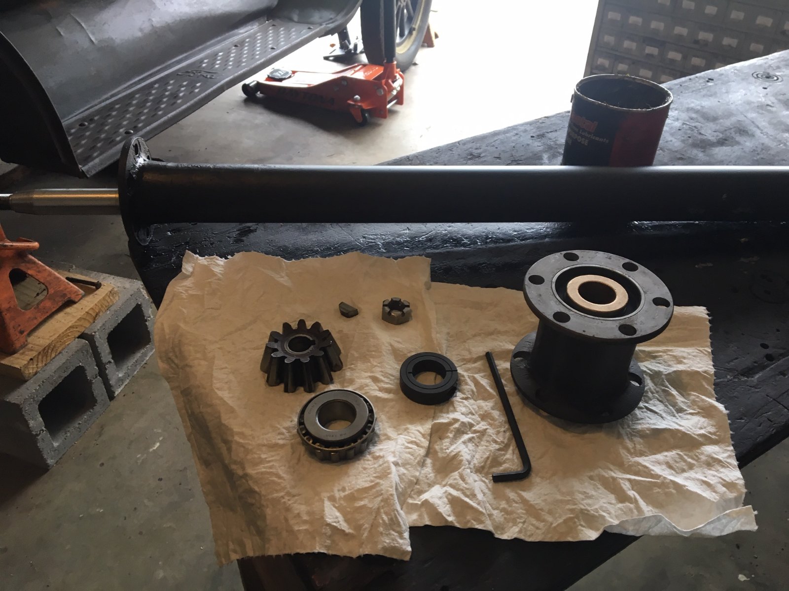

I started by installing my Fun Projects pinion bearing kit, then proceeded to completely assemble the entire rearend, driveshaft, u-joint, torque tube, wishbone assembly.
There were a couple hiccups and learning moments but all in all, it went smoothly. I now have the whole unit assembled and painted in flat black. I'll let it dry until next weekend and will install it then. In the meantime, I need to install my reconditioned rear spring set in the crossmember.
I wanted to be sure that the rear spring gets seated all the way up in the crossmember so I removed the rear seat frame assembly so I can see the hole in the crossmember and I also wanted to appraise the condition of the seat frame and the top of the rear crossmember. I was pleased to see that the rear seat frame is in remarkable condition. It's wearing very old paint that is probably factory applied and has zero rot. It's filthy but I'm sure it'll clean up nicely. The brown areas on it, in the photo, are very thick caked on dirt but it does look like there's still paint under that dirt.
You've gotta love dry climates like west Texas and how they preserve old sheet metal.

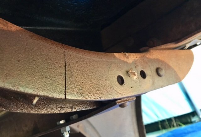

My next task is to get this crack in the rear crossmember welded up before I install the rear springs.
It's a minor task with potentially major ramifications so I'm not going to use my booger-welding skills to do it. I have a friend who's a good welder who'll do it for me. I just have to wait for him to fit me into his schedule. Hopefully that won't be too long.

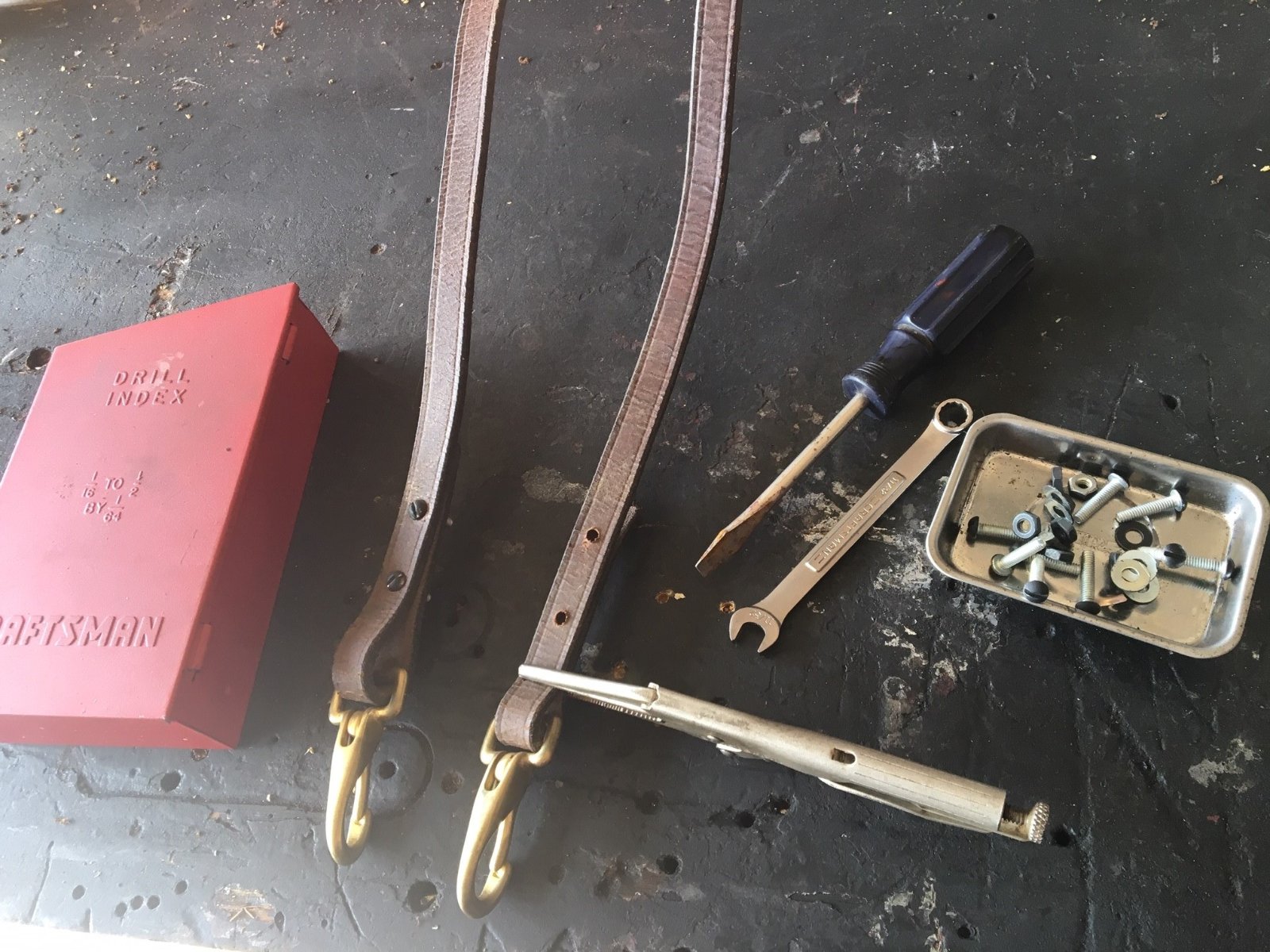

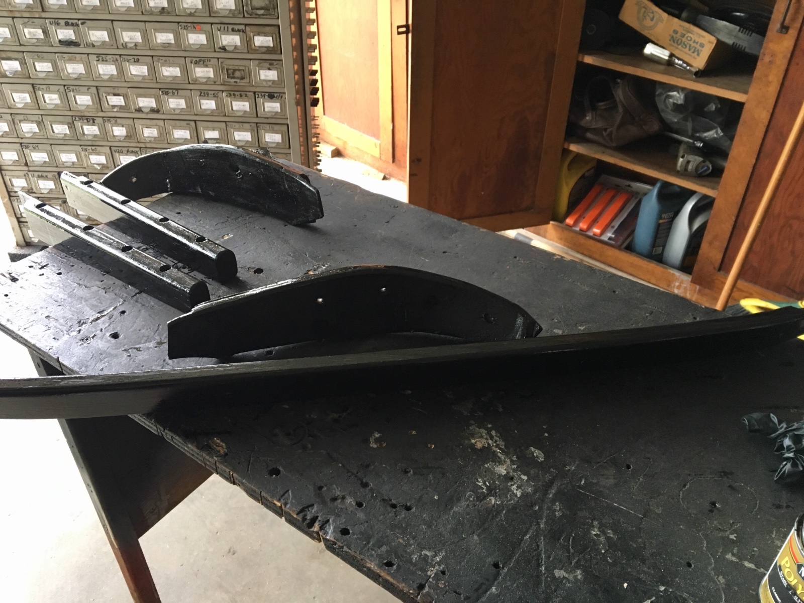

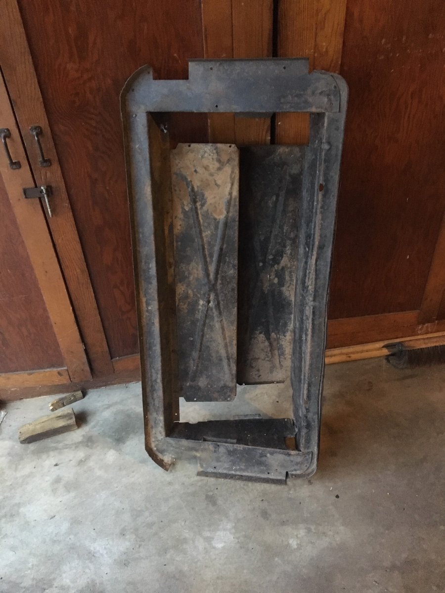

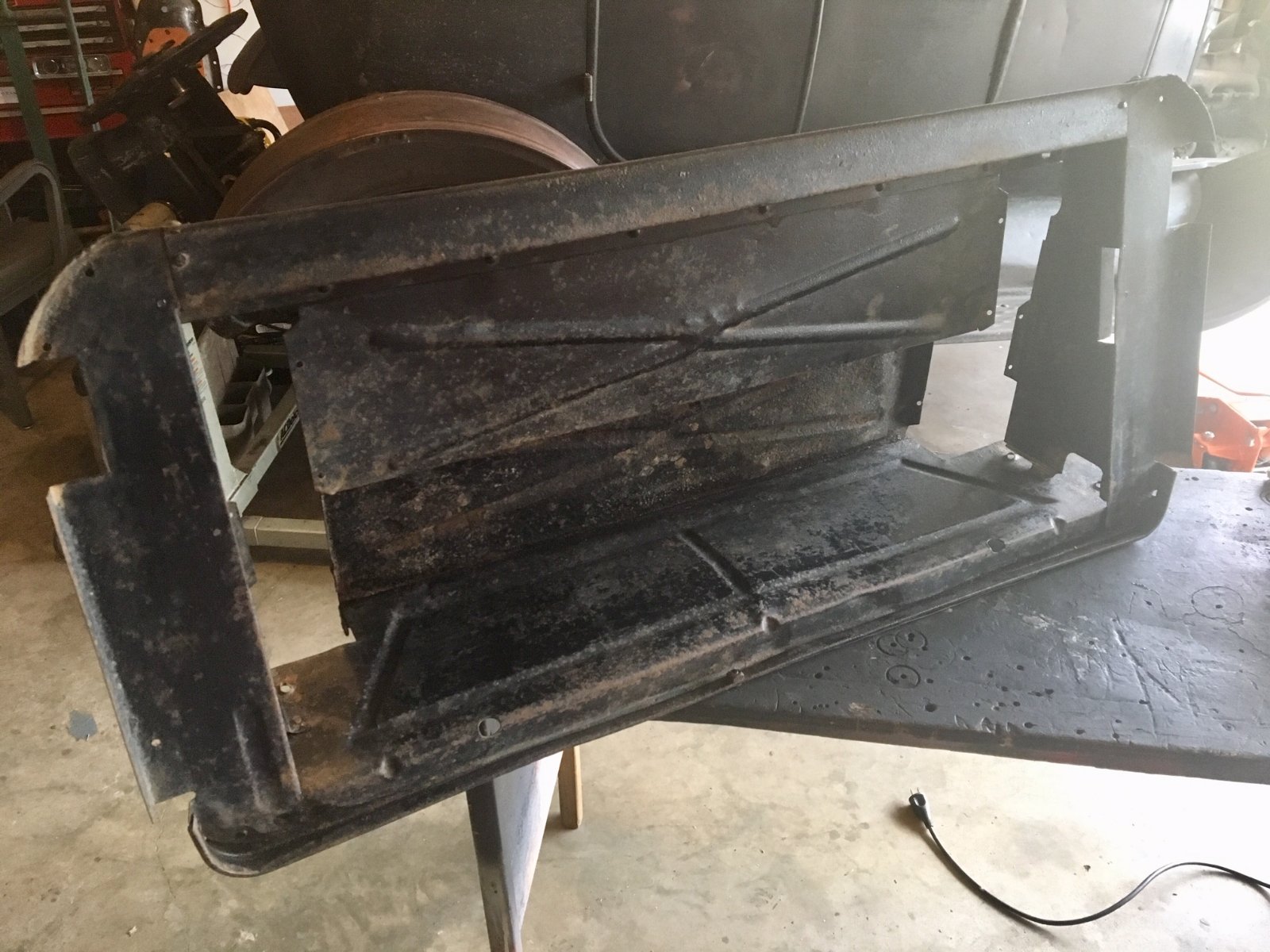

The rear seat pan cleaned up nicely and has the same magnificent (IMHO) patinated finish present on most of the car.
The bracing rod at the top leading edge of the assembly had separated from the sheet metal and at some point in the distant past and a hole had been drilled in the rod and sheet metal at exactly the same place. It's almost certain that a fastener had been placed there to hold them together, but the fastener is long gone. The "correct" thing to do would be to straigthen both pieces out and tuck the sheet metal under the brace's lip. However, this has never been a restoration. This has always been an homage to Great Depression Texas farm life. So...I placed an appropriately weathered and ancient slotted machine screw and square nut to fill the hole and connect the pieces back together, then peened the screw to keep it in place. Yep...I'm sweating the details THAT MUCH...and loving every minute of it. I can see, looking forward that the nut may be in the way of the seat frame sitting where it might want to go, but I'll cross that bridge when I get to it.

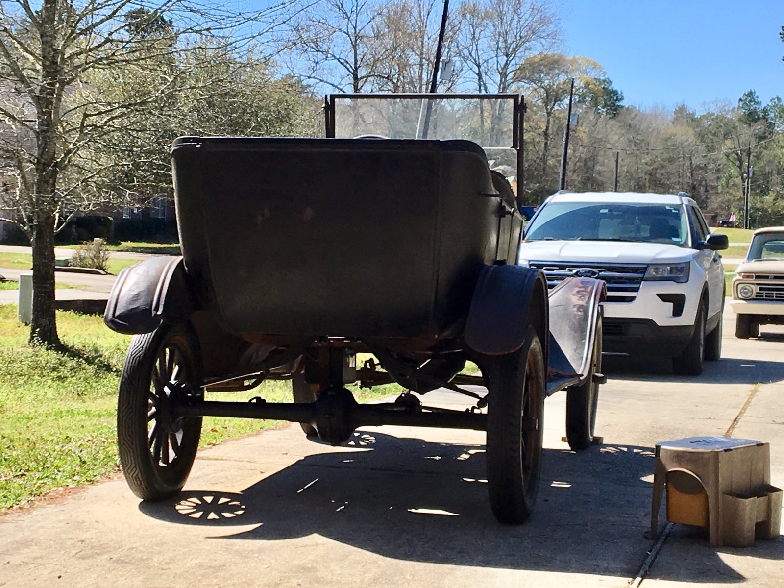

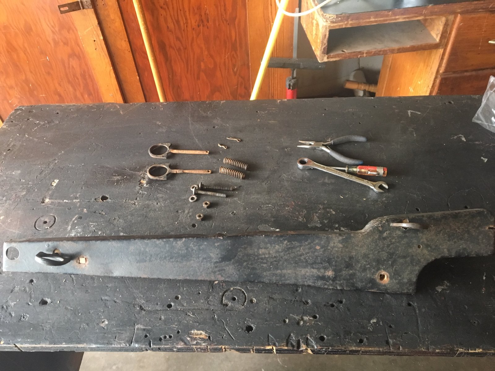

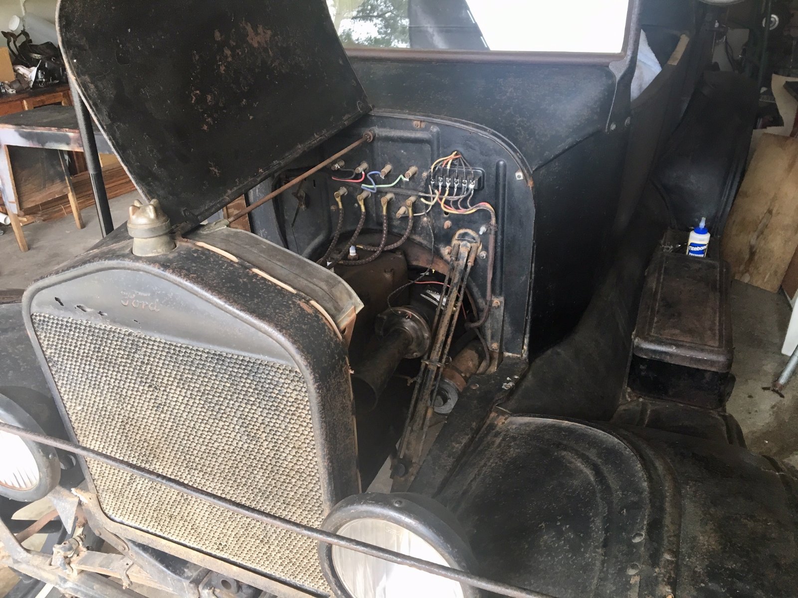

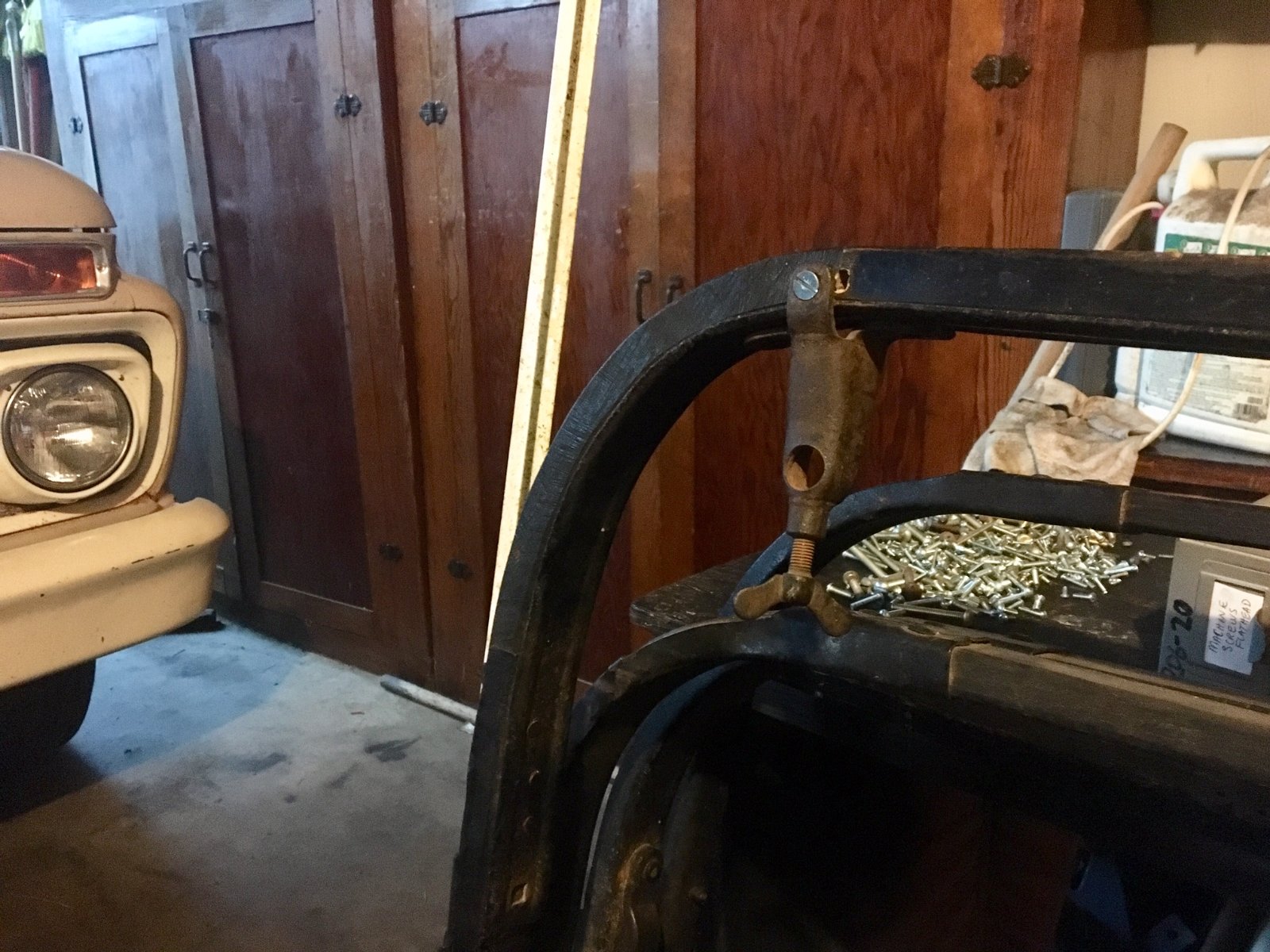

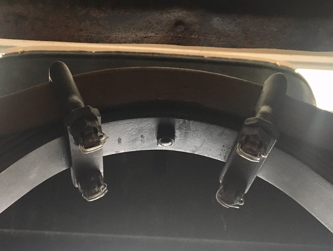

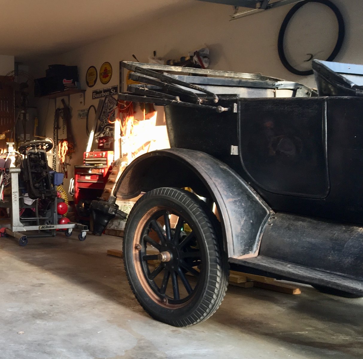

It was another good day of Model T'ing.

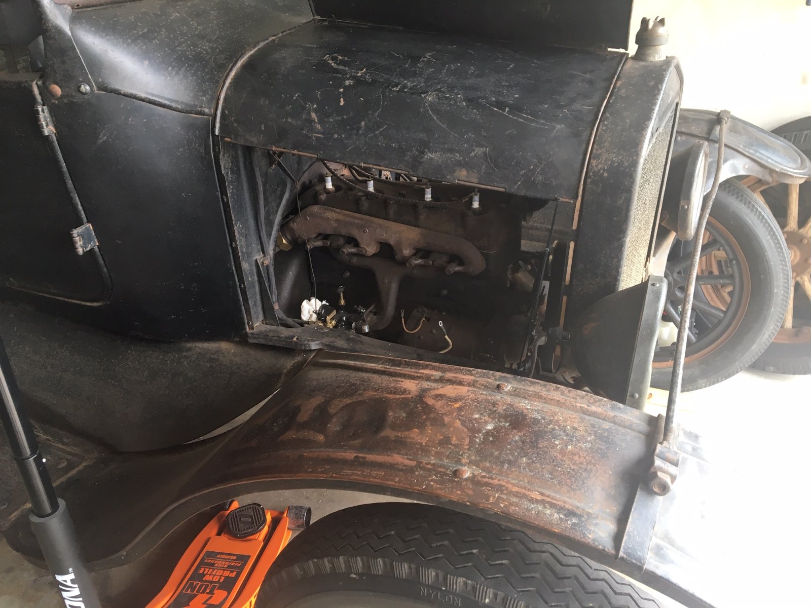

I started by installing the four hood latches. The trick where you tie down the springs was too difficult so I just pulled the hood shelves and installed them that way. It was much easier.
Then I took a dive off the deep end installed the rebuilt spring set and the rear axle and torque tube assembly. I had a lot of trouble getting the spring shackles onto the springs and perches at the same time so I cobbled together a homemade spring spreader and that did the trick.
It's good to have the car sitting on 4 wheels again.

I went ahead and used the earlier high head bolt that I got from Bob B. The later, shorter head version probably works fine (or Henry wouldn't have used it) but I like the way the earlier version protruded way up into the hole in the crossmember. It just seems more secure to me.
In my mind, I imagined that the hole in the crossmember would be significantly larger than the bolt head, but no...I couldn't even get a fingernail in between the two once the springs were installed. That's a pretty close tolerance, especially for a 95 year old crossmember that's seen as much hard use as this one has.

My car came with a low radiator shell and low honeycomb radiator that is in excellent condition.
However, the car is a 24 with a high cowl. So...I'm on the lookout for a high radiator shell with the same weathered finish that the rest of the car has. So far, I haven't had much luck. There are plenty of high shells out there, but most are restored or are wearing old lacquer paint jobs (from 50+ years ago) that just don't age the same way as old factory paint.
I'm hoping to find what I'm looking for at Chickasha.
In the meantime, I've raised my low shell and radiator 1" with wood blocks that I'll paint black so they're not so noticeable. The hood top I bought from Hugh Hemphill in San Antonio is a nice match for my old paint. Over the weekend, I mounted it on the car and cinched it down with zip-ties to get an idea how it'll look with no hood sides and my raised radiator. I was pleased with the overall look.
Next step is to create some hood straps from some old leather horse harnesses that I got from my in-law's barn. I'm going to attach them at the hinge pin at bottom edge of the hood then terminate them with a brass clip that'll hook onto the Model T hood latches. I'll do two on each side.
The hood sides that came with the hood must be for a short radiator car because they're too short. They're in superb condition and are wearing that same paint that looks like it's original factory stuff. I'll take them to Chickasha to find a new home for them.

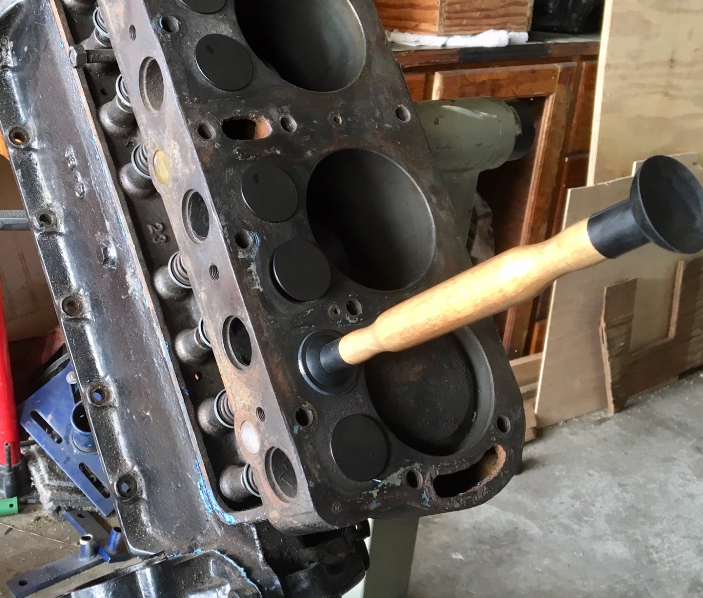

All I lack (mechanically) to have a running/driving car is to go through my spare engine. That'll involve lapping the valves, "time-savering" the bearings, installing new bands and a few other things.
The two front spring perches and bushings are toast and they'll get the full treatment, but I think I'll cheat and at least take it around the block a couple times once it's running...before I tear into the front axle.

Don, go easy on the hood fitting. The low radiator shell has sides which are square to the front of the radiator, whereas the high shells have side which are angled outwards to follow the contours of the body somewhat. As a consequence fitting a high radiator hood to a low shell means the curves of the hood top panels have to be altered to get a neat fit. If you do this, the hinge line at the front will be a little low, resulting in side panels which then don't fit well.
If you intend to source the correct radiator, I would tend to space the hood on the low radiator, rather than bend it to fit.
I have the shell you need, in original shop soiled, chipped and rusted at the chips state, probably new-old-stock. It has crayon numbers written on the inside on the original black japan paintwork. I have it put aside for nickel plating and fitment to my Duncan and Fraser wide body roadster. Being as good as it is makes it much less costly to prepare for plating. Since I got my barn fresh Henrietta, I understand your aims to find parts which match the condition of your car. If you can find a later brass shell from the 26-7 model cars which requires absolutely NO repairs, I would be prepared to trade, but the postage each way would likely queer the deal. Letting vendors know what you are looking for here on the forum may well pay dividends at Chickasha.

Worked some more on the radiator/hood situation today.
I made some tie-down straps out of an old horse bridle set that I found in my in-law's barn. I like the way the straps work and look but I'm not happy with the low radiator on my high cowl car...even after raising it up some with wooden blocks. I really need a high shell that has good weathering on it. Finding one is my main goal for Chickasha. If and when I do, I'll buy a new Bergs radiator to go with it.
Surely one of you guys with the big stashes has a high shell with old paint on it that you'd be willing to part with!

Those straps look they they've been there since day one... nice job. I like the look of running with the hood sides removed
... and my number is Beechwood 4-5789
1926 Touring - "Corrina"

Thanks Jason...that was the general idea. I'm trying to make everything look like it's been there a while. Not always doable, but mostly it is.
I didn't have a choice with the hood sides. The ones I have are in beautiful shape but they're probably for a low cowl car and don't fit my car. However, I also think the car looks pretty good with no hood sides. And since the old girl won't be run in inclement weather, their absence won't be a problem. I'm not afraid to run my old cars in rain, but this old girl won't see rain if I can help it. She's done more than her fair share of hard work and will now see only fun, easy duty.

This weekend was the first time the weather allowed me to push the T of the garage to get a look at my handiwork now that the rear axle rebuild is complete.
I love the spindly, awkward look of a stock Model T from the rear...it's so goofy and cool at the same time. I'm no purist by any stretch and have built several hotrods, but part of why I don't like T hotrods is that when you lower them down and put big wide tires on them, it ruins this "spindly" look...and that's a lot of the charm on a pre-war car.
A nasty head cold had my number this weekend so I didn't accomplish as much as I wanted, but I did finish all the little details with the rear end assembly. When I installed it a couple weeks ago, I finished super late in the evening and didn't properly cotter pin everything and fill up the differential with 600W oil. So, I did all of that, and made some more progress on the tack rail project.
Not a ton of progress but I've been through enough old car projects to know that even small amounts of progress eventually adds up to a running, driving car.

Another thing I was pleased with since the rebuilding and reinstallation of the rear springs is how much nicer the car sits and how fluid and smooth the spring action is compared to before.
Not only was there a broken spring leaf in the set, but the factory applied slip paint had long ago faded away. Add to that the completely dry and trashed spring shackle bushings and you had a very squeaky car that had almost no suspension travel. The car is now completely silent and has a nice range of motion as you rock and actuate the rear suspension. I'm excited to get the front suspension rebuilt and experience what a fully functional Model T suspension feels like.
I've ridden in John Mays' excellent 1911 Touring and was amazed at how comfortable it was and how capably it handled a dirt road. I'm hoping mine turns out to be similar.
Here's a link to the video of John taking my son's and I for a ride in his beautiful car.
https://www.youtube.com/watch?v=wdhGFCLEDJ0&t=4s

Hi Mark...yes...I put a rubber pad between the springs and the crossmember. It was the one Langs sells.Mark Gregush wrote: ↑Tue Feb 26, 2019 10:09 pmThanks for the idea on the laminated tack rail. Maybe a bit late, but did you put pads between the springs and channels? Looking good!

More work on the front tack rail today. I hope to have the woodwork done by tomorrow and also have it all stained. Then I’ll let it dry for a week and install it next weekend.
That’s the plan anyway.

Yet more woodwork today for the short time I had this morning. I finished sanding all the front tack rail pieces then did a trial fit of the whole assembly, then took it apart and stained all of it.
I also added a few thin pieces of plywood to the horizontal structural wood at the top of the front seat area (behind the front door) to shore it up. That piece of wood was (I believe) replaced at some point and wasn’t stout enough and didn’t have the right shape.
I’ll allow that repair and the stain to dry for a week and will then install the tack rail. All that will leave for me, in the wood department is wood kits for two of my three doors and the vertical struts for the back of the rear seat area.
I’ll buy the door kits because I want excellent quality hardwood with precisely the correct shape in order for my doors to shut correctly, but I’ll make the three vertical struts myself.

More progress on the front tack rail this evening...mostly fitting, removing, sanding, removing, re-fitting, and on and on. I am very pleased with how nicely it's turning out, especially the corner pieces that I made. I can't even get a fingernail between the body and wood and they are extremely sturdy.
I should have the tack rail project finished tomorrow after some more fussing with fitment. Then I'll reapply some stain and call them done.
1924 Touring
RustyFords
- First Name: Don
- Last Name: Allen
Tack rail project is complete with the exception of the small nails that finish securing the sheetmetal to the tack rails. The laminate idea that Australian Alan recommended was brilliant.
Both seating "buckets" are now very sturdy.

One of my Chickasha goodies was this fender I bought from Mike Lebsack.
The right rear fender on my car was the only one that didn't have the worn original paint that the reast of the car is wearing. Mike had one that is just beautiful and is a perfect match for my car.
I got home around 3 PM today and was so geeked out about installing it that I went ahead and did so...even before I unloaded my car. Before I installed it, I gave it a gentle bath, then dried it and rubbed in some Penetrol to bring out the old black Gilsonite paint.
Here's a photo of it installed....the lighting wasn't the best. I'm a super pleased with it.

Don, that fender looks like it has lived there a long time. Its much harder get that look than put a newly painted fender on it. Plus the hunt for just the right look is half the fun. I know the fun. It sounds like your having fun also and thats what its really about I think. Waiting for your next report!

Yeah Dallas. I know there are some pretty skilled artists who can simulate old paint, but I don't think this particular look can be duplicated. Original pieces have to be sought out. If I can find a tall radiator shell with this paint, I'll have all the body panels I need.Dallas Landers wrote: ↑Sun Mar 17, 2019 10:29 amDon, that fender looks like it has lived there a long time. Its much harder get that look than put a newly painted fender on it. Plus the hunt for just the right look is half the fun. I know the fun. It sounds like your having fun also and thats what its really about I think. Waiting for your next report!

Here's a shot of the absolutely gorgeous top bow set I bought from Dave Hanlon. They're in very solid condition and are sporting great weathered paint that is a nice match for my car. There's even what looks like very old, very well-done brazing that's showing, adding to the overall "Great Depression" vibe.
My car has 26-27 top pivots in place that don't work well with the earlier one-man top bows. I bought a used set of the correct top pivots from Langs and hope to have them by the weekend. I'll find a way to plug the incorrect holes in the body in a way that compliments the "look".
Once they're here, I'll get my used top material out and will attempt to get it mounted. And advice on that is welcome. I've watched a YouTube video several times where a lady does the top on a black Touring car and it's given me a lot of ideas on what to do and what not to do.
I'm also gettting ready to start putting my spare '25 engine back together. First order of business is lapping the valves.

Ask and ye shall receive

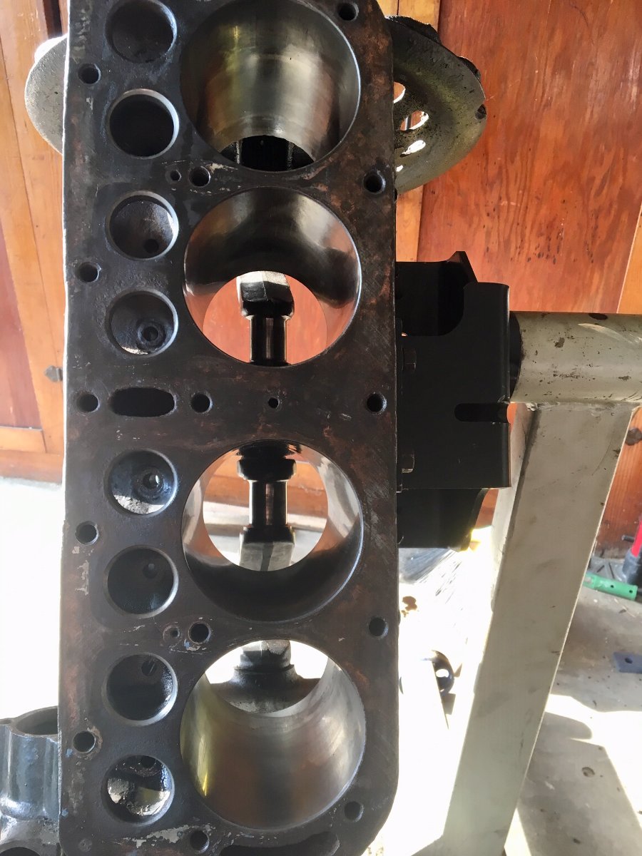

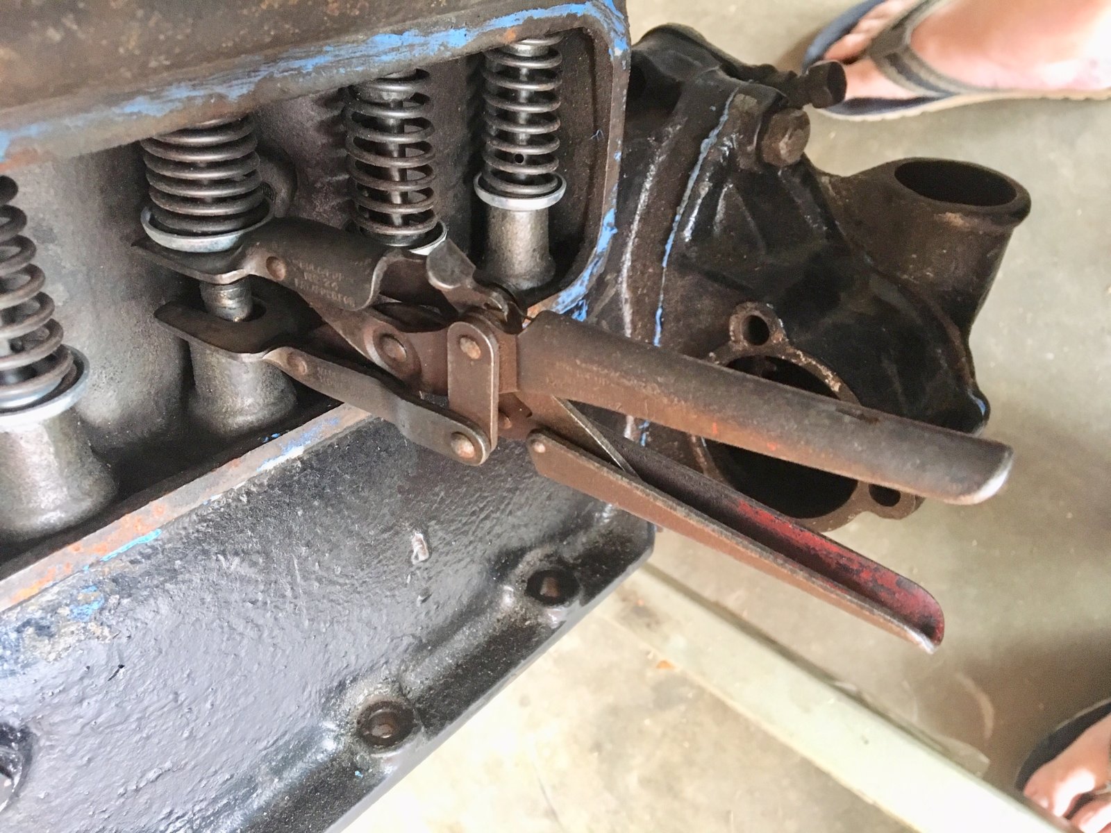

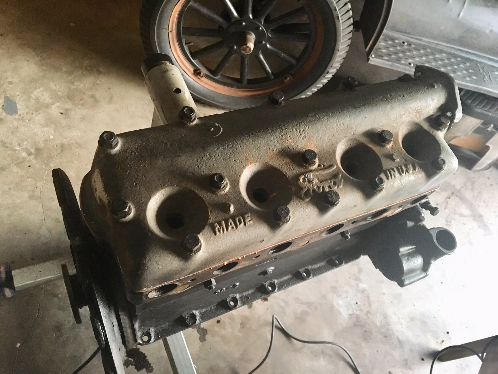

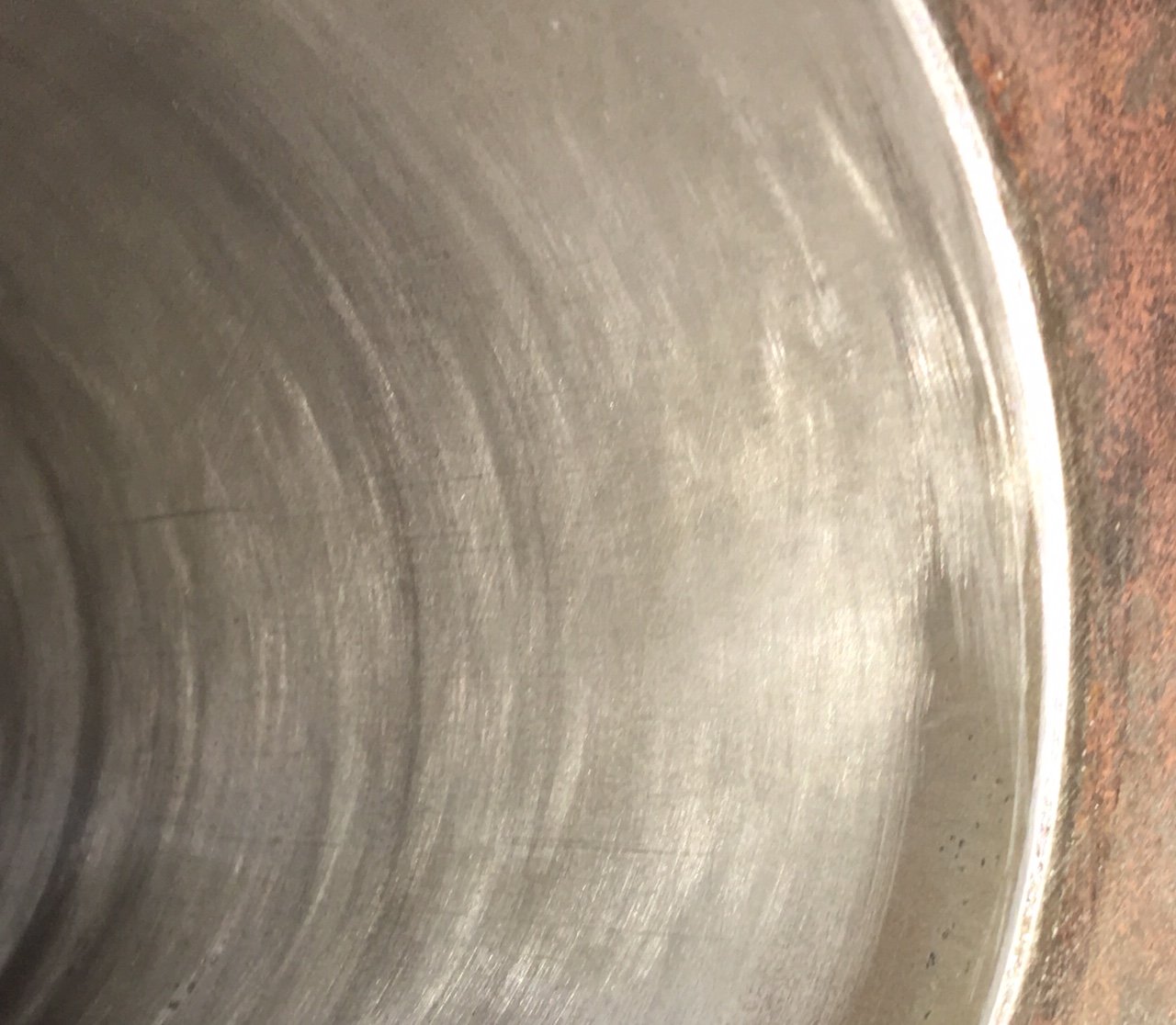

Today I concentrated on the spare 25 engine. I lapped all eight valves and removed the pistons to prepare for the honing that I'll give the cylinders. Gene French is re-babbiting my rear main bearing and as soon as I have that back, I should be ready to reassemble the engine. The goal with this engine is to do a quick and cheap refresh in order to give me a temporary engine. The cylinder walls look good and a quick honing is all they should need. My car's original engine will eventually go to Ross Lilliker for a complete rebuild.
I continue to clean the block and the imense amount of blue RTV goo that the previous owner applied over just about every surface. And, I think he used a garden trowel to do it.
I love the valve spring compressor tool that I bought on eBay. It's very easy to use, and for some reason was a fraction of the price of the more common tool.
Six of the valve seats are excellent, while two are so-so. But I've lapped them extensively...enough to make them seal up, I think, for the amount of time I'll run this engine. There's also some significant pitting at the ends of the block where the coolant ports are. I think a new gasket and copper sealant will be enough to compensate for this though.
I also cleared out the oil pickup tube. It was about 75% blocked and whatever was blocking the tube was very solid and persistently stuck. About an hour of fussing with it, jabbing at it, soaking it with carb cleaner and blowing out the tube with compressed air, cleared it out. As an aside...one should pay attention where one places one's face while spraying compressed air into a stopped up tube containing carb cleaner. It could spray the carb cleaner back into one's eyes, causing searing pain and a mad dash for the garden hose and a good soaking for 15 minutes. Ask me how I know.
And...from the "just because" department...here's a photo of the ancient set of top bows that I bought from Dave Hanlon...a set that his dad put away many years ago. The old repair (brazing I think) is just magnificent and a perfect match for my car.

I'm going to start making door panels and kick panels. I have a lot of weathered old interior fabric that I bought from Dave Hanlon and plan to use it for this purpose.
My first inclination is to make the backer boards out of Luan Plywood.
Any thoughts, or words of wisdom, on this?

Still slow going on the T. My wife has been wanting to re-carpet and paint the entire inside of the house for a couple years so we're tackling that. It doesn't leave a lot of time for the T, especially when you factor in my time consuming job.
BUT....I PRESS ON!!! I refuse to quit on the T. Even in its non-running state, it brings me happiness. It'll be even moreso once I can putt around in it.
I had about an hour of T-time on Sunday so I picked one little project I could start and finish in that time. That turned out to out to be the top-to-windshield post clamps.
My top bows/irons set were repaired a long time ago. The repairs are very well done and made the set very sturdy...maybe even more sturdy than a stock set. These came from Dave Hanlon's dad's stash so I'm assuming his dad made the repairs...but I could be wrong about that.
The forward-most bow has been modified in a way that made correctly placing the two windshield post clamps a bit difficult. On a stock set, the placement of the clamps is set and obvious. On this set, there was no indication as to where they belonged. I had to find a way to center them while maintaining the proper spacing for them to match the windshield post spacing. To make a long story short, I rigged some uprights to help find the center of the bow, then worked out from there.
I managed to finish the project in my allotted time and then test fitted the open top on the car. It worked fine.

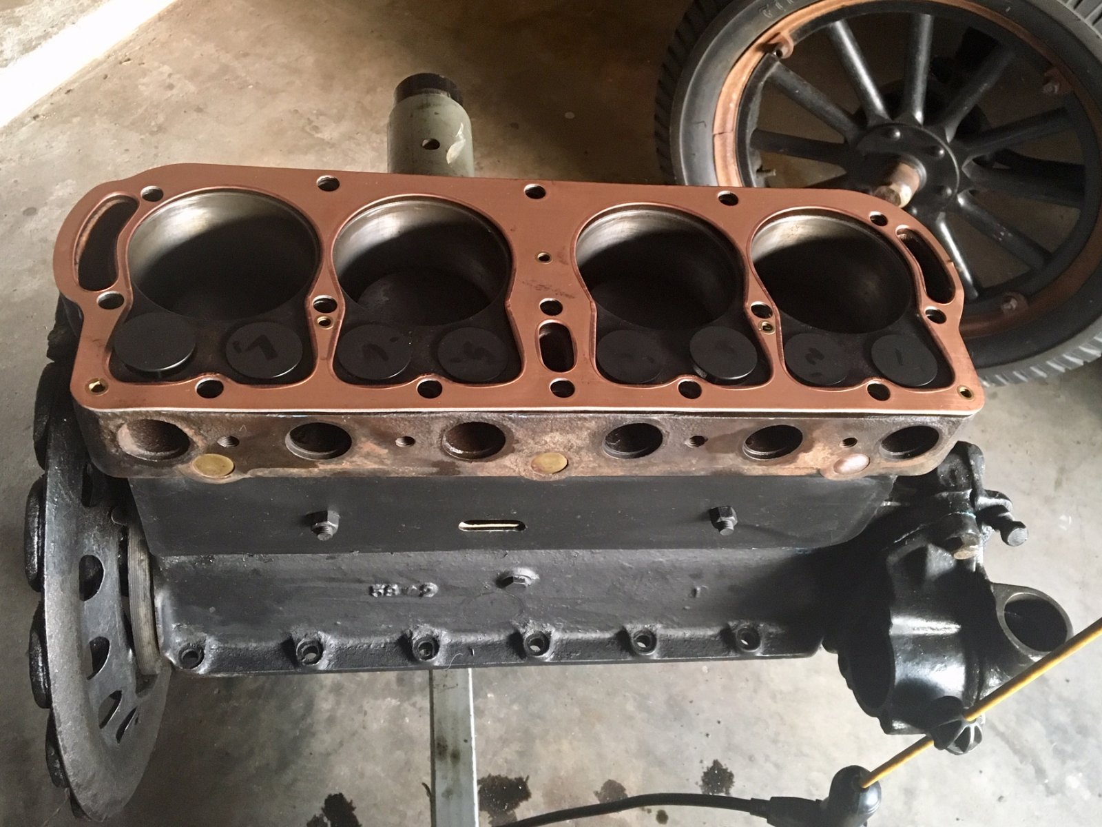

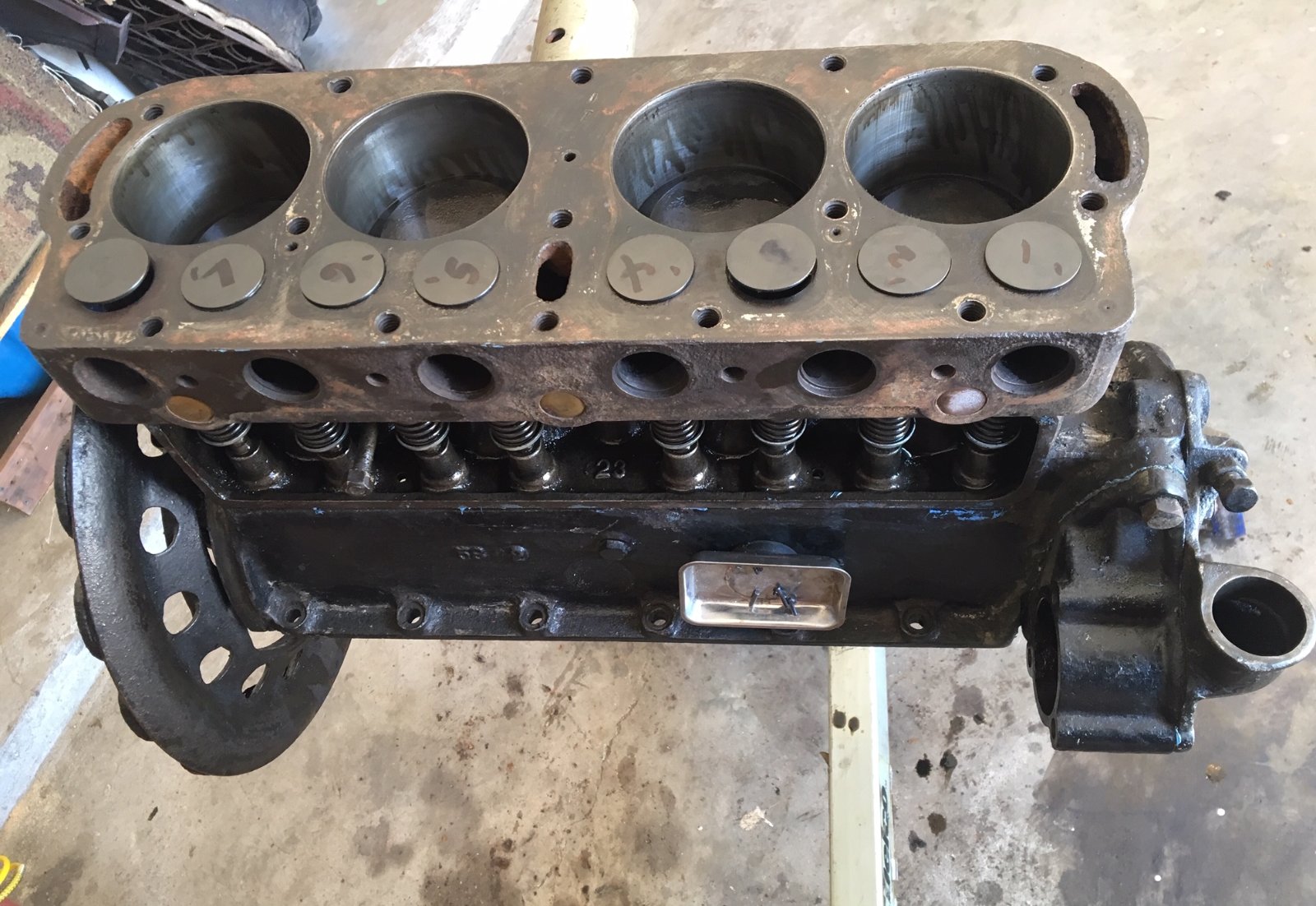

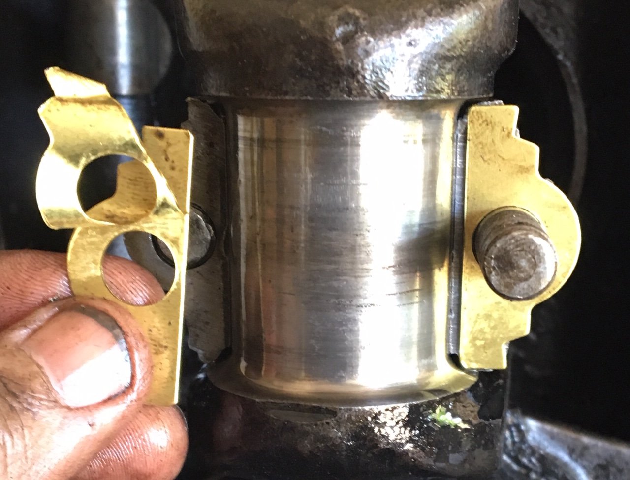

The mailman was Santa today and delivered everything I need to put my temp engine back together.
A rebabbitted rear main from Gene French and some stuff from Langs. Now to find the time to do it.
I can almost hear it running now!!!

- Posts: 7131
Don, I would not use plywood for the door panels. Trimmers here almost exclusively use 3mm MDF fibreboard. They can even sew through this if that is called for. Plywood can delaminate of it gets wet, cheap luan even more so. MDF just needs to be primed/sealed on the back side after the covering is fitted.
Hope this helps.
Hope this helps.

This afternoon The focus was on the temp engine.
I gave the cylinders a quick honing then installed all the pistons and lapped the rod caps with Timesaver. Then I installed new shims and went through the process of removing shim layers until each cap was just right. The procedure I followed was to remove layers until the rod was too tight to turn then I added a shim layer back in.
It kept occurring to me how much easier and enjoyable this process is with the engine out of the car (on an engine stand) that it is while laying under the car!
I also installed the rebabbitted rear main cap that Gene French redid. All of the slop is now eliminated from the crankshaft.
Overall, the engine is now really snug
Yes...I did finish properly folding down the cotter pins after I took the photo below.
I previously lapped the valves and I replaced the valve stem keeper pins. A few of the old ones were slightly bent.
Next I'll see what repairs are needed for the magneto and will order up the parts for those repairs. Then I'll reinstall the transmission and re-line the bands. Finally, I'll re-install the head and then install the engine in the car.

Dallas Landers wrote: ↑Sun Apr 14, 2019 9:10 pmOh ya, laying under with oil dripping on your face. What fun!
One step closer Don. Glad to see you got in some shop theropy.
Dallas and Jason...I'm at that stage in an old car project where you get that sense that you might actually get to drive it. Up 'till then, it's more like a gigantic arts and crafts project.Barth_Tool_Co wrote: ↑Mon Apr 15, 2019 12:22 pmLooking good, not even my car and I'm getting excited for the maiden voyage!
Work and family continue to consume the vast majority of my time, but even so, I'm thinking I'll be putting around this summer. The front spring perches and shackles and steering linkage in this car are very worn, but that's not going to stop me from taking a few very-low-speed laps around the neighborhood.
I've returned a half dozen or so long-term storage (30 years or more) cars to the road. Each time I've made that first ride, I've had a smile from ear to ear and may have even screamed out for joy when I was driving out through the country.

Pushed the project forward a bit this evening by installing the valve cover and head.
1924 Touring
- Posts: 6707
Don
see those "dots" on the center main bearing bolts? They correspond to the cotter pin hole. Next time you're into an engine, you'll want to pay attention to them so as to EASILY fit cotter pins to them!
RustyFords
- First Name: Don
- Last Name: Allen
I'm not following you Scott...please explain.Scott_conger wrote: ↑Tue Apr 16, 2019 10:38 pmsee those "dots" on the center main bearing bolts? They correspond to the cotter pin hole. Next time you're into an engine, you'll want to pay attention to them so as to EASILY fit cotter pins to them!![]()
1924 Touring
- Posts: 6707
Don
Look at the bolt heads...they're square...there is a "dot" rasied on a corner of the bolt head. If that dot is aligned toward the outside of the block or inside of the block, then the cotter hole will be thusly aligned. In otherwords, if you aligned both bolts such that a straight line can go from the "dot", across the opposite corner of the bolt AND cross over a "dot" on the other bolt and it's opposite corner, the cotter pins will then be a straight shot with both bolts conveniently aligned and easy to put the cotter pins in. I'm sure there is a much easier way to say this but I am flumouxed as to how to say it right now
