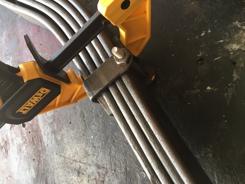

Yesterday I made a big push to get the rear springs done. Cleaning them up on the wire wheel was nasty work and left me covered in dust...looking like a coal miner. I don't mind getting that filthy occasionally, but I figured I'd limit it to just one day this weekend.
Here's how it went:
I finished cleaning all the leaves late last night then I painted them with graphite paint. I've never messed with that stuff before. It's pretty neat. I might paint the underside of my mower deck with it. If anyone in the Houston area needs some, let me know. I'll never use the gallon that I have.
They were dry this morning. I installed new bolts in the clamps. The old weathered nuts from the original set were in good shape and cleaned up nicely so they got re-used. My practice with this car is, if it's sound, safe and re-usable, it gets re-used...even something as small as a nut.
Then I installed the main bolt that holds the whole set together. I didn't have the strength to clamp down the whole set enough to get the main bolt started so I used another long bolt to press them together, then clamped them, then removed the long bolt and installed to correct bolt that I got from Langs.
I then cut off the excess bolt material and peened the clamp bolts and the main bolt. It'll now get a coat of flat black. I need to install new bushings and new grease cups and then it'll be ready for installation.
Here's how it went:

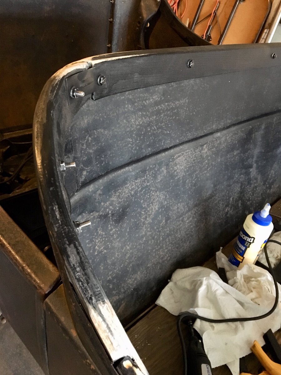

I wrapped up the day by continuing the tack rail project. I’m building the driver’s side curved piece out of plywood laminate like I did the other side.

Had just a few moments after work, before I ran out of sunlight so I glued another layer down on my plywood laminate corner section of the tack rail.
Hopefully, this coming weekend, I'll be able to wrap up the tack rail project.

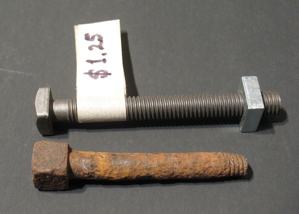

The spring bolt I got from Langs was rather disappointing.
Beside the remains of an original bolt it's obvious that the head is much too short. It's just a generic square head hardware store bolt. The head should be tall enough to fit into the hole in the frame and keep the spring from wandering.
This is the NOS bolt I got from Bob Bergstadt.

Wow Steve...that is a huge difference. Thanks for clueing me in on that.
I'll contact Bob to see if he has another one.

Good to see the original style bolt is available. I found a good original in my pile of parts for my 21 touring. I was about to cut the head off another bolt to weld on the head of the standard head bolt to make a thick one which would work but then I found the decent original.
- Posts: 3818
- First Name: Larry
- Last Name: Smith
Re: 24 Touring Barn Car Revival - Part 3
The later center spring bolts didn't have as high a head as the early ones did. I have no idea when the change occurred. Also, the two spring clips used on each side have a special square head, and use a 1/2" across the threads jamb nut, which is used in various places on the late T's.

Bob B has a new center bolt in the mail and Lang's has a new u-joint and pin, and new bushings in the mail as well.
That'll be everything I need to re-install the rearend/torque tube/driveshaft. The items won't be here by the weekend
but I'll get it done as soon as possible.

I went ahead and used the earlier high head bolt that I got from Bob B. The later, shorter head version probably works fine (or Henry wouldn't have used it) but I like the way the earlier version protruded way up into the hole in the crossmember. It just seems more secure to me.
In my mind, I imagined that the hole in the crossmember would be significantly larger than the bolt head, but no...I couldn't even get a fingernail in between the two once the springs were installed. That's a pretty close tolerance, especially for a 95 year old crossmember that's seen as much hard use as this one has.

More work on the front tack rail today. I hope to have the woodwork done by tomorrow and also have it all stained. Then I’ll let it dry for a week and install it next weekend.
That’s the plan anyway.

Yet more woodwork today for the short time I had this morning. I finished sanding all the front tack rail pieces then did a trial fit of the whole assembly, then took it apart and stained all of it.
I also added a few thin pieces of plywood to the horizontal structural wood at the top of the front seat area (behind the front door) to shore it up. That piece of wood was (I believe) replaced at some point and wasn’t stout enough and didn’t have the right shape.
I’ll allow that repair and the stain to dry for a week and will then install the tack rail. All that will leave for me, in the wood department is wood kits for two of my three doors and the vertical struts for the back of the rear seat area.
I’ll buy the door kits because I want excellent quality hardwood with precisely the correct shape in order for my doors to shut correctly, but I’ll make the three vertical struts myself.

More progress on the front tack rail this evening...mostly fitting, removing, sanding, removing, re-fitting, and on and on. I am very pleased with how nicely it's turning out, especially the corner pieces that I made. I can't even get a fingernail between the body and wood and they are extremely sturdy.
I should have the tack rail project finished tomorrow after some more fussing with fitment. Then I'll reapply some stain and call them done.

Tack rail project is complete with the exception of the small nails that finish securing the sheetmetal to the tack rails. The laminate idea that Australian Alan recommended was brilliant.
Both seating "buckets" are now very sturdy.

One of my Chickasha goodies was this fender I bought from Mike Lebsack.
The right rear fender on my car was the only one that didn't have the worn original paint that the reast of the car is wearing. Mike had one that is just beautiful and is a perfect match for my car.
I got home around 3 PM today and was so geeked out about installing it that I went ahead and did so...even before I unloaded my car. Before I installed it, I gave it a gentle bath, then dried it and rubbed in some Penetrol to bring out the old black Gilsonite paint.
Here's a photo of it installed....the lighting wasn't the best. I'm a super pleased with it.

Don
see those "dots" on the center main bearing bolts? They correspond to the cotter pin hole. Next time you're into an engine, you'll want to pay attention to them so as to EASILY fit cotter pins to them!
RustyFords
Topic author - Posts: 1559
- First Name: Don
- Last Name: Allen
- Location: Houston, TX
I'm not following you Scott...please explain.Scott_conger wrote: ↑Tue Apr 16, 2019 10:38 pmsee those "dots" on the center main bearing bolts? They correspond to the cotter pin hole. Next time you're into an engine, you'll want to pay attention to them so as to EASILY fit cotter pins to them!![]()
1924 Touring
- Posts: 6606
Don
Look at the bolt heads...they're square...there is a "dot" rasied on a corner of the bolt head. If that dot is aligned toward the outside of the block or inside of the block, then the cotter hole will be thusly aligned. In otherwords, if you aligned both bolts such that a straight line can go from the "dot", across the opposite corner of the bolt AND cross over a "dot" on the other bolt and it's opposite corner, the cotter pins will then be a straight shot with both bolts conveniently aligned and easy to put the cotter pins in. I'm sure there is a much easier way to say this but I am flumouxed as to how to say it right now
