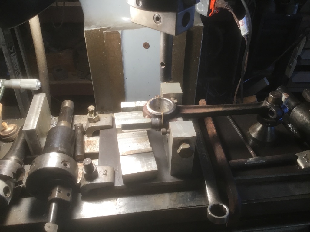

Post by Larry e rutt » Sun May 23, 2021 1:09 pm
Just a couple of pics...
