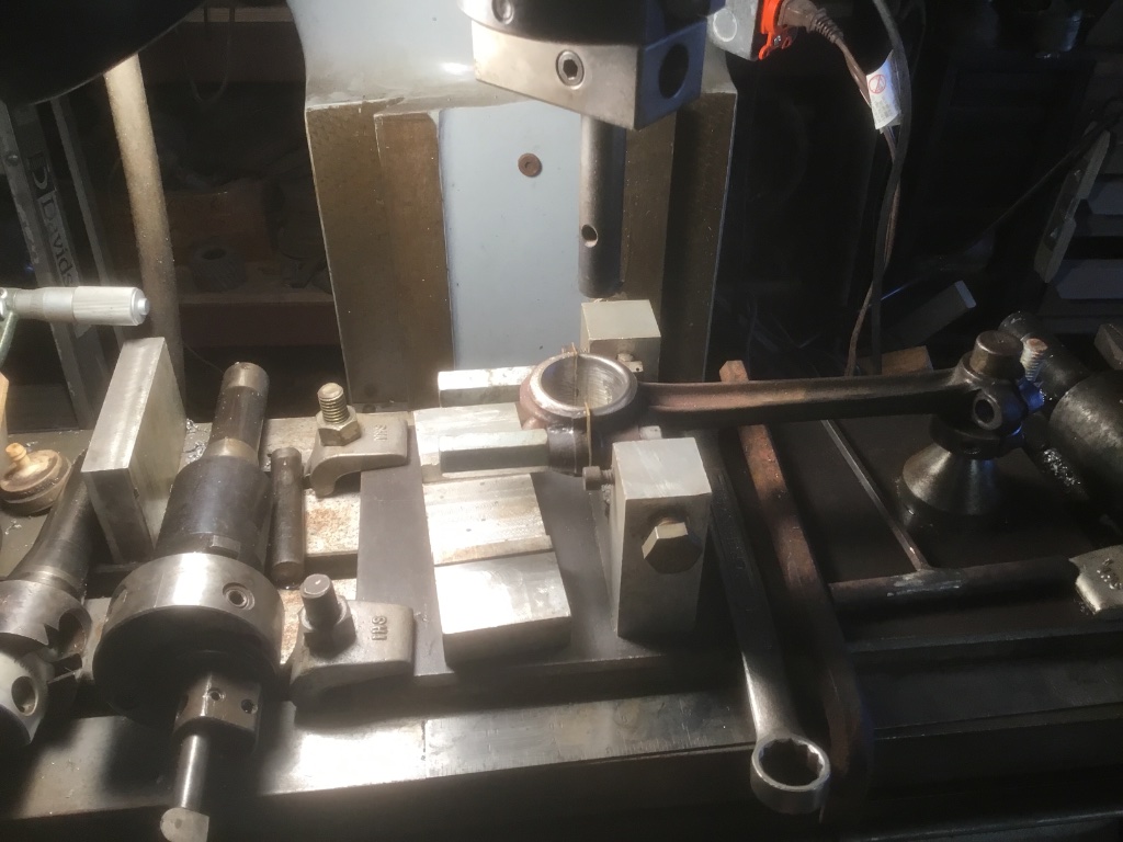

Post by Larry e rutt » Sun May 23, 2021 1:09 pm
Just a couple of pics...

Post by Scott_Conger » Sun May 30, 2021 6:34 pm
Larry, I'll warn you that if you simply run a reamer down the hole without fixturing the reamer dead center on the valve hole (or where it SHOULD be since the last set of valves were lapped in with excess wobble/clearance), and then CUTTING a new valve seat, you are not going to come to a good end.
There will undoubtedly be someone who will cheerfully suggest that "nah, you only have to whale-away at the block with a couple of stones after you've reamed it and you'll be fine". If you take that advice, well the advice was free, just like mine.
http://www.mtfca.com/discus/messages/70 ... 1510948496 shows how I do it, and how others do it similarly, as well as a period tool which did the same thing as I and others do. All good engineering practice and you're guaranteed concentricity between the valve guide and the valve seat (which is absolutely vital once the guide/valve tolerances are back in spec).
I really cannot too strongly suggest that you get help with this from someone who is acquainted with this type of work. Pretty sure I said the same thing when you were first replacing the valves and sincerely hope that you will take the advice now.
