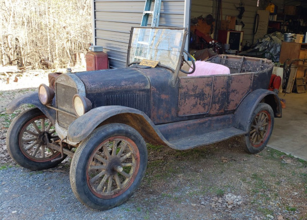

I recently purchased a 1926 Ford Model T Touring and really do not know much about it except I have always wanted one. I am sure everyone here understands that. The mechanics part of it I get. I have restored many old tractors and cars. I am in the process of rewiring it. It did not have an alternator, but did have 6volt battery. When I went to order one I found they have a 6volt and 12 volt option. My experience with 6 volt systems is they under preform are unreliable and batteries do not last long. So I want to convert it over to 12 volt. I know the coils should be fine. I use them on my hit and miss engines with a 12 volt battery. Other than replacing the headlight bulbs, is there anything else I need to do or is it best to leave it 6volt? Since I am new to Model T's. I thought I would ask those who are more experienced with them. Thanks

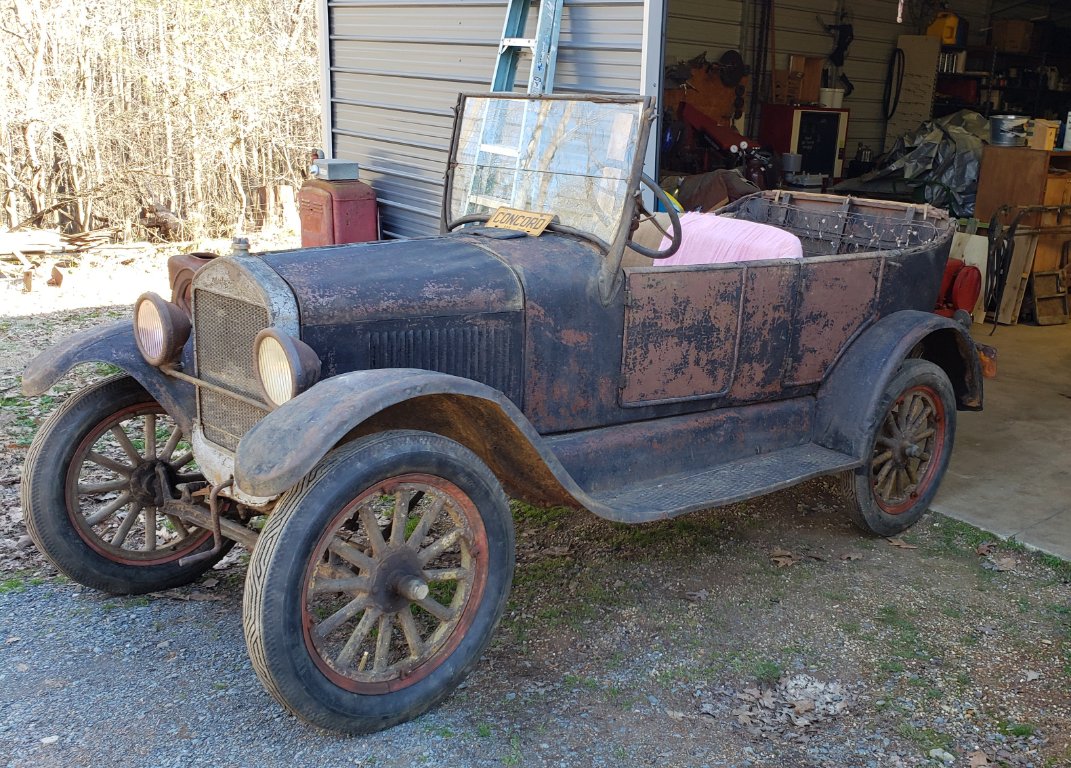

A good 6v system works well. An 8v battery is compatable with all 6v equipment & lights. You get better cranking & it can hide some electrical issues. A 12v conversion can be done. However, generator/alternator must be set for 12v. Problem is starter. A new 12v replacement starter or proper 12v conversion should be done. 12v to a stock starter tears up the bendix drives & possibly ring gear. If you go this way carry all the stuff to replace the bendix & hardware for WHEN it fails.
BTW neat patina! Love it as is.
