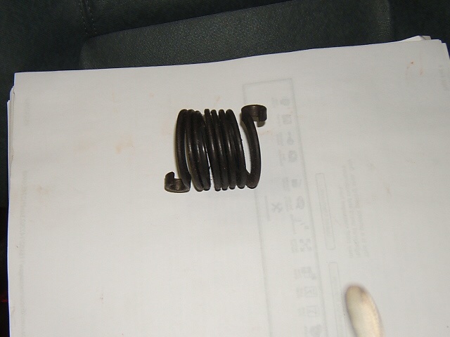

Hi there
I maybe wrong and maybe right
But in Australia my experience is that our 6 volt battery’s don’t stand up as good as they should
That’s why I converted to 12 volts
The other reason why is we run a 12 volt uhf ( CB Radio )
For safety and communication between our big groups
As we are on country roads with big trucks and so on
As for the starter they have one big battery connection pin that puts 6volt down through 4 sets of heavy windings in parallel
So I cut two of and run 2x2 in series
And this slows the voltage down a little and isn’t as hard on the bendix and I have two vehicles like this
For over 6 years
Sorry for stepping on the 6volt toes
