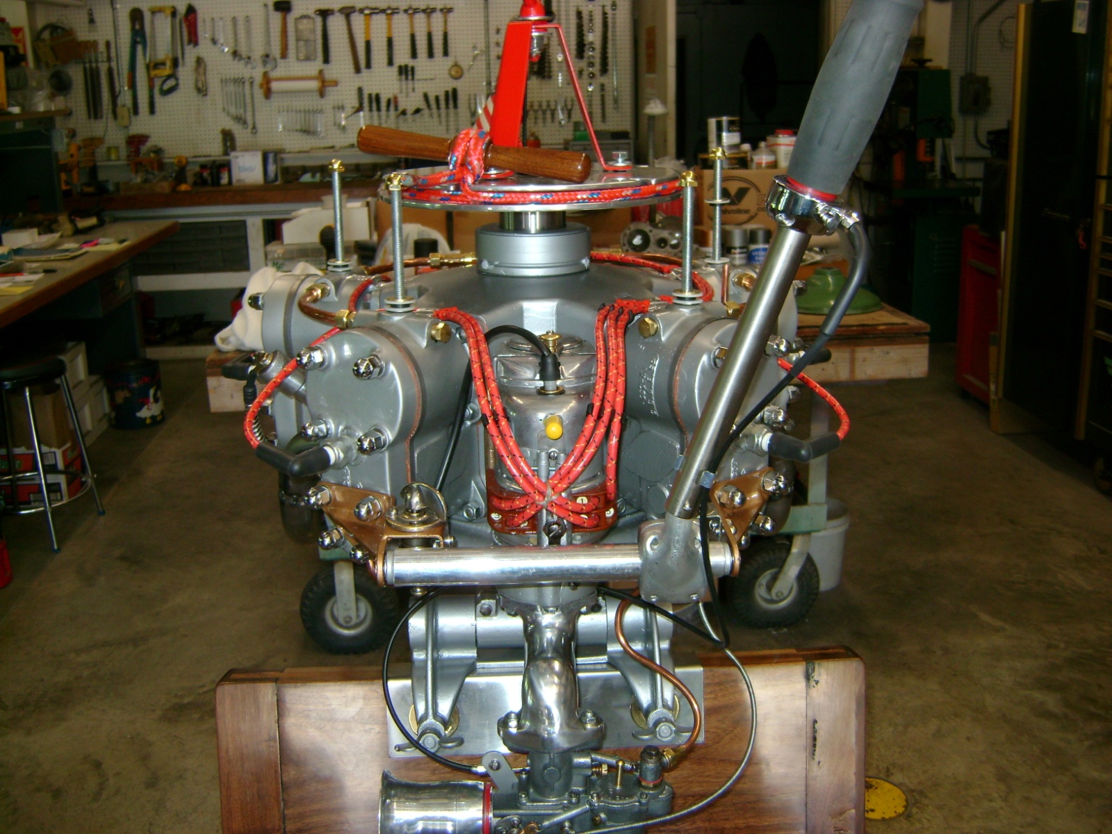

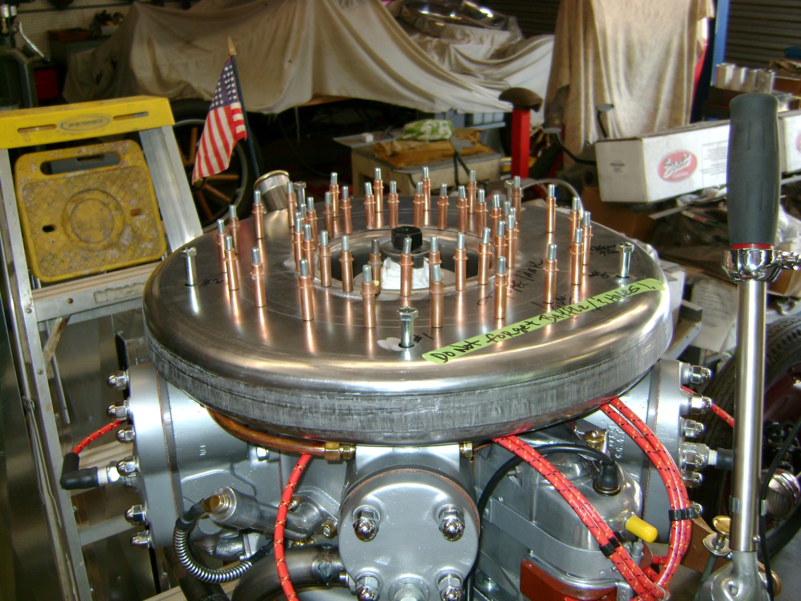

To show you what the possibilities are, this one of the most rarest outboard engines there is. A total basket case when I purchased it with missing parts, etc. It is a 1928 Cross 5 Cylinder Radial Outboard Engine making 50 HP. They did not start producing that again until the late 1960's. A lot of reverse engineering but a total labor of love.
The donut style fuel tank I was able to make in a day. It is all in planning the style and be patience. No Rush!

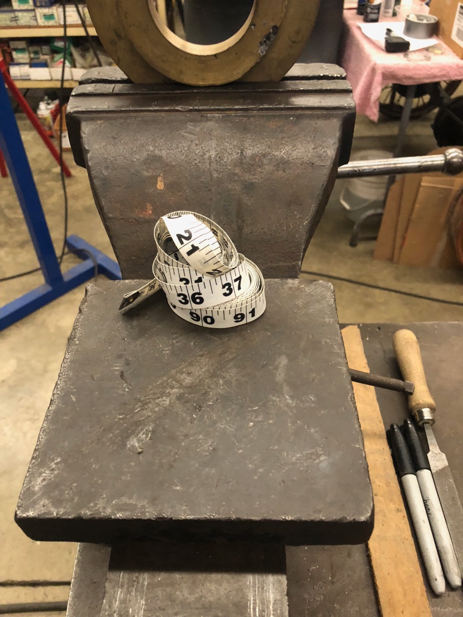

Well not a long day in the shop as planned due to cold rainy weather and body aches, but a start.

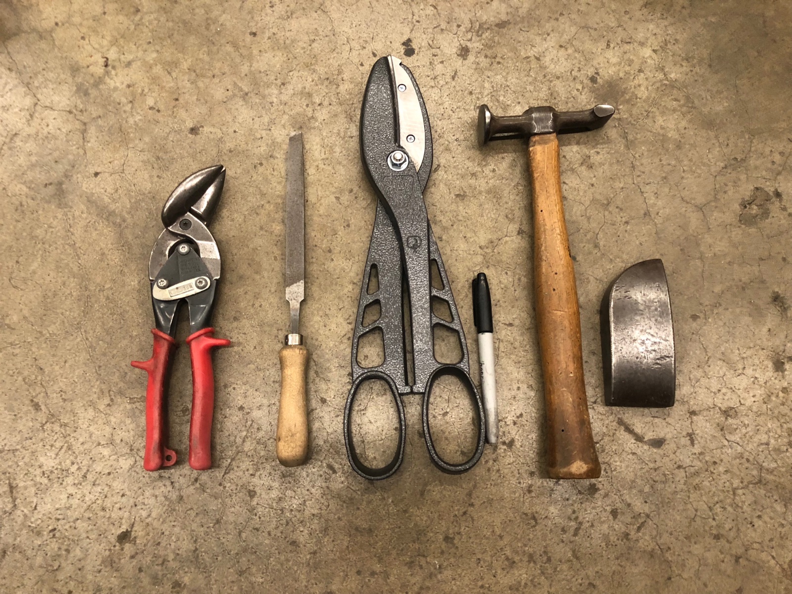

First of all, basic tools to do this. With basic tools more labor and time is required to gain results, but really who cares, look at it as therapy!
Quality tools now days can be found online, flea markets, swap meets, etc. Even various shapes of metal laying around and at a scrap yard works.

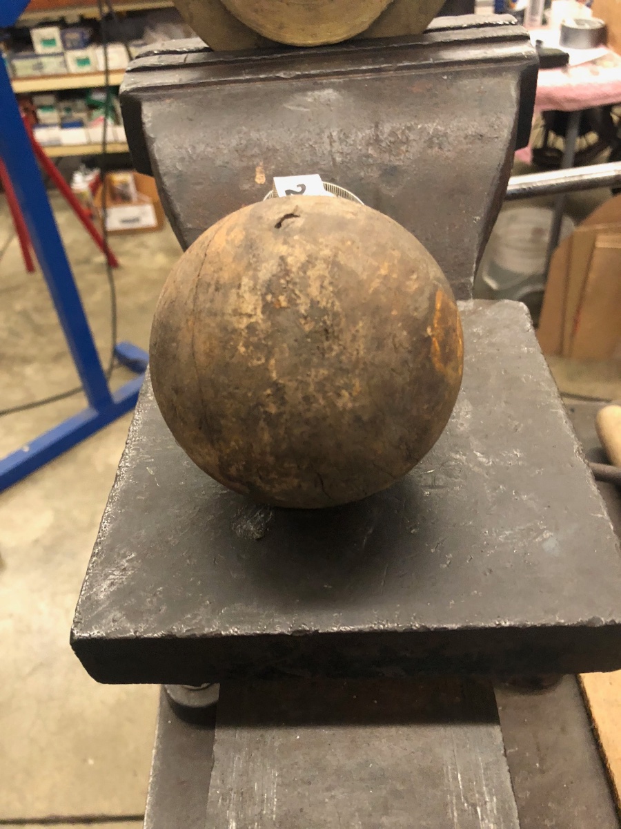

Using an old croquet ball and large diameter wooden dowel is your friend too. Does your wife have a wooden rolling pin she does not use anymore? Remember when she use to make pies, well, make panels with it now.
An old British friend once told me, If you can imagine it, you can make it. The only limitations are the depth of your machines, the space you are working in, and ability. So practice, make in pieces, and get a bigger place.

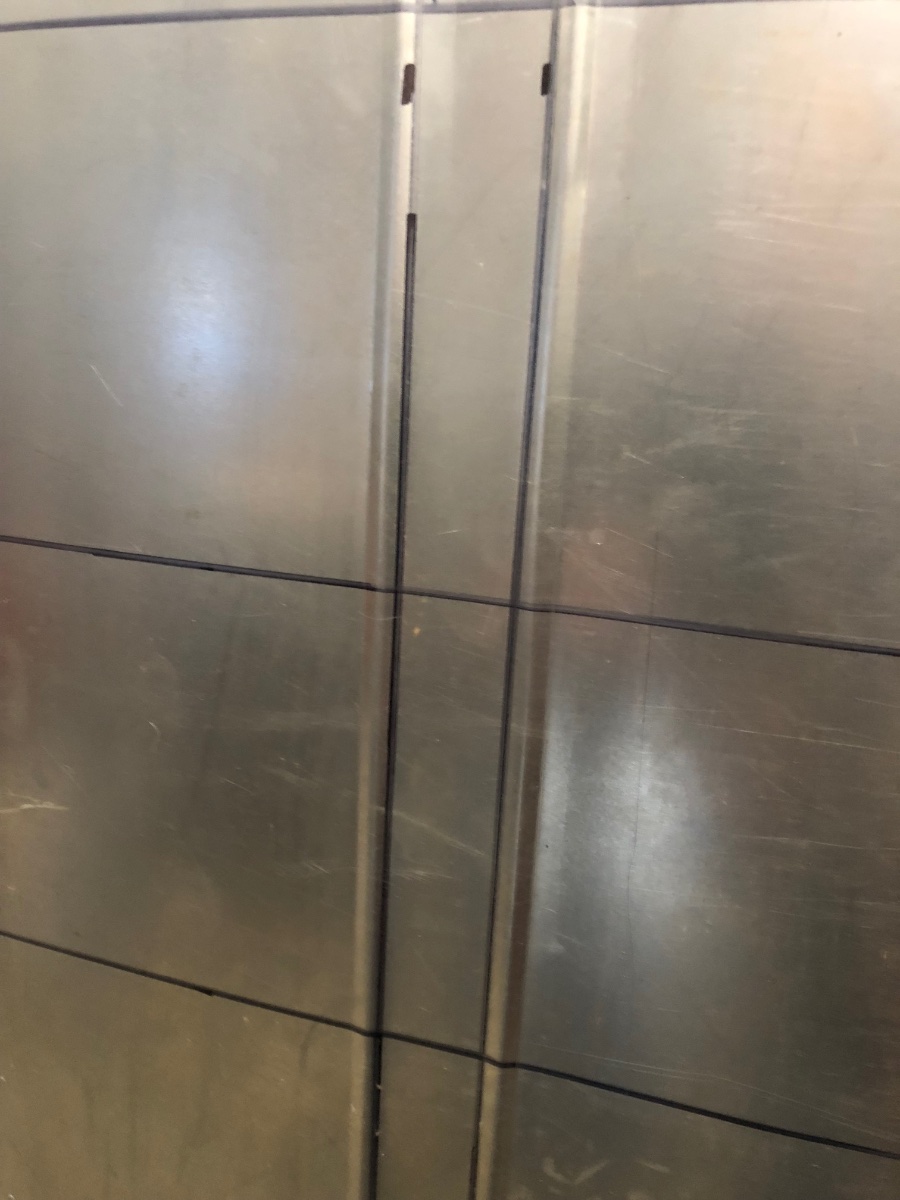

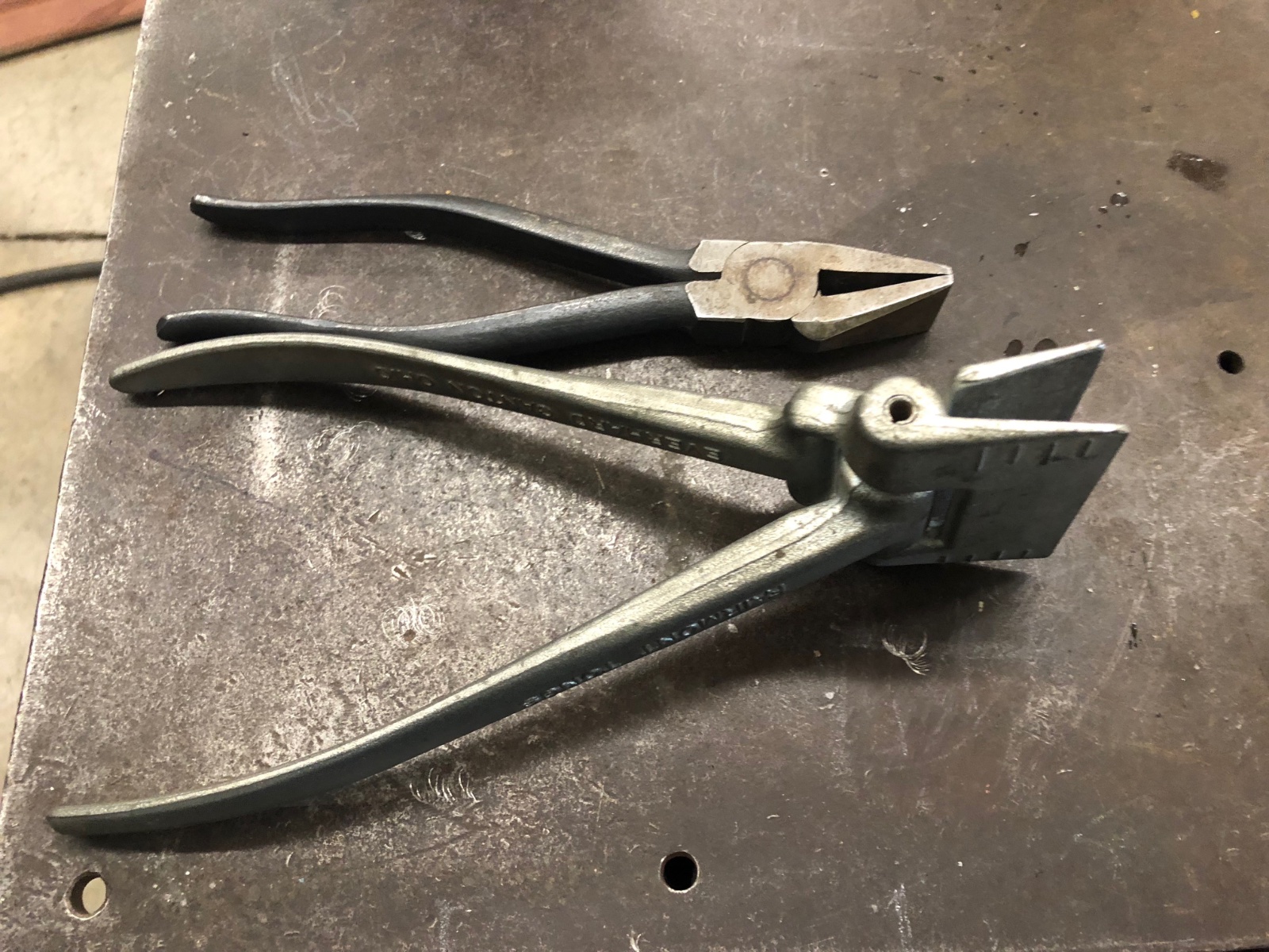

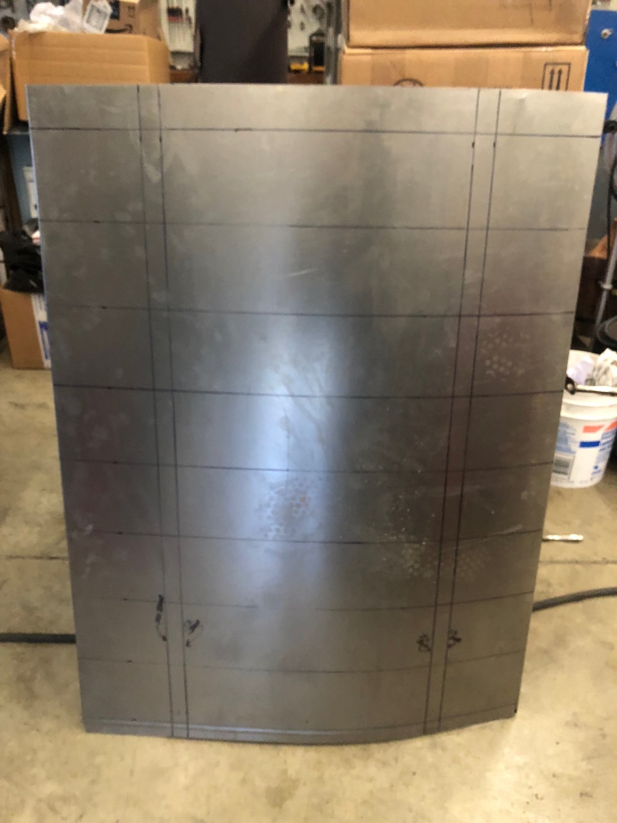

We only want to use quality steel, mild grade, clean, and 20 to 22 gauge works fine. We are now moving into layout and a few other tools that make life easier. The upper pliers are glass cutters and the large ones are duct flange pliers.
Layout is very important as it keeps things true. I have put this into my power roll machine for a strap guide using a 1/4" bead, they look really nice with these guides.

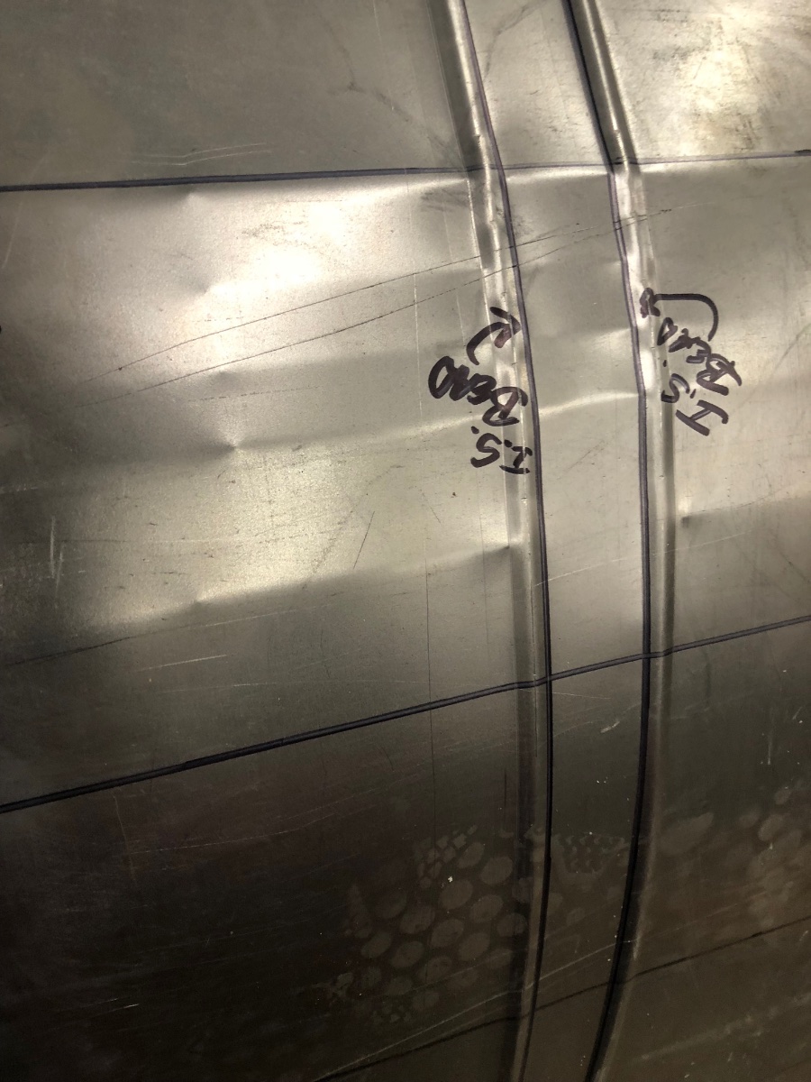

If you have noticed, I have bead rolled my complete piece first then shear again. This is because of the bead rolls line up perfectly when I resection the metal. Don't forget to file your edges after cutting, save on stitches.

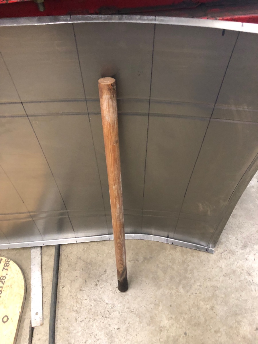

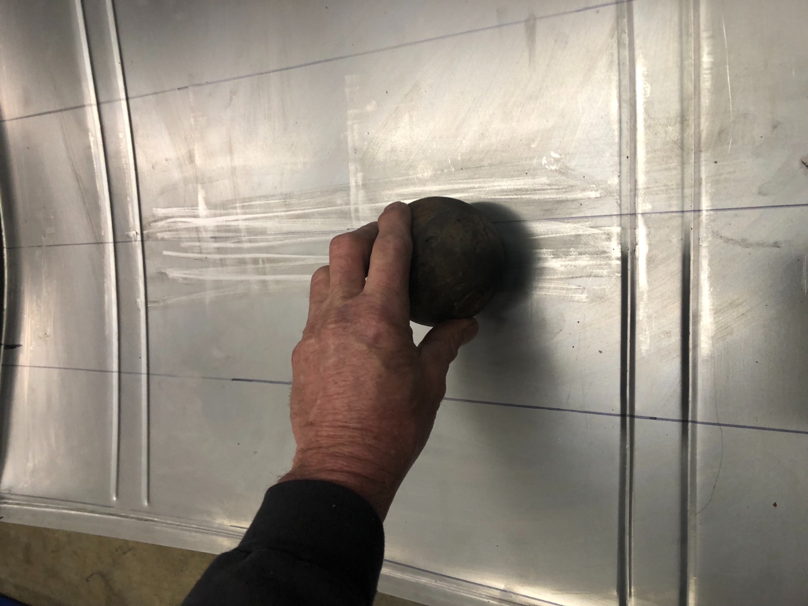

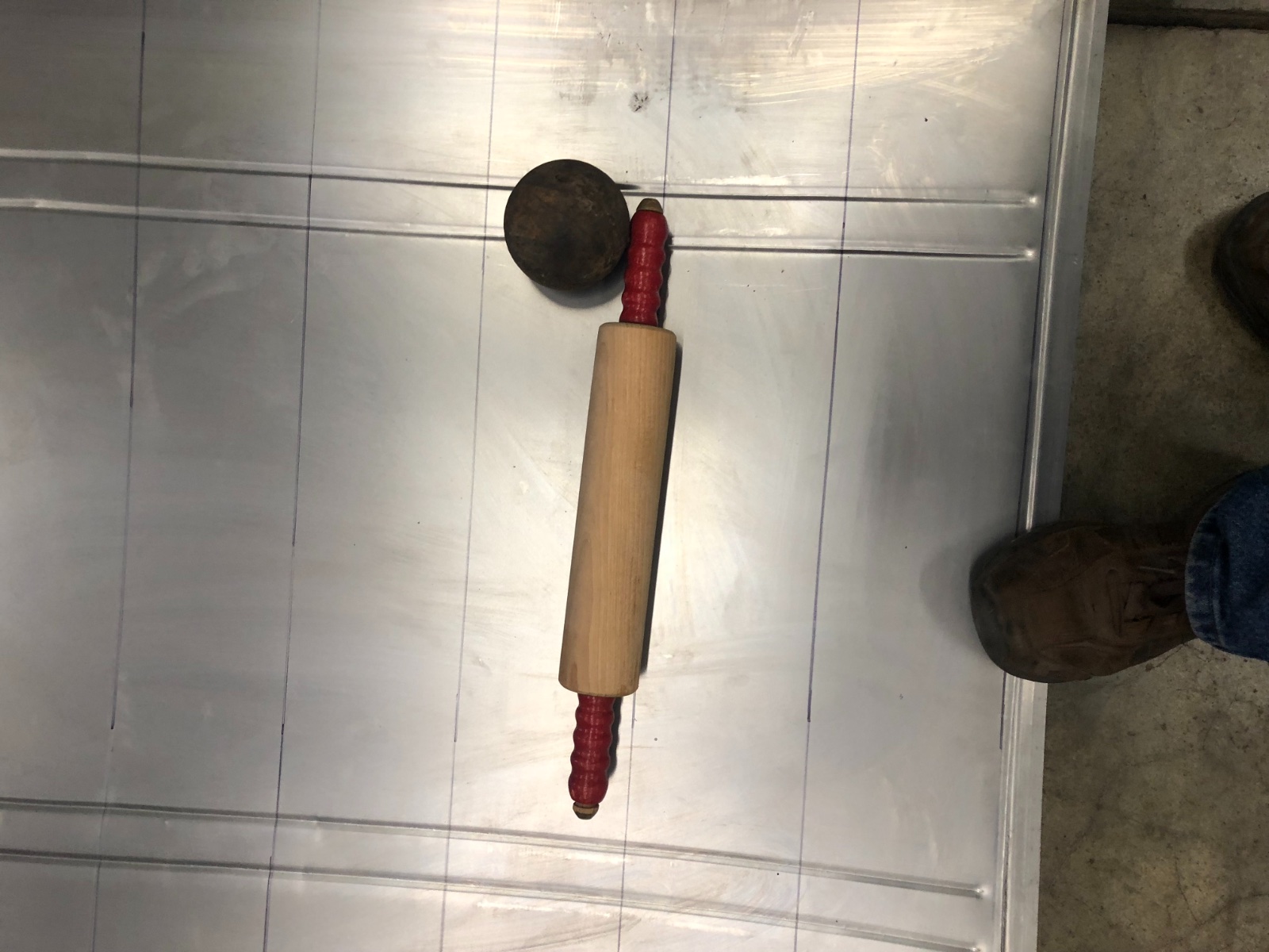

Now on a clean swept floor, lay down two 2 X 4's about 10" apart, push and rub the wooden dowel against the panel and watch your results. Using the croquet ball with a canning paraffin will help well too and the rolling pin. Don't over do it and check your results as you go.
If using a shrinker tool, do this often, and if using in conjunction with a pan sheetmetal break, really often.

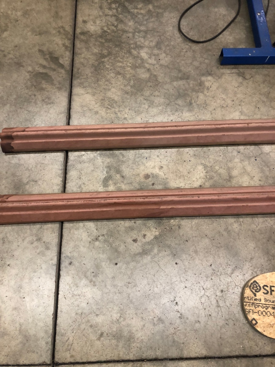

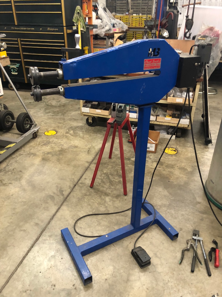

First picture is a nice power roll machine that does so much, from body bead rolls to louvers.

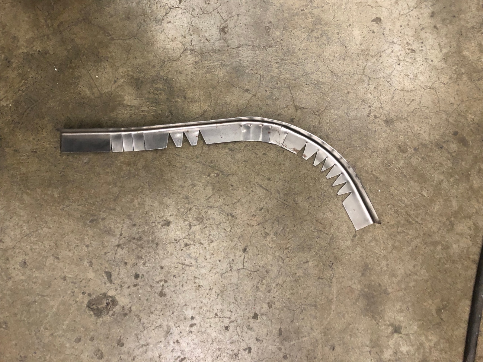

Pictures of why the fingers are removed and what happens if they are not in a pan break. Bad kinks at the tank strap area.
Sorry if I am getting ahead or behind on some items, I am still fighting a crappy sinus/chest crud. Please bare with me.
You will also notice that there are some marks that have "PC" and "PT" these are for Point of Curvature and Point of Tangent. Just layout and you can come up with whatever makes your heart happy.
