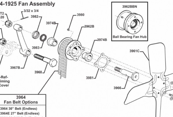

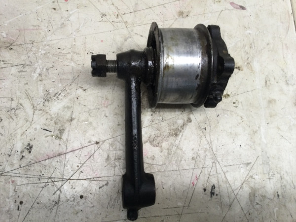

Trying to take my ‘25 fan hub apart. It’s the old style,I believe, with a grease fitting. Is the fan bracket threaded onto the fan shaft ?
Retired ... nothing to do and all day to do it.
Posts: 5431
Last Name: Gregush
Location: Portland Or
Re: Fan hub
Post by Mark Gregush » Sat Jun 05, 2021 11:53 am
Yes it is threaded on, thats what the flats are for on the fan end.

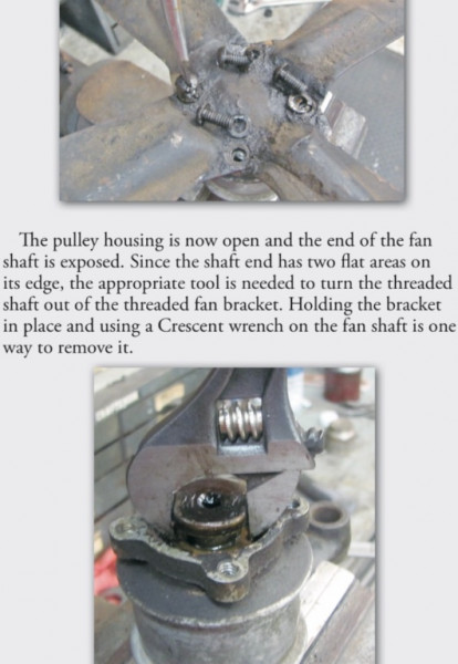

Normally a Crescent wrench can retain the fan shaft end, 3966, then just twist the bracket arm off the threaded end.

Dan, Can’t get enough of a grip with a crescent wrench as the end of the shaft doesn’t stick out far enough. Either have to make a wrench, jam to thin nuts on the threaded end or clamp the threaded end of the shaft in a vise, loosen the bracket, cut and replace the shaft.

Use a vise grip wrench and tighten down on the flats straight up. Then use a wrench to turn the crescent wrench to loosen up the hub bolt. It should come out without ruining the bolt.
Sometimes you have to use convoluted ways to remove a bolt in those kind of positions. Maybe an open end wrench with slim jaws can be made to fit.

Hmmmm.... I’ve always been able to stand an open crescent on the large ‘flats’ of 3966 and unscrew it from the bracket. Try that with # 3966 in a vise.

Same here George
If the fan hub is lacking grease and is old rusted up field variety, use lots of penetrating oil in the hub chamber and on the threaded end too.
