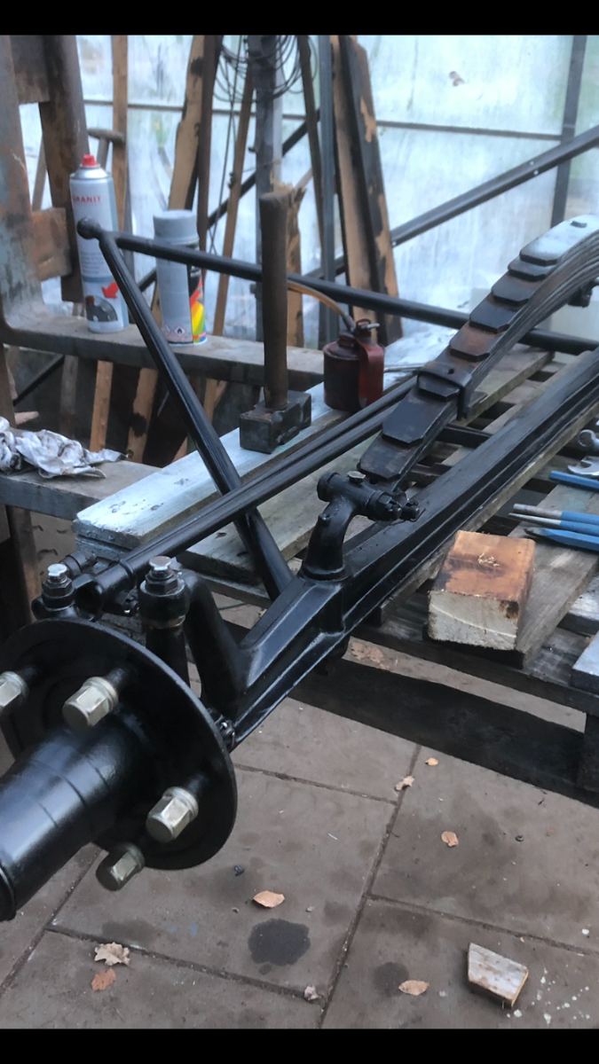

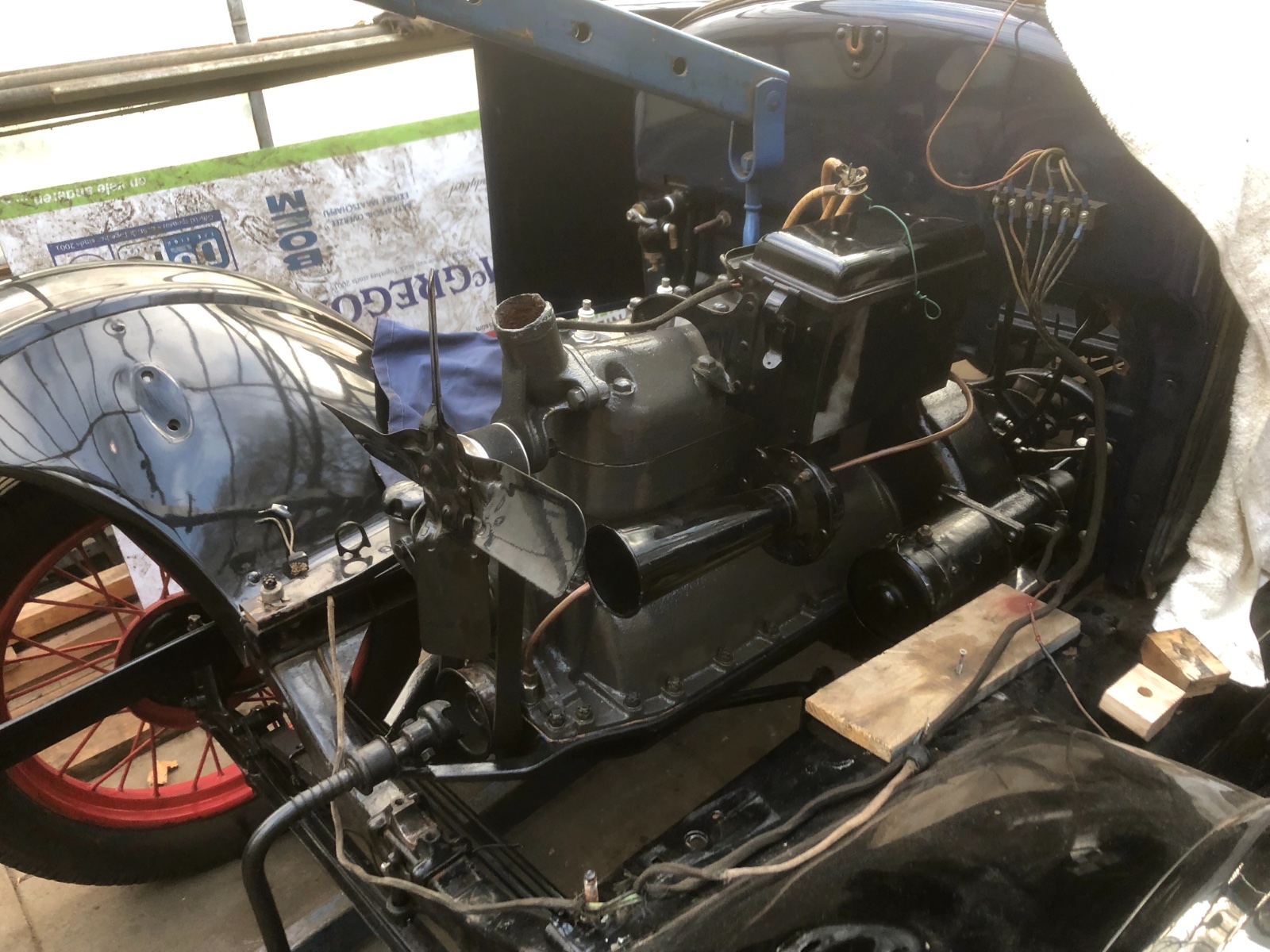

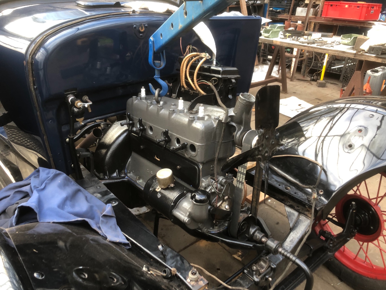

Just did this job today
Put the engine in I did it by my own, engine out and in.
Pulling out dont forget to losen the trangel from the frontaxle, I forgot it when pulling out and had no cluw why the engine stickes in the frame, stupid me...
Hit my own head when I saw my mistake, beginners fault
Succes Bert
Succes Bert

Bert, What is a “trangel” ? I need translation!
- Posts: 5470
Re: Question re pulling a 27 engine
Radius Rod.
Triangel
Maybe a bit dutch translation of the connection part frontaxle to the engine pan.
What is the correct word of this part??
Greets Bert
Greets Bert
In the U.S. it is generally called the front “radius rod”.
The slang term is “the wishbone”.
