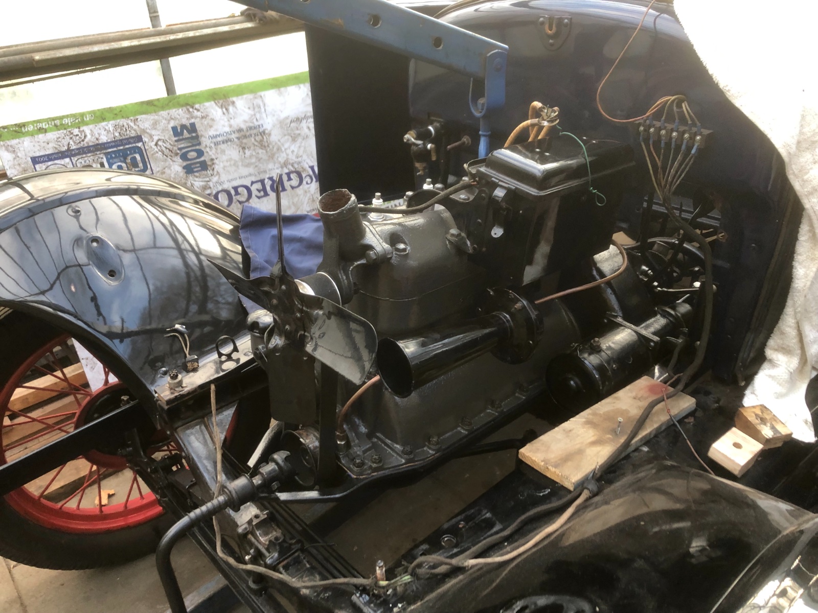

Just did this job today
Put the engine in
I did it by my own, engine out and in.
Pulling out dont forget to losen the trangel from the frontaxle, I forgot it when pulling out and had no cluw why the engine stickes in the frame, stupid me...
Hit my own head when I saw my mistake, beginners fault
Succes Bert
