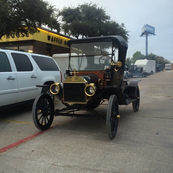

Maybe they like it mounted that way.Original Smith wrote: ↑Tue Mar 19, 2019 9:42 pmGot my latest issue today. On the cover is a beautiful 1914. Why is it so many people with '14s mount their horn upside down. Is it ignorance, or they plain don't care? At least 50% of the '14s I see are that way. Strange. Some '13s too.
1924 Touring
- Posts: 2993
- Last Name: House
Re: New Model T Times
People who point out the horn is upside down on that beautiful 1914 touring in that beautiful setting must have their “glass half empty.” My glass is “half full” and I loved the beautiful Fall colors in the foliage behind the touring. BTW, the horn on my ‘14 runabout is “bell down”.
