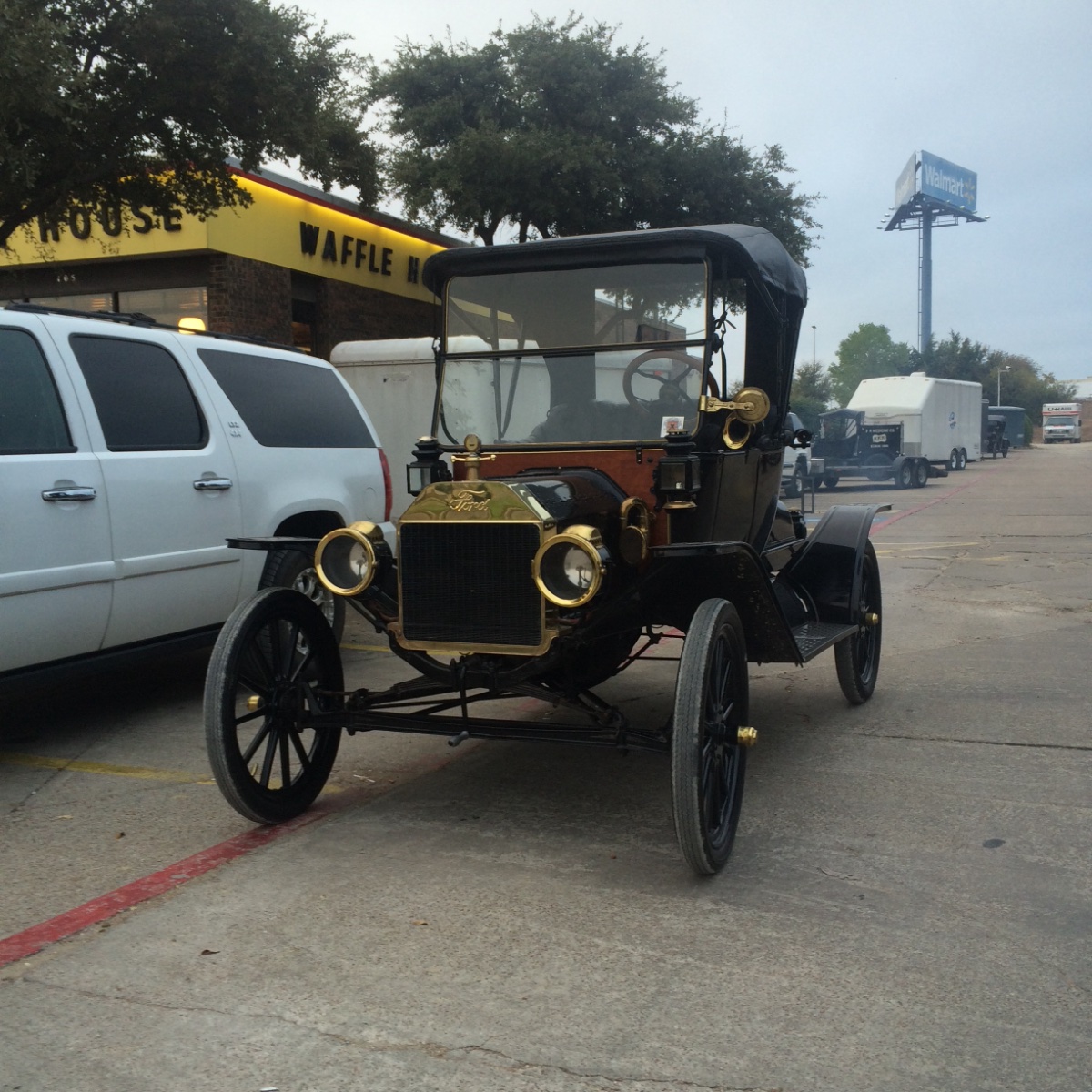

I don't find that stating the a horn is 'upside down" is very helpful without including a picture or a description like "bell up" or "bell down". Since different types of horns were mounted differently, then "upside down" depends on the car year and horn type.
Since on LHD cars, multi-twist horns were mounted bell up, and single twist (as referenced in the encyclopedia) or 3/4 twist (as referenced by the technically obsessed) horns were mounted bell down, I think that mounting a horn "upside down" would be an easy mistake, if looking at the other type of horn as an example. I am not familiar enough with RHD cars to state whether this description holds true for those cars too.
Keep crankin'
Eric
PS, my LHD '14 Touring has the black and brass single twist horn mounted bell down....
