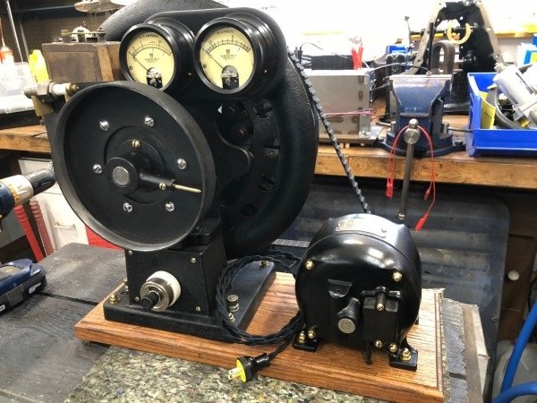

Here is what I did to mine. A small pulley on the motor and the belt around the flywheel.

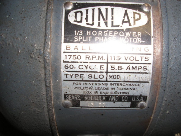

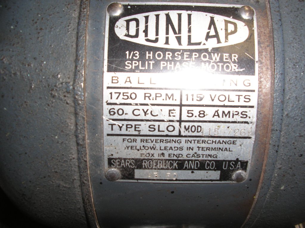

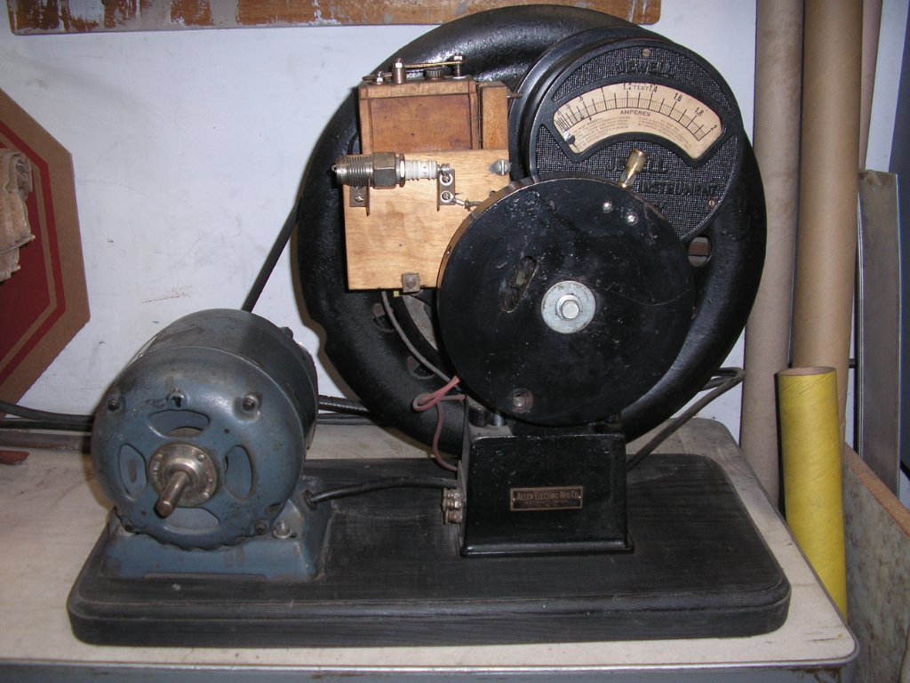

Motorized HCCT https://mtfca.com/phpBB3/viewtopic.php?t=11202

Michael,
Does it appear that the one meter configuration is original or has it been modified from a two meter configuration?
If this was originally a two meter coil tester, the second meter can be added.
Please post some more detailed photos of the meter and it's installation.

I bought the HCCT so long ago I don’t remember the details but it was cobbled up from different testers and rebuilt by a club member. All I vaguely remember is that he moved from up North to near Corpus Christi, Texas many years ago. Now that I know I can use it ok without the volt meter I am not too worried. Would really like one of the smaller ECCT units but it appears the Covid thing has shut the supplier down.
