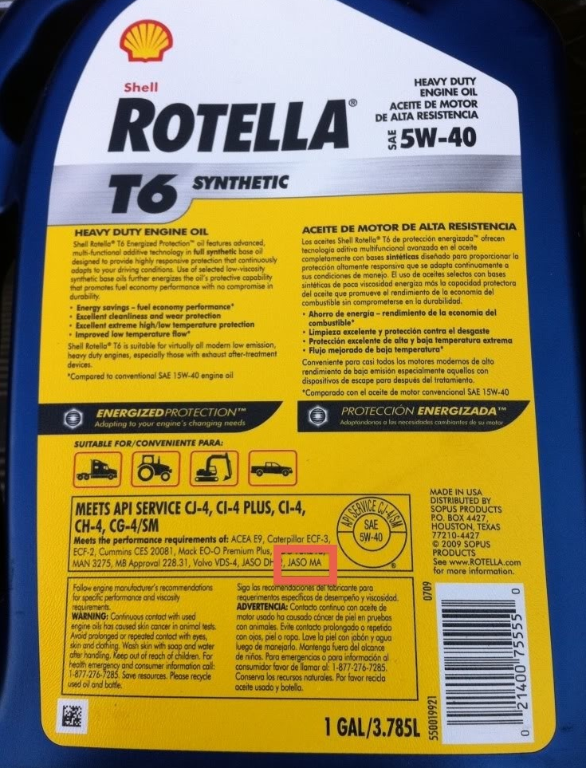

Well said and I agree that my Model T and Model A do not need ZDDP but my oil, Shell Rotella has it in there.....it can not hurt and may help like you said. Rotella is Diesel Engine oil and it is designed to hold contamination in suspension much better than regular oil due to its additive package. I have owned Diesels for many years and if you have as well you know that the oil turns coal black as soon as you change it. You need a diesel oil that keeps all that contamination in suspension. With Rotella having properties like that I feel it's a good thing to have it in a Model T.
I also use Mobile One Synthetic in my modern gas vehicles and have had excellent results with it.....without an oil filter I think Rotella is a much better choice. Please keep in mind that I feel oil is cheep insurance and I do not mind paying a little more for synthetic but I do realize that the lowest quality oil available today is light years ahead of what Our Model T's used when new.

Living in NC I think 15w40 Rotella T6 is a better Choice than 5W40 Rotella as I am never starting at temps below 30. What are your thoughts for a Model TTRDxB2 wrote: ↑Tue Nov 09, 2021 1:17 amHow soon we forget. There have been numerous discussions in the past about what "engine" oil for maximum lubrication. And ignore what effect the choice might have on transmission bands. The Model T falls into the "wet clutch" category along with some motor cycles, rv's, and diesel trucks. The recommendation for those are lubricant codes JASO MA and JASO MA2. As it has it Rotella T4(blended) & T6 (synthetic) both meet that specification.
- Posts: 8653
Re: Synthetic Oil
Read the Wikipedia, et al, articles on ZDDP. Rotella is a fine product and it is highly detergent/dispersant with good ZDDP levels. I would use 15/40 Rotella, regular or synthetic, in a T unless in very cold conditions, in which case 15/40 regular with a pint or two of MARVEL MYSTERY OIL will work well. I have had better results using Wal Mart 20/50 conventional oil in old engines with some wear on them rather than Rotella 15/40. I'd guess that the high detergent/dispersant qualities of the Rotella 15/40 may keep the worn rings and pistons too clean, allowing slightly more blowby. A little varnish/carbon on piston skirts and behind rings in worn engines can actually improve performance in worn engines in light duty service. I have had no issues with transmission bands or clutch function using full synthetic oil. As far as that goes, ZDDP, being a friction modifier, might not be a stock Model T's metal-to metal clutch's best friend. On the other hand it might very well promote smooth clutch engagement and prevent damage from mis-use. More likely, unit pressure between clutch discs would be too low to allow ZDDP to do much of anything. I don't believe ZDDP would affect band performance. ZDDP is effective between metal surfaces operating under high unit pressure, like cam/lifter surfaces in higher performance engines. I speculate that it might offer some protection to Model T transmission gears. Apparently, nearly all automotive lubricants made in the last 70 years have at least some ZDDP, and today's motor oil formulations still include ZDDP, though at reduced levels. ZDDP can be bought for use as an additive at auto parts stores. It's not clear from what I've read whether ZDDP in any reasonable amount will kill a catalytic converter or not. It is a toxic substance, and I would not recommend it for use as a table condiment.

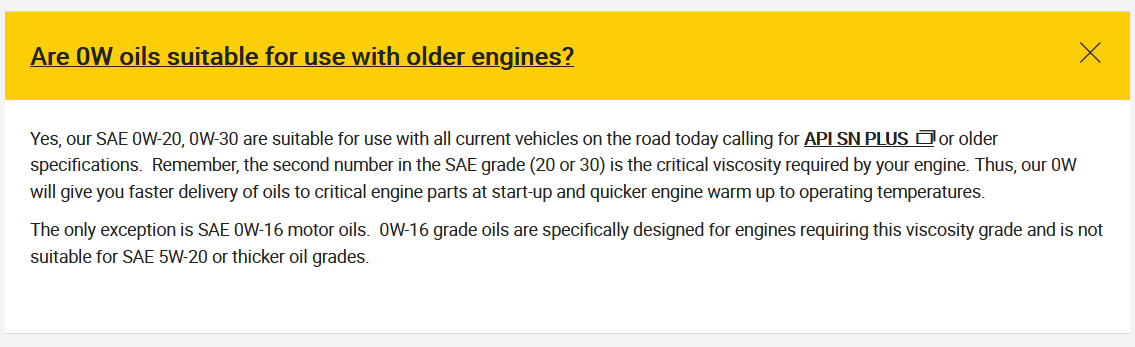

So it sounds like if you live in a cooler part of the country, 0W20 or maybe 0W30?TRDxB2 wrote: ↑Sun Nov 07, 2021 11:43 amNot a rumor but a fact. Having said that it is the oil viscosity specification that determines cold weather flow and how it thickens when it warms up. Here is an example that may get you thinking, but first put aside the synthetic vs regular oil issue. Many of Today's cars (2019 +) are recommending 0W30, yes "0W", for faster lubrication to vital engine parts when starting. So would you switch to this weight oil since it would be even better in cold weather? https://www.pennzoil.com/en_us/educatio ... -faqs.htmlgreenacres36 wrote: ↑Sun Nov 07, 2021 11:21 amRumor has it synthetic flows a little better in a cold engine. That would be a huge benefit in a splash lubricated engine I think. I use it.

5w or 0 flows easier, of course it does, but a T engine clearances are by a today's modern engine specs are worn out so flows easier in and even faster out, it would not be doing it's job as a lubricant in the design of a vintage splash engine.

Would 5w40 be a better choice as apposed to 15w40? I am asking because Shell Rotella comes in both.

Pat, the test would be miles and time, tell us what your engine is like when you have done what Dean Yoder has at a 100,000 miles on 20w50
- Posts: 6587
Re: Synthetic Oil
The first value 5W vs 15W applies to cold starting (engine as well as ambient temperature). High performance cars today are looking at 0W for quick lubrication. T6also applies to wet clutch specifications - the 40 value may be a bit high for newly rebuilt engineModel T Ron wrote: ↑Wed Nov 10, 2021 5:38 pmWould 5w40 be a better choice as apposed to 15w40? I am asking because Shell Rotella comes in both.

If 0W20 syn failed to lubricate all parts of the engine, the car never would have completed the Montana 500, which it did do. Beyond that, I don't believe that it would have stood up to the way I drive it, particularly in 95-100 F weather. I believe you would find that the film strength of a good 0W20 synthetic oil is substantially higher at oil temperatures well above 200 F than that of the best oils available in the 1920s under similar conditions. I believe that you could destroy a Model T engine a lot quicker running a heavy oil in a tight motor, especially in cold weather, than you ever would running a good multi-grade synthetic. Modern multi-grade oils with a low 1st number, and particularly synthetics, approximate the flowability characterstics that Ford engineers recommended for the Model T. They far exceed every other aspect of 1920s oil performance in any operating environment, and particularly in cold start lubrication and warmup and operating in very hot weather. Use what you like; Ts can tolerate less than ideal oils. (But stay away from the heavy stuff in cold weather!)
- Posts: 8653
Re: Synthetic Oil
5W or 0W would probably be more suitable for use in Maine than in the Carolinas. A 30W or 40W equivalent at operating temerpature ought to be fine for a T engine. I'd go with a 10W30 for break in, unless in very cold weather, in which case I'd choose a 5W20 or even a 0W20.
