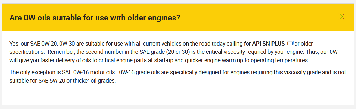

Rumor has it synthetic flows a little better in a cold engine. That would be a huge benefit in a splash lubricated engine I think. I use it.
Not a rumor but a fact. Having said that it is the oil viscosity specification that determines cold weather flow and how it thickens when it warms up. Here is an example that may get you thinking, but first put aside the synthetic vs regular oil issue. Many of Today's cars (2019 +) are recommending 0W30, yes "0W", for faster lubrication to vital engine parts when starting. So would you switch to this weight oil since it would be even better in cold weather? https://www.pennzoil.com/en_us/educatio ... -faqs.html

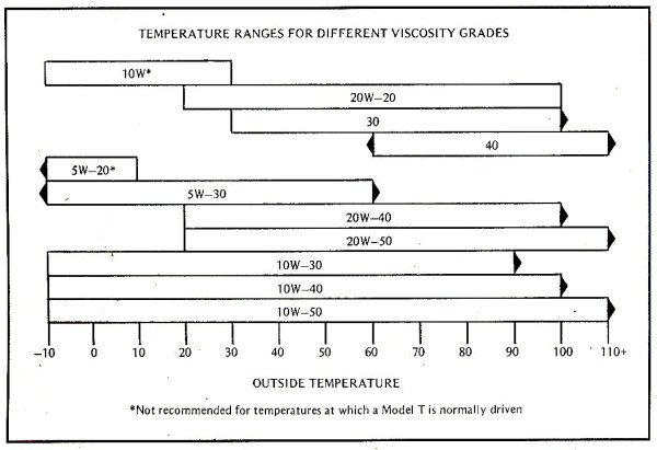

Thicker ain't necessarily better. In fact, it usually isn't. While Model Ts don't typically have the very tight clearances of modern engines, they lack a pressurized lube system. Ford recommended what would be close to an SAE 20 oil for year round use and even thinner oil for winter and warned against the use of "heavy" motor oils. As late as 1949, Chevrolet recommended 10W oil for cold weather use, and for extreme cold, they recommended 10 W oil with 10% kerosene added. In 1949, Chevrolet still used babbited rods, cast iron pistons, and a low pressure oiling system with rod bearing lubrication only a little more sophisticated than the Model T. You can burn the rod bearings out of a good Model T or Model A engine by putting thick oil in the crankcase and starting the engine on a cold morning and revving it.

I like using the screen and magnet on my cars.
I use 10-30 and I only run cars in 40f+ temps. The warm season [model t season ] here is awesome but only lasts May- October

Post by Steve Jelf » Tue Nov 09, 2021 12:21 pm
Caution: The medium light engine oil recommended by Ford was the equivalent of 20W-20. (See Royce's website for an explanation of how we know that.) The 5W-20 used in modern engines is NOT the same.
Posts: 6340
Re: Synthetic Oil
Post by TRDxB2 » Tue Nov 09, 2021 1:24 pm
I have posted the link to Royce's info multiple times in the past (years!). 20w-20 is slightly incorrect. It was called "light weight" oil which equated to 20W NON-DETERGENT OIL. They didn't have "detergent oils" then, nor the quality of today's oils. There is no longer a one-size-fits-all for a T engine, choice of oil pretty much depends on the the state of the engine, was it rebuilt?, when, with what, usage and climate. What one person uses without reference to those factors should be a consideration but not necessarily the determining factor.
