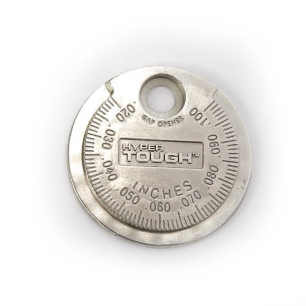

Post by perry kete » Sat Dec 18, 2021 10:45 am
I use this tool for setting gaps. Depending on where you buy it, it is usually less than a dollar.

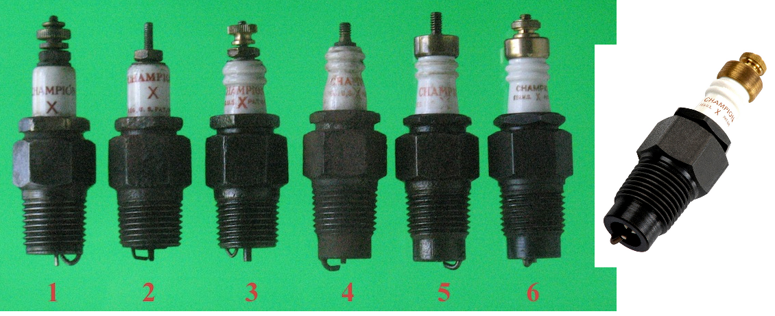

Post by Steve Jelf » Sat Dec 18, 2021 10:52 am
Most ground electrodes...are meant to be centered over the center electrode.
Not on Champion X plugs. The ground electrode should be bent upward with the end beside the center electrode. The center is not to be bent. Ford recommended a gap measured by "one thin dime" (about .032"). Many people use .025", .028", or .030".
#2 has the best preserved ground electrode and shows the correct configuration.

You might need to specify the "set" you just received, 1-6 or new manufactured. As they have said, never bend the center electrode, the curved one is intended for gap setting.

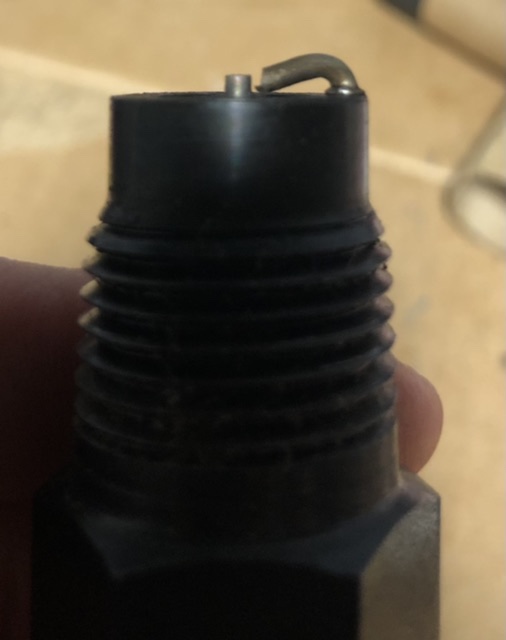

Post by MichaelPawelek » Sat Dec 18, 2021 12:22 pm
These are new production and bending the side electrode at the base makes the tip move up too much and bending the tip back to where it belongs at the side of the center electrode makes the gap way too small. The side electrodes feels much stiffer than those I have gapped in the past.

Post by TWrenn » Sat Dec 18, 2021 1:21 pm
Yep...that's the tool I was trying to describe that I use that Perry Kete showed! Handy little devil.

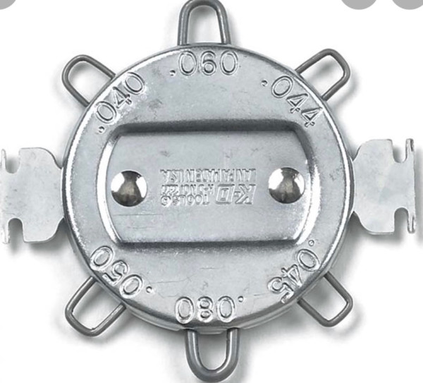

Post by DanTreace » Sat Dec 18, 2021 4:50 pm
Prefer this gap tool as the outer lever tabs can fit under the outer electrode at different spots. Makes tweaking that electrode easy. Just use real gentle pressure by rotating the disc with the tab edge on the rim of the plug to lift the electrode up or down , depending on where you place the tab.
The loops indicate the gap as they just clear the center and outer electrodes.
The one pictured isn’t useable on the T, get one with smaller dia. loops.
