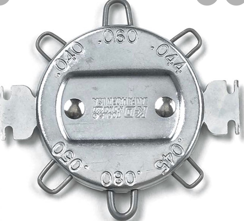

 - Posts: 3962
Re: Setting the Gap on Champion X
Prefer this gap tool as the outer lever tabs can fit under the outer electrode at different spots.  Makes tweaking that electrode easy.  Just use real gentle pressure by rotating the disc with the tab edge on the rim of the plug to lift the electrode up or down , depending on where you place the tab.
The loops indicate the gap as they just clear the center and outer electrodes.
The one pictured isn’t useable on the T, get one with smaller dia. loops.
