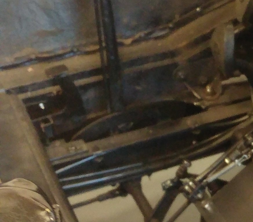

Well, in my Lizzy - when I got it - there was a hole in the inner coverage of the body, caused by the lever's upper end. The lever was able to move forward too far but I could feel that there was nothing engaged on last 2" of move. To prevent further damages, I welded a little piece of flat steel to the "ratchet bow", so the lever is now stopped 1/2" before hitting the coverage. -> Has absolutely no negative effect on High Speed clutch. I have adjusted it to have fully closed 2" before lever's end position. The lever is still free (no pressure from High in last 2" of forward move).
I also used the rear part of floor board slot for a self made starter pedal-switch, because the default location of the starter button was exactly where I place my feet during driving. So the starter button is in a safe place now, where it will not be pressed by accident, and there was no need for making new holes into the floor board. The switch itself is now located horizontally approx 2-3" below floor board level and a little bit behind the front edge of the seat (so it is below the tank apartment). It is a bad picture, but you can see the starter pedal. An emergency battery switch is located 4" above the floor board in same corner.
Self made Starter pedal
This way the never used rear 3" of the slot are now partially used by the starter pedal (rearmost 1").
I will put the hand lever into vertical position (this is a little bit before the high starts to be engaged, the picture shows the desired position). Then I will adjust the E-brake rods just enough to get the rear wheels spinning free. This should give me sufficient move to tighten the E-brakes.
I have no idea how to adjust the E brakes in my garage to work symmetric, but I will start with doing the same number of turns on every side. A fine tuning can only be done on a brake tester in next spring.

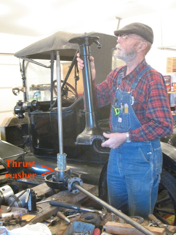

Posts: 7401
Re: How easily should rear wheels turn?
Post by Steve Jelf » Mon Dec 27, 2021 8:26 am
...where are this thrust washers located?
Posts: 2958
Last Name: Hjortnaes
Location: Men Falls, WI
Post by DHort » Mon Dec 27, 2021 3:48 pm
Hard to see in Steves picture. On both sides of differential is a steel washer, then thrust washer, then another steel washer. The steel washers have holes in them that go into pins to hold them in place. The pins are set in the differential and the axle housings.

You are not quit there with those thrust washers, as they where originally made of babbit. Now that was good when new, but eventual acid components in the old oil/grease in the rear may over time degrade the babbit so it disintegrate. You do not want that to happen as the original transmission brake then may fail. Your AC brakes may save you here, but you should at some not so distant point in time disassemble the rearend and check. Are they babbit replace with modern brass washer.

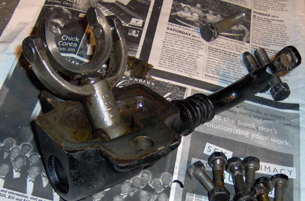

I have a neutral in my Ruckstell. The rear wheels turn as easily as the fronts.
Posts: 2548
Last Name: Strange
Location: Hillsboro, MO
Post by CudaMan » Tue Dec 28, 2021 12:50 pm
Larry, how did you achieve that? By grinding an extra notch in between the stock two notches for the shift plunger? I thought I read elsewhere in the forum that that was a no-no.
Posts: 5176
First Name: john
Last Name: karvaly
Location: orange, ca
Post by speedytinc » Tue Dec 28, 2021 1:45 pm
Correct. it makes for a very small lock notch for which ever gear you are in. Makes it very more prone to jumping to neutral. Potentially very dangerous. AND NOT ORIGINAL!!
Posts: 3917
Location: Lomita, California
Post by Original Smith » Wed Dec 29, 2021 12:32 pm
I guess if you grind too much of a notch in there, it could be dangerous. My notch in all of my cars is very slight. I've never ever been caught in neutral ever.
