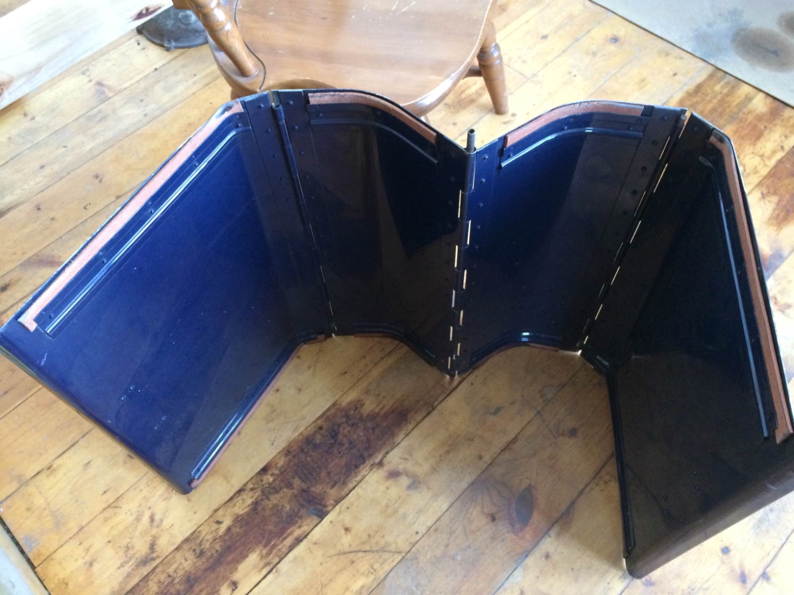

When I got my '13 runabout a couple of years ago, I replaced the "anti-squeak" leathers in the hood. They were hard and brittle as over-cooked bacon. All the heat and fumes under the hood is tough on leather. Probably a good idea to occasionally clean them with warm soapy water then apply as much saddle oil or genuine neats foot oil as they will absorb.
