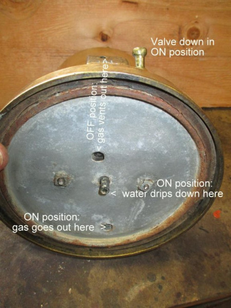

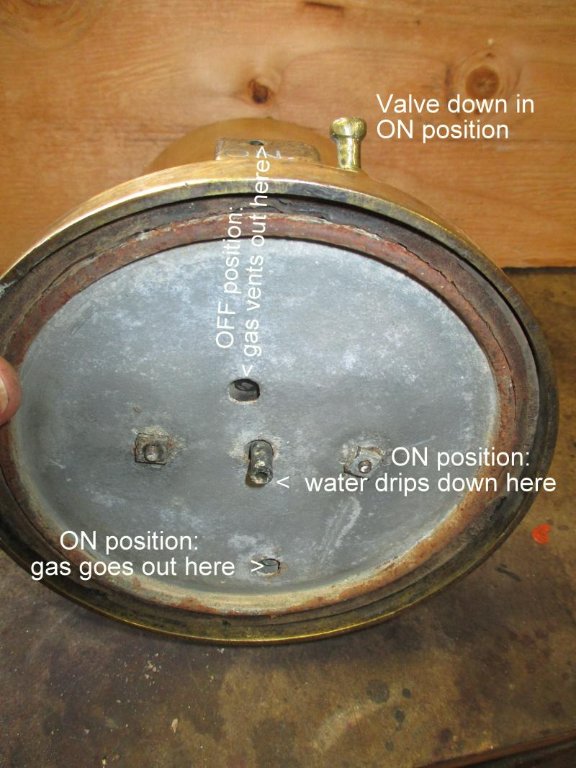

I have an E&J carbide generator. I don't know if it is an original or a reproduction.
Today I removed the top tank and filled it with water over the kitchen sink. I turned on the valve, but I didn't see any water dripping out of the center tube on the bottom of the tank. What should the drip rate be?
I have heard that the reproduction tanks are intentionally made not to function to avoid liability. If mine is a repro, how can I make it function?
----------------------- UPDATE ---------------------------
Update - Never mind, I just wasn't patient enough. After 30 seconds or so, water started dripping out the center tube at a rate of one drop every 5 seconds or so. :)

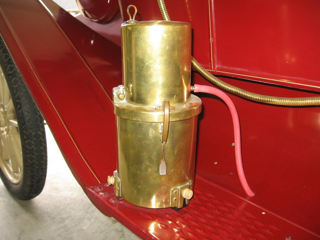

My piping system is all brass (not copper) tubing. I see the vendors offer clamps for the ends of the red rubber hose, but I have heard that original systems did not use clamps, is that correct?
Another question - is the carbide residue hot after it is used? I wonder if I could put a plastic tub in the bottom of the lower tank to catch as much of the residue as possible, or would the residue melt the tub, making an even bigger mess?
