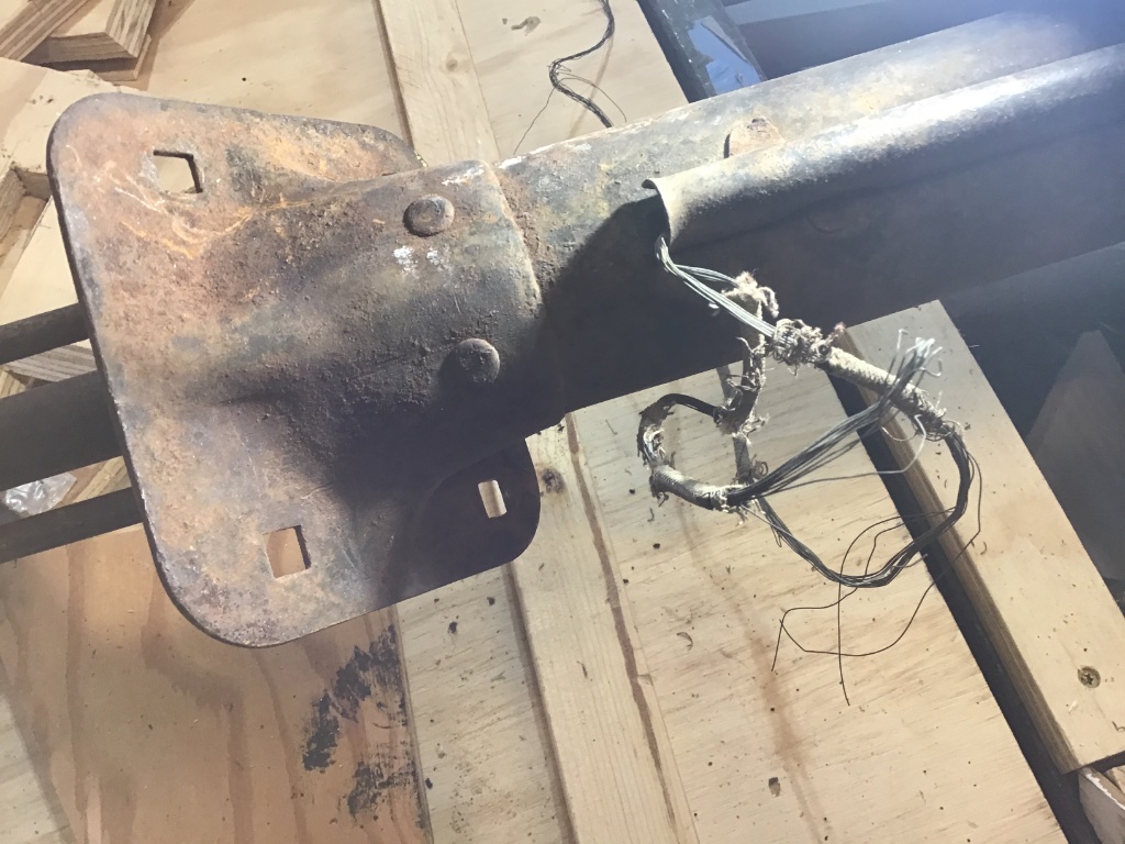

I am using a 24 roadster running gear making a pie wagon replica. I am using a 3/4 inch plywood firewall and as a result the steering shaft is to short as the spark and throttle rods are short in the steering bracket on the frame.
My question is can I grind off the rivets on the column collar move it back the needed distance and reattach?

You can accomplish the same results by shortening the top end and sliding the quadrant down. In either case, you will have redrill the control rods.
I should also mention your photo shows a 26-7 column if you’re trying to make your pie wagon look older.

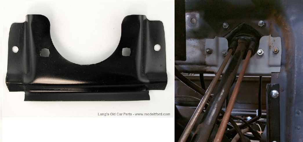

I'd think it would be easier to cut a clean hole in the new firewall just slightly larger than the column flange, then make up a piece of 1/16" sheet metal larger than the hole and bolt it to the engine side of the firewall after making holes in it as needed to attach the column flange to it. If needed, a spacer made of hardboard or plywood could be used to get the column spaced properly in relation to the steering bracket. That would avoid altering the column and dealing with rivits, and it would permit easy adjustment of the spacing if needed.

I would consider this idea. Look @ pix of 26-7 firewall steering column mounts. Make the mount in this fashion. 2 advantages I can think of are easy & complete removal, VS thru a hole that wont clear the mount and some easy versatility in getting the angle exact to your best fit.TXGOAT2 wrote: ↑Fri Feb 11, 2022 10:45 amI'd think it would be easier to cut a clean hole in the new firewall just slightly larger than the column flange, then make up a piece of 1/16" sheet metal larger than the hole and bolt it to the engine side of the firewall after making holes in it as needed to attach the column flange to it. If needed, a spacer made of hardboard or plywood could be used to get the column spaced properly in relation to the steering bracket. That would avoid altering the column and dealing with rivits, and it would permit easy adjustment of the spacing if needed.

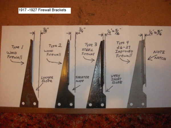

Here is something to consider that would affect the choice of the steering bracket on the frame. Also be aware that the '26-27 column does not have a replaceable bushing on the end of the column tube.
By Jeff Humble on November 11, 2008 http://www.mtfca.com/discus/messages/50 ... 1226597205
For the improved 1926-27 T's, the vehicle and the seating was lowered. When the seats were lowered, the steering wheel was also lowered, this was accomplished by changing the angle of the steering column. Now if you had a pre-1926 steering column on your 26 roadster, they either changed the lower steering column bracket at the chassis frame to allow the steering column to follow the proper 26-27 angle, or they had to raise the steering column attachment points at the firewall and dashboard. Since you are having a problem raising the steering column high enough for the flange holes to line up with the firewall holes I would suspect the firewall has been modified. Check the dimension from the top of the chassis frame to the center of the bottom column flange hole and it should be 9 5/8", that is what I measured mine at. If your firewall measures right then there is something wrong with the lower bracket where the column attaches to the chassis frame.

The suggestion that Pat made also follows how the '26 column was mounted to the firewall with the bracket below
by TXGOAT2 » Fri Feb 11, 2022 9:45 am

i would like to thank all the replys to my question on the length of my steering column. I tried txgoat2 suggestion on making the hole in the firewall slightly bigger than the flange and securing it to the engine side. It worked and now have the correct length on both rods.
