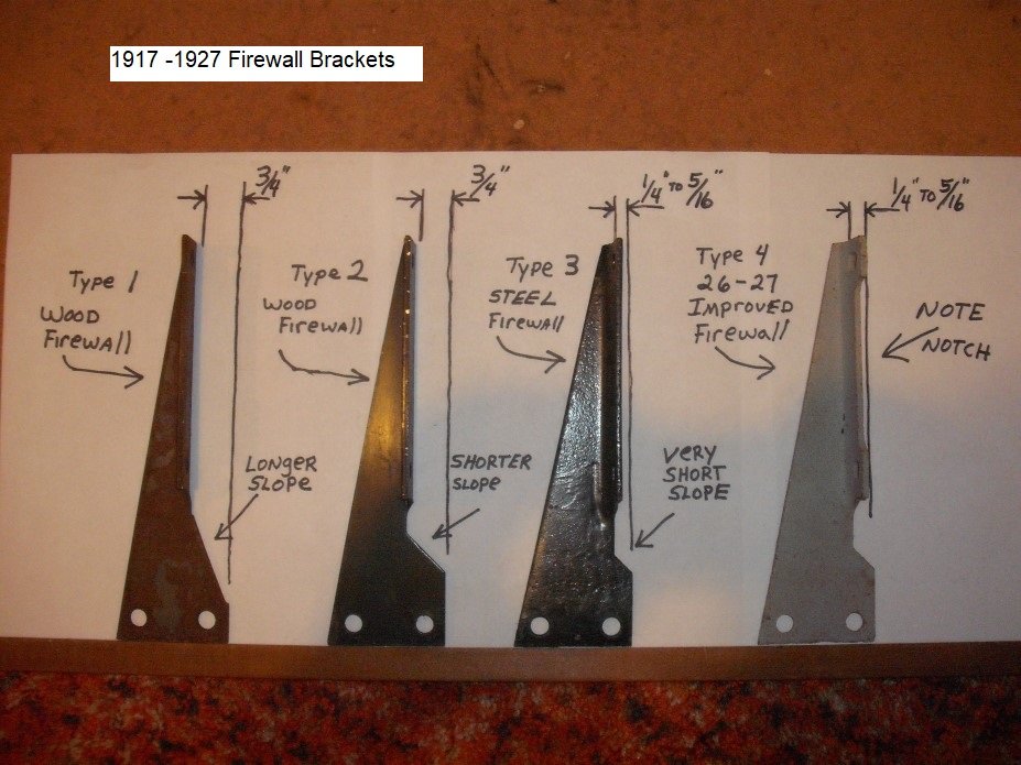

For the improved 1926-27 T's, the vehicle and the seating was lowered. When the seats were lowered, the steering wheel was also lowered, this was accomplished by changing the angle of the steering column. Now if you had a pre-1926 steering column on your 26 roadster, they either changed the lower steering column bracket at the chassis frame to allow the steering column to follow the proper 26-27 angle, or they had to raise the steering column attachment points at the firewall and dashboard. Since you are having a problem raising the steering column high enough for the flange holes to line up with the firewall holes I would suspect the firewall has been modified. Check the dimension from the top of the chassis frame to the center of the bottom column flange hole and it should be 9 5/8", that is what I measured mine at. If your firewall measures right then there is something wrong with the lower bracket where the column attaches to the chassis frame.
Also by kmatt2 » Fri Feb 11, 2022 11:44 am
A couple of things here. As has been said the steering gear in your picture is from a 1926-27 T. You will need to get the correct lower bracket that mounts to the car frame at the lower end for a 1925 or earlier car if you don’t already have one with you 1924 roadster project. I think you can get new correct length spark and gas rods from Langs for a 24 car if you need them. The next problem is that you stock 1924 car uses a high steel firewall, to use a 3/4 inch wood firewall you will need the earlier wood firewall to frame brackets used up to early 1923 with the low firewall cars. Correcting these problems should bring you steering gear position closer to stock depending on how you built your new body.

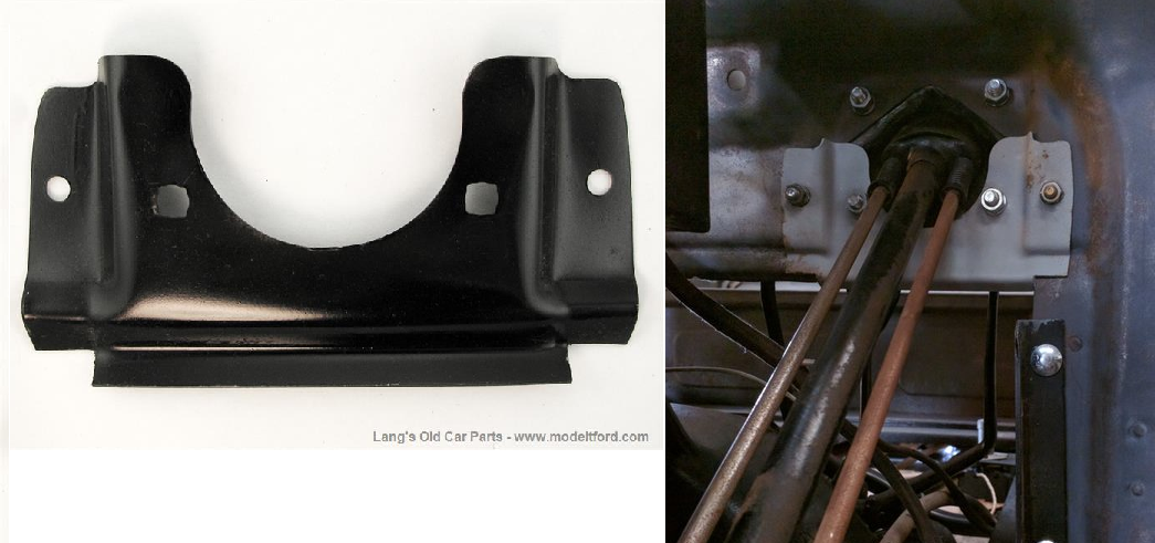

The suggestion that Pat made also follows how the '26 column was mounted to the firewall with the bracket below
by TXGOAT2 » Fri Feb 11, 2022 9:45 am
I'd think it would be easier to cut a clean hole in the new firewall just slightly larger than the column flange, then make up a piece of 1/16" sheet metal larger than the hole and bolt it to the engine side of the firewall after making holes in it as needed to attach the column flange to it
