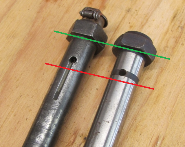

Those king bolts should have an oil passage. Typically, the hole extends down the center of the bolt to the point where the top bushing of the spindle supports the axle, and at that point there's a hole drilled perpendicular to the axis of the bolt, and into the first hole, to direct oil to the top of the top bushing and the excess flows down to oil the bottom bushing. I suspect you are already accomplishing that with your oiling technique.
If this car was mine, I would jack up the front axle to take the load off the wheels and remove one king bolt, inspect it and the bushings, replace it, then do the same on the other side. If parts are worn you will know, and if parts are good you will have peace of mind. If the non-drilled bolt is good, you could drill the passages with a hand drill, you should not need a lathe or special length twist drill.
I have seen some king bolts that were drilled deeper, to the midpoint between the bushings, but this arrangement delivers oil below the top bushing and as a result the top bushing may not be adequately oiled if only a few drops of oil are introduced. Good luck, respectfully, jb

I saw a picture where a little groove is going around the king bolt where the perpendicular drill is located.
Would be great if you (or someone else) could tell me the distance between center of perpendicular drill and bolt head and also the diameter of vertical and perpendicular drill. I guess somebody will have an old king bolt laying around?
Is the vertical drill wider to hold more oil, or is it of same diameter as perpendicular drill? I don't want to pull the oiler pot from other king bolt to measure, then it would become lose.
I thought the drill goes down the entire king bolt to supply both bushings. For that a very long drill would have been needed. But you are right, such short drill can be done on a drill-press, too. And this distributing notch can be easily grinded into the bolt.

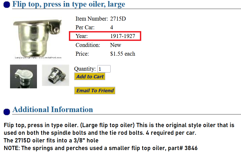

Rainer: I measured the old worn king bolt and new replacement king bolt and oil passages in both old and replacement bolts are the same. I am rebuilding a 1926 coupe. The oil passage is 5/32 Inches in diameter and it extends to the point 9/16 Inch below the bolt head. The axle is 9/16 inch thick at the top, so the lateral oil hole in the bolt is centered at the top of the bushing where it bears on the axle. That lateral hole is also 5/23 inch diameter and intersects the oil passage.
The counter bore in the bolt head for the oiler is 3/8 inches diameter by 1/4 inch deep.
My e-mail address jab35(at)cornell(dot)edu if you want to correspond directly, I can e-mail photos if you like.
Not to distract from original question, but as an engineer I'm a little bit troubled by the design, with oil passage holes removing so much material from a structurally critical part at a location where maximum shear stress is applied when driving the car. I do not have the original Ford blueprint for the king bolt, so possibly Ford used a smaller hole making the part stronger but more likely to be plugged by dirt and restricting lubrication.
Good luck with your project, jb

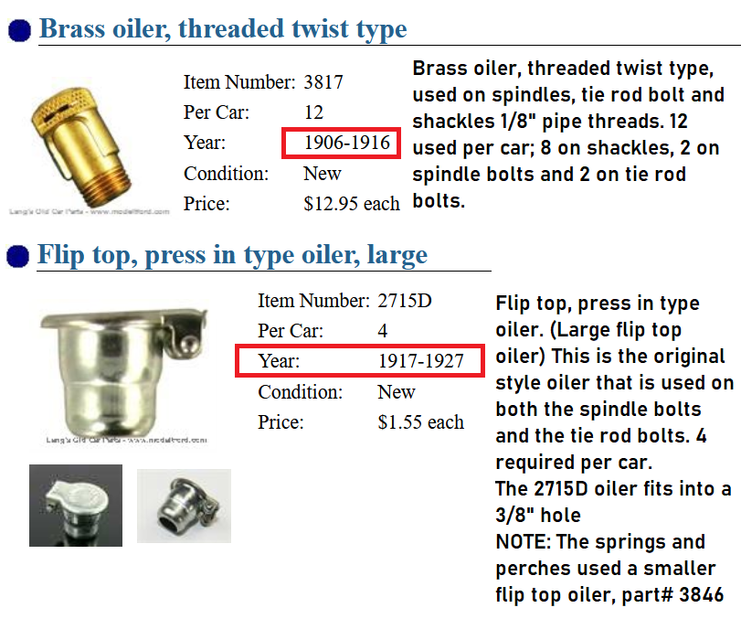

PS-Here's a pic from Lang's that shows detail of bolts they sell, in addition to hole there's a recess to channel oil
around the circumference of the bolt at the top bushing, good for oil but bad for strength in my opinion. http://www.modeltford.com/i/d/2931428l.jpg

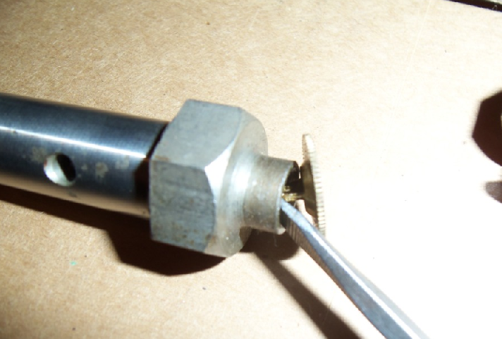

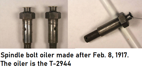

There were a few different styles of spindle bolts (king pins). One difference was based on year as noted below. The Twist style was threaded into the top of the spindle while the Flip Top was unthreaded and just pressed in. The bolts had slight different designs. The depth for the cap is about were the green line shows and the red line is a smaller diameter hole from green line to red line. The external groves around or parallel to the bolt are intended to allow the lubricant to flow to the lower bushing. ---Also as James states the oil filler hole may be plugged with dirt or even a bent flip top cap. Take a good look
- Posts: 7399
Re: Oiler on front axle needed?
And for a while between those two types they were a part of the bolt. Actually Ford used several different types of oilers. In the Encyclopedia Trent Boggess goes into detail on them.
- Posts: 5498
That type is referred to as a "manhole" oiler.
- Posts: 6549
In reading several old threads the "Man Hole Oiler" had an internal spring an rather flat cap. Nothing at all like the current style called "Flip Top". Suppliers have their oilers named.

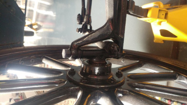

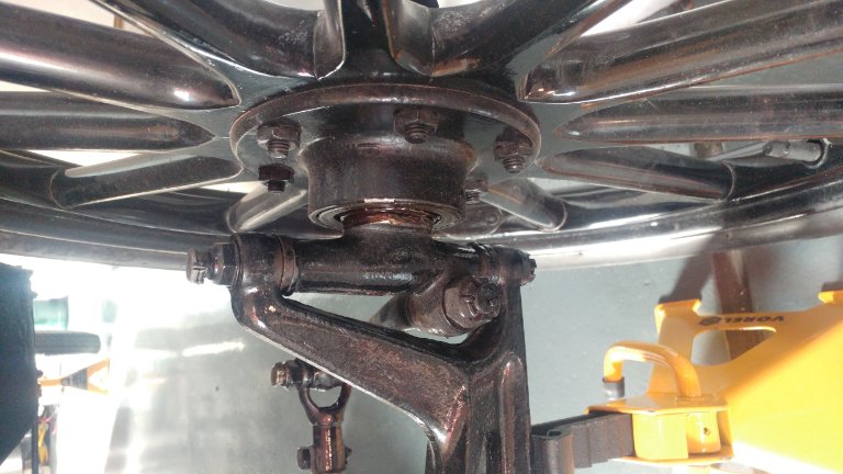

Thank you so much for this details. I have included pictures of both front wheels.
Having a closer look, the right King Bolt appears to be self made from a piece of hexagon steel. I can see the tracks caused by the steel saw on top of the bolt head.
It appears to me that 2715D oilers will be the right ones. Luckily 3/8" is very exactly 9.5mm (9.547mm), so this is luck. I do not have to buy another imperial drill, I will use a 9.5mm drill instead. For oil channels: 5/32" is approx. 4mm, also closely enough to next metric drill I have.
So I will buy a few Flip-Top press-in oilers and then start.
First I will try to get the bolt head into shape. It is really sad that 9/16" (~ 14.5mm), Into my friend's lathe up to 16mm can be fed through the spindle, so I can work on lathe (what a luck). So I will approximate the head shape and also drill the center bore on lathe.
Do this press-in oilers slide in very hard? What is the best method? I think about putting a piece of hard wood on top of it and hammer it in.
