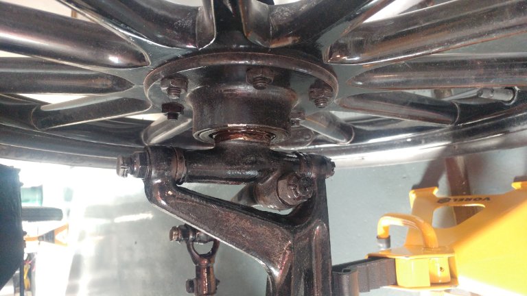

Thank you so much for this details. I have included pictures of both front wheels.
Having a closer look, the right King Bolt appears to be self made from a piece of hexagon steel. I can see the tracks caused by the steel saw on top of the bolt head.

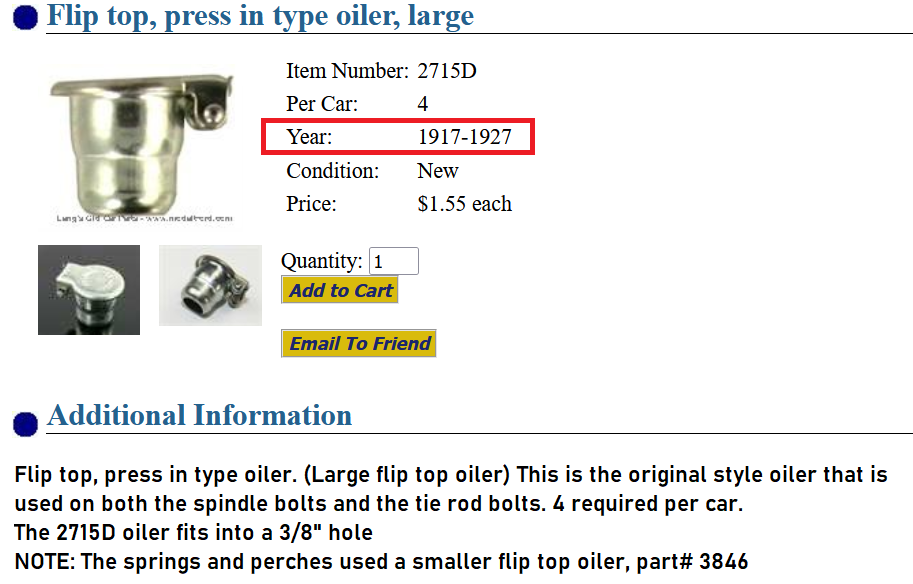

It appears to me that 2715D oilers will be the right ones. Luckily 3/8" is very exactly 9.5mm (9.547mm), so this is luck. I do not have to buy another imperial drill, I will use a 9.5mm drill instead. For oil channels: 5/32" is approx. 4mm, also closely enough to next metric drill I have.
So I will buy a few Flip-Top press-in oilers and then start.
First I will try to get the bolt head into shape. It is really sad that 9/16" (~ 14.5mm), Into my friend's lathe up to 16mm can be fed through the spindle, so I can work on lathe (what a luck). So I will approximate the head shape and also drill the center bore on lathe.
Do this press-in oilers slide in very hard? What is the best method? I think about putting a piece of hard wood on top of it and hammer it in.
IMO, wouldn’t trust that part as being properly hardened for that important part, any failure risks damages. If it drills easy as you hope just to make oiler hole passage, the it’s not hardened and drilling makes it weak for the purpose intended.
Would instead get a set of proper hardened and ground finish new king pins, bushings too, and replace both sides, reaming the bushings for fit to the pins and to the axle yokes. Do a proper repair.
One last note. There may be a reason the previous owner used that non-Ford bolt. The lower threads in the axle yoke that secures the king pin may have been stripped. A common occurrence that needs repair. That person may have tapped over sized threads there that may necessitated the use of that bolt. Check the nut and threads there, compared to the other side.

For installing flip top oilers: I have 2 different sized brass drifts I turned out on the lathe - one for the larger front axle oilers & a smaller one for the perch & shackle oilers. A hardwood dowel would also suffice I believe.
Posts: 7413
Re: Oiler on front axle needed?
Post by Steve Jelf » Sun Feb 27, 2022 1:38 pm
I use wood, on the theory that being softer than metal it's gentler on the oiler. Either way, drive it in with light taps, not heavy hits. It's easy to wreck those oilers with excessive enthusiasm.
