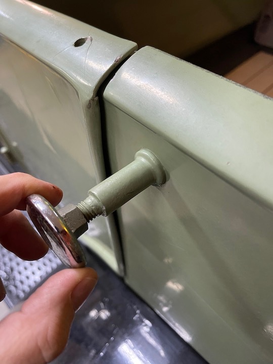

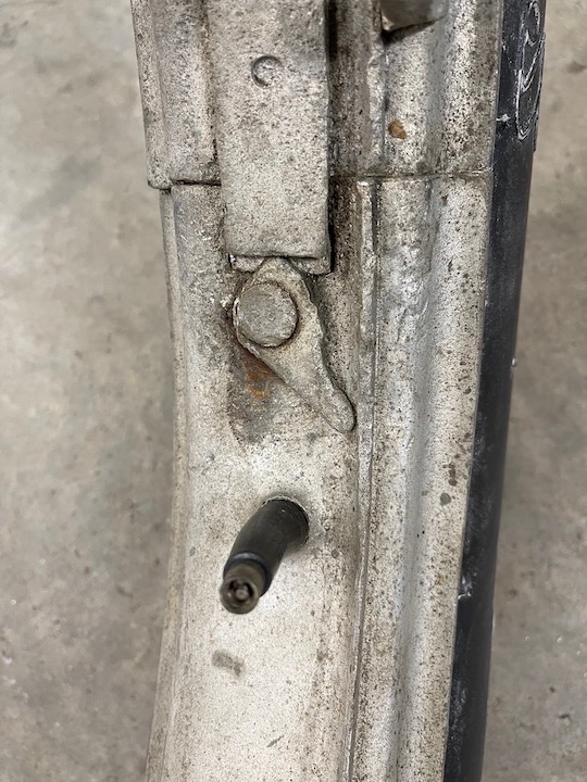

So tonight I had some more progress on Rattles. First I got the hood rod out and cut it to fit. I used the drill to get it out and back in the holes.
Then I fitted the hood. Sort of????

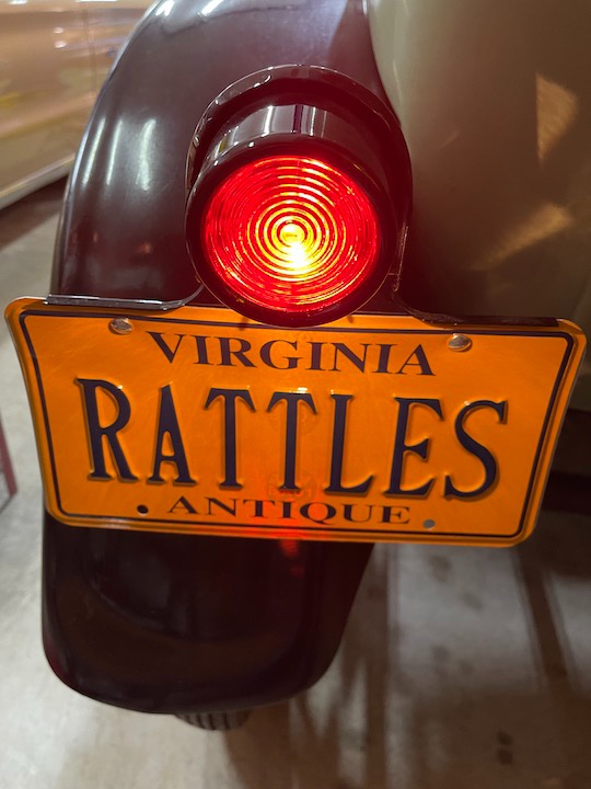

I was also able to get the back light grounded. It's still intermittent so I need to get some more of the washers that bite into the paint.

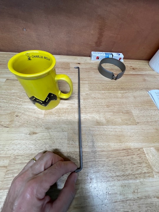

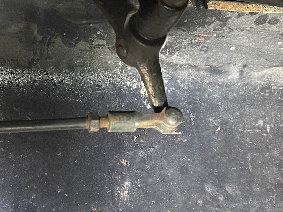

OK so today I got some of the bugs out. My throttle rod was short (because I bent it) and was also in backwards. So I started out with a new one and was able to hook it up without bending it at all.
The first thing I did was checked how the throttle lever moved without the rod hooked up. It was nice and smooth. I hooked up the rod and saw that it was rubbing the block a bit from where someone made the hole for it to pass through. It's not that bad but I wish i would have filed it down a bit when I had the motor apart. Not sure if you can see it here.
Next I'm going to do the same with the timing rod. The timer seems to rub on something when it's fully retarded.

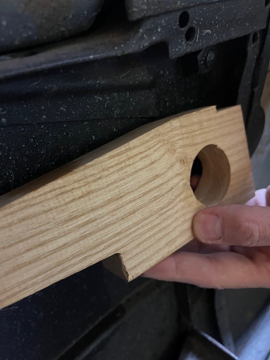

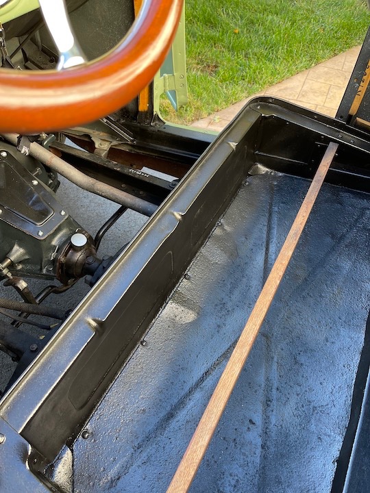

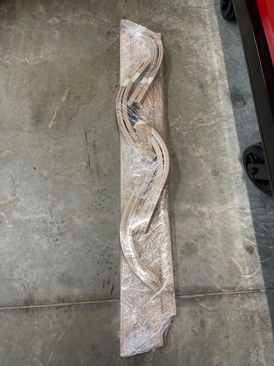

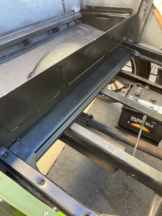

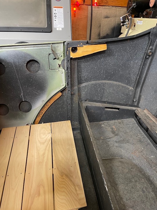

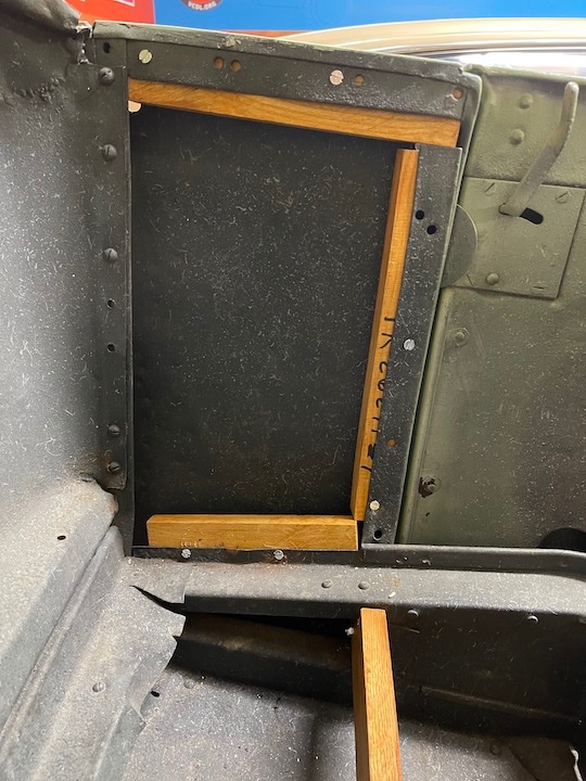

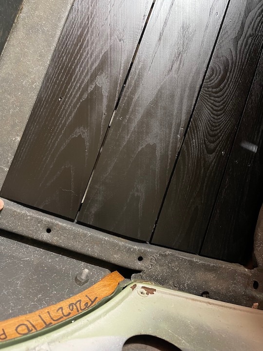

Next up my carpentry skills or lack there of. I know it's a 26/7 so it only has a few pieces of wood but I'm sure I'll mess something up. There are only a few wood parts that are labeled so I may have some questions in the future. This is the first part I'm going to tackle.

Got the sanding machine set up. I know it's a HF special that may fall apart. I just need it to hold together for a little bit. :lol:
Now I'm trying to get all the bolts that hold the wood in unscrewed. This is my second night with hitting them with PB Blaster. I got one out. Not only are they rusted they were painted when the guy before me sent the car out. I'll get them eventually.
You can see the wood is a bit thick. I'm not sure who made the body kit (It's older maybe 1980's).

So today we decided to adjust the parking break. We first jacked up the rear and put it on jack stands.
When we go under this car, this is what we found. You can see that the nut was not tightened.
Once we took the pin out we made an adjustment.
Unfortunately that didn't seem to make a difference. We adjusted them as far as they would go and the wheels still turned. I found a set of break shoes that came with the car. I'm guessing that they are the ones that supposed to be in there. When I take the tires off to change them I pull the wheel as well and see for sure. We started out thinking we were going to get something done. Ha!! If everything worked well it wouldn't be as fun.

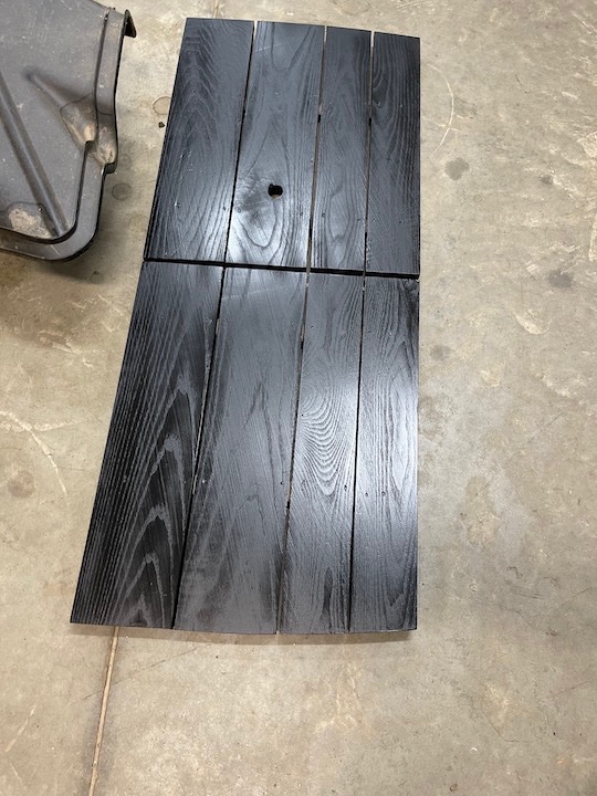

Post by Mopar_man » Mon Feb 28, 2022 6:17 pm
So sorry I haven't posted in a while. I got Covid. Not that bad just a bit of a cough and a runny nose. So I had to put the T on the back burner for a bit. I did start to work on the wood. Big thanks to Tom Miller for answering my questions. The diagram for a 26/7 touring is not that clear and my wood kit that came with the car doesn't have matching numbers. Tom has been very helpful.
I was able to shave down a machine screw and tap the hole to attach a door latch.
Tom asked me to seal the wood so I make it easier for the next guy. Ha!!
I'm drilling some holes in the wood to put them on.
Test fitting
otrcman

Post by otrcman » Mon Feb 28, 2022 7:36 pm
Robert,
Can you tell us what type of sealer you used on the woodwork ? Varnish, clear lacquer, shellac, linseed oil, etc ?
Dick
Mopar_man
Posts: 1158
Last Name: Govoni
Location: Fredericksburg, VA
Re: Getting Rattles Back On The Road
Post by Mopar_man » Mon Feb 28, 2022 7:42 pm
I used the stuff you seal a deck with. I figure that is good to leave in the weather it should be good if the wood gets wet from the rain.

Post by Mopar_man » Mon Mar 07, 2022 7:45 pm
Got some more done tonight. These went in a little more easily.
Had to file this one down a bit to fit it.

Got some work done yesterday. The first thing I did is fit the floor. I found two issues. First there was a piece of wood under the battery that was too thick and made the battery too high so the floor wouldn't fit. Solved that issue with a thinner piece of wood.
Then I painted the front and rear floors.
I also picked up some top bows at Luray. Came with the rivets.
They came from JP Auto Wood
I got my floors from him as well a few years ago. He makes great stuff and is very helpful.

We also started to fit the floor. I'll save my questions for a new post.

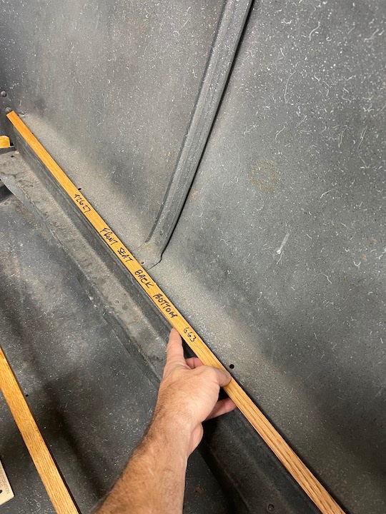

Well we're back at it again. Sorry for the delay My daughter is trying to master the stick shift in the soon to be her Jeep as well as other things. Today we trimmed the floorboards to fit. We had to adjust the hight of the small board in the middle of the rear footwell.
Then we had to cut some rusty bolts off to allow the center wood under the front seat to fit.

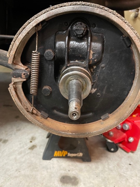

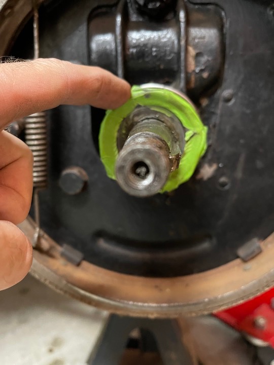

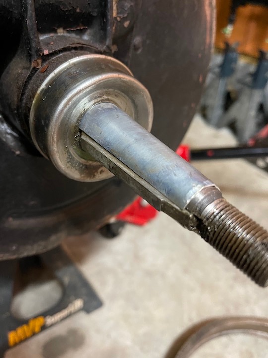

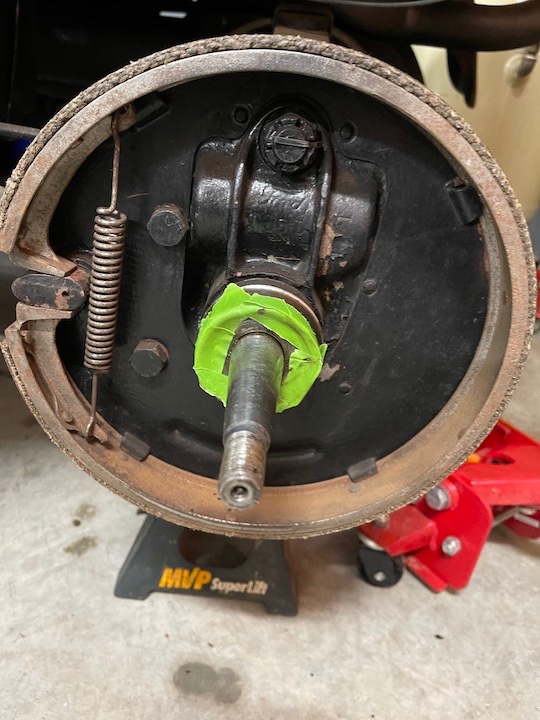

So tonight I decided to take the rear wheel off and see why the parking brake didn't work.
I'm thinking that after finding these in my pile of pars I kind of know why.
After taking off the hubcap I discovered something dangerous!!!! No cotter pin and the nut was on finger tight!!
Then the wheel just came off!! That's not how that is supposed to happen. Look what I found. No brakes!!
Now for another problem. I got the brakes on and the drum won't fit over them.
Posts: 5083
First Name: john
Last Name: karvaly
Location: orange, ca
Post by speedytinc » Sun Aug 21, 2022 8:20 pm
Make sure they are round. fit into the drums.
Note the brake cam width compared to the gap when the shoes are in the drum.

Post by Mopar_man » Tue Aug 23, 2022 9:43 am
Well I checked by placing the shoe in the drum and measuring the gap. Then measuring the gap when it's installed. sure enough I think I have the issue of the lining being too thick. It looks like the pad was in the car before because you can see that it's used a bit. I've seen people have said to sand the pad down. You would think that they would make one that fits.
Posts: 6699
Post by Scott_Conger » Tue Aug 23, 2022 10:03 am
Your one band is sprung open and may have to replace it
as for friction material, folks are simply selling what is commercially available and as you've found, it is too thick; it is one of the hobby's best known secrets
your rear wheel is going too far onto the axle and mashing into the dust cover which is a common problem. Vendors sell shims to move the hub out a bit and if the wheel is installed tightly, are perfectly serviceable.
Finally, there is a seal installed on the inside face of the drum which is ALWAYS missing...it is the same felt seal as is used for the front inner bearing...see this: http://www.mtfca.com/discus/messages/82 ... 1541507398
glad your test drive was limited and your clutch was not prone to dragging!
Mark Nunn
Posts: 1284
Last Name: Nunn
Location: Bennington, NE
Post by Mark Nunn » Tue Aug 23, 2022 1:47 pm
My '26 Runabout had shoes with pieces of rivets but no lining. I relined them with material from one of our vendors. I used a coarse 2"-wide wood rasp to take down the lining to where I was satisfied with fit. I also had to round over the lining edge on the outboard side to match the rounded corner of the wire wheel drum.
Scott mentioned the shoe that has a wide opening. The cams spread shoes at the openings. The highest stress on shoes with worn out linings is at a point opposite the open ends. Both of mine were bent out at that point, showing a gap there between linings and the drum. (I placed my shoes in a drum on the workbench as a guide to reshape my shoes.) Check, bend a little, repeat. I placed my shoes over the open jaws of a vise and gently tapped between the jaws until shoes fit well. Then I went after the linings with a rasp.

Scott Thanks for all you help! I now see that one band is open more than the other. Does the shim look like a big washer? I'm going to look for it as well as the felt washer.
Mark Thanks for your help as well. I have set the shoe in the drum and it looks like it's ok. I will have to get after the thickness of the band like everyone else.

https://www.modeltford.com/item/2505SH.aspx
Found it! Now i know what it looks like.

Post by Mopar_man » Sat Aug 27, 2022 7:35 pm
Today I got some more wood in the car and painted my windshield stanchions.
Not sure what all these little holes are for yet. One seems to be filled in.
Posts: 1674
Last Name: Seth
Location: Jefferson Ohio
Post by perry kete » Sat Aug 27, 2022 7:47 pm
Fess up and tell us the truth...Today YOUR DAUGHTER got some more wood in the car and painted the windshield stanchions! :D

Mark Nunn
Posts: 1284
Last Name: Nunn
Post by Mark Nunn » Sun Aug 28, 2022 9:56 am
The little holes are for side curtain fasteners.

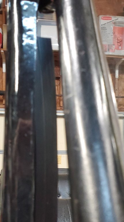

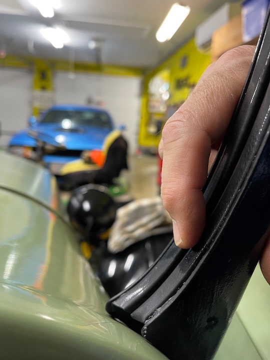

Today's work was first putting on the windshield stanchions. Is this grove for a rubber gasket?
Also what's the best way to get the nut on. My gosh I thought the nut that holds the power brake booster on a MOPAR under the dash was bad. I may have to take apart the dash again.
Today I also got the wheel on. I wanted to see if it was hitting the dust cover so I put some tape on it and tightened the wheel down. Then I spun the wheel and took it off and looked for a mark.

Post by RVA23T » Sun Aug 28, 2022 10:41 pm
Yep this is what the rubber looks like for that. Readily available from vendors.
I just learned about its availability and also just found my stanchions only have the uppers retainers and not the 2 lower ones on each side of Scarlotte O'Hara. Guess I will be in the market for some new or nice used ' 23 stanchions.
As far as the bolt...I would think small hands would be able to get them on. Must be another great feature of the "improved" car.
Upper gasket from front
Upper gskt from in car
End profile
End profile

More progress tonight! I was able to put the wood in for the front. I hope that it gives me enough wood for the interior. I can't imagine nailing to the wood. I'll have to use a staple gun. Seems like the wood would flex as you were hitting it.
I'm thinking this piece of wood goes at the bottom of the front seat.

The other thing I did tonight was looked at the rear axel. Here is what the shim loos like.
Then on the car.
I also got the felt for the hub.
Here is a video of what the issue is with the axel.
https://www.youtube.com/watch?v=4AqqNuvGjnU&t=37s

Today's adventure Getting the Touring car's windshield weather tight. :lol: :lol: :lol:
Then it was time to put the one bolt in that it almost impossible to get a nut on the other side.
Even my wife gave it a shot! :lol: :lol:

Post by speedytinc » Sat Sep 03, 2022 4:21 pm
I believe your outer seal cup is not on all the way. It takes brutal force to get them seated all the way down.
There is a low area where the hub rubbed & there is a high area @ the outer edge & I see a lot of tubing behind the cup..

Post by Mopar_man » Sat Sep 03, 2022 4:29 pm
John I'll try it again. I did tap it with a piece of wood and a small hammer. Maybe I should give it a better hit.

Post by speedytinc » Sat Sep 03, 2022 8:22 pm
I use a transmission or output shaft with flange(brake I think) & use a 3# brass hammer. Gotta be aggressive.

Post by Mopar_man » Mon Sep 05, 2022 2:55 pm
John, It worked!! I put a piece of wood on it and hit it a bit harder with a hammer and it moved quite a bit. I don't think it will hit anymore. I also sanded the shoes down. There is still a bit of a drag on them but I don't want to sand off the rivets.

Well Tonight I made some adjustments to the Emergency brakes. Here is what I did.
First I made sure that this cam and lever was to the rear.
Made sure the cam was level.
Made sure I torqued it to 120 foot pounds and look cotter pins now!!!
Here is a look at what I did.

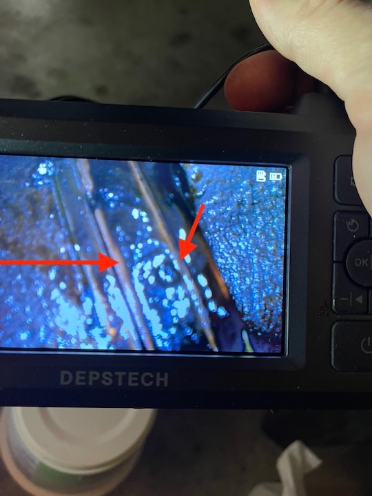

Almost forgot. I was able to scope the rear and I think i got a look at the thrust washers. Are these them? The camera was pointing to the right. I could see the gears when I looked left and I think I'm looking at them. See any Babbitt in there?

I was able to paint the parts in the interior that will show after I put the interior in.

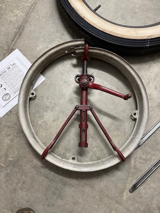

I also printed off the directions on how to use a rim split tool and think I did it correctly and didn't destroy the rim.
How hard can this be? The receipt I have for the tires says that they were put on the car in 1974.
Now all I have to do is put on 5 tires!!!

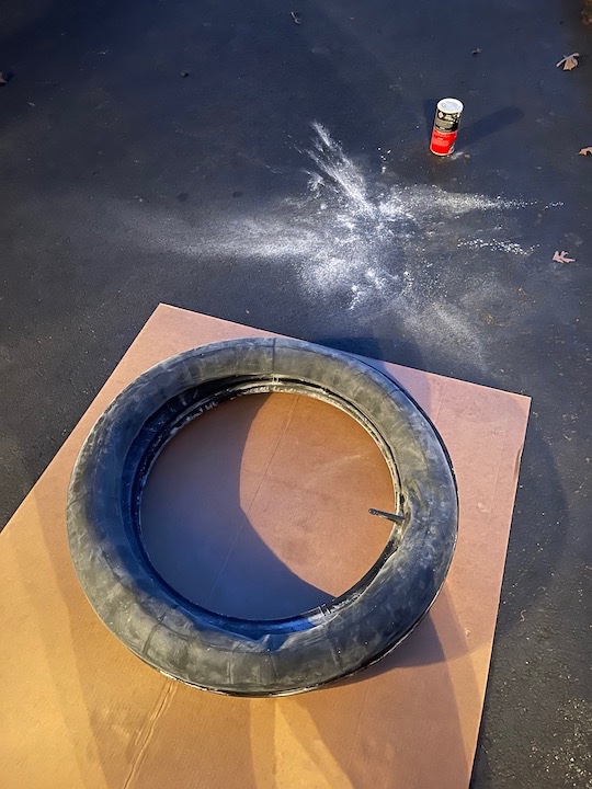

Post by Mopar_man » Thu Oct 20, 2022 8:41 pm
Got some time tonight to powder up the tires and get the tubes in them. I filled the tubes with a bit of air, then I put the tire talc in the tire.
Then I got the tube in.
The next thing I did was filled the tube up with air. this made sure that I didn't have any kinks or twists in the tube.
Next When I have some light. I'll start to take the rest of the rims off and let some air out of the tubes to put the flaps in.

We now have flaps! I decided to buy them new as the ones that were in the tires are hard.
I also picked up some wood from Ford Wood. Great people to deal with.

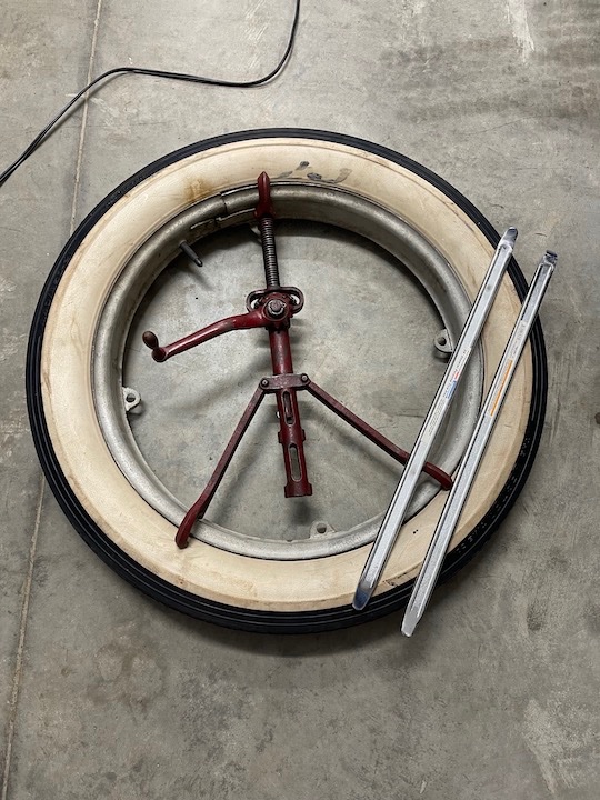

Post by Mopar_man » Sun Nov 06, 2022 12:52 pm

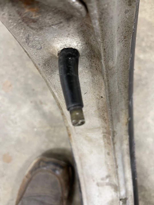

Next up was my first time putting a split rim on. The tool worked as advertised!!! I have to admit I was a bit scared that I would damage things. But it went great!!!
This is what it looked like after I was done.
I put a little bend in the stem and I think getting it to come out straight was the hard part.
Hey! Only four more to go!!!!!!
