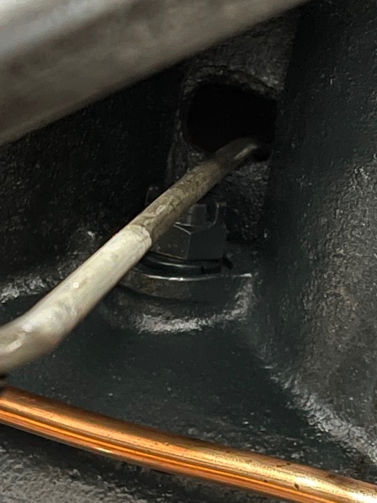

So I discovered some more.
The rod that goes between the top of the radiator and the firewall is too long and is pushing the radiator forward. I also saw that the rod is too small in diameter at the tank. So I have the wrong rod or someone brazed the wrong size receptacle on the tank. I cut the rod so it won't push the tank forward and tried the clamps again. Nope did't work.
Next up I'm off to the parts store to get two hose clamps. I looked in my stash of clamps but had non that would fit. I also saw that I need to get the clamp close to the tank to make it over the bulge in the neck.
It's going to go we didn't get this far to be stopped by a leak. Ha!!!

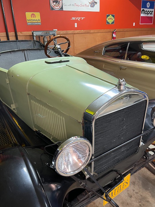

So tonight I had some more progress on Rattles. First I got the hood rod out and cut it to fit. I used the drill to get it out and back in the holes.
Then I fitted the hood. Sort of???? I was also able to get the back light grounded. It's still intermittent so I need to get some more of the washers that bite into the paint.
The the last big news....... We went for our first drive.
https://www.youtube.com/watch?v=icbmDBsMCKM

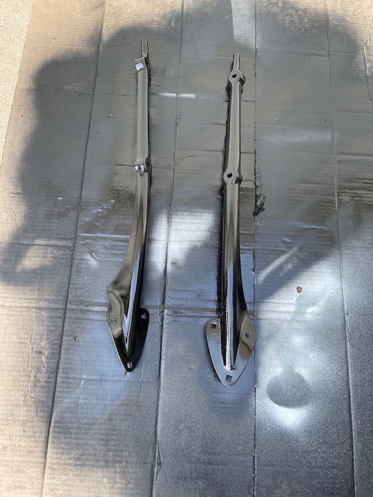

Next up my carpentry skills or lack there of. I know it's a 26/7 so it only has a few pieces of wood but I'm sure I'll mess something up. There are only a few wood parts that are labeled so I may have some questions in the future. This is the first part I'm going to tackle.
Step one was to get this off Then I sand blasted and painted these.
Now I have to fit this in. So I got a sanding machine and I think I've got a lot to sand to get it to fit.

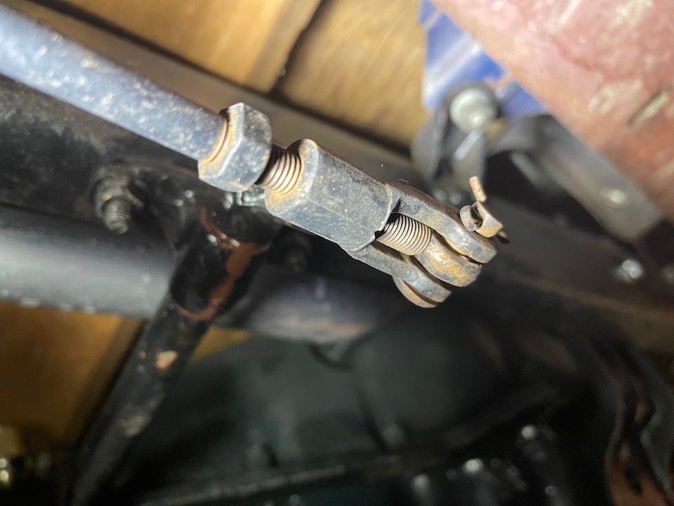

So today we decided to adjust the parking break. We first jacked up the rear and put it on jack stands.
Unfortunately that didn't seem to make a difference. We adjusted them as far as they would go and the wheels still turned. I found a set of break shoes that came with the car. I'm guessing that they are the ones that supposed to be in there. When I take the tires off to change them I pull the wheel as well and see for sure. We started out thinking we were going to get something done. Ha!! If everything worked well it wouldn't be as fun.
When we go under this car, this is what we found. You can see that the nut was not tightened.
Once we took the pin out we made an adjustment.Unfortunately that didn't seem to make a difference. We adjusted them as far as they would go and the wheels still turned. I found a set of break shoes that came with the car. I'm guessing that they are the ones that supposed to be in there. When I take the tires off to change them I pull the wheel as well and see for sure. We started out thinking we were going to get something done. Ha!! If everything worked well it wouldn't be as fun.

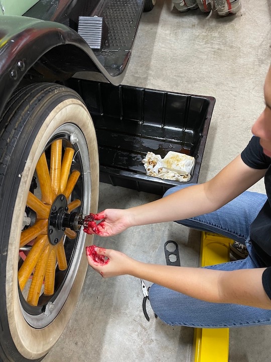

Well we were able to get out and repack the front wheel bearings today.
https://www.youtube.com/shorts/NR1JrIPZaX4
I know they make bearing packers but this is the old way. Ha!!!
https://www.youtube.com/shorts/C75zowRCykg

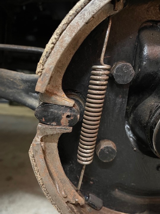

So tonight I decided to take the rear wheel off and see why the parking brake didn't work.
I'm thinking that after finding these in my pile of pars I kind of know why. After taking off the hubcap I discovered something dangerous!!!! No cotter pin and the nut was on finger tight!! Then the wheel just came off!! That's not how that is supposed to happen. Look what I found. No brakes!!
Now for another problem. I got the brakes on and the drum won't fit over them.
- Posts: 4838
Re: Getting Rattles Back On The Road
Make sure they are round. fit into the drums.
Note the brake cam width compared to the gap when the shoes are in the drum.

Topic author - Posts: 1158
- First Name: Robert
- Last Name: Govoni
Well I checked by placing the shoe in the drum and measuring the gap. Then measuring the gap when it's installed. sure enough I think I have the issue of the lining being too thick. It looks like the pad was in the car before because you can see that it's used a bit. I've seen people have said to sand the pad down. You would think that they would make one that fits.
- Posts: 6558
Your one band is sprung open and may have to replace it
as for friction material, folks are simply selling what is commercially available and as you've found, it is too thick; it is one of the hobby's best known secrets
your rear wheel is going too far onto the axle and mashing into the dust cover which is a common problem. Vendors sell shims to move the hub out a bit and if the wheel is installed tightly, are perfectly serviceable.
Finally, there is a seal installed on the inside face of the drum which is ALWAYS missing...it is the same felt seal as is used for the front inner bearing...see this: http://www.mtfca.com/discus/messages/82 ... 1541507398
glad your test drive was limited and your clutch was not prone to dragging!

My '26 Runabout had shoes with pieces of rivets but no lining. I relined them with material from one of our vendors. I used a coarse 2"-wide wood rasp to take down the lining to where I was satisfied with fit. I also had to round over the lining edge on the outboard side to match the rounded corner of the wire wheel drum.
Scott mentioned the shoe that has a wide opening. The cams spread shoes at the openings. The highest stress on shoes with worn out linings is at a point opposite the open ends. Both of mine were bent out at that point, showing a gap there between linings and the drum. (I placed my shoes in a drum on the workbench as a guide to reshape my shoes.) Check, bend a little, repeat. I placed my shoes over the open jaws of a vise and gently tapped between the jaws until shoes fit well. Then I went after the linings with a rasp.

Scott Thanks for all you help! I now see that one band is open more than the other. Does the shim look like a big washer? I'm going to look for it as well as the felt washer.
Mark Thanks for your help as well. I have set the shoe in the drum and it looks like it's ok. I will have to get after the thickness of the band like everyone else.

Today I got some more wood in the car and painted my windshield stanchions.
Not sure what all these little holes are for yet. One seems to be filled in.

Fess up and tell us the truth...Today YOUR DAUGHTER got some more wood in the car and painted the windshield stanchions!Today I got some more wood in the car and painted my windshield stanchions
- Last Name: Govoni
Ha! Don't worry she'll check my work. LOL
- Posts: 1252
- Last Name: Nunn
- Location: Bennington, NE
The little holes are for side curtain fasteners.

Today's work was first putting on the windshield stanchions. Is this grove for a rubber gasket?
Also what's the best way to get the nut on. My gosh I thought the nut that holds the power brake booster on a MOPAR under the dash was bad. I may have to take apart the dash again.

Yep this is what the rubber looks like for that. Readily available from vendors.
I just learned about its availability and also just found my stanchions only have the uppers retainers and not the 2 lower ones on each side of Scarlotte O'Hara. Guess I will be in the market for some new or nice used ' 23 stanchions.
As far as the bolt...I would think small hands would be able to get them on. Must be another great feature of the "improved" car.

Then it was time to put the one bolt in that it almost impossible to get a nut on the other side.
Even my wife gave it a shot!

I believe your outer seal cup is not on all the way. It takes brutal force to get them seated all the way down.
There is a low area where the hub rubbed & there is a high area @ the outer edge & I see a lot of tubing behind the cup..

John I'll try it again. I did tap it with a piece of wood and a small hammer. Maybe I should give it a better hit.

looking at the last picture, I see that your daughter has matured a bit during the build!

John, It worked!! I put a piece of wood on it and hit it a bit harder with a hammer and it moved quite a bit. I don't think it will hit anymore. I also sanded the shoes down. There is still a bit of a drag on them but I don't want to sand off the rivets.
Scott, Ha that's my better half.

Well Tonight I made some adjustments to the Emergency brakes. Here is what I did.
First I made sure that this cam and lever was to the rear.
Made sure the cam was level.
Made sure I torqued it to 120 foot pounds and look cotter pins now!!!
Here is a look at what I did.
https://www.youtube.com/watch?v=3EvEwXlQPRQ

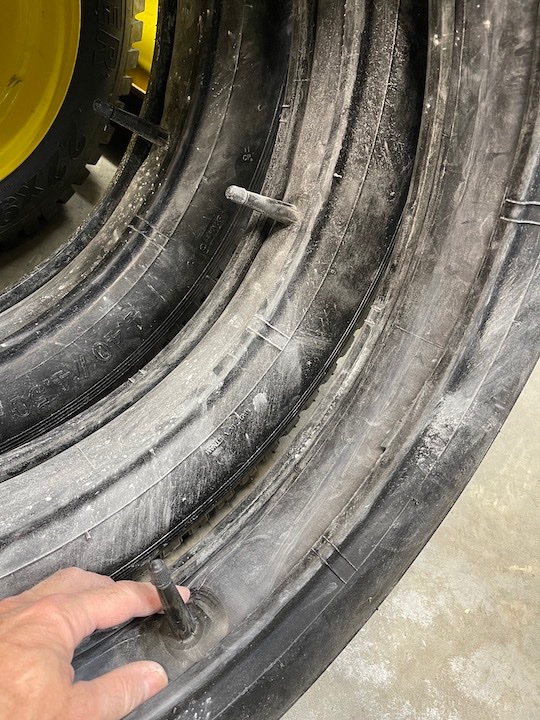

I also printed off the directions on how to use a rim split tool and think I did it correctly and didn't destroy the rim.
How hard can this be? The receipt I have for the tires says that they were put on the car in 1974.
Now all I have to do is put on 5 tires!!!

Got some time tonight to powder up the tires and get the tubes in them. I filled the tubes with a bit of air, then I put the tire talc in the tire.
Next When I have some light. I'll start to take the rest of the rims off and let some air out of the tubes to put the flaps in.
Then I got the tube in.
The next thing I did was filled the tube up with air. this made sure that I didn't have any kinks or twists in the tube. Next When I have some light. I'll start to take the rest of the rims off and let some air out of the tubes to put the flaps in.

Next up was my first time putting a split rim on. The tool worked as advertised!!! I have to admit I was a bit scared that I would damage things. But it went great!!!
I put a little bend in the stem and I think getting it to come out straight was the hard part.
Hey! Only four more to go!!!!!!
This is what it looked like after I was done. I put a little bend in the stem and I think getting it to come out straight was the hard part.
