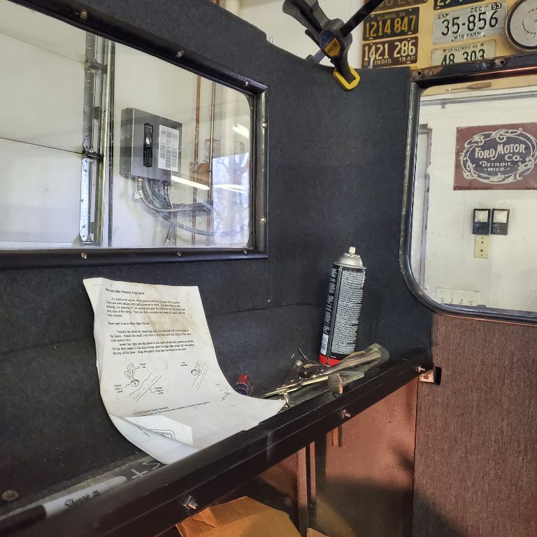

Looking for some pictures/advice on how the upholstery is glued to the package tray. I have the later steel one with the single wood bar on the front.

Spray glue cloth to tray. No need to fold over or trim the edges since they are covered by side wall panels. Do not know if the wood strip on front of the tray is covered or not. Covering the wood will make it more difficult to move the seat back to the foward or back position so I didnt cover it.

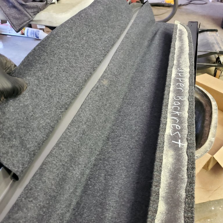

This is what I got. The flat part has cardboard backing on it but I am wondering why the material doesn't go further up? I was comparing the piece for the lower window and it seems like there will be enough but it doesn't seem right that it would be two pieces?
Also, I have this upper backrest piece that I don't know goes where?

My metal tray is similar to yours. I covered the entire metal surface with cloth including the flange in the back. The tray goes in the car prior to the upper side panels, so when the side panels go on they cover the rear flange of the tray. Do not know why you have a separate cardboard piece, but there were several versions of package trays including all wood, perhaps the wood tray uses that cardboard piece.

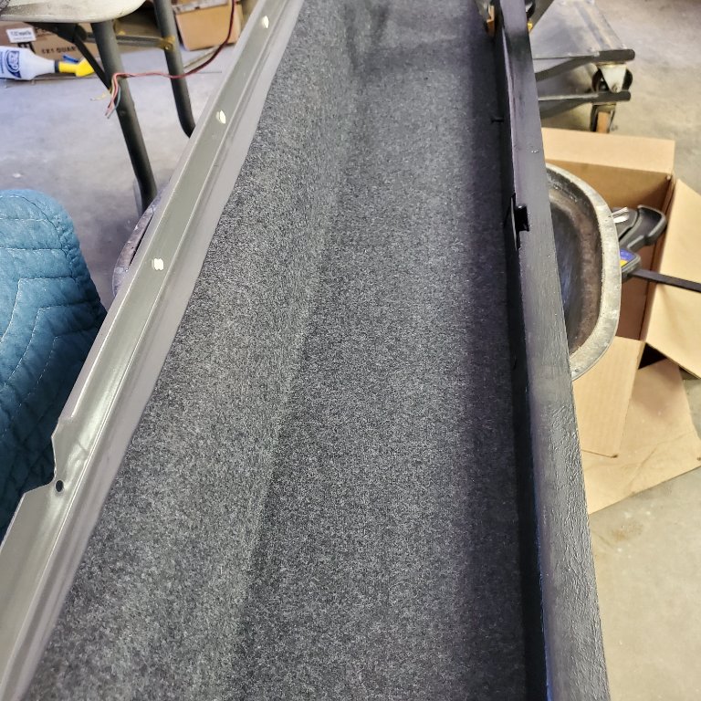

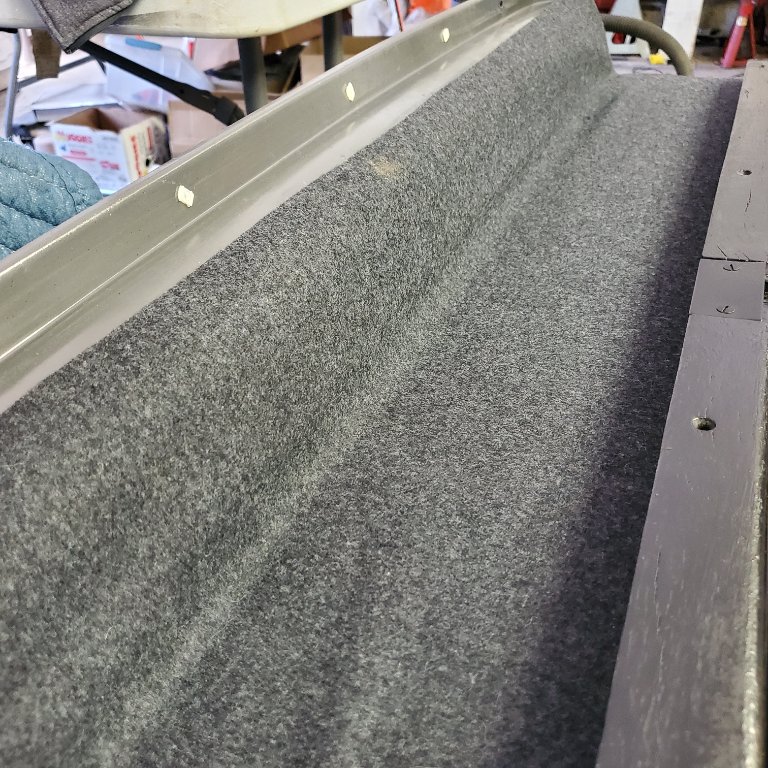

I moved the panel back as far as I could to the bend at the back and mounted the wood. The material will only come up to where it is at in the pictures. Is this a problem?

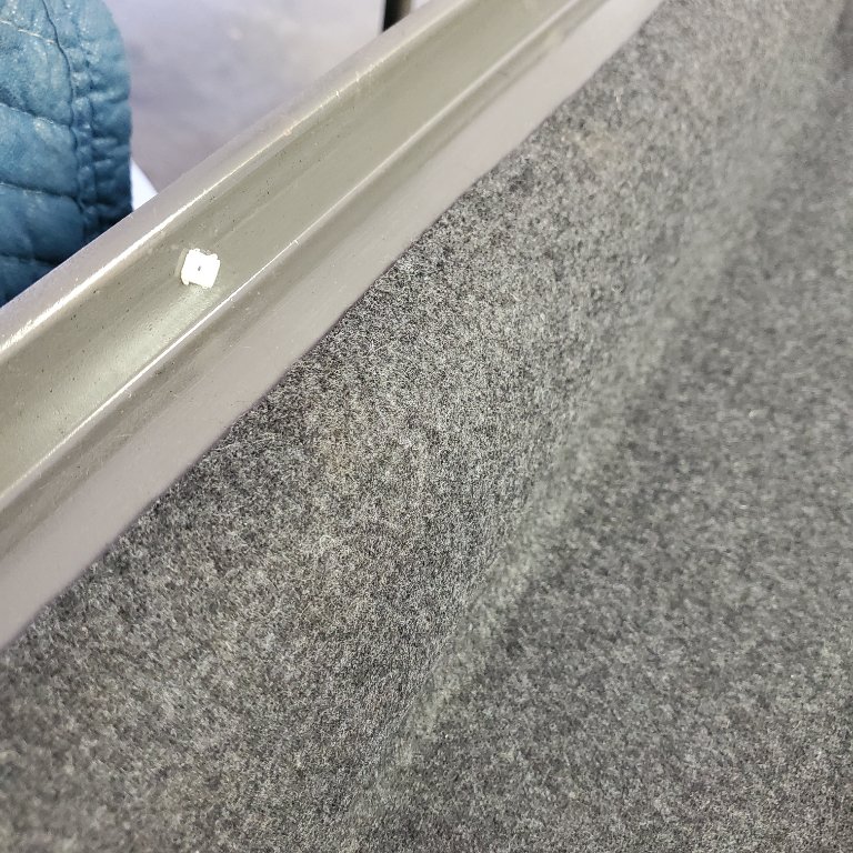

Yes that is a problem, it needs to go all the way to the outer edge of the flange, you are about 2-3 inches short.
Is the wood in front of the tray or on the tray?

Post by pron022020 » Tue Mar 15, 2022 10:59 pm
I ended up doing the best I could with what I had as I could have used a little more material. But the result looks great and it will work for an all original car.
