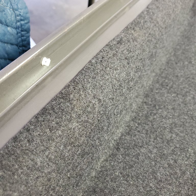

Re: 27 Coupe Package Tray Upholstery
This is what I got. The flat part has cardboard backing on it but I am wondering why the material doesn't go further up? I was comparing the piece for the lower window and it seems like there will be enough but it doesn't seem right that it would be two pieces?
Also, I have this upper backrest piece that I don't know goes where?
I moved the panel back as far as I could to the bend at the back and mounted the wood. The material will only come up to where it is at in the pictures. Is this a problem?
- Posts: 2061
- First Name: Jeff
- Last Name: Humble
- Location: Charlevoix, Mi
- Board Member Since: 2006
Yes that is a problem, it needs to go all the way to the outer edge of the flange, you are about 2-3 inches short.
Is the wood in front of the tray or on the tray?
