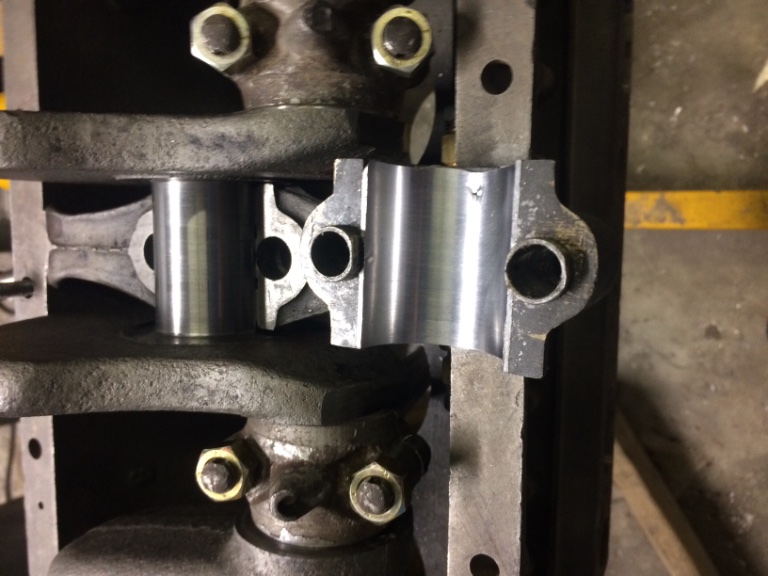

UPDATED: Through an old timer at my engine parts supplier - New England Engine, I've found out which Onan engine used these bearings. They are 1" wide and available in 1.626" std. size and -.010" and -.020" under. As you can see in the photos, three sets of these bearings are used for the rear main and the center and front main use two sets spaced apart and that space is used for the oil groove.
The thrust surfaces on the rear main are machined out of 660 bearing bronze and attached with machine screws.
Photos by Fred Hoss in the Vintage Ford Volume 23 Number 5

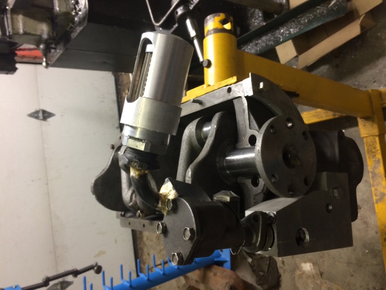

Recently I have switched to using Flathead V8 oil pumps driven of the back of the camshaft. Eliminates any concern about pump priming loss.

If you are going to run shells then cap alignment is VERY critical. A solution is tubular dowels. Attached picture
My V8 pump installation
I always run the oil lines so they feed from the block side

This is the crankshaft, and it's a late-'20s DOHC Fronty crankshaft that is part of the Fronty engine that was one of two engines used in the racing car. It is extra heavy-duty and supposedly was made to stand up to the power of the single-cam S-R and DOHC heads, and both the mains and the rod journals are 1.625."
The pistons are also Fronty, although #4 has been changed and has a slightly different dome, probably done to make a race in time. It has a dry-sump oiling system with an original two-stage pump driven by the timing gear and uses an oil tank. I've used similar, but smaller Ford V8-sixty pumps in a couple of Mercer Raceabout engines like you have done with T's with excellent results.
I'm going to machine the main bolts out of 4140 and set them up so they are a very snug fit in the caps if I use these inserts, which will locate them since there isn't any room between the bolts and the inserts for tubular rings, which do work well. I've made plenty of new insert bearings https://theoldmotor.com/?p=149961 in the shop and sometimes don't cut them on the center but offset the cut, so the inserts in the block stand above the parting line and serve to locate the cap. Did an SSK Mercedes engine once and learned how they handled locating the caps.
