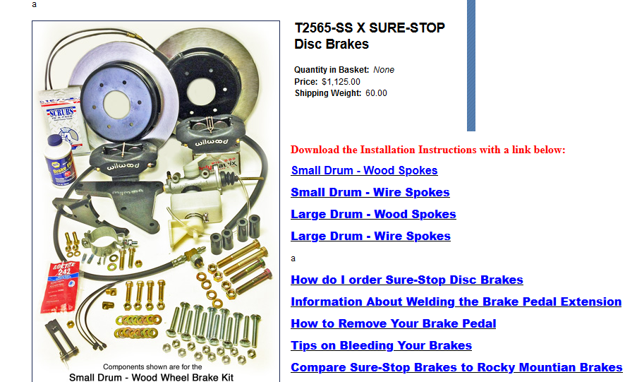

Best is relative
Most effective and easiest to modulate would be disk brakes but there is the obvious downside if you are concerned about authenticity or appearance. I would seriously consider them for my car if I didn't already have a good option in place.
Rocky Mountain brakes as produced in the last 25+ years work well when going forward and dry. My experience is they are poor at best in reverse or when wet. At least they look like they could be an authentic accessory. I used them for several years and understood them so they were "OK".
I have no experience with the AC brakes but understand they work for both forward and reverse, don't know about wet.
On a '26 or '27 large drum car the hand brake is an effective backup plan if the linings and drums are good and you can actually react to use them. With pressed steel drums, riding them or over use can cause significant brake fade.
Some folks have developed hydraulic drum brakes over the years for both front and rear wheels but there are no commercially available kits. Somewhat significant modification is required, especially for front wheel brakes. These require understanding what you are doing in the design as well as accepting some personal risk.

I installed disc brakes after two scary experiences in the hills of southern Indiana. I absolutely love them. Being hydraulic they require no adjustment and in the unlikely possibility that the hydraulics fail, the original brakes still function. The advice to drive like you have no brakes is good, but if a situation arises, you want the best brakes you can get.

My advice is to install hydraulic disk brakes and forget about it.....unless you are obsessed with originality. I am a "city driver" and I wouldn't drive my T without disk brakes. Good luck.

No disc brakes here Gracie's dad......I just cant do it to this car......Gracie'sDad wrote: ↑Tue Apr 12, 2022 2:13 pmMy advice is to install hydraulic disk brakes and forget about it.....unless you are obsessed with originality. I am a "city driver" and I wouldn't drive my T without disk brakes. Good luck.

I'm sorry if I have upset some of you. The post wished to obtain people's opinion on "BEST BRAKES", I did that. I AM "obsessed with originality", that's why I drive a 100 year old automobile. I have great reverence to early automotive engineering and all that it represents. But loading up loved ones destined for a leisurely drive and probably ice cream in my beautiful 99% original '23 Touring with minimal braking power is nuts. Compared to all other vehicles sharing the road, the Model T is already inherently unsafe in nearly all regards. I feel an effort to improve stopping power is not unreasonable. I don't care if you use Rocky Mountains, Fred Flintstones or any other device that is capable of retarding "T" forward (or reverse) motion it is a damned good idea. For me, I love my disk brakes. You have my blessing to operate your vehicle any way you wish.
