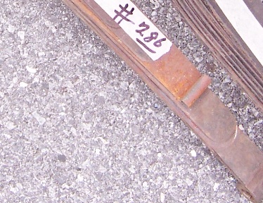

Thanks! I didn't have a clear picture of the leaf with the end rolled up.
