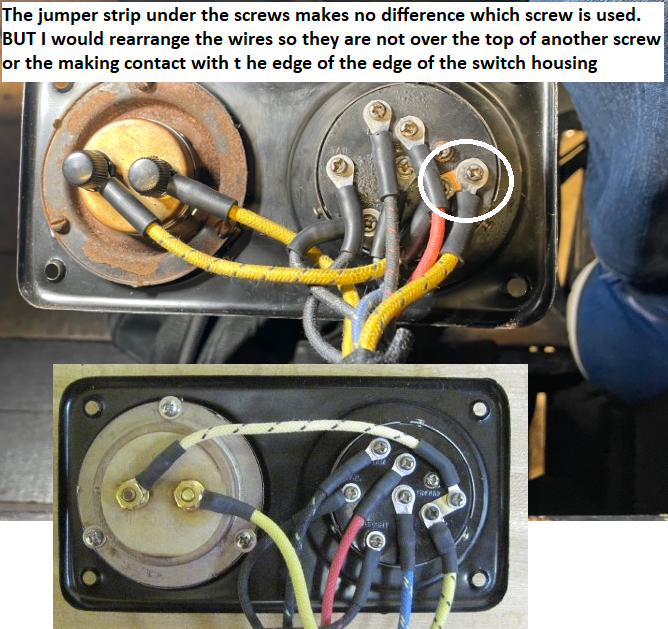

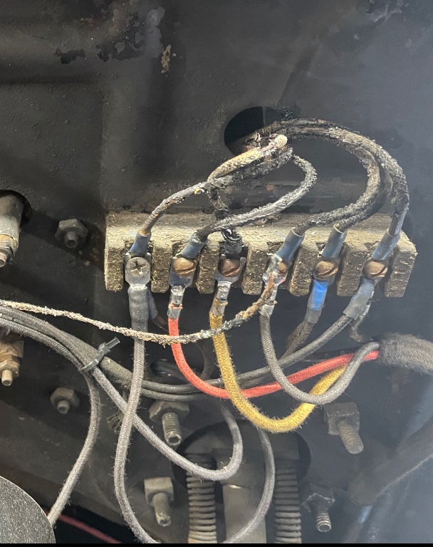

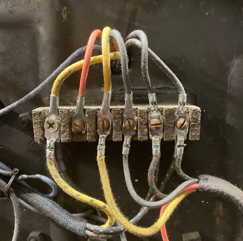

All the wires going from the terminal block through the firewall look damaged in the photo. Only one wire going from the terminal block to the underhood area looks bad.

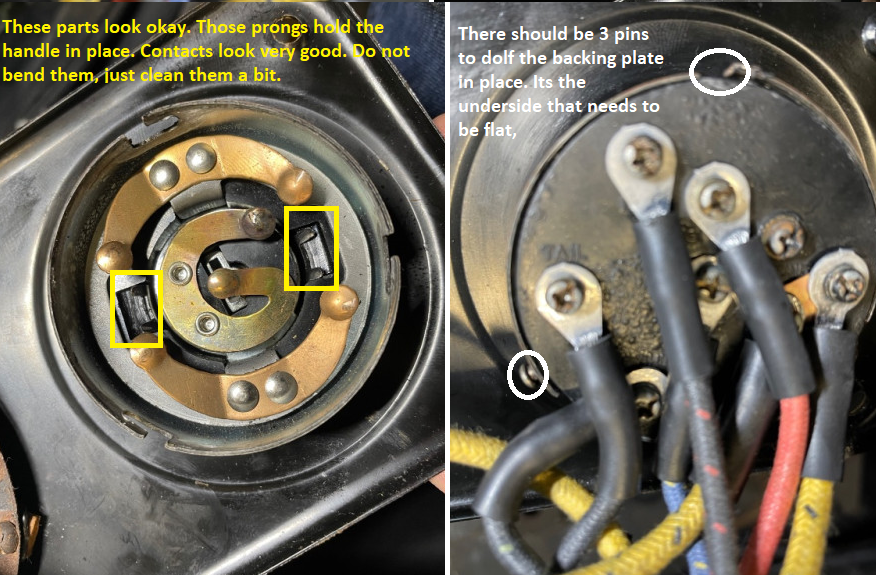

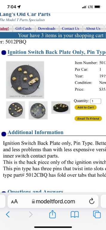

If your lucky its just the backing plate. Ammeter may have survived. Post a picture of the ignition switch.

Eli, can you identify what that burnt wire is on the body side of the junction block, looks like it might be wired to the tail light?

New pic after replacing melted wires:

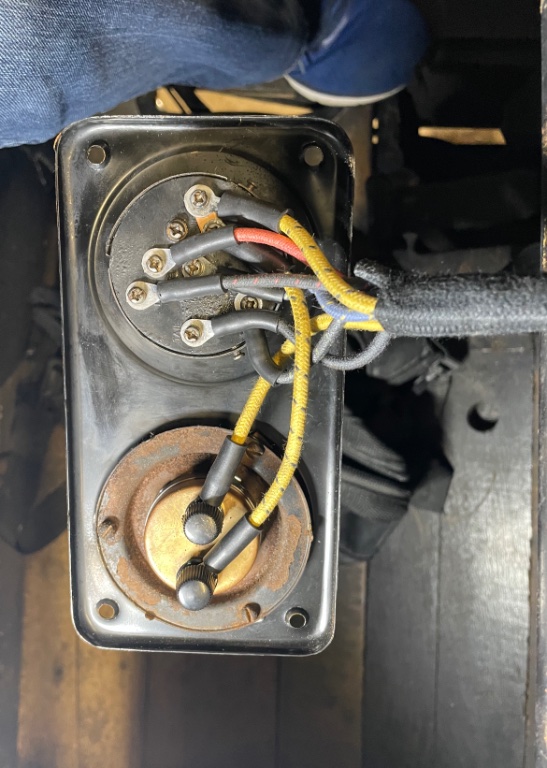

@TRDxB2 do you want a pic of the back of the switch where the wires are connected behind the dash?

@humblej that burnt wire is the one that goes from the Distributer coil to the back of the dash. Replaced with me blue wire in picture with yellow stripes.

Eli, you fried your points, condenser, and or coil, that is why it will not start. I would not assume the problem that caused the fire went away just by replacing the wires.
Your ignition switch may be bad, it may have been bad before the fire, but since your wires are burnt there could be damage to the switch too.
If your junction block is stripped out and needs a longer screw, I would suggest replacing it with a new junction block. It is possible to run a screw too long and have it ground out on the metal firewall.
You should add an in-line fuse close to the starter switch to the yellow wire.
Fire with the key on bat should not have caused a burned wire on whatever is connected at the tail light wire junction, what was that wire for?

Eli, what was this wire for? Looks like it is connected to the tail light.

I believe that was the wire that went to the positive side of the distributer coil. It melted and the wire broke there. But it bypassed the terminal block and ran through the firewall hole to the back of the dashboard. I replace it with the blue wire with yellow stripes on it.

The picture of the melted wire makes it look like it is attached to the terminal block but it wasn’t .

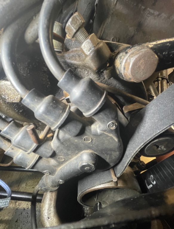

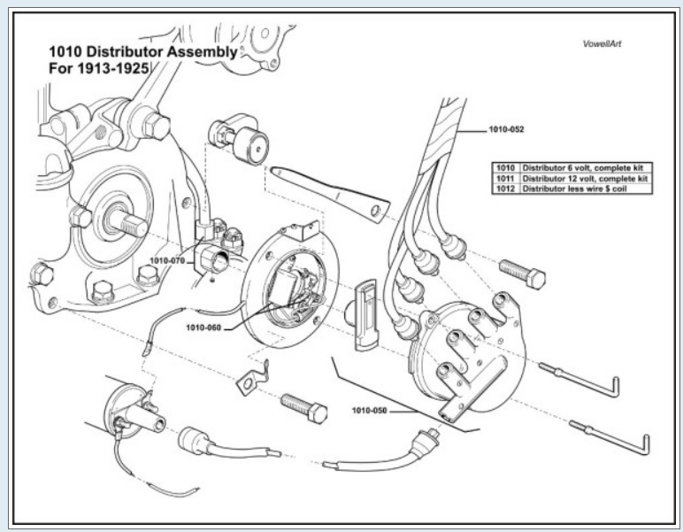

Eli, that appears to be a Model T Ranch distributor, https://modeltranch.com/show_product.asp?idProduct=5,. I don’t think I’ve ever seen a fan belt guide that positions the belt like that on the crank pulley. The position of your fan assembly arm my need adjusting. Curious, do you have a water pump on your engine? I’m not going to get in the debate of for or against water pumps but just asking because of the belt alignment. An option to consider without knowing any of the above is to get the smaller pulley for the crank to give you more leeway on the belt positioning though it may require you to get another length belt. I believe you also can reposition the belt tensioner that comes with that set up you have.

Thanks JTT3. No water pump. I tried to get a new pully but everything is back ordered. I hope it comes in soon. I’ll check to see if I can find parts for that distributer and going to put the fuse on soon.

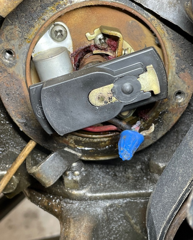

Your distributor is from a Honda. The fan belt should run on the other side of the idler pulley, the idler pulley is used to keep the fan belt off the distributor. I think the Ford Barn in Spokane Washington sold those, but I am not sure. If you can’t find distributor parts it may be easier to change to the currently made VW type. I believe the biggest problem with the Honda type was the idler pulley failure . The Honda distributor may use electronic solid state components and they were most likely damaged in your electrical fire. Be sure to change out that thermal block, a extra long screw touching the metal fire wall is a direct short to ground, bad news and burnt wires if and when that happens.

Here's what I think happened: You left the ignition "on" in the "Batt" position. The points in the distributor happened to be closed, so the coil was receiving a continous supply of battery current, which caused it to overheat and short to ground. This caused the ignition primary wire to burn up and break the circuit. The points are probably damaged. Other wires near the ignition primary wire may have been damaged. The ignition switch, which I assume is the original Ford-type switch, may be damaged. I don't think the battery tender had any role in your problems. The coil may or may not remain shorted to ground. I would replace it, regardless. I would replace or rebuild the ignition switch and replace the points and condenser and examine any internal wiring in the distributor for any signs of overheating or abrasion. I would replace the firewall terminal block and any wiring that showed any evidence of heat damage or abrasion. ** If your ignition system uses an ignition resistor, it is probably damaged. I would replace it.

Is that an idler pulley above and to the right of the crankshaft pulley? It looks like an idler designed to keep the belt away from the non-stock distributor. That would explain the odd position of the belt guide.

One of my Model T pet peeves is "creative" wiring with the wrong colors. #4 should be green. I'll forgive the headlight wires because they retain the basic black. In fact, the tracers are a helpful aftermarket accessory.

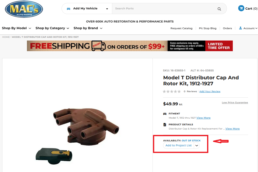

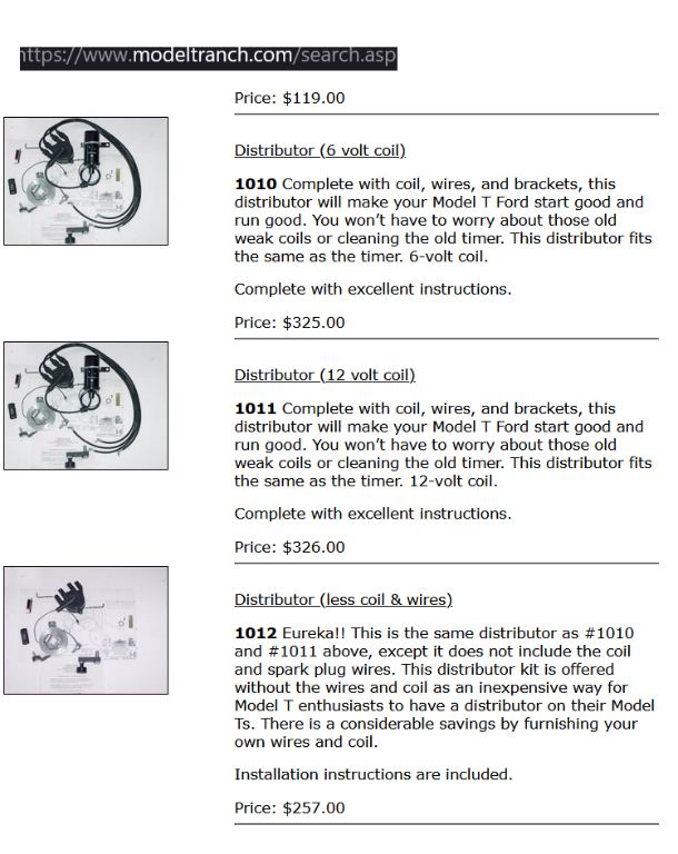

The distributor you have is still available - likely the parts are too --ecory0 wrote: ↑Sun Apr 03, 2022 9:03 amLooks like Lang’s only sells Bosch Distributer and parts. Not even sure what I have on my T. Any idea where I could get parts for this? Also my fan belt keeps slipping off and while taking this picture it seems the belt is rubbing against this Distributer setup. Probably why. Maybe time to buy a new one? But they look pricey.
But the parts may not be - also you need to be careful and making sure points etc are for YOUR distributor --
Here a wiring diagram for a distributor
- Posts: 6710
Re: Wires melted and now won’t start
It is a John Stoltz design distributor system. It was, and is, sold by Model T Ranch.
https://www.modeltranch.com/search.asp
if you want to pay 25% more and buy it from MAC's, then you can buy it from MAC's, but the SOURCE is Model T Ranch. This product has been out there for like, forever (if 35 years is "forever")
- Posts: 6542
Thanks --- Forgot about Model T Ranch. MAC's (aka Eckler's) does seem to have higher prices on some thingsScott_Conger wrote: ↑Sun Apr 03, 2022 3:50 pmIt is a John Stoltz design distributor system. It was, and is, sold by Model T Ranch.
MODEL T RANCH Prices

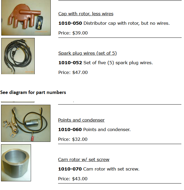

Should I get new spark plug wires? Or just the cap, points and condenser.

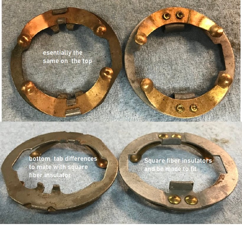

You may not need all these parts. Most condensers are common, points should be okay if not welded together. Small pitting is common and can be filed off. Distributor cap and rotor should also be visibly okay. Checking continuity of spark plug wires and inside/outside of distributor contacts.

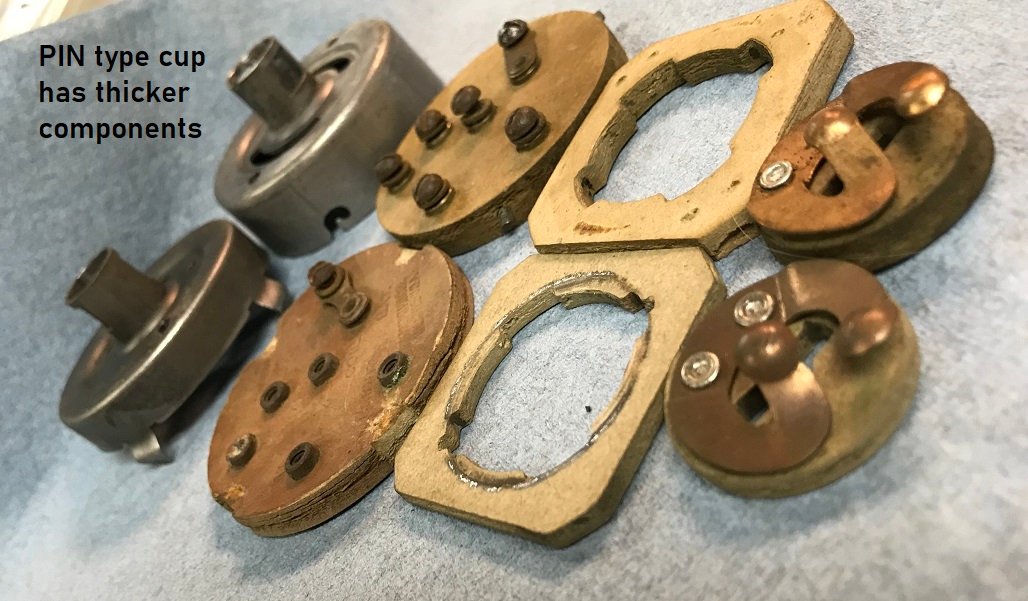

Still my feeling is its the ignition switch. A fiber disk with brass contacts connected to melted wires - just sounds like something has to be wornfg. Not sure what you have PIN or CLIP-ON style but individual parts are very similar. --
Depending on the switch handle this part may be different

The ignition switch would make sense since the plastic backer on the key switch was a little melted but the wires closer to the alternator looked ok. I’ll replace that first and go from there. It’s less expensive than changing the alternator.

Ohhhh plastic backer on the ignition switch!

Perhaps the switch overheated and shorted to ground, rather than the coil.

- Posts: 8421
It should not be necessary to disconnect the battery. In this case, the battery tender/charger played no role in the problems. Accidentally leaving the ignition switched on, plus a little bad luck with exactly where the engine stopped, caused the problems.
- Posts: 6542
Don't order anything yet till you oped the switch. If is the PIN style you need to press down one the disk and rotate counter clockwise. I find it easier to bridge a small screwdriver across some screws to act as a lever while twisting. Many ignition switches and parts may be out of stock. Don't take more apart than than the photos aboveecory0 wrote: ↑Tue Apr 05, 2022 7:08 amYes, not sure why my fingers keep typing alternator when my mind it thinking distributor…. Ugh. Going to order a new switch first. Should I just get the back part or the entire switch? And does it make a difference which back type I purchase? Looks like there are two types.

J1MGOLDEN
- Posts: 1314
- Last Name: Golden
- Location: Bowie, MD
George, to disconnect the battery cable would be far more difficult than just getting out a sharp knife from your pocket and cut the yellow wire leading to the battery, which I have done twice and seen done three times.
Here is one example.
note the correct ammeter is installed now.
ecory0
Topic author - Posts: 90
- Joined: Mon May 03, 2021 7:55 pm
- First Name: Eli
- Last Name: Cory
- Location: Bristow, VA
Looking at Jimgolden’s picture, I think I have the Yellow stripped wire from the amp meter going to the wrong screw?
- Posts: 6542
The backing plate obviously got very hot. The bobbles on top are of no concern. Its the underside that needs to be flat. It looks okay but seems to be missing a pin. You can use a small machine screw but be careful not to split the disk or be to long and contact a screw. Some rub the bottom of the switch plate face down across some sand paper, light sanding, to flatten it and clean it up a bit. It actually might be okay. The material that the backing plate and internal parts are made of where part of a restoration kit, and/or reproduction switches (when?). I have a set that I was unsure of, but after seeing what it went through I'd say its not a bad repro. I have other ones made of different materials.
The connection you question are Okay since there is a jumper under the two screws. But I would rearrange and separate the wires a bit like Jim did to avoid any accidental contacts.
The ammeter you have is a substitute, a 1926 style in an adapter plate. No need to replace it unless your trying to be year perfect. Then your only choice is a used one since repro's don't appear to be available anymore. Used ones are available but "Buyer be aware" they may not be working.
George Mills
- Posts: 644
- Last Name: Mills
I think the pictures are pretty much the same?
Anyway....slow down, take a breath...chances are those switches and switch parts have another century of back order on them (almost, only kidding I use to hold the Langs record for longest backorder in Langs existence, but these switch parts seem to be almost unobtanium new. I took my name off the list...Steve Lang said may not want to do that, I'll drop 100 plus spaces in the queue for a complete new switch.)
Anyway...here's my take/my story...on my hack and very similar. I had a car that suddenly wouldn't run on mag to save my life yet my mag meter showed 27 volts when running down the road on battery. My horn was on mute. My lights were a tad wonky as dim and reg had the same filament. Gotta be a warped switch-back right...since I know the wires to the terminal block were right?
Terminal block...like yours mine was one of those soybean contraptions...probably original...and it looked like overbaked bak-o-lite, more like a sand casting and the dividers went in all different directions...no loose terminals, tiny wood screws good and tight. Why not, I have a couple of new in a box...so just for the heck of it, changed the terminal block to a new one while waiting for the Langs backorder for a switch to clear.
Because it's a hack, the standard wire loom from the switch back to the terminal strip is a tad too long. I was going to shorten to size, etc as part of this 'whatever' fix. I popped the switch plate over and took a look...backplate didn't look warped but that don't mean a thing others have pointed out in the past. Woopee! Pin back! I'll pop the back off and see if there are grooves worn or something bent (The other type, the tab type needs care to bend, then heat anneal before bending back later or they break off...the pin type is a 10 degree turn while pushing down and the back pops off)
Well, that little ammeter wire was bare, insulation had just aged and crumbled to dust...but it didn't touch anything...lol. The switchback has all of the divets on the inside black while the copper ring was still polished. I took a white eraser on a pencil and like a valve grinder got them clean. Fiber backplate was still flat and not too grooved.
Bolted everything back up, made a new wire for the batt terminal to ammeter peg...amazing...ALL works as it should an I can't tell you why, but I'll take it! I think perhaps that just like that carbon tracking on wooden firewalls issue with the early cars, that soybean terminal strip just might hold moisture...but to change them out is a 15 minute job and they are relatively cheap.
Just my 02 in 2022....

- Posts: 8421
"It is a John Stoltz design distributor system. It was, and is, sold by Model T Ranch." (S. Conger)
- Posts: 4694
This is a long string of posts, and I scanned over them. Maybe it was mentioned, however, I didn't see any reference to checking the ammeter. In a circuit without any fuses, the ammeter is the weakest link. If your lights work, check whether it moves to discharge when they are on. If so, it is good and correctly connected, at least the light circuit is correct. If you have a tester, you can test for continuity. If it is open, you will need to replace the ammeter.
- Posts: 4626
The distributor setup is as Scott C. pointed out is a Model T ranch product. The Model T Ranch website has repair parts listed for their distributor set-ups. Maybe checking out the distributor may be a good idea if the wiring has been been gone over and replaced as necessary.
The parts are available.

ecory0
- First Name: Eli
- Last Name: Cory
Well… got to the bottom of it all. First, thank you to everyone for helping me with this. As you can see in the pictures, the wires in the distributor melted apart. I think that is a clue, lol.
- Posts: 5472
Is that's what's left of a wire nut ??????????
- Posts: 4392
Yup, that's a mess. The condenser rubbing on the cam wasn't a great thing either.
- Posts: 6710
Photographic proof that not all repairmen are mechanics.
- Posts: 4626
That’s the first place I would have looked if I had a T with a distributor. But at least we now know what caused the trouble.

When you get your points and condenser MAKE SURE that the condenser doesn’t rub against the shaft. Even if that is the ?? correct ?? condenser it’s way to close to the shaft. You may can file off the condenser bracket to get it about 1/16” farther away from the shaft.
Good luck.

A common problem with a distributor is that the points stick closed which gives a constant ground. If your bushings in the shaft are worn, the cam moves away from the block on the points and the point gap gets smaller until the points stick. So check the point gap and also try to move the shaft side to side to see how it fits.

Jerry, I believe Norman is referring to worn bushings and play in the distributor shaft, not the engine cam shaft.
- Posts: 4392
Yes, I know, but if you look at the distributor he's using, you'll see that the rotor runs directly off of the cam shaft. It's not your "normal" type of distributor.MichaelPawelek wrote: ↑Mon Apr 25, 2022 6:08 pmJerry, I believe Norman is referring to worn bushings and play in the distributor shaft, not the engine cam shaft.
From a posting on April 3...
- Posts: 4694
Yes it is the distributor shaft which of which I was referring to. Also if the ignition switch had been left on while the points were together, which they should be during a certain part of the cycle called "dwell" If they were together when the key was left on, the current would continually flow to ground and cause a melt down. So I think you have solved it.
First off you should have done a visual inspection off all the wiring and the distributor. An ohm meter is a good investment to check continuity of your wires and switches.it does not have to be a high dollar unit, any possibility of taking your points and condenser to your local parts house and see if they might be able to find a match. Some of these parts people can find anything.
As for your fan belt and idlers and pulleys, takea look under the hood of your daily driving car and you can get a general idea of how idlers are used to route belts around things and not rub. Your belt rubbing on that pin by the distributor is incorrect and the belt should be under the idler and against the back side of the belt.
If all else fails a timer and 4 coils can make a T purr and is easy to use a jumper wire on to test and bypass circuits.
As for your wiring block, yours looks original and looks like pressed sawdust. Since you are not running a show car, bgo to a parts house and get a modern one and mount it on a piece of Delton or hard rubber and then mount it on the firewall and it will not short out if a screw is too long. Even a piece of a kitchen cutting board would insulate the backside.
