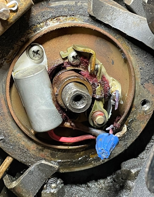

@humblej that burnt wire is the one that goes from the Distributer coil to the back of the dash. Replaced with me blue wire in picture with yellow stripes.

Eli, you fried your points, condenser, and or coil, that is why it will not start. I would not assume the problem that caused the fire went away just by replacing the wires.
Your ignition switch may be bad, it may have been bad before the fire, but since your wires are burnt there could be damage to the switch too.
If your junction block is stripped out and needs a longer screw, I would suggest replacing it with a new junction block. It is possible to run a screw too long and have it ground out on the metal firewall.
You should add an in-line fuse close to the starter switch to the yellow wire.
Fire with the key on bat should not have caused a burned wire on whatever is connected at the tail light wire junction, what was that wire for?

Eli, what was this wire for? Looks like it is connected to the tail light.

I believe that was the wire that went to the positive side of the distributer coil. It melted and the wire broke there. But it bypassed the terminal block and ran through the firewall hole to the back of the dashboard. I replace it with the blue wire with yellow stripes on it.

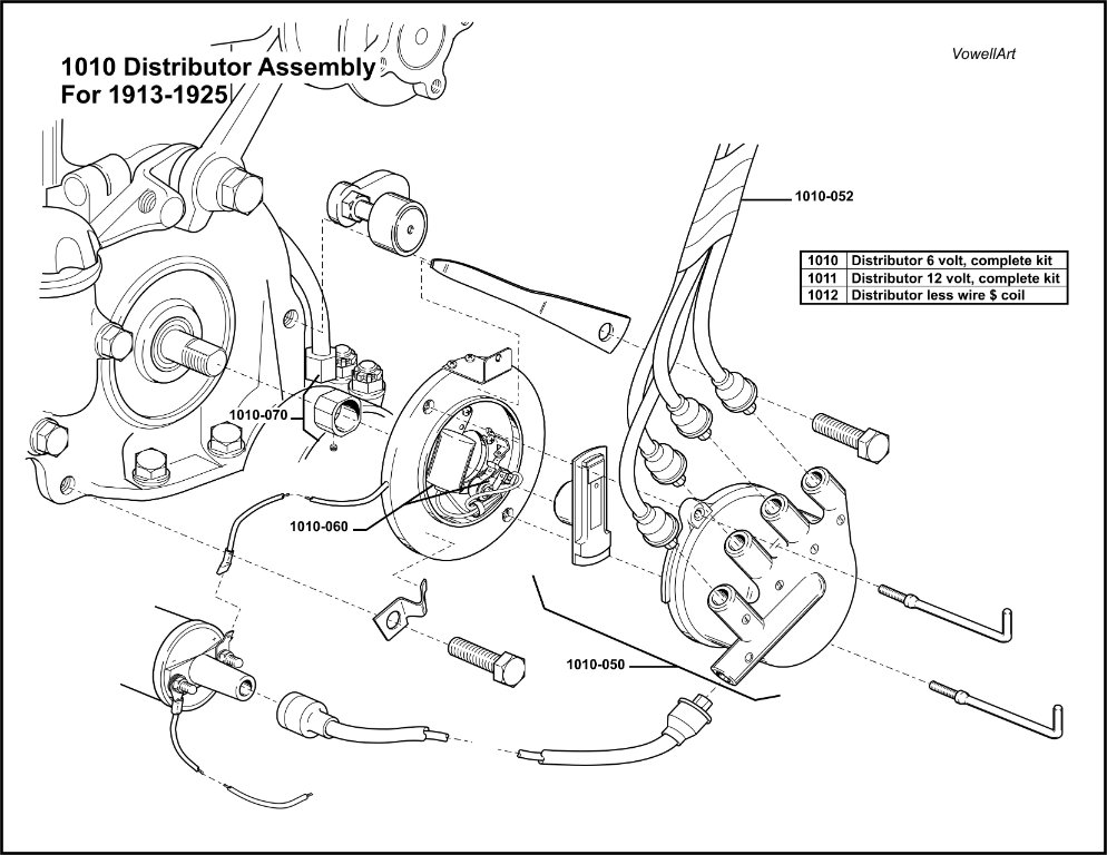

The distributor you have is still available - likely the parts are too
But the parts may not be - also you need to be careful and making sure points etc are for YOUR distributor
Here a wiring diagram for a distributor

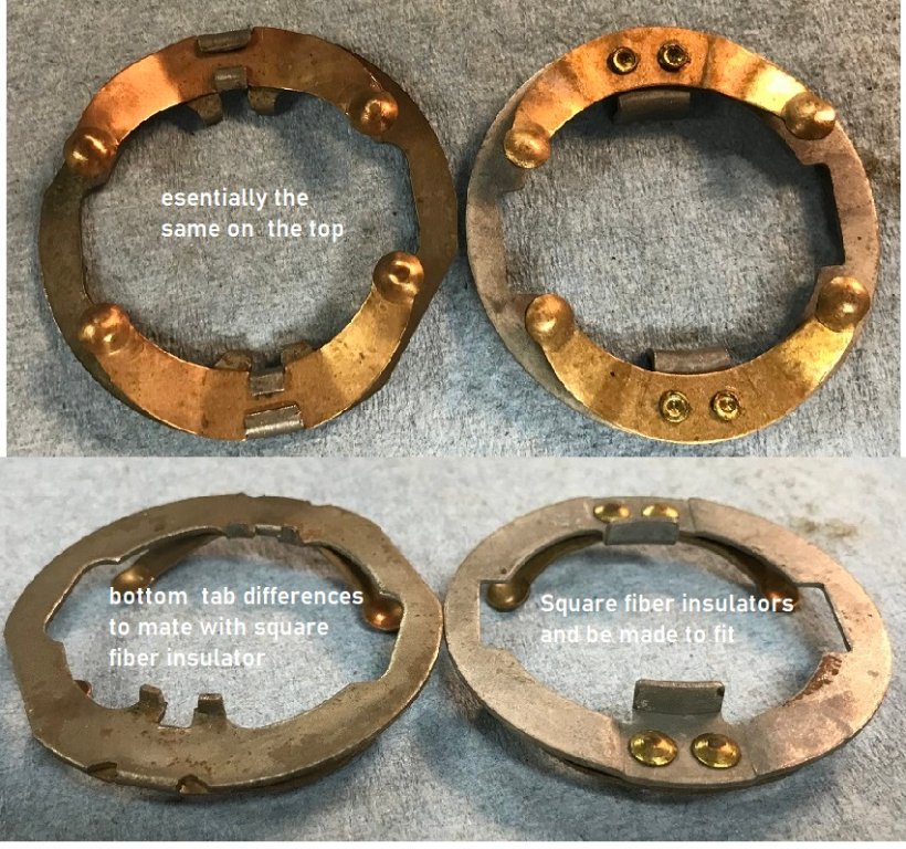

You may not need all these parts. Most condensers are common, points should be okay if not welded together. Small pitting is common and can be filed off. Distributor cap and rotor should also be visibly okay. Checking continuity of spark plug wires and inside/outside of distributor contacts.
Still my feeling is its the ignition switch. A fiber disk with brass contacts connected to melted wires - just sounds like something has to be wornfg. Not sure what you have PIN or CLIP-ON style but individual parts are very similar.
Depending on the switch handle this part may be different

George, to disconnect the battery cable would be far more difficult than just getting out a sharp knife from your pocket and cut the yellow wire leading to the battery, which I have done twice and seen done three times.
Here is one example.
note the correct ammeter is installed now.
Ron's Problem.JPG (49.94 KiB) Viewed 12051 times
Ron's New Switch Back.JPG (57.12 KiB) Viewed 12051 times

The backing plate obviously got very hot. The bobbles on top are of no concern. Its the underside that needs to be flat. It looks okay but seems to be missing a pin. You can use a small machine screw but be careful not to split the disk or be to long and contact a screw. Some rub the bottom of the switch plate face down across some sand paper, light sanding, to flatten it and clean it up a bit. It actually might be okay. The material that the backing plate and internal parts are made of where part of a restoration kit, and/or reproduction switches (when?). I have a set that I was unsure of, but after seeing what it went through I'd say its not a bad repro. I have other ones made of different materials.
The connection you question are Okay since there is a jumper under the two screws. But I would rearrange and separate the wires a bit like Jim did to avoid any accidental contacts.
The ammeter you have is a substitute, a 1926 style in an adapter plate. No need to replace it unless your trying to be year perfect. Then your only choice is a used one since repro's don't appear to be available anymore. Used ones are available but "Buyer be aware" they may not be working.

I think the pictures are pretty much the same?

"It is a John Stoltz design distributor system. It was, and is, sold by Model T Ranch." (S. Conger)

The distributor setup is as Scott C. pointed out is a Model T ranch product. The Model T Ranch website has repair parts listed for their distributor set-ups. Maybe checking out the distributor may be a good idea if the wiring has been been gone over and replaced as necessary.
The parts are available.

Finally got back in the garage. I have power through the switch and coming in and out of the distributor coil. There is continuity through the ammeter. I’m not sure how to test the distributor but given that power leads up to it, I’m guessing that narrows the search down. Thoughts?

You can make a very basic test of the distibutor by using an ohm meter. With the ignition OFF, The terminal on the distributor side of the coil should show NO continuity to ground when the points are OPEN. When the points are CLOSED, the terminal on the distibutor side of the coil should show no resistance (full continuity) to ground. (With the points open, you may get a momentary indication of continuity as the capacitor charges. This indication should go away in a few seconds or less) I don't know the correct setting for your points, but .015 to about .018 ought to allow the engine to start and run.

Post by Jerry VanOoteghem » Sun Apr 17, 2022 3:04 pm
ecory0 wrote:
Sun Apr 17, 2022 12:30 pm
Check your points for corrosion or pitting. Then, with the ignition on, and the distributor cap removed, you should be able to manually open & close the points**. Remove the coil output wire from the distributor cap and let the end lay about 3/16" from the engine block. When you manually operate the points, you should see a spark from the coil wire to the block. This assures that you can actually make a spark. Next step is to figure out why the spark isn't coming through the distributor and getting to the plugs.
**Do this when the engine is rotated such that the points are in the closed position.

Well… got to the bottom of it all. First, thank you to everyone for helping me with this. As you can see in the pictures, the wires in the distributor melted apart. I think that is a clue, lol.
Posts: 5591
Re: Wires melted and now won’t start
Post by RajoRacer » Sat Apr 23, 2022 1:40 pm
Is that's what's left of a wire nut ??????????
Posts: 4471
Post by Jerry VanOoteghem » Sat Apr 23, 2022 3:06 pm
Yup, that's a mess. The condenser rubbing on the cam wasn't a great thing either.
Posts: 6798
Post by Scott_Conger » Sat Apr 23, 2022 5:10 pm
Photographic proof that not all repairmen are mechanics.
Posts: 4681
Last Name: Kuehn
Location: Texas
Post by John kuehn » Sat Apr 23, 2022 5:31 pm
That’s the first place I would have looked if I had a T with a distributor. But at least we now know what caused the trouble.
DJPeterson
Posts: 59
Joined: Sun Jan 06, 2019 11:09 pm
First Name: Dale
Last Name: Peterson
* REQUIRED* Type and Year of Model Ts owned: 1915 Touring, 1916 Roadster, 1925 Roadster PU, 1926 Canadian Fordor, 1927 Speedster
Location: College Place, WA
Post by DJPeterson » Sat Apr 23, 2022 6:38 pm
Not done diagnosing yet, what caused the short that burned up the wire? That was the end result of another problem.
Posts: 8640
Post by TXGOAT2 » Sat Apr 23, 2022 7:35 pm
The coil may have shorted to ground, or the capacitor may have shorted to ground, or the points themselves may have shorted to ground. It's possible the flexible wire inside the distributor that connects to the points grounded. Any of the preceding could have resulted from leaving the key on with the points closed for an extended period of time.
Posts: 4681
Last Name: Kuehn
Location: Texas
Post by John kuehn » Sat Apr 23, 2022 8:24 pm
The over packed distributor is probably the main cause of the short issue. A careful eyeball inspection shows the condenser being continually rubbed by the shaft is a no-no. If not that the wiring being jammed inside the distributor looks like it shorted and if the key was left on something eventually got continuity and then 🔥💥⚡️

The ignition primary circuit is not designed for 100% duty cycle.

I’m not a mechanic, just a hobbyist who is having fun learning about the model T. I ordered a new set of points and condenser from model t ranch. Hope to get it back on the road soon.
Posts: 6798
Post by Scott_Conger » Sun Apr 24, 2022 11:11 am
Eli
I am in no way impugning your ability. I simply am pointing out that over the last 100 years, these things have been worked on by folks with varying degrees of abilities and thoughtfulness. Your distributor is a case-in-point as to the surprises these things can hide. I most certainly wish you many years of enjoyable tinkering and driving.

When you get your points and condenser MAKE SURE that the condenser doesn’t rub against the shaft. Even if that is the ?? correct ?? condenser it’s way to close to the shaft. You may can file off the condenser bracket to get it about 1/16” farther away from the shaft.
