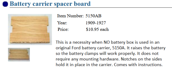

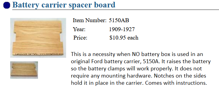

From Langs

Lang's lists the 5150A battery carrier for 1919-1927.

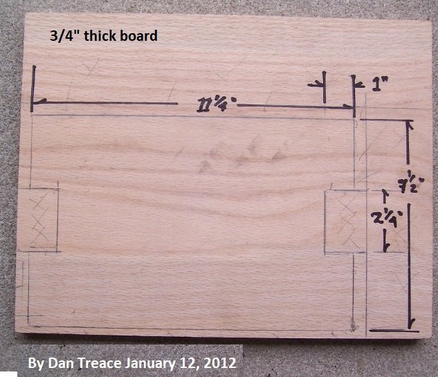

DIY oak, poplar, hard maple, plywood but seal the wood. May be cheaper to purchase from Lang's than buy the wood

When I bought my '27, the battery carrier and spacer(s) were a mess. I kid you not - I found Duct tape, Baling wire, and a couple of sheet rock screws (one of which protruded about 1 1/4" below the carrier). I repaired the battery carrier and thought about making my own spacer. When I looked at the Lang's catalog and saw the price of a store-bought spacer, I was on the phone to Lang's within ten minutes. No way I could get a decent piece of wood and make the thing for the $10.25 that Lang's wants for it. I also bought it a buncha years ago and it was cheaper then that.
