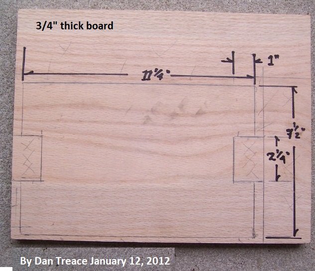

- Posts: 6413
Re: 1926-27 Battery Carrier
DIY oak, poplar, hard maple, plywood but seal the wood. May be cheaper to purchase from Lang's than buy the wood
