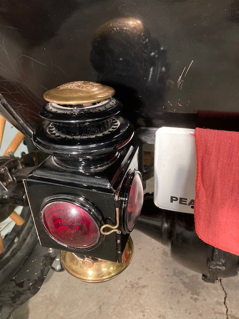

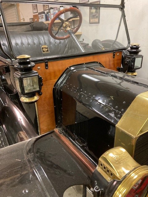

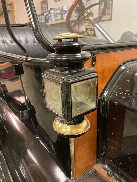

James, these are the sidelights and taillight on my 14 Touring. The Jno Brown sidelights are Model 110. You mention Model 100 in your post, that model is for a 12. The taillight is a Jno Brown Model 115. Blue lens to the driver side, red lens to the rear, clear lens pointed at the license plate. These lights have all been restored but retain the original configuration of black and brass. Hope this helps, let me know if you have any more questions.
