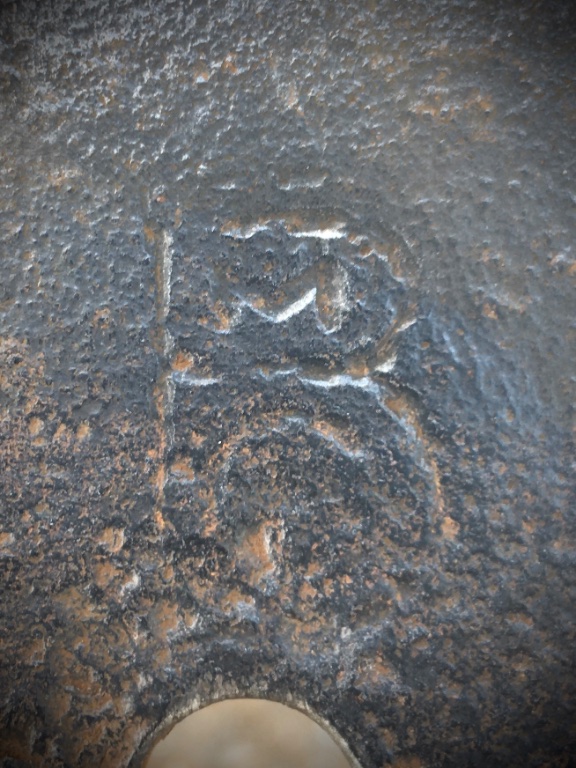

There seems to be a lot of identification markings all over the model T. What they all mean can be mysterious. Maybe someone will know? Post them if you’ve got them.
while wire brushing my frame down today I found this marking under the scale. I can see the letter M Then maybe a B or R and what might be a C or G. Any ideas? Its on the rear cross member drivers side right at the body mount hole. 1926 frame

Different steel mills roll their I D marks in the product they produce. It may be just one of those.

I can't find previous discussions on this. These are the marks I am familiar with. I know A.O. Smith made frames early for Ford but others did later.
maybe someone else can remember.

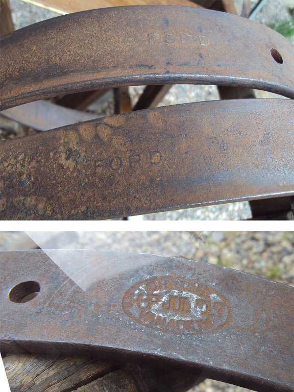

Some of the spring leaves on my 21 T has Carnegie randomly on the leaves. It’s faint but there.

The spring markings are very interesting too. Here are some I found.

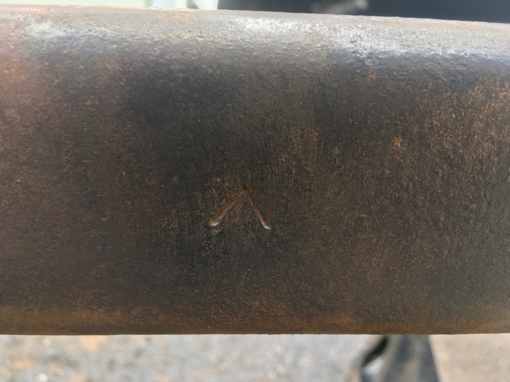

here’s another hieroglyphic. Passenger side frame rail about the area of the carburetor. Possible assembly line guide?

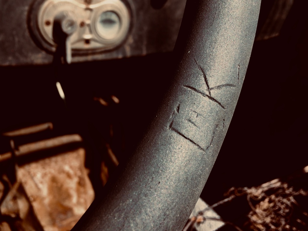

Bryant
Posts: 1214
First Name: Bryant
Last Name: Shafer
Location: Myersville Maryland
Re: Identification Markings
Post by Bryant » Wed Jul 27, 2022 7:35 pm

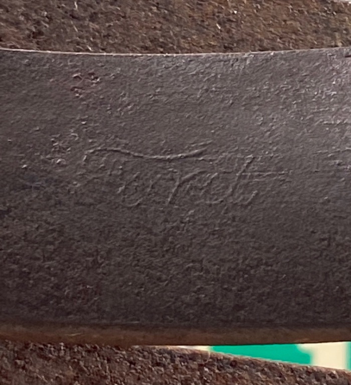

Then there’s this one which I would love to find out! Owner from long ago?
